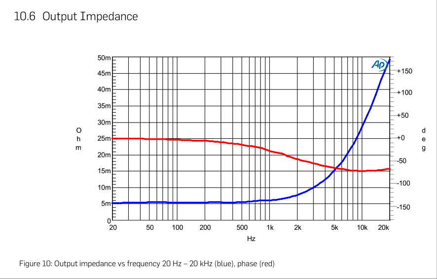

Two days ago I was reviewing, again, the manual of the new IcePower 1200AS2 class D module and I was struck by this graph, where the phase shift is almost 70º at 20 kHz!
Hypex NC500 only says:

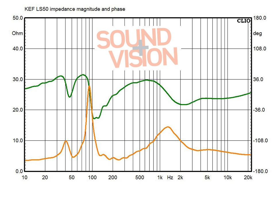

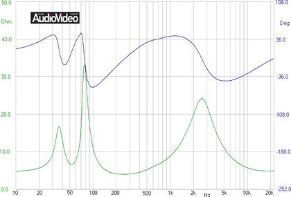

Is it usual in this type of amplification? Taking into account that the phase also varies -except specific filters- in the speakers, how does it affect sound at high frequencies?
KEF LS50
Output coil inductance: 10 uH Effective output inductance ithis number divided by loop gain.

KEF Q100

[ Two days ago I was reviewing, again, the manual of the new IcePower 1200AS2 class D module and I was struck by this graph, where the phase shift is almost 70º at 20 kHz!
[URL]http://maty.galeon.com/WP-imagenes/hard/IcePower-1200AS2-output-impedance-phase.png[/URL]
...Taking into account that the phase also varies -except specific filters- in the speakers, how does it affect sound at high frequencies

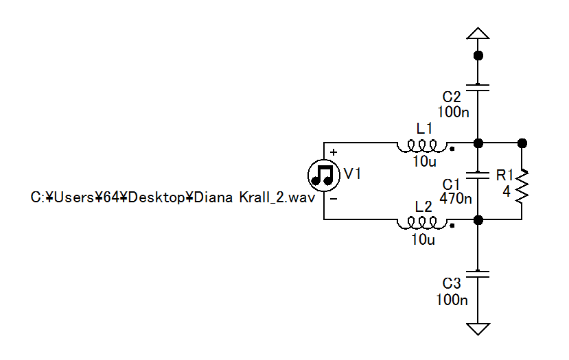

I've simulated the wave file as source and saved R1 voltage as wave file again. That's typical H-bridge LC filter, suitable for most popular Ti amps. 20kHz -40deg. Anyone hear the difference original vs simulated?
Diana Krall_1.wav — Yandex.Disk
Diana Krall_3.wav — Yandex.Disk
I would like to point out that in the original post the graphs of phase are the electrical phase of the loudspeakers.
Yes, the second and third are of the magnitude and phase of speaker impedance.
The first is the output impedance and the phase of that output impedance of the "IcePower 1200AS2 class D module".
...This has absolutely nothing to do with the acoustic phase shift of the drivers + crossover combination.
Yes again

Is anyone else encouraged to make the test?
Yes. No audible difference for me.
