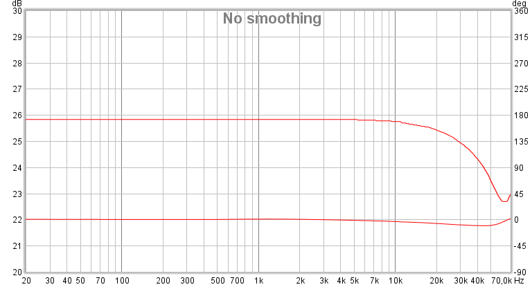

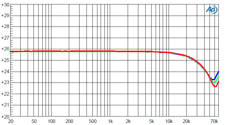

As below in a limited window of X and Y axis they do show a frq response in 10.1 of datasheet, blue is 4 ohm load, green is 8 ohm, and red is no load:
attachment.php
Using a free trace program we can get a rough response copy of above red trace and then again using a free program phase extractor we get below minimum phase domain curve for that response (20kHz point phase is a minus 6,8º number so far with out knowing more about low pass slope up higher):
attachment.php

...PASCAL module has a little better frequency curve but the phase is not like your simulation.
Yes its the limited window of X and Y axis that hinders us to get the real low pass slope up higher where so far they use a 70kHz window limit.

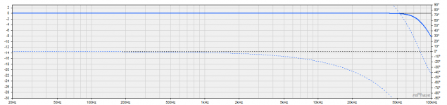

You can use free Rephase and estimate that Pascal graph, below is a dirty quick 4th order low pass at 80kHz and looks close.
I think its as good as that Pascal in that we can see frq response goes up again where window leave us uninformed above 70kHz, its probably some kind of resonance filter at 60kHz that is needed for that amp topology and its allowed cost budget as Eva kindly reminded us play a role.
If you have these modules yourself its much easier hang it inside a soundcard loop with some resistor divider network and measure performed amplitude and phase domain, if you use REW then align impulse with Controls/"Estimate IR delay" and then Controls/"Generate minimum phase" and you will see if it deviate from minimum phase domain as discussed over at ALPHA thread where xrk971 and AKSA seems to like output verse input have faster phase as frq goes up than a pure minimum phase domain device will dictate. What they like is what can be done with any FIR filter as crazy as you want it smooth or resonant like but i don't agree it can be done without measurements in acoustic domain because as far as i know real world and sound are mostly of minimum phase nature and the same are recording and reproduce chain that music material are mixed under, so in my view only thing they get doing that by ear is a sound system that stand out because their brain feel for a improved 3d soundstage that can be hard to be recreated for others because we don't have same acoustic environment and exactly same chain of playback gear as they have. And if you intend use this digital amp for bass duties only then forget about its phase turn at 20kHz point because it doesn't really matter when there is no amplitude.
