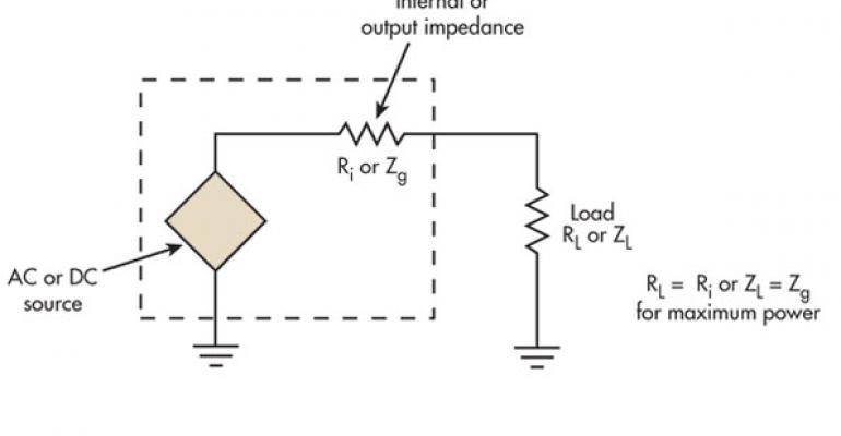

How much affect with IcePower 1200AS2? I do not know.
I just received the answer. They say that is not the module amplitude and phase response.
They do not provide what is.
But, you know, a poweramp is like a black box system. You can modelate it.
In class A or class AB the output impedance is almost resistive. It usually varies in a range of six degrees. You know, Engineering is the science of what is possible (or reasonable).
The question is in class D the output impedance is not only resistive!
How does it alter the phase of traditional dynamic loudspeaker systems, with phase < 45º ?
That is why in the first post I put the impedance and phase graphs of two: KEF Q100 (mine) and KEF LS50.
I trusted that, being the other parameters of this 1200AS2 class D module so excellent / superb, that said phase would hardly vary in f < 20 kHz.
Now we have a new variable in the equation in front class A or class AB.
How will it affect the sound quality? I do not know.

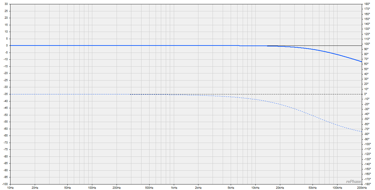

Well, there are phase shift but much less than IcePower 1200AS2, 700AS2 or Pascal M-Pro modules. Better engineering with frequency/phase in Hypex NC400.
Hi maty,
Phase for NC400 is probably textbook in it looks follow amplitude response (bandwidth) as a minimum phase device, below is nearly the same slope in a Rephase textbook example for a 1st order low pass at 54kHz, a close number to what NC400 datasheet tell about having a -3dB point at 50kHz so we close and should not worry other than some users would always wish or prefer for more bandwidth.
If you do not urge, I would expect Amirm to measure a NC500.
* NC400 at 20 kHz - about 17 degrees
* Anaview AMS1000 at 20 kHz - about 22 degrees.
The problem, I think, is in the IcePower 1200AS2, with much more degrees.
I still do not know if with acoustic music and natural voices we can appreciate the shift phase. I suspect that yes but I have not been able to verify it myself or found information on the net in one way or another.
If you listen to other kind of music, it will surely be difficult to notice differences.

I find confusing of what you are wondering about . The first curves posted for 1200as2 is the output impedance curves . Impedance means resistance and reactance components determined by phase angle . At 45° they become equal each being 0.707 of the impedance value which is about 7m ohm . That is the output of the amplifier the speaker sees it as a 5m ohm resistor in series with 0.45uh inductor . Just a wire of 1m linking the speaker will add 0.1 ohm in series to this impedance making it almost resistive .
