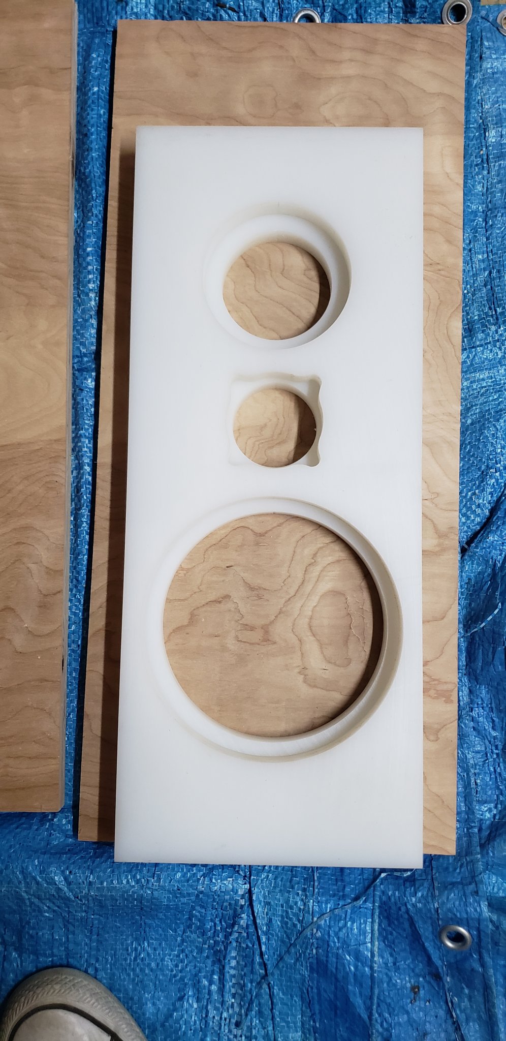

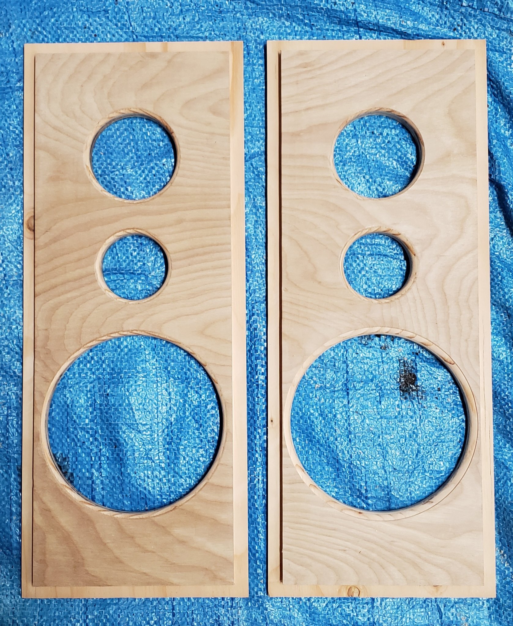

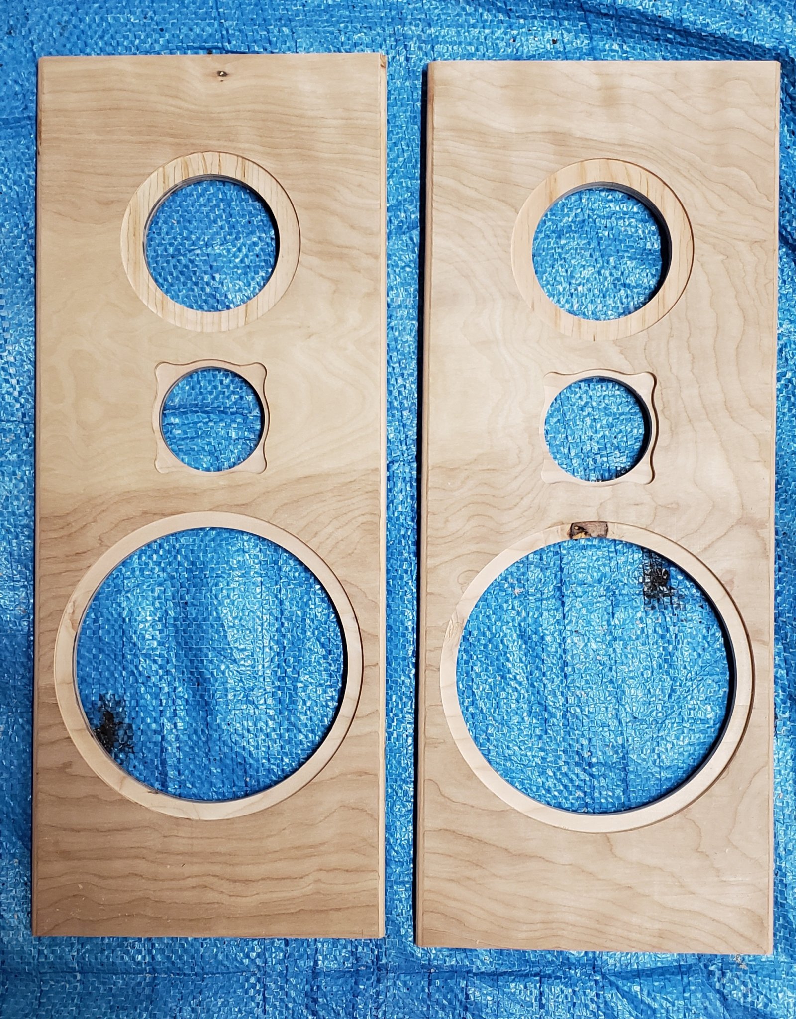

That should do it, best of luck!Would you be able to post larger versions of your baffle drawings with recesses if you have them? That would be greatly appreciated!
Thanks for pointing that out

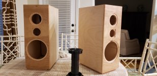

I hope you don't mind my dredging this up a year later... nice job on the speakers, and really helpful that you shared your work and process! Thank you.That is correct, 3/4 inch high density plastic templates. Thank you! Im happy with the progress so far.

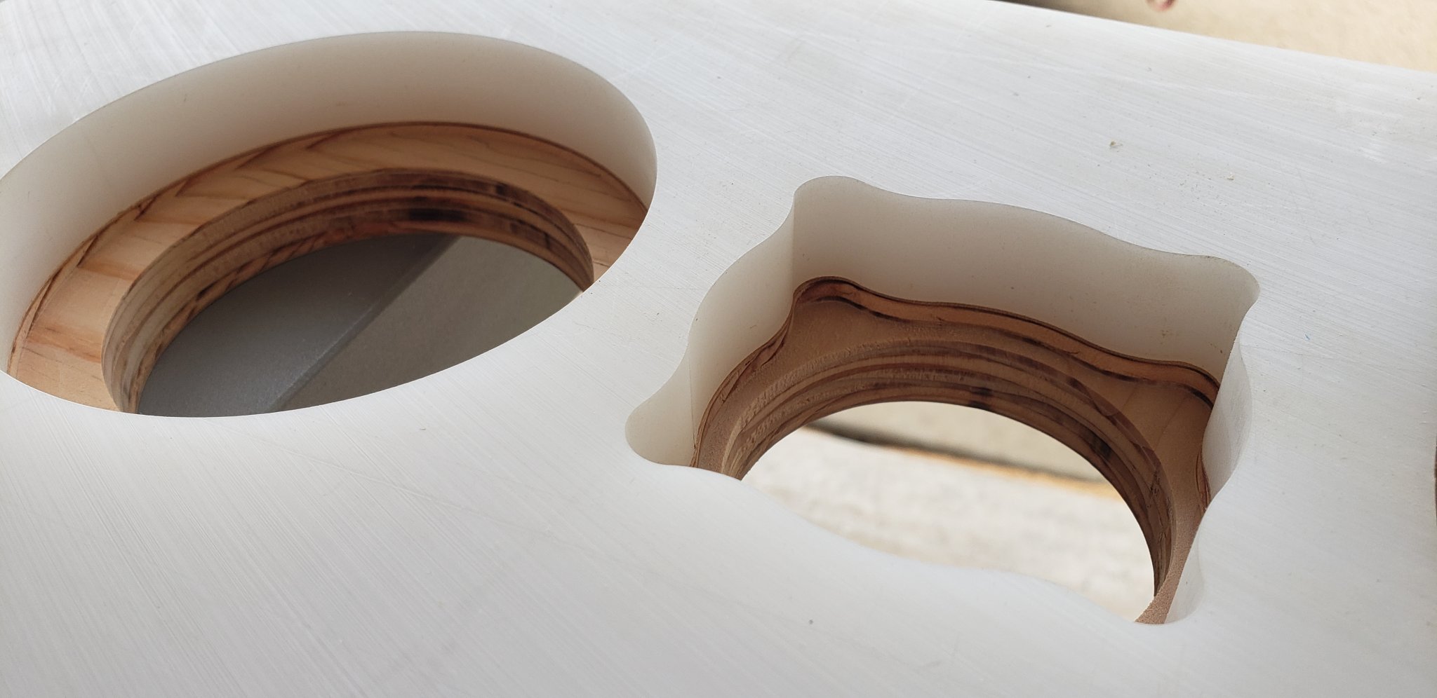

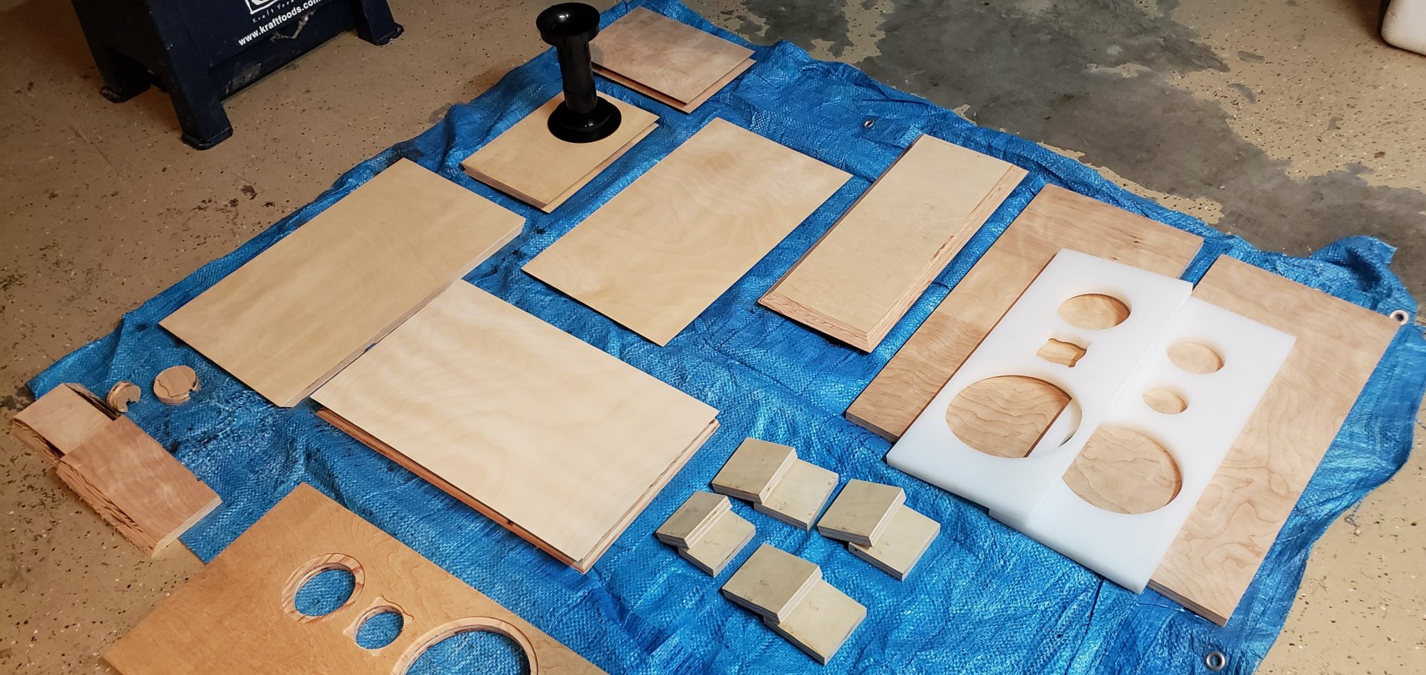

I like the waterjet-cut template idea. Mind if I ask which plastic you used, and the approximate cost? Did you also consider having the baffles CNCed?

Hello, I dont mind 🙂 and thank you, i am still enjoying them.I hope you don't mind my dredging this up a year later... nice job on the speakers, and really helpful that you shared your work and process! Thank you.
My ceramic BMR kit has been collecting dust due to "life", but I'm planning on changing that. My current concept is to make the housing out of concrete because I've always thought it would be interesting to mess around with that material, to pair with a wooden baffle.

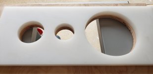

The plastic used for the templates is HDPE, a high density plastic. cost was about 380$. I considered having the templates CNCed but i didnt find any local businesses and was not aware online services existed. If i did it again i would have gone through SendCutSend.com for a cheap template then transferred it to whatever material i wanted.

Wow, what a kind and generous offer! Let me see how my design develops--a duplicate of your templates could be very helpful.Hello, I dont mind 🙂 and thank you, i am still enjoying them.
I have a sheet of 3/4" baltic birch collecting dust from a recent project. I can make a couple finished baffles if you cover shipping?
I also really appreciate the additional link to SendCutSend.com--I'm curious to explore their offerings!

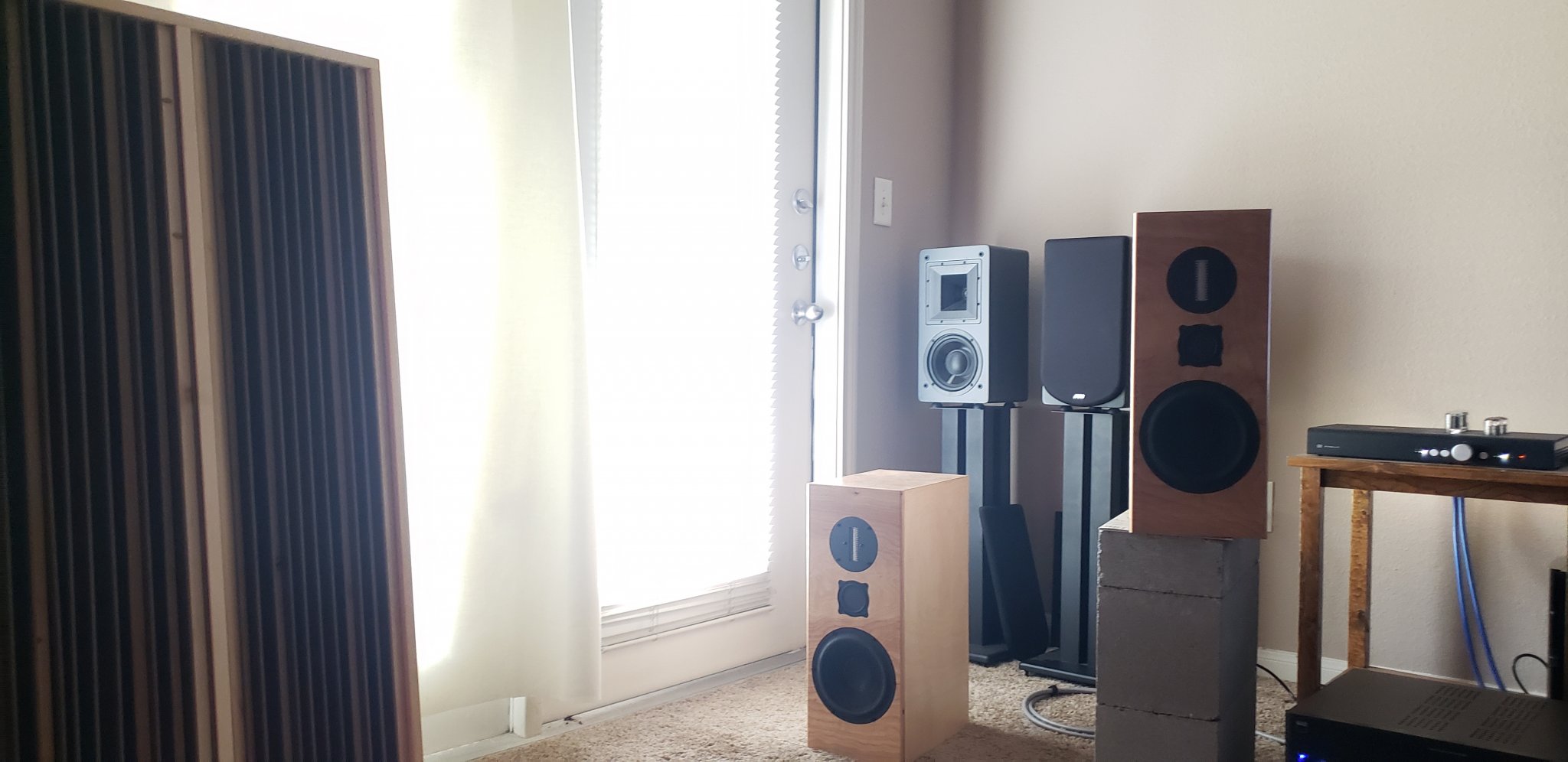

Here's what I'm expecting my BMRs to look like. I preferred the look of towers to monitors on stands for this project, so I explored using the volume of the "integrated stands" to make the towers slimmer and not package as much air. However, when I posted on the AVS forum I was cautioned that the elongated aspect ratio would change the box tuning.
To my amazement, Dennis contacted Paul Kittinger, who generated ML TL parameters that are optimized for this very different enclosure shape! Incredible that they would take the time to support my one-off variant of the highly refined BMR.
I decided to have some fun exploring high performance concrete, so am intending to create everything but the baffle in a molded form, after which they'll be bonded to the baffle, faired and painted. They're intended to be 40.25" high, 10" deep to the back of the oval, and use the standard 8" baffle width. I haven't decided on the foot/plinth treatment yet... working out how to have them on small casters for easier movement. Using a 3/4" wall in GFRC puts the concrete shell currently at about 55 lbs, so probably 75-80 for the whole speaker.
Sure thing, happy to help! If a duplicate of the template is more useful i can do that. Send me a PM when your ready and we can work it out.Wow, what a kind and generous offer! Let me see how my design develops--a duplicate of your templates could be very helpful.
I really like where your going with the build, i will be following. Im interested to learn along the way how you make the concrete forms (many pictures please haha). Concrete isnt something ive had the chance to work with yet, Im always in envy seeing builds with this material and the bmr's are going to look amazing as a floor stander. I nearly made mine with built in stands to hold the crossover, i wish i had.
Thats awesome Dennis and Paul were able to help you out with design. I also had a positive experience with Dennis during my build.

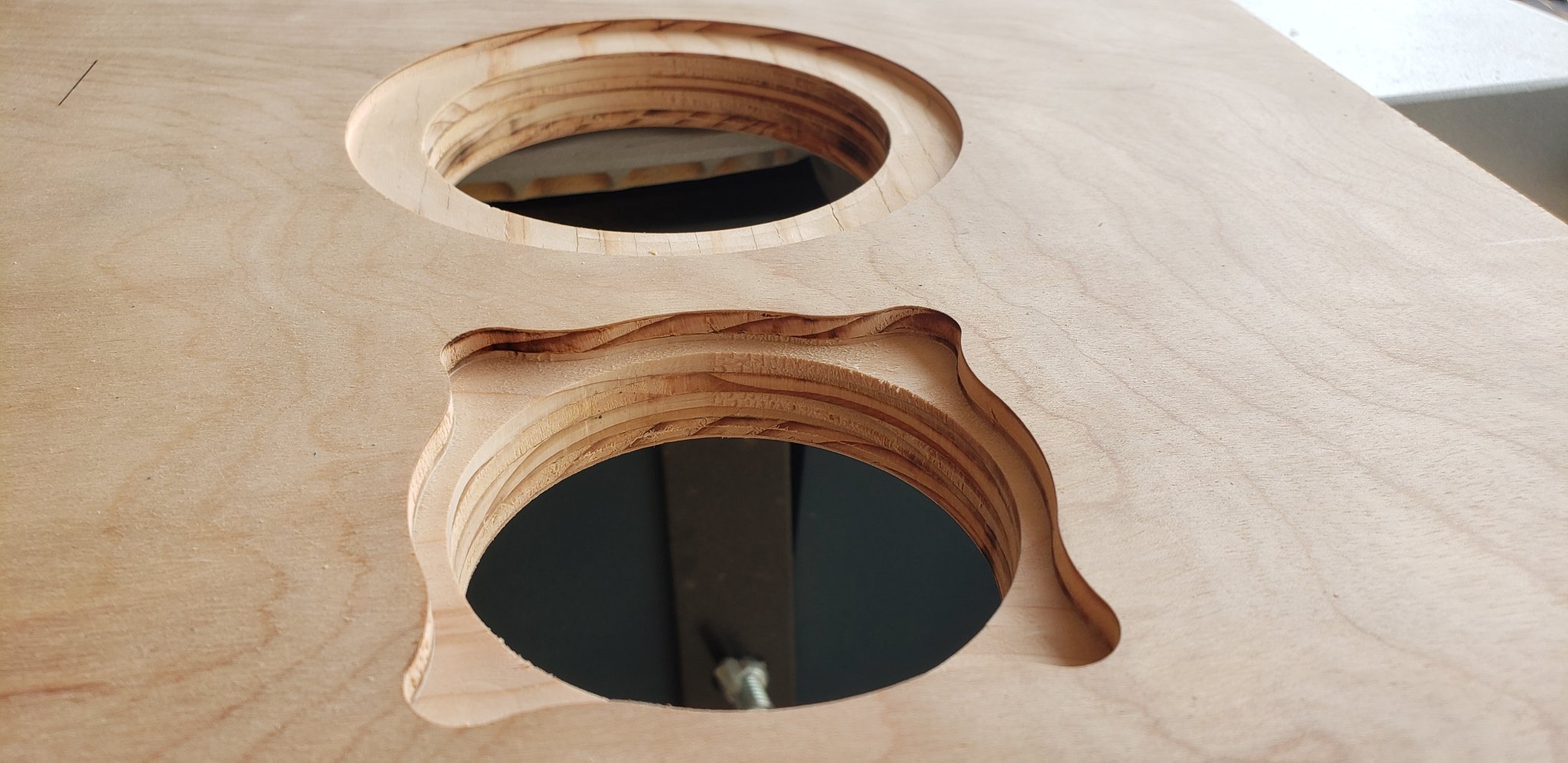

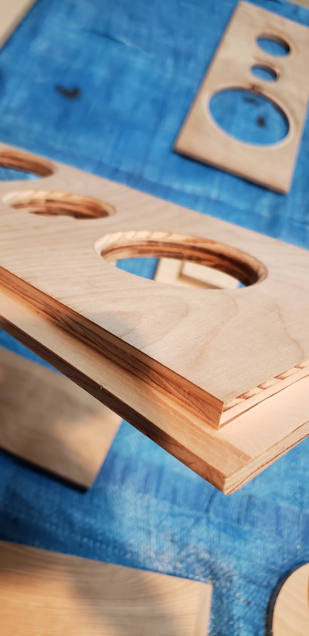

Attached is my BMR routing template. It includes alignment marks. Use a 1/4" spiral bit with a 5/16" template bushing. Attach with double-sided tape or a finish nailer. Do a test cut before you cut your actual speaker. Let me know if you have an issue.

Doing a test cut first! Always an excellent idea. 🙂 The 5/16" template bushing means that the routing template is 1/32" oversized, as it were?Attached is my BMR routing template. It includes alignment marks. Use a 1/4" spiral bit with a 5/16" template bushing. Attach with double-sided tape or a finish nailer. Do a test cut before you cut your actual speaker. Let me know if you have an issue.
The project so far is going... like a project. So, I'll need to route a bunch of identical forms for the concrete mold... say, I never did mount that router plate in the wing of my table saw... wait where the heck Is the plate (add 30 minutes of searching)... need some scrap wood the same thickness... this one's perfect but too short... that one's long enough but slightly uneven... run it through the jointer... small knot flies out of the guide surface... etc.
Correct
