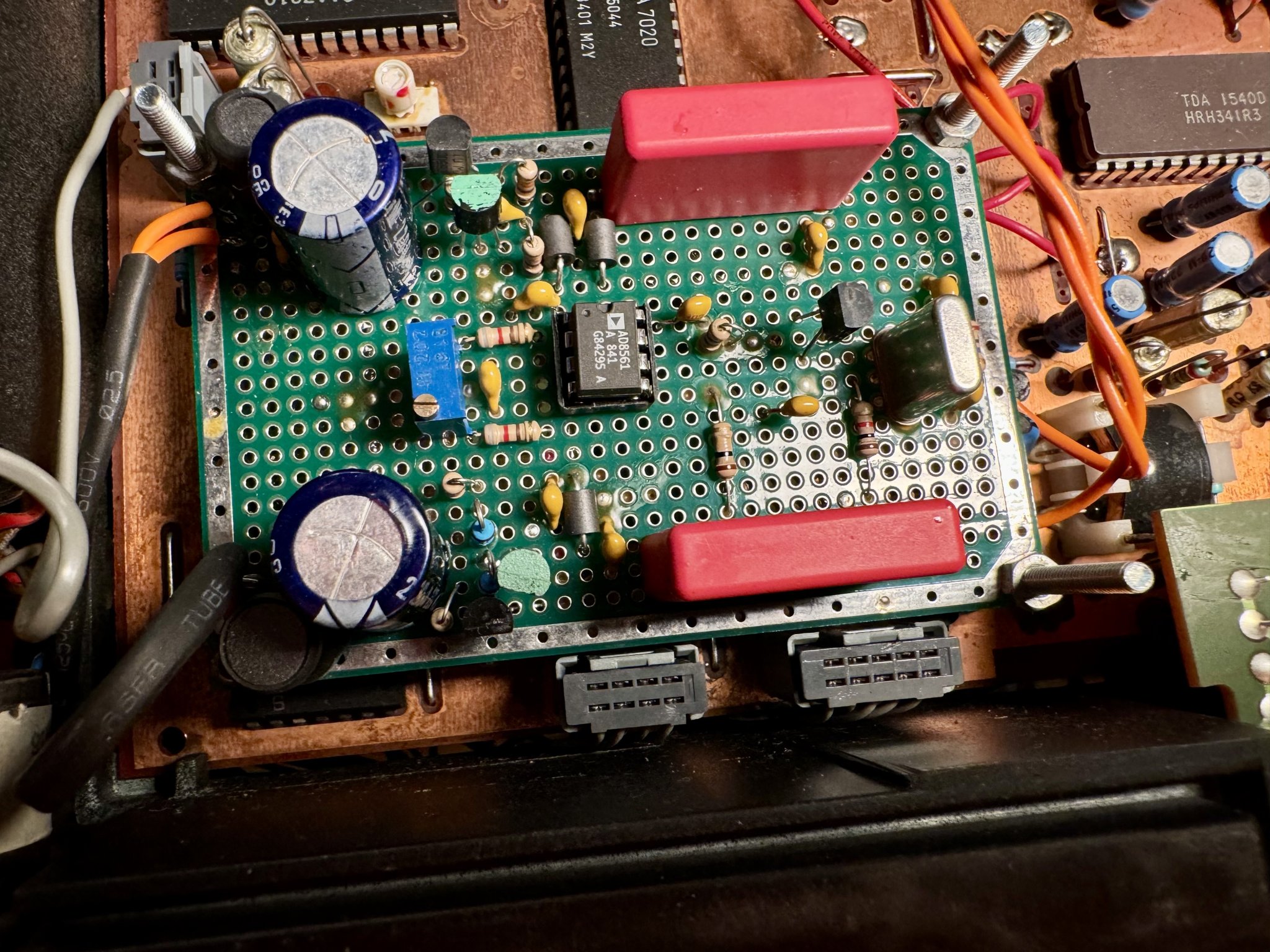

I installed a Kwak clock and replaced some electrolytic caps with Oscons.

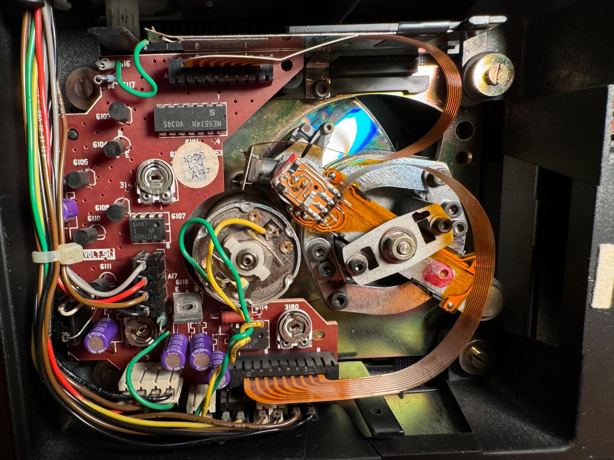

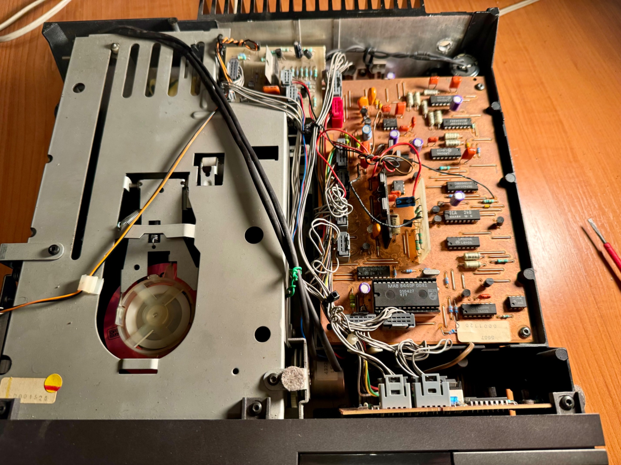

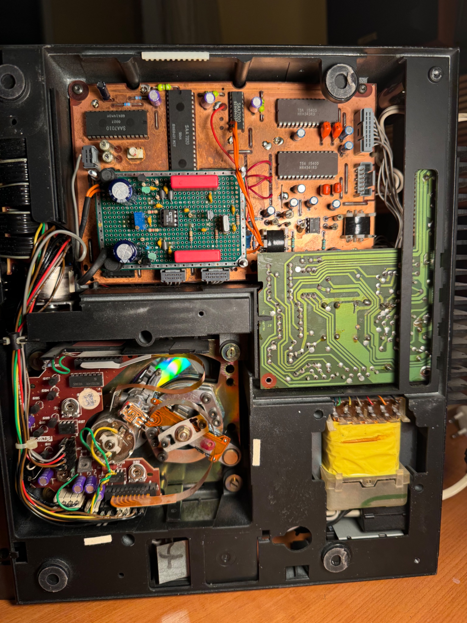

I have a CD104 here with a few problems. From least to worst:
  • when ejecting the tray, the motor keeps running for a few seconds more even after the tray is fully out.
  • the player can only play back discs for a short while. Once it "warms up", it becomes unable to read the discs. If I let it sit for a while, then on the next try it will read the TOC fine and play back discs for as much as 5-10 minutes. But once it is warmed up, it becomes progressively more blind, eventually reaching the point where it just doesn't play anything or even show the TOC.
Also, seeking (searching) seems to be pretty slow too.
- there is no audio output on the RCA jacks. The cables have proper continuity so something else must be broken before the output phase.
The unit seems to have no visible faults, I can't spot any dry solder joints or corrosion anywhere. The only other problem I had is the CDM1 laser board having an extra PCB which is held in place by legs only, and of course it fell out while testing... I soldered the extra PCB together with the legs holding it to prevent this. This made no difference in functionality.
I've done a near full recap on the system since, the only caps I didn't replace were a single one on the front panel (largely irrelevant, the inputs all function correctly) and all the ones on the CDM1 laser board (the board that has the two ribbon connectors on it) due to running out of the correct type caps. But every cap on the power, servo and decoder boards have been changed to brand new ones. Unfortunately, this made zero difference.
I've tried checking the TDA1540s and they both seem to get the same voltage inputs/outputs. The reed relays seem to function in as much that they show no continuity when the unit is off, but they show continuity when the unit is powered.
Could anyone help me with where I should begin looking for problems? I don't own a scope to check any waveforms, only a decent multimeter.

The small board fell out because I poked it, because I've never seen a sub board connected like that. It was only held in place by the little connectors clinging into it like claws. From the few pics I've seen, this board standard on the CDM1.

Replaced the remaining caps on the CDM1 board. Now the player can search/fast forward very quickly and even search backwards as well. It also reads the TOC immediately. So this improved the CD reading behavior considerably.

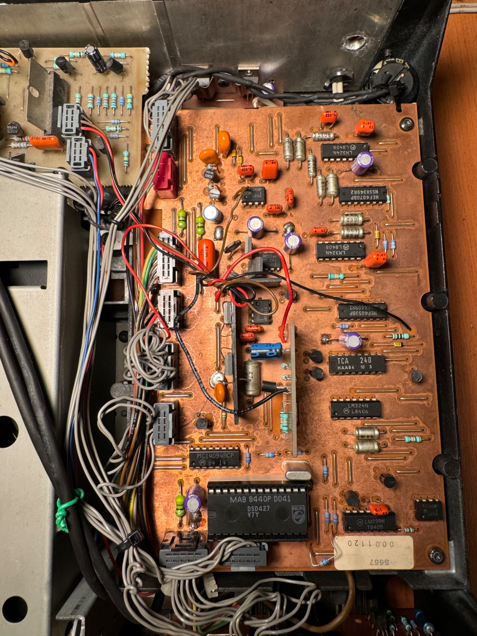

I've measured all the voltage regulators on the power board. Their output voltages are all fine, within a few % of the values listed in the service manual (for ex. -18V measured as -17.7V). The -31.5V measured as -34V but that's an input voltage and the output was correct.
Next I left the player running and then touched each IC for heat. Most got barely warm, but the SAA7010 and SAA7020 were hot enough to burn my finger. I tested some heatsinks and found that when I put a heatsink on the SAA7010, the player is be able to play for much, much longer. Additionally the SAA7020 doesn't heat up so much either as long as the SAA7010 has a sink on it, and the player can switch tracks faster as well.
I have not glued the heatsink on so far, only let it held by gravity while the player is upside down, so the heat transfer may not be the best. Once the heatsink heats up, the player once again stalls. I was rotating two heatsinks to keep the chip "cool" and it has been going on for nearly an hour this way.
So my hunch was right, a chip is overheating. But, why?
SAA7010 pin 15 and pin 28 correctly measure as +12V and +5V respectively. Pin 22 correctly measures as 4.3218 MHz (or thereabouts, it fluctuates a bit, but I'm reading it with a multimeter).
other measurements:
pin 6 - 5V - service manual says 4.7V
pin 7 & 8 - 1.38V - service manual mentions 1.8V for these both.
pin 12 - 3.73V- service manual mentions 4.6V
pin 13 - 3.64V - service manual mentions 4.6V
pin 17 - 3.5V - service manual mentions 2.4V
pin 18 - 4.45V - service manual mentions 5.1V
Additionally there's a component marked as 2501 on the manual (with a value of 22n, not sure what it is). If I do as much as touch the upper lead of it in any way - finger, multimeter, anything - the player nearly immediately stops playing. Tilting it while touching the outer cylinder won't do this, so probably not a bad joint, but even the most gentle contact with the lead will make the player drop out of playing.
