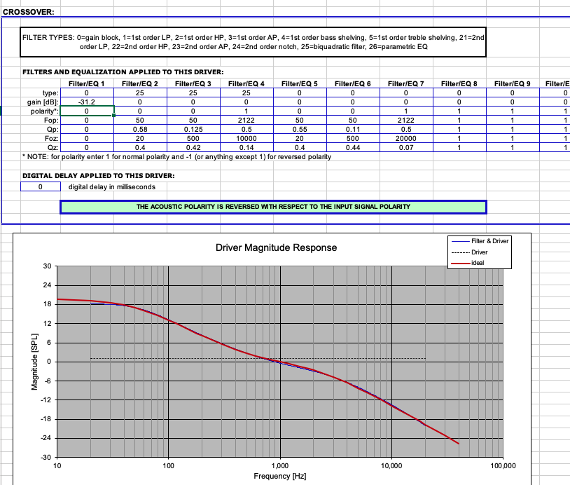

Folks, here is a retrospective on all of this. I have demonstrated how to implement an RIAA EQ correction curve using my ACDf IIR filter LADSPA plugin. It's practical, more than satisfactory, and provides some adjustability to suit one's listening preferences at several frequencies. Now it seems that some folks think it is important to be within a tenth of a dB and with a few degrees of some "perfect" EQ curve. Fine. But I'm not really all that concerned with this level of accuracy here. Who knows if the recording, on the disc, is faithful to such a fine tolerance anyway.
I will explain how I came to the EQ curve (apart from what I explained in post #1 of this thread). The 1kHz level is at 0 dB. Below there is a first order rise. I can implement this using my ACDf plugin (also works for miniDSP) as a first order "bass shelf". There is 20dB of boost below the shelf. The center frequency of the shelf is the geometric mean of the limiting frequencies. In this case, the boost runs between 50Hz and 500Hz, and the geometric mean is 158.114 Hz. Initially I did the correction by eye and came up with 155 Hz, so pretty close. The other correction occurs above 2.1kHz, and has a slope of -6dB/oct. I implemented this using a first order lowpass filter. Again, close enough for me. I have read about additional minor corrections where this flattens again at some frequency like 50kHz. There are two reasons why I would not bother with this: (1) It's too high in frequency to have anything but a very minor impact of the phase response above 10kHz, and (2) with digital EQ, as I mentioned in the first post, there is a zero at the Nyquist frequency. You cannot place a zero higher in frequency or do anything up there for that matter. For 96kHz, Nyquist is at 48kHz so you are more or less constrained by the sampling rate. Sure you can use some ridiculously high rate like 196k or higher, but really folks... this is more than splitting hairs IMHO. I would be happy explain how it can be done using another shelf instead of a 1st order LP if someone would like to try it.
With only those two corrections, the EQ curve only loosely follows the EQ target. But perhaps that is the kind of correction that was used by the record companies... and is therefore the one to use. I really don't know. The EQ can be brought closer to the target using the PEQ bands that I specified in post #1. By choosing the PEQ gain anywhere between 0dB (no correction) and 2.5dB (full correction) you can bring in the curve at the inflection points to suit your own taste, feeling, sense, etc.
If anyone wants to engage in a productive discussion about this EQ scheme, how to implement it or tweak/improve it, I am happy to engage.

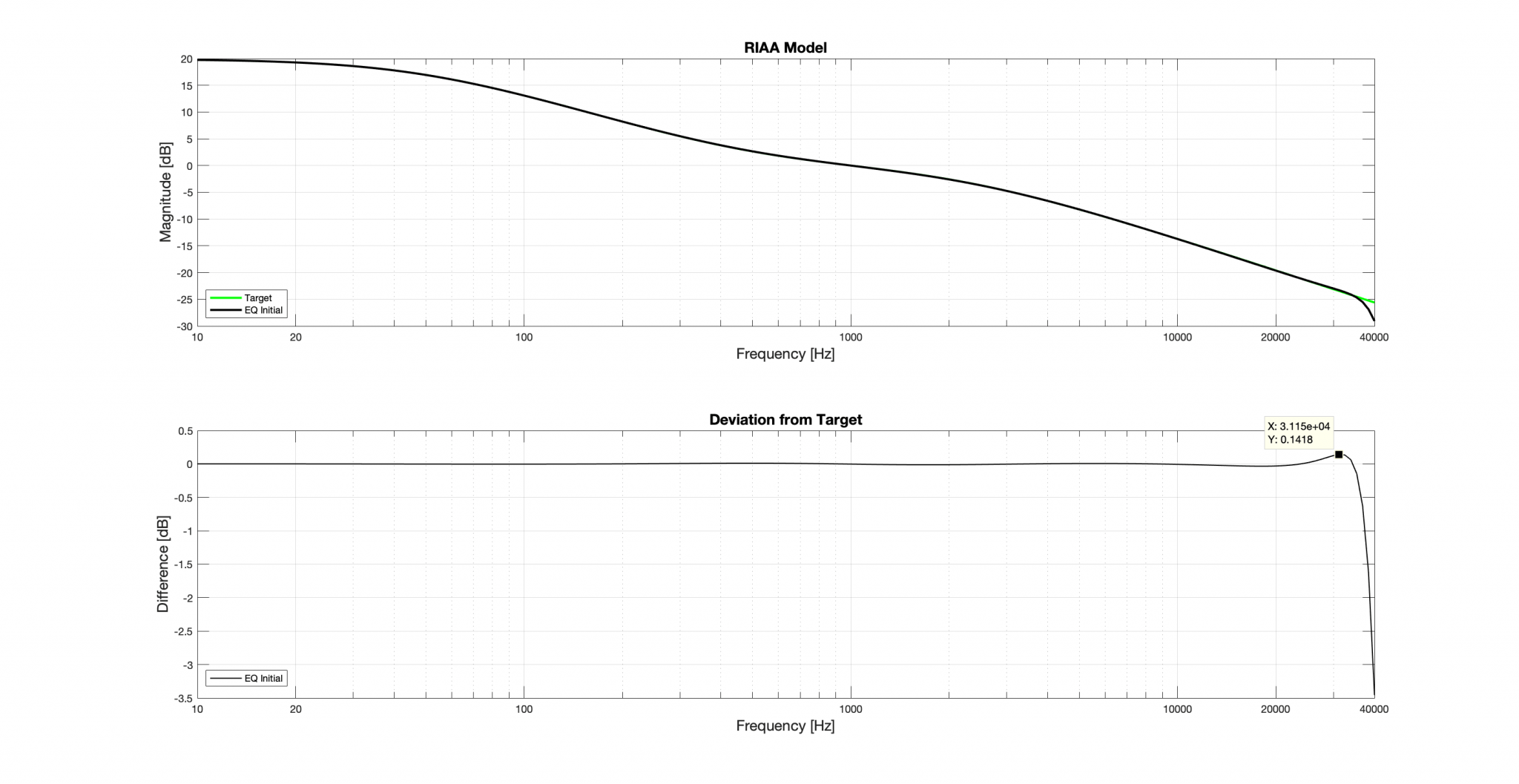

Managed to get a reasonable looking curve with 3 biquad filters. This gets me within 1/2db after 30hz (a flatter low frequency curve makes more sense to me)
There are probably more ways to do this, but this is what I thought of. If you're using ACDf, you have to update the sample rate, otherwise Nyquist steps in and rolls off frequencies above 10k.

I think you made a slight mistake in ACD with the driver FRD data. In your plot the SPL of the driver looks to be constant at 1dB. My guess is that you entered something like 1,1,1 and 20000,1,1 for the driver FRD data... With 1 dB of boost built into the fake driver, your EQ curve will be off 1dB in magnitude everywhere, although that is not really a problem at all since you will be using another gain stage from the audio interface.
When you enter fake driver FRD data you probably should enter 0dB and 0 degrees phase angle, e.g. X Hz, 0 dB SPL ,0 degrees and Y Hz, 0 dB SPL ,0 degrees in the FRD data sheet in the driver worksheet. In place of X enter a frequency at or just above the plot minimum, and for Y enter a frequency at or just below the plot maximum.
Otherwise, looks good! And of course you now have the ability to tweak the EQ curve at will.
By the way, where did you get the data for your "Ideal" reference curve?
Good call, an easy fixI think you made a slight mistake in ACD with the driver FRD data. In your plot the SPL of the driver looks to be constant at 1dB. My guess is that you entered something like 1,1,1 and 20000,1,1 for the driver FRD data... With 1 dB of boost built into the fake driver, your EQ curve will be off 1dB in magnitude everywhere, although that is not really a problem at all since you will be using another gain stage from the audio interface.
the reference curve came from the site @henrik linked, HiFi Loudspeaker Design as he actually has numbers that are spreadsheet-able

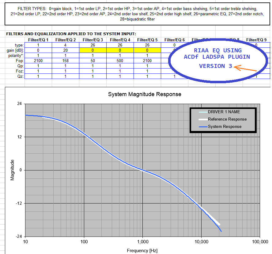

Ah, thanks! Got it. So, using that data, I present the fit I achieved with the filters I listed in the first post, but without the PEQ bands, at a sample rate of 96k Hz. I set the gain of each PEQ stage to 0 dB so that it will have no effect. The only minor change was in the frequency of the low shelf, which I changed from 155 Hz initially to 158 Hz in this version.
Please see the attached plot that compares the two.
I will try to create tabulated values that compare my EQ and the reference one at the link you gave me, and/or plots of the difference between the two. I will have to get to that later tonight.
NOTE I am using version 3 of my LADSPA plugins. These are available at the link in my signatures. There have been a couple of changes since version 2...

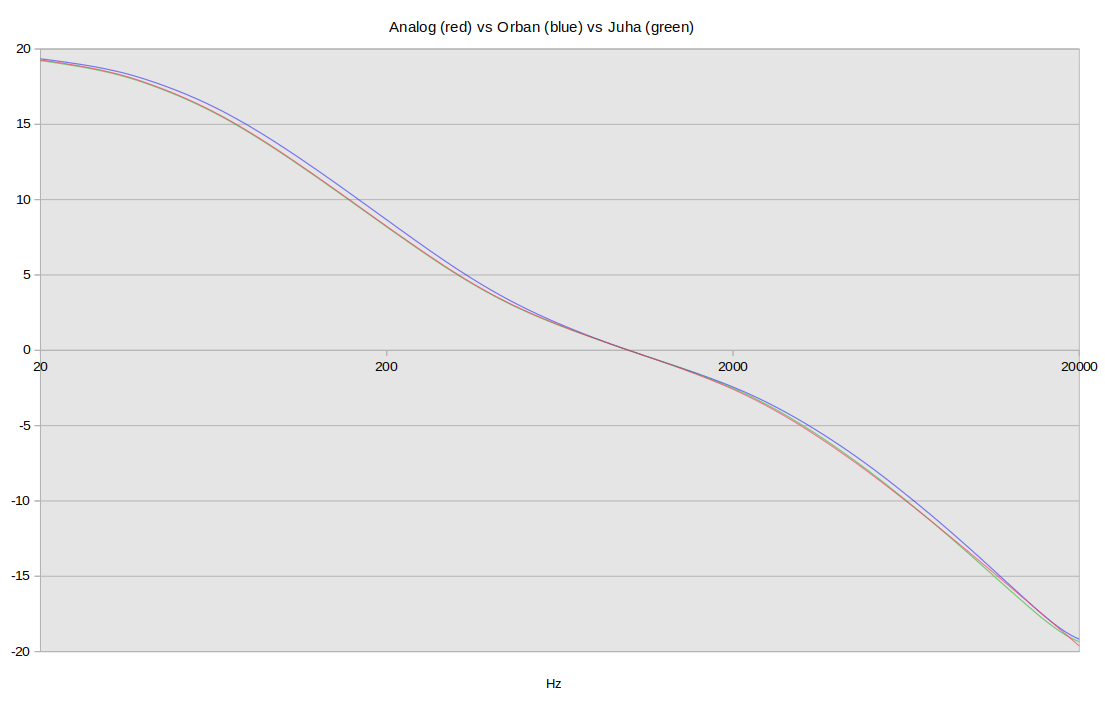

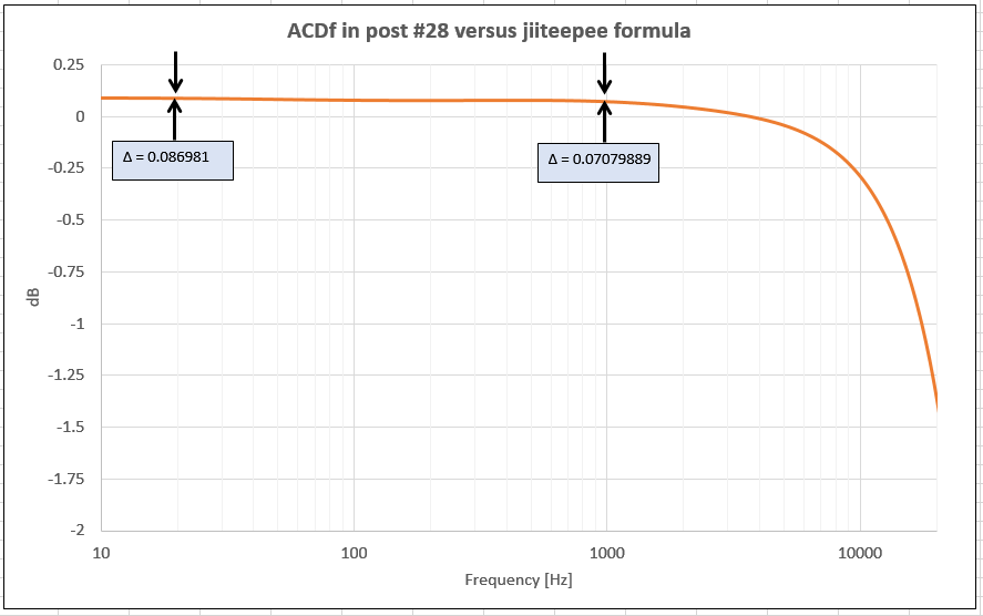

Thanks for that. Comparison attached. If they were the same there would be a flat line at 0dB.
My method includes the low frequency offset that you attempt to zero out with the final term of the formula. I will look into why my response sags at the high end, but at least part of that is due to the zero at the Nyquist frequency I mentioned before.

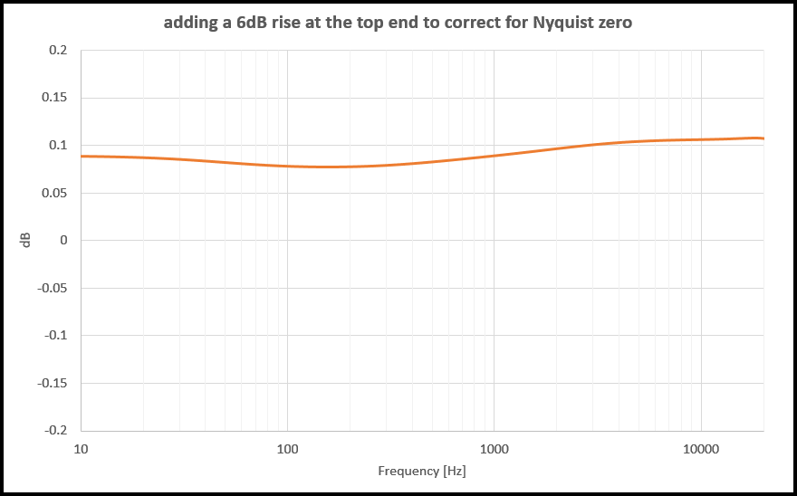

I was able to eliminate the top end rolloff by inserting a 6 dB rise centered above the audio band. This compensates for the zero at the Nyquist frequency within the audio band. See attached plot. The EQ curve now matches within about +/- 0.02 dB. Above the audio band the response rolls off into a notch at the Nyquist frequency.
This is only a solution for ONE sample rate (this is 96kHz). At another sample rate a different 6dB rise would be required because the zero will have changed in frequency. In any case I would not advise using a sample rate less than 96kHz for this application.
That formula is for s-domain filter ....
This error in response comes from transfer method (BLT) related issue and without hard optimization you can fix it by just using high sampling. Orban used Remez Enhanced based approximation, Scott Wurcer some other method.
MZT/IIM has less error in magnitude response but, phase is wrong. In one biquad implementation these methods has one analog coefficient unused so one can improve the response by using this.

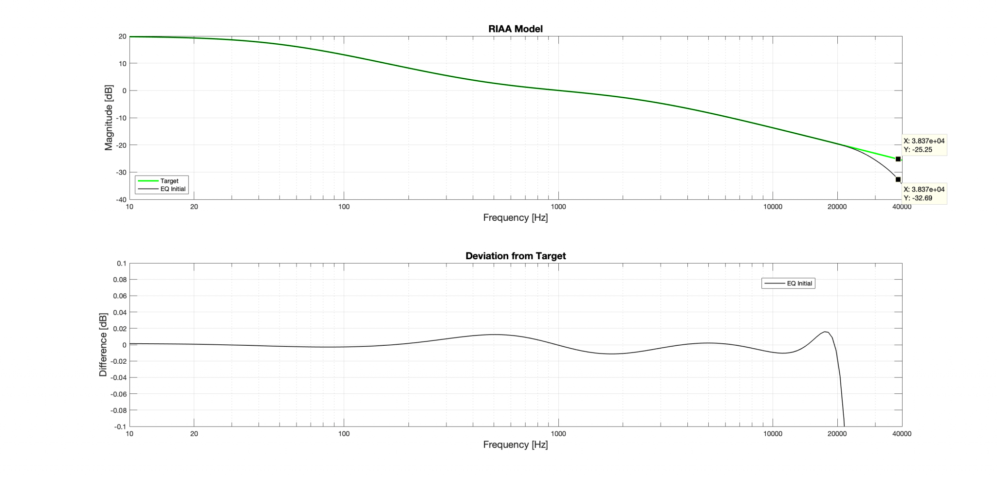

What do you think of that?
Obviously the LF will be different because of the input stage of the DSP.
Target given by the equation given by @jiiteepee optimized fitting with Matlab.
Sampling rate 96kHz higher would be better but it looks like 20kHz is correctly captured.
3 biquads
Gain: 19.9dB
could be implemented with EQ APO: https://sourceforge.net/projects/peace-equalizer-apo-extension/
Filter 1: 1st LowPass Fc 50.00 Hz Gain 0.00 dB Q 0.50
Filter 2: HighShelf Fc 1031.632 Hz Gain 12.570 dB Q 0.467
Filter 3: Peaking Fc 24369.418 Hz Gain 1.645 dB Q 0.817
Edit with extended HF, very close to -3dB@40kHz.

Have you compared the response of the digital 96kHz RIAA filter you vouch for against analog RIAA filter?
By quick test in Octave, looks like Orban/Wurcer 96kHz filter has about 1.45dB error (absolute) against digital model of analog filter @ 45kHz ... (Orban's little (0.0001dB) less than Wurcer's) ... relative error stayed below 0.06dB all the way (1Hz-48kHz) for both filters (as expected).
Filter @ lower sample rates, as like 44.1kHz, just shows better the nature of the error coming from coefficient calculations ... if same method used then shape of the error usually stays in higher sampling but, of course, higher sample rate makes it smaller.
No, I never did that. The frequency response errors from my carts were way bigger than any error in the RIAA filter. I EQd both my analog preamp and later my digital RIAA filter after measuring frequency sweeps with a test record. Any smaller response error in the audible range would get hammered flat anyway.Have you compared the response of the digital 96kHz RIAA filter you vouch for against analog RIAA filter?
My requirement is not "perfectly flat @45kHz" but rather "good enough for CD4 records - so that I can see both FM sidebands left and right of the carrier frequency, roughly equally loud and loud enough to be above the noise floor".
Have you read Scott's article? I can really recommend it, you can get the PDF for €3 from the Linear Audio site. He goes through the entire process of designing the filters, literally "does the math" and includes all the test files and python scripts used as a download on the LA website.
https://linearaudio.net/article-detail/2240 and the downloads are at https://linearaudio.net/downloads. I'm not in any way affiliated with LA or Scott, I just found the books and this one article in particular a really good read.
True, but isn't that why you are supposed to use an IIR filter that is made specifically for the sampling rate you're using?Filter @ lower sample rates, as like 44.1kHz, just shows better the nature of the error coming from coefficient calculations ... if same method used then shape of the error usually stays in higher sampling but, of course, higher sample rate makes it smaller.
