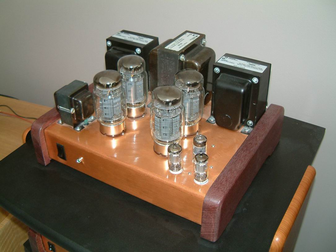

Howdy all! My fourth project.... EF86 triode connected-> 12AU7-> KT88 triode connected PP. No negative feedback. Hammond output and power tranny's. Great forum you have going here...think I'm going to be a regular. Some damn fine looking amps here!

Nice -- is the chassis copper?

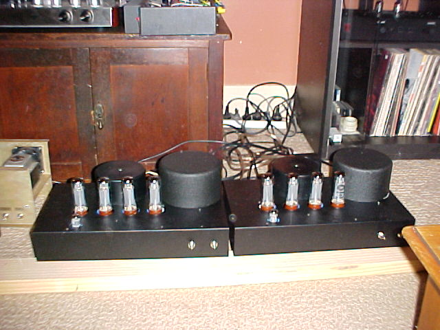

A friend just built some parafeed EL84 monoblocks with triode strapped EF86 -- quite a relevation.

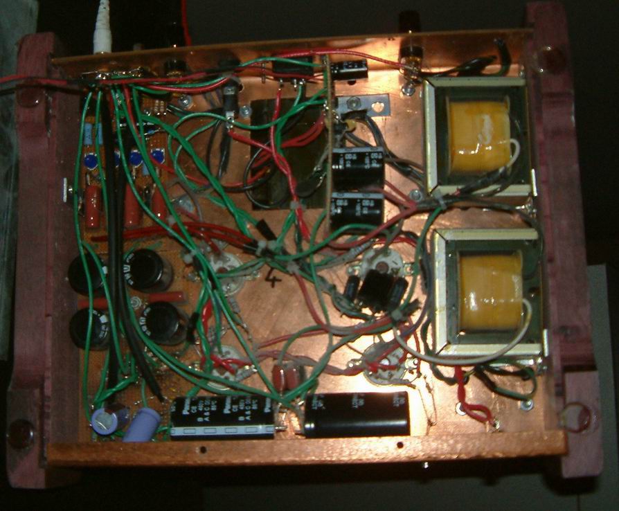

Here's a bottom shot finally! Yes chassie is 12 gauge copper. A sheet
large enough to make two amps cost me $90CND. The guy at the sheet metal shop does the cutting and bending for free. "Anything but another duct!" Kinda messy under the hood, but a lot of tinkering went on. You see 2X4H chokes under there. Overkill, but I had em so......

What's sense of copper cassis ? Past one month it will be dirty black and will be look like textbook of dactyloscopy 😉 . Standard question : Have you in your flat a children ?

It is easy to stop copper from oxidising if you spray it with a clear Laquer.

That amp was built 4 years ago....sprayed it with clear laquer...havn't had to do more than dust it! (Occationally) Copper is really easy to work with. UMMMM...let's see....Hummmm...I thought it would look pretty cool at the time too.

Hi Mel, do you use the copper chassis as part of the circuit? If so, how are electrical connections to it made?
