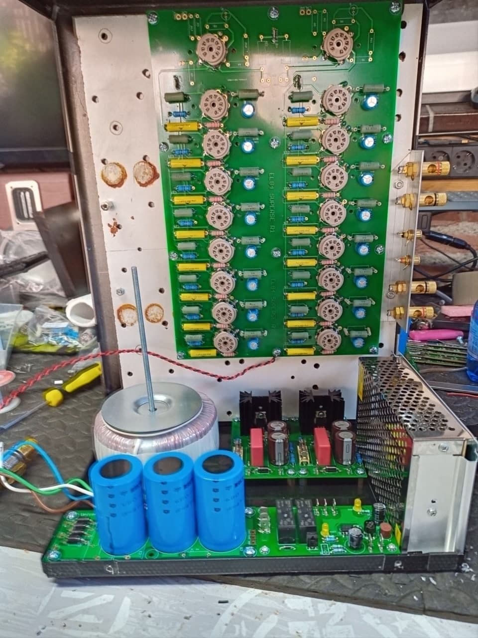

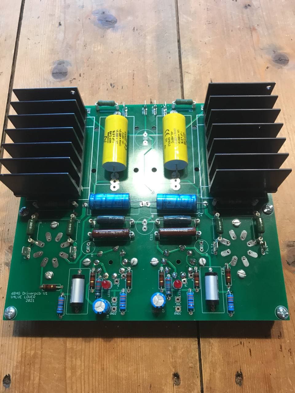

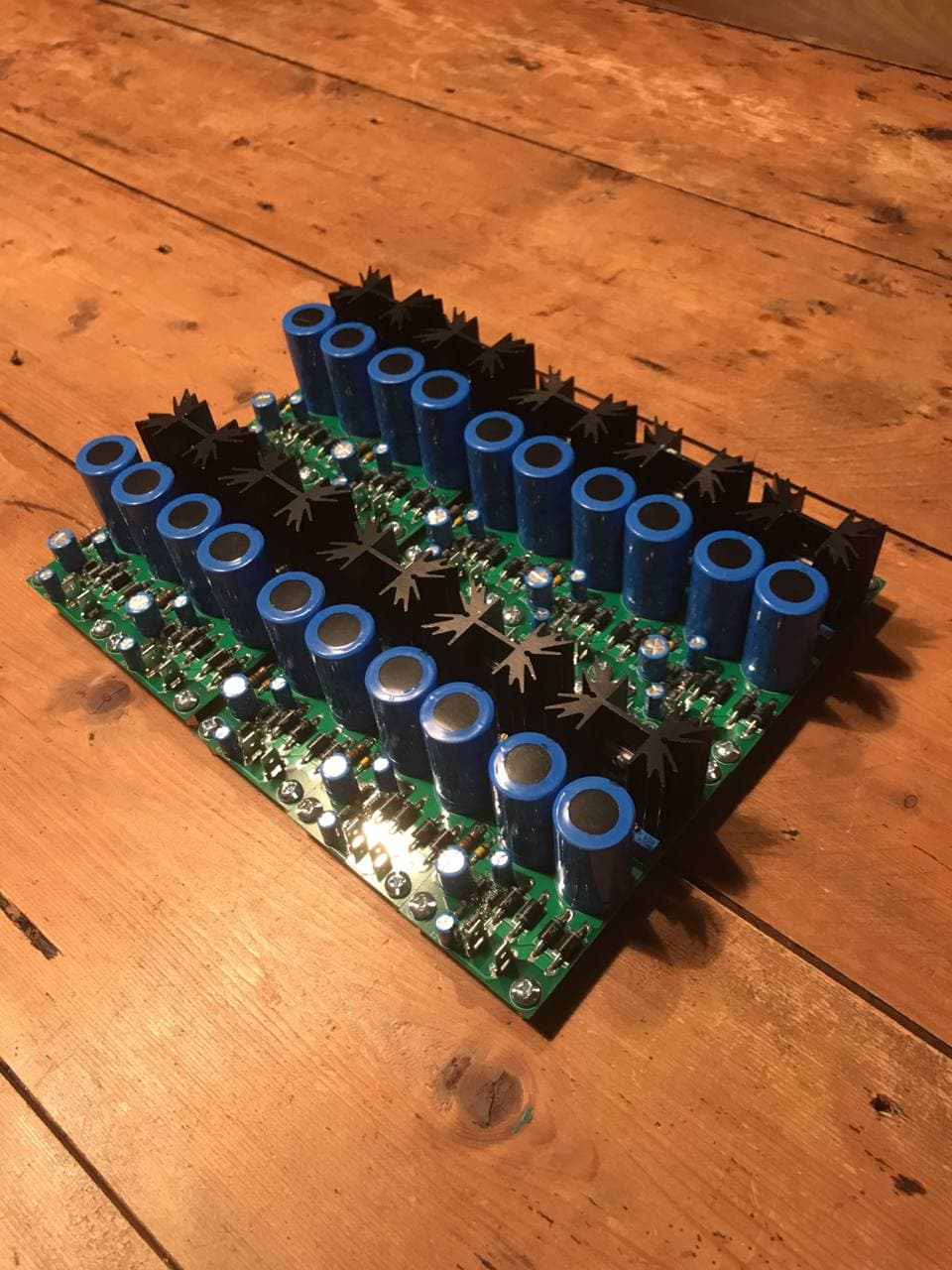

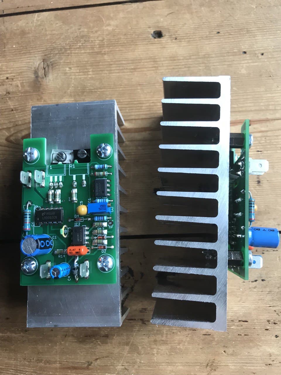

Photo dump, no amps just PCB's
Heres some Photo's from this years FR4 harvest.
No context just epoxy resin fibeglass.
