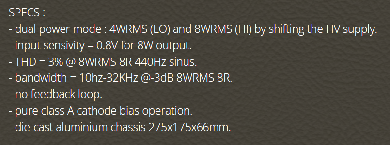

Oh, I certainly posted it already 😏... My U-300B, but with more details this time 😉 :
2000-2010 = ten years during it was tested satisfactorily as a prototype :
Then in 2010, I ended to build the pair od mono blocks definitively :
Using Hammond 1550J die-cast aluminium enclosures as chassis :
Drawing then drilling : drill press, jigsaw & GreenLee
Assembly :
Wiring & Layout :
Finished :
Still operational today, flawlessly... 😎

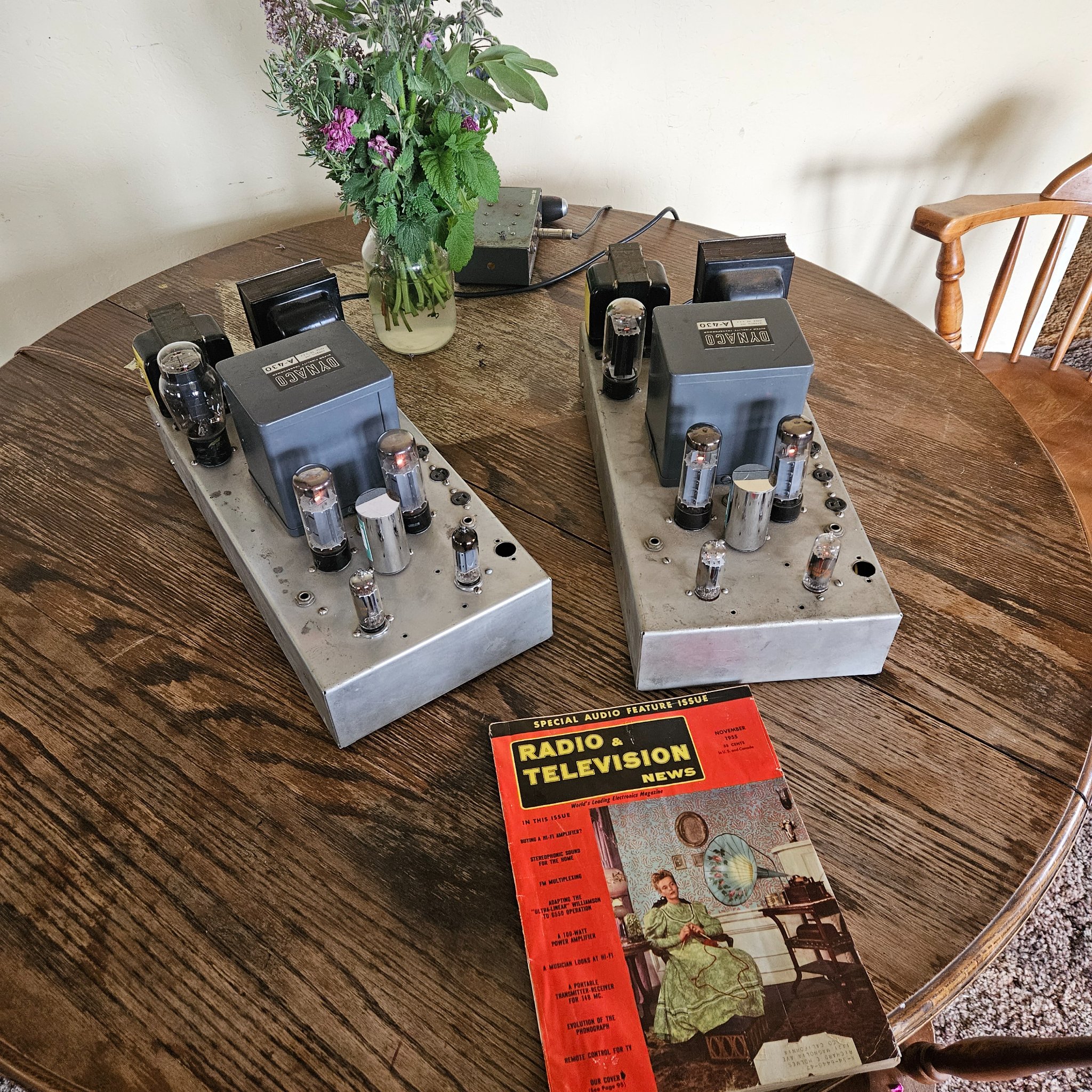

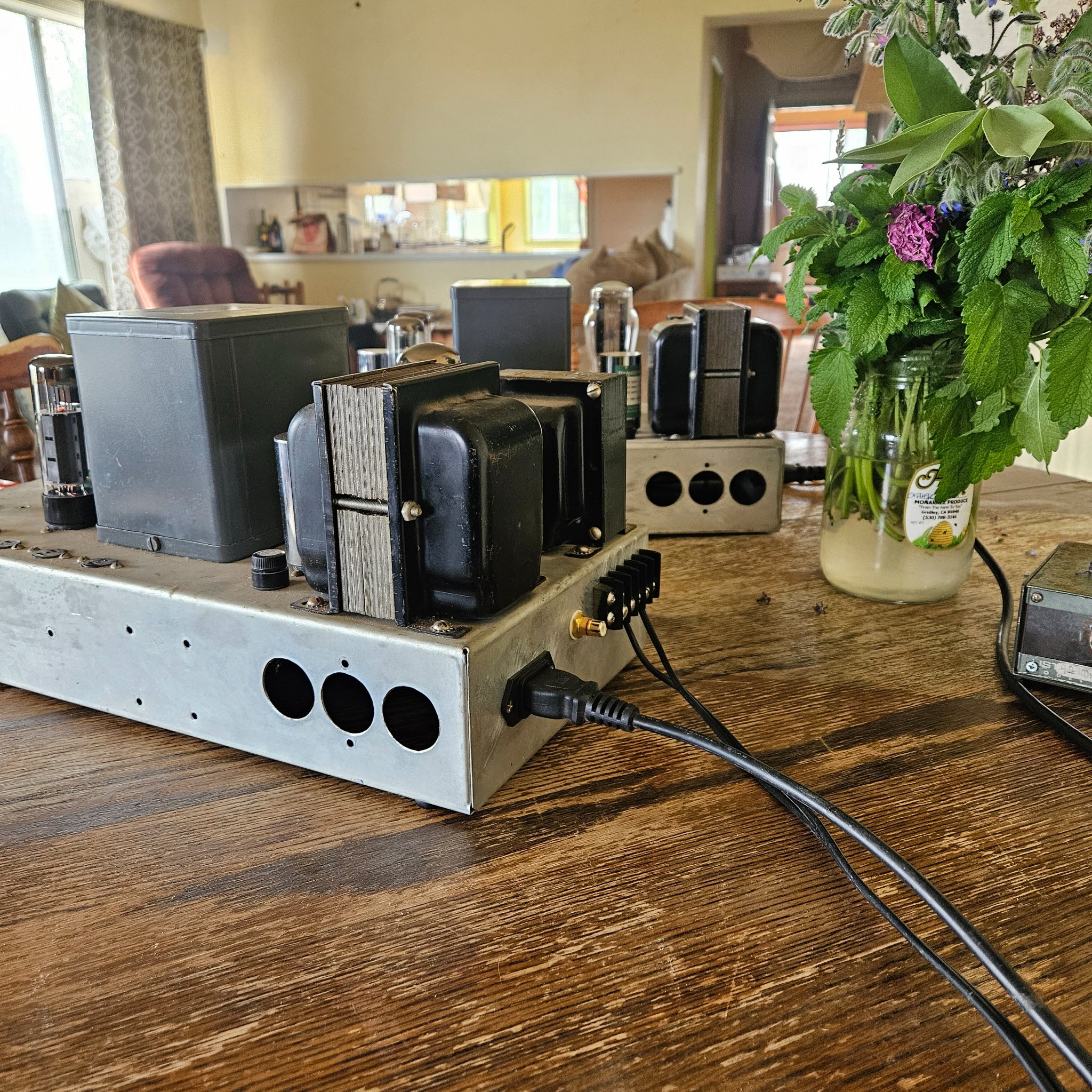

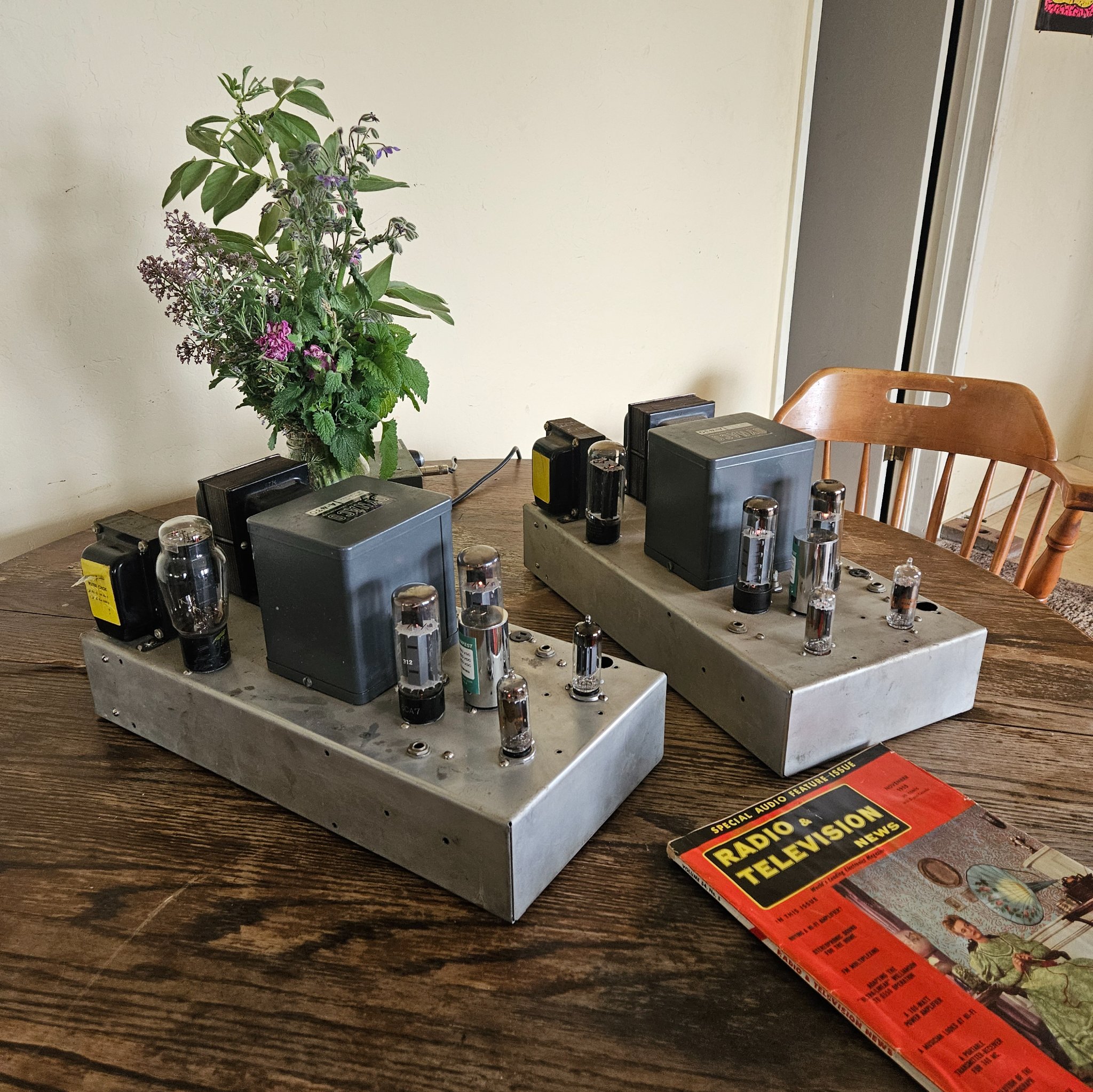

Someone else's DIY effort that I cleaned up and made work. Wired as a Williamson it actually sounds really good.
(Original builder is long dead, I bought them from an old hifi shop which is long since closed)
They make an honest 35 watts and sound pretty darn good doing so.
Could use some attention on the input, or perhaps more feedback.
An amp like this could be tweaked on indefinitely or just enjoyed.
I chose to enjoy it.

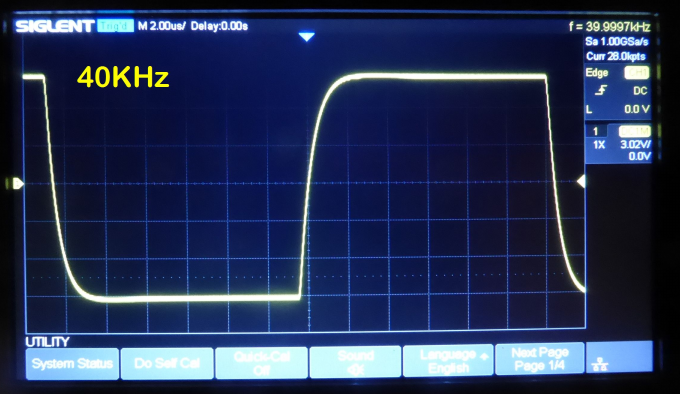

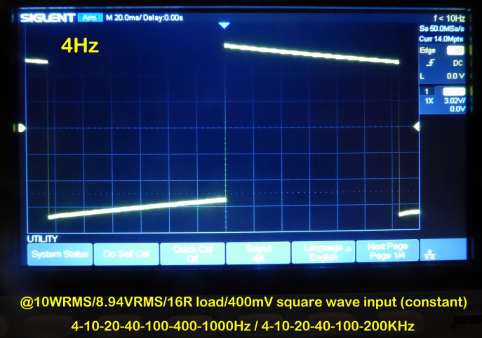

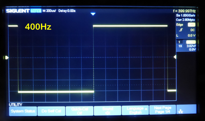

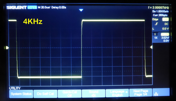

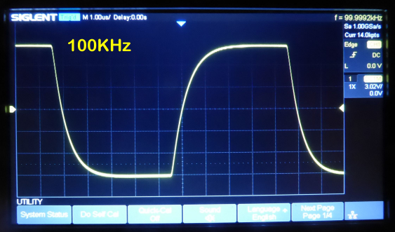

I called them "Ultimate 300B" because... I lagged 10 years before building them, nothing else ! Or rather because of their compactness, but not for their performance - which is correct and as expected (below), but the output transformer, while good, is not an "ultimate" one...
I'd say that my U-300B have the sound of a good 300B, but nothing exceptional, or "Ultimate", due to the output transformer.
