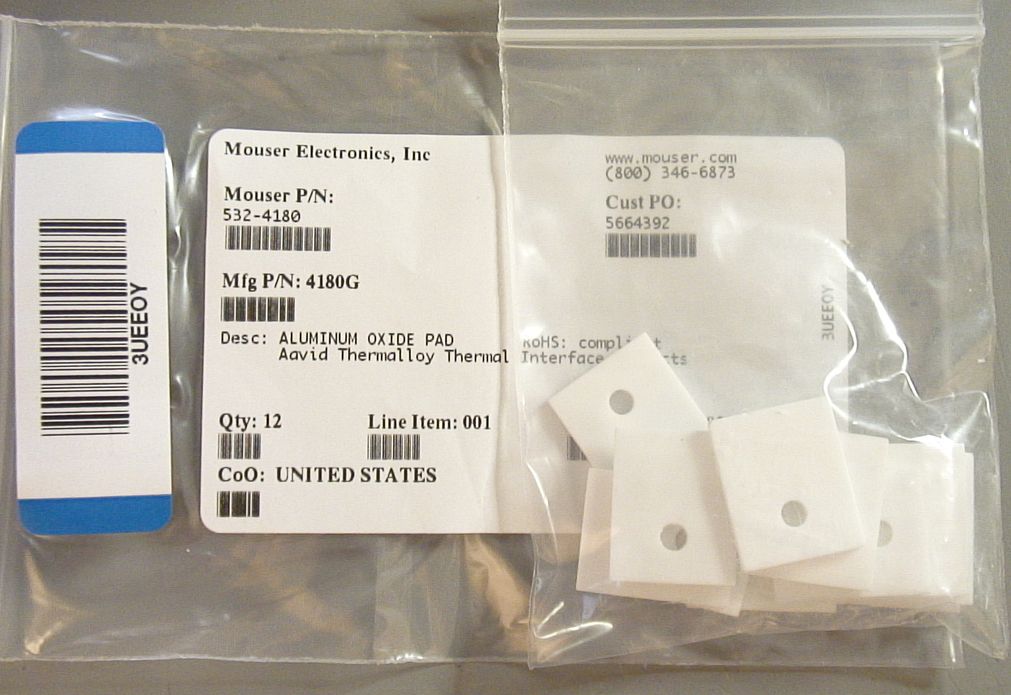

I actually have 12 of the Thermalloy pads for my discrete amp, but I haven't used them as I thought I'd screwed up my online order. Was also under the impression the thickness would inhibit heat transfer. Are those in the link clean or did you add a compound?
They require goop.
As shown in Patrick's article, thermal conductivity of Aluminum Oxyde is really good, but the insulator thickness seriously drops that advantage.
Back in the mid '80s I bought 4.5mm AlOx insulators, pretty useless compared to mica.
Advantage then was that they could be used over and over again, big plus if one hasn't finished a project and already coming up with the next. (as neat as braided hose with fast connectors, to someone into boats and cars)
In time, they became thinner, the Aavid ThermAlloys of the Krell thread do better than mica, also better than e.g. trendy Bergquist ceramics filled sheet items at the time.

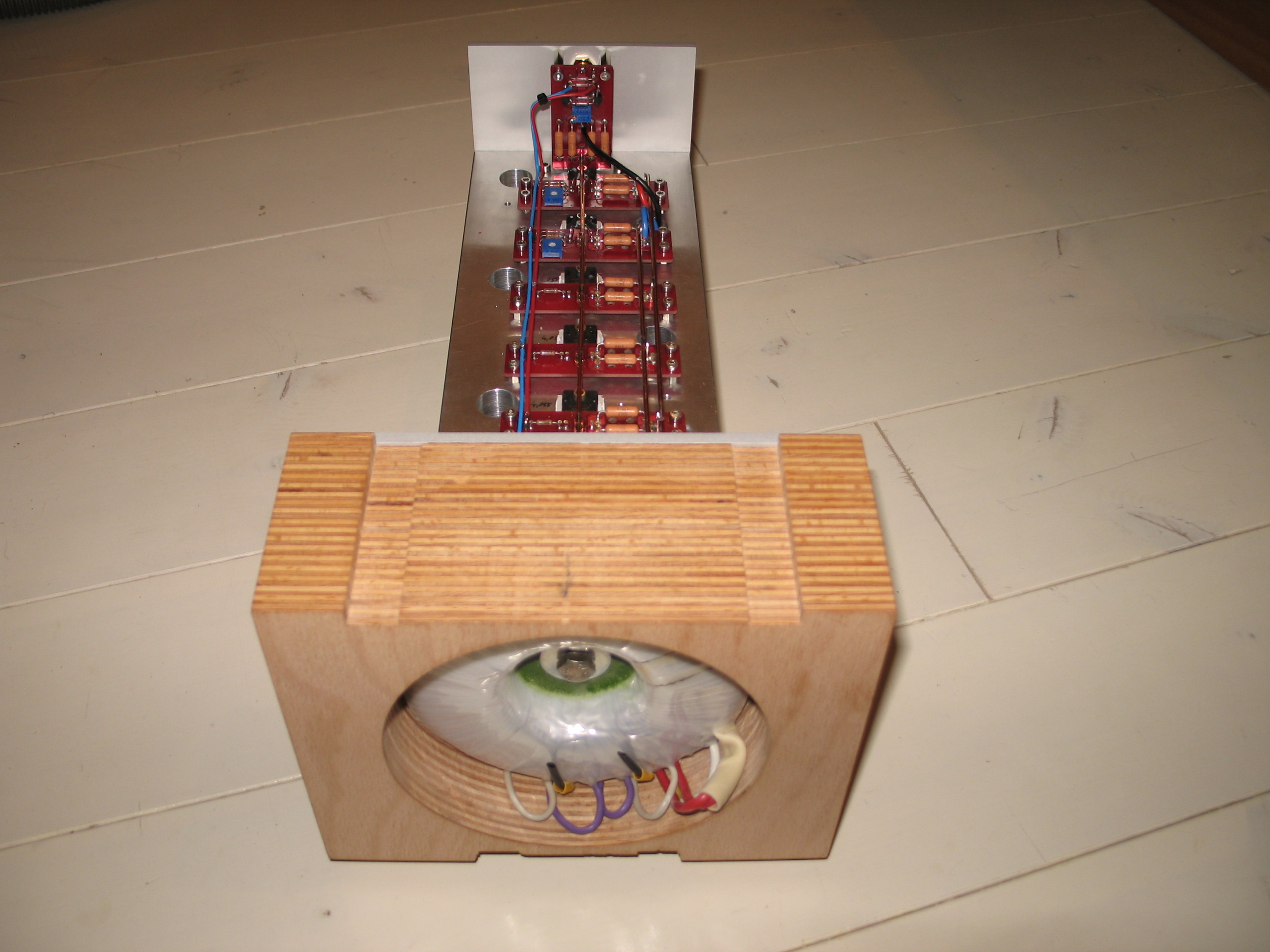

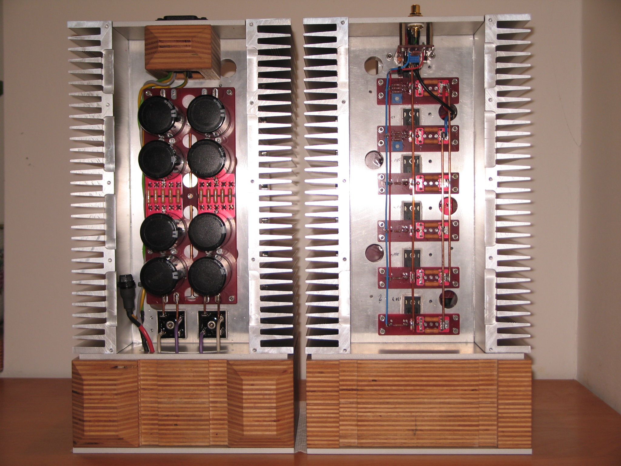

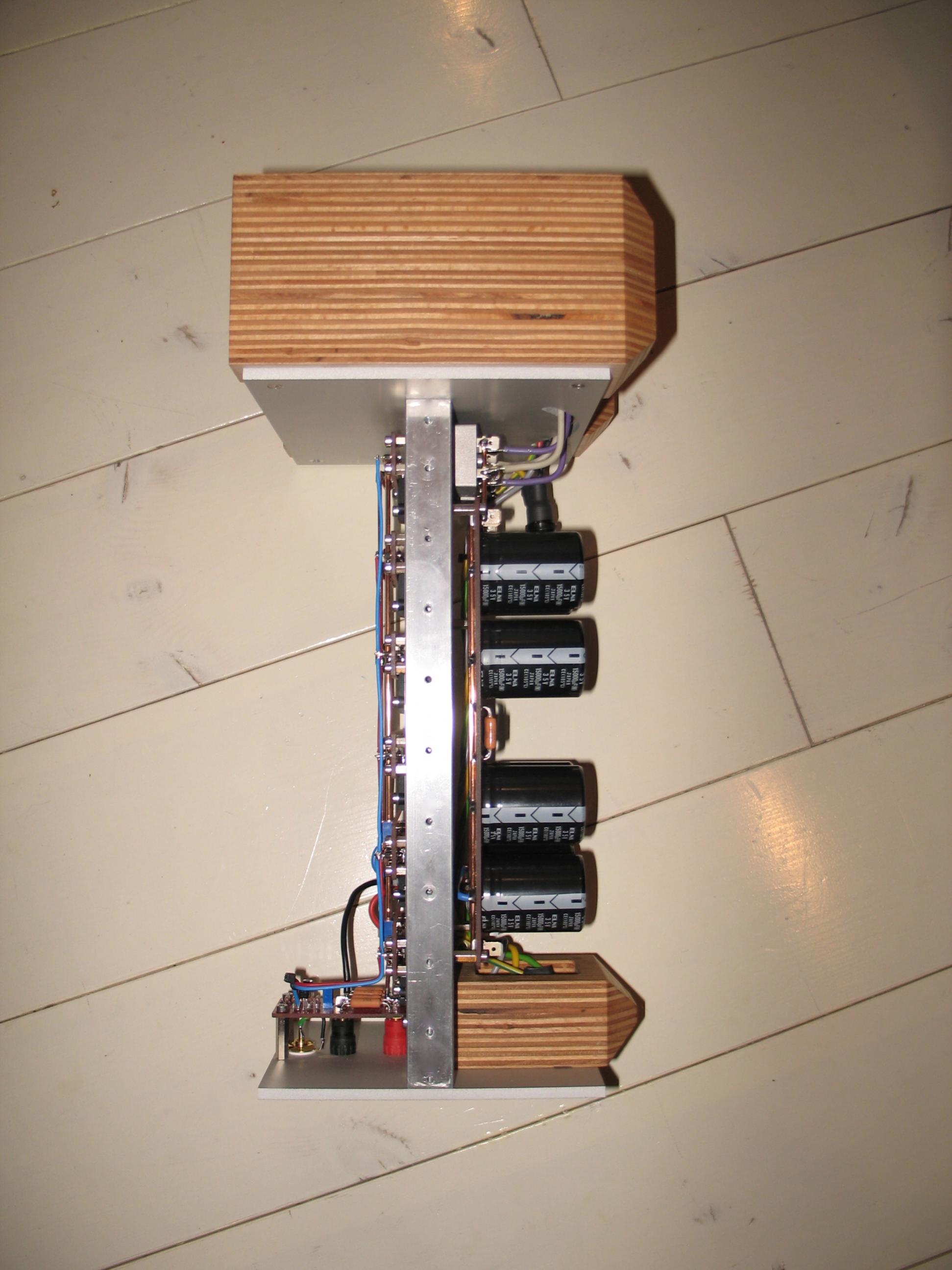

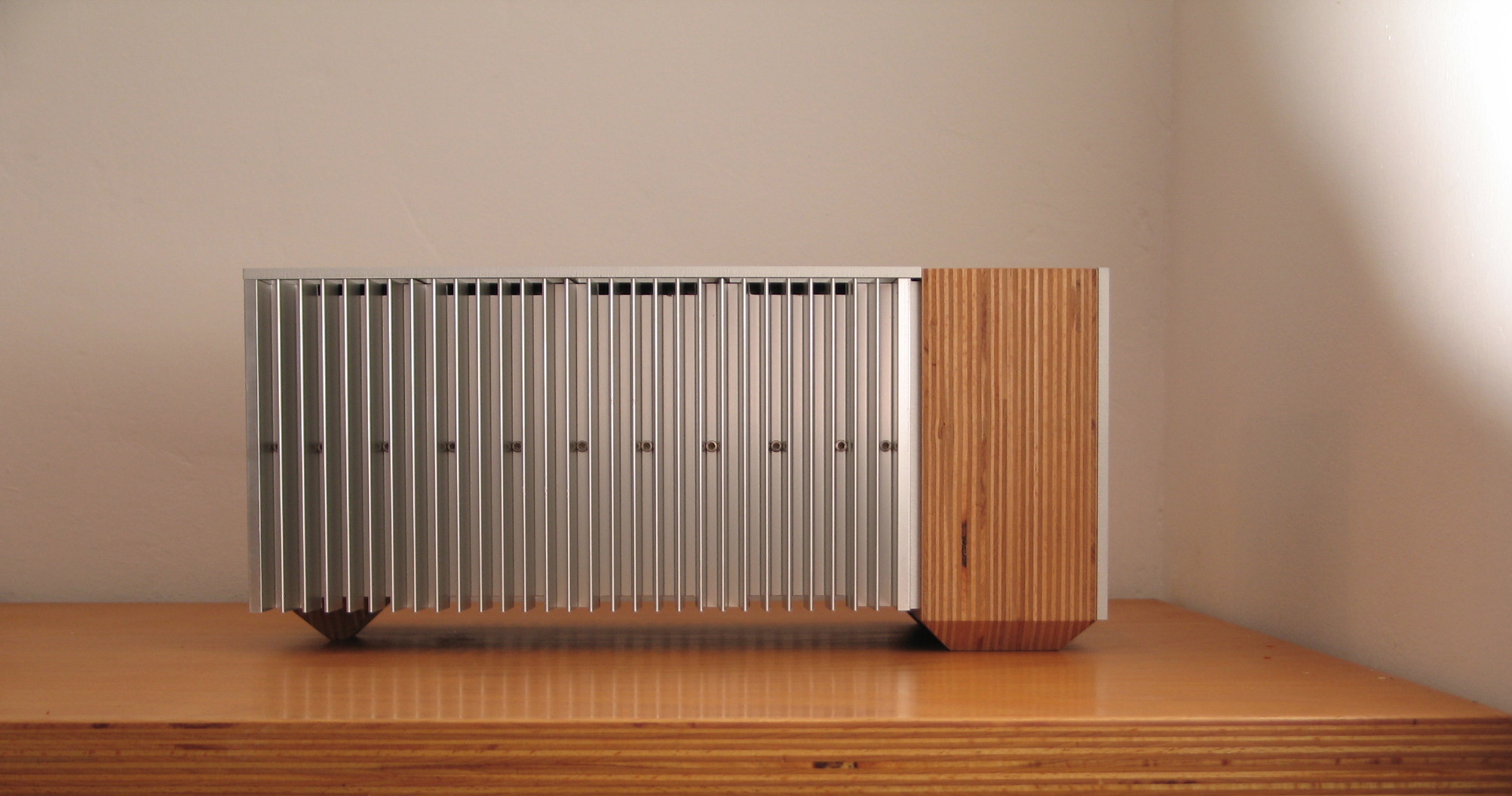

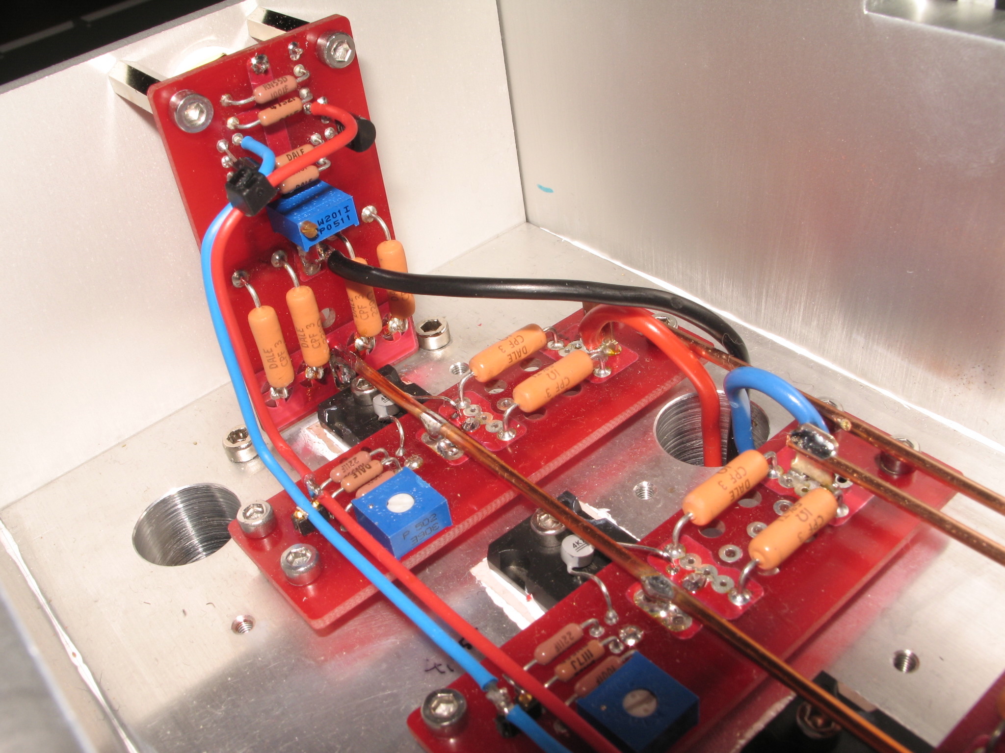

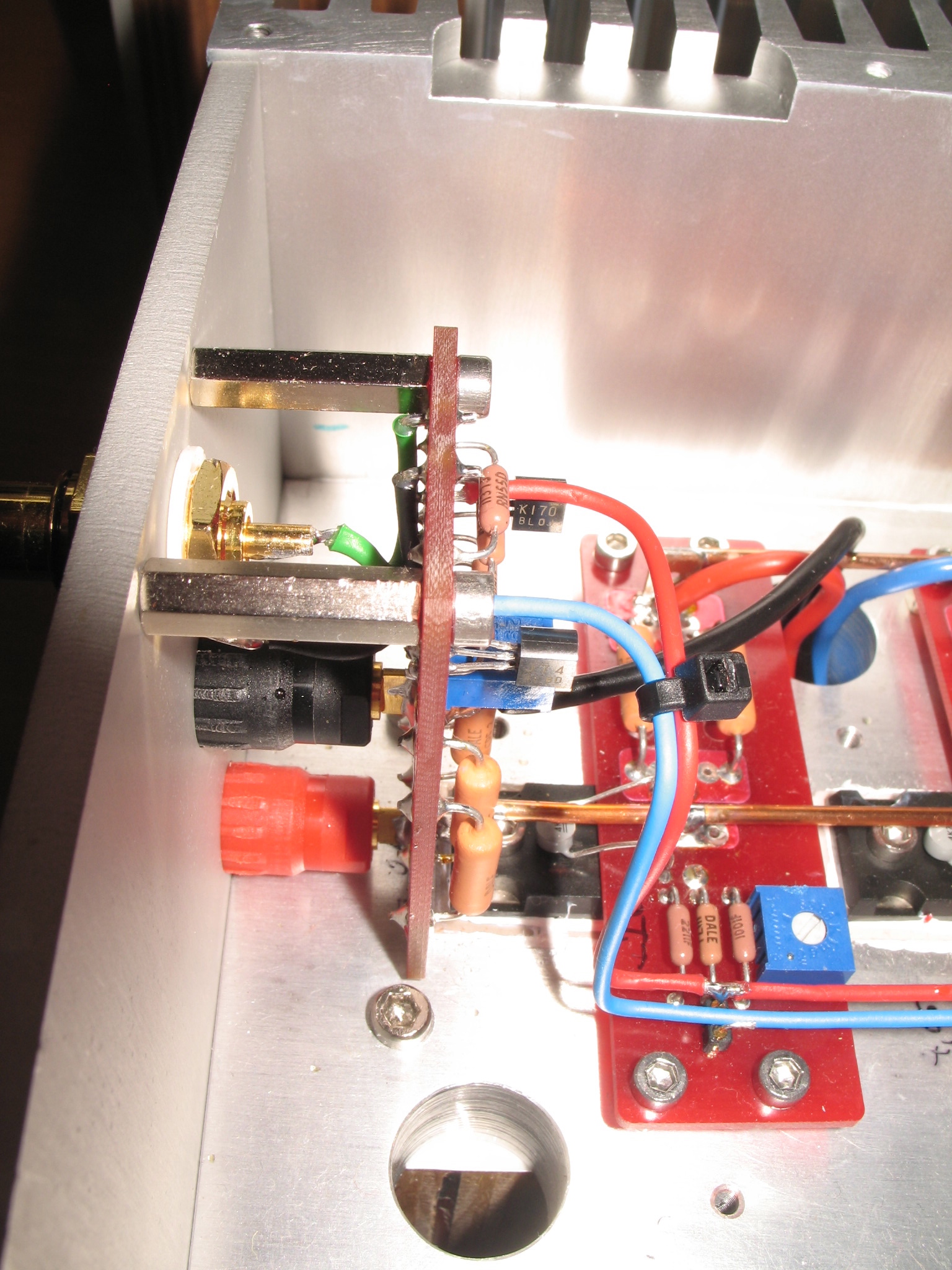

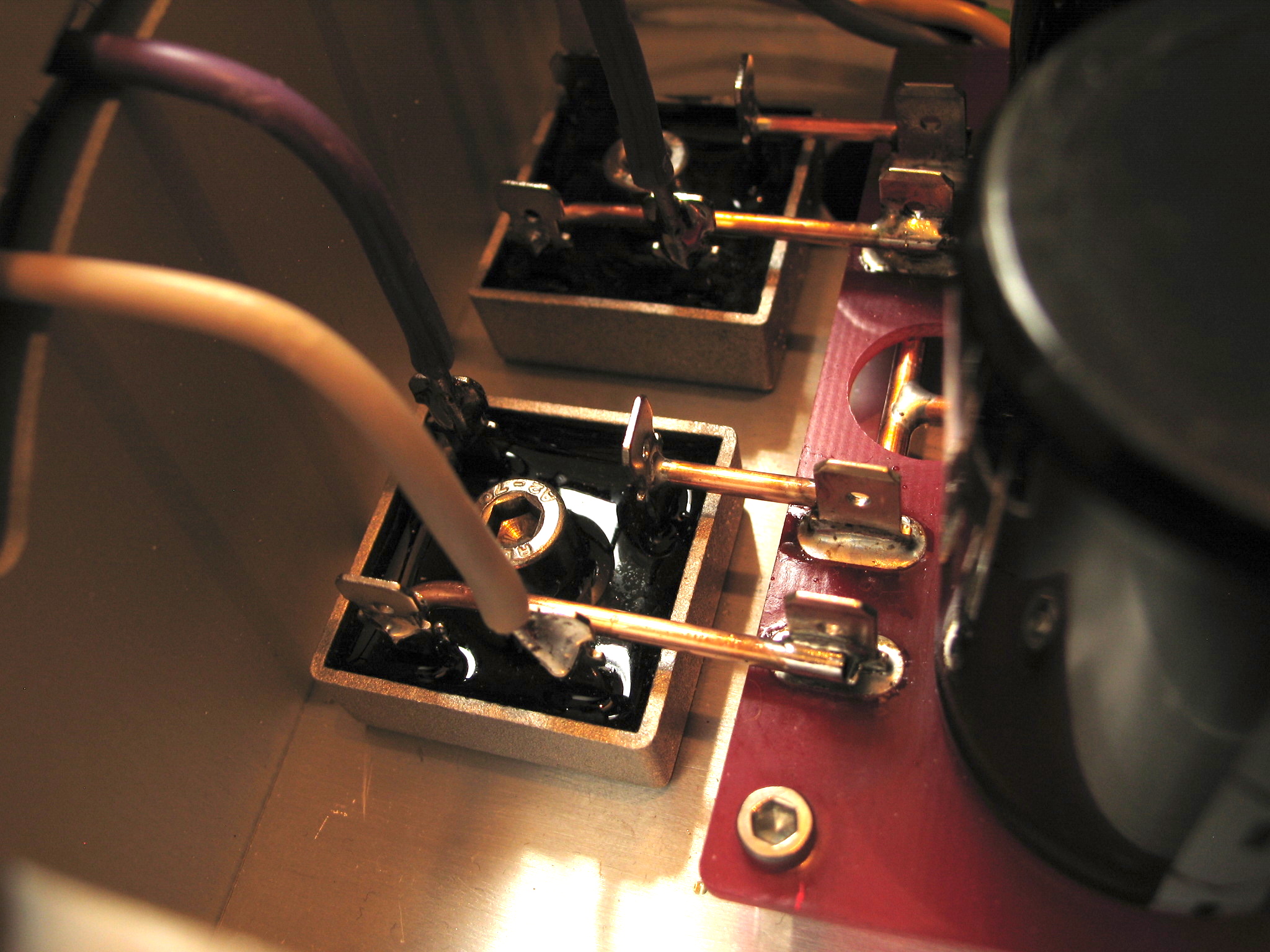

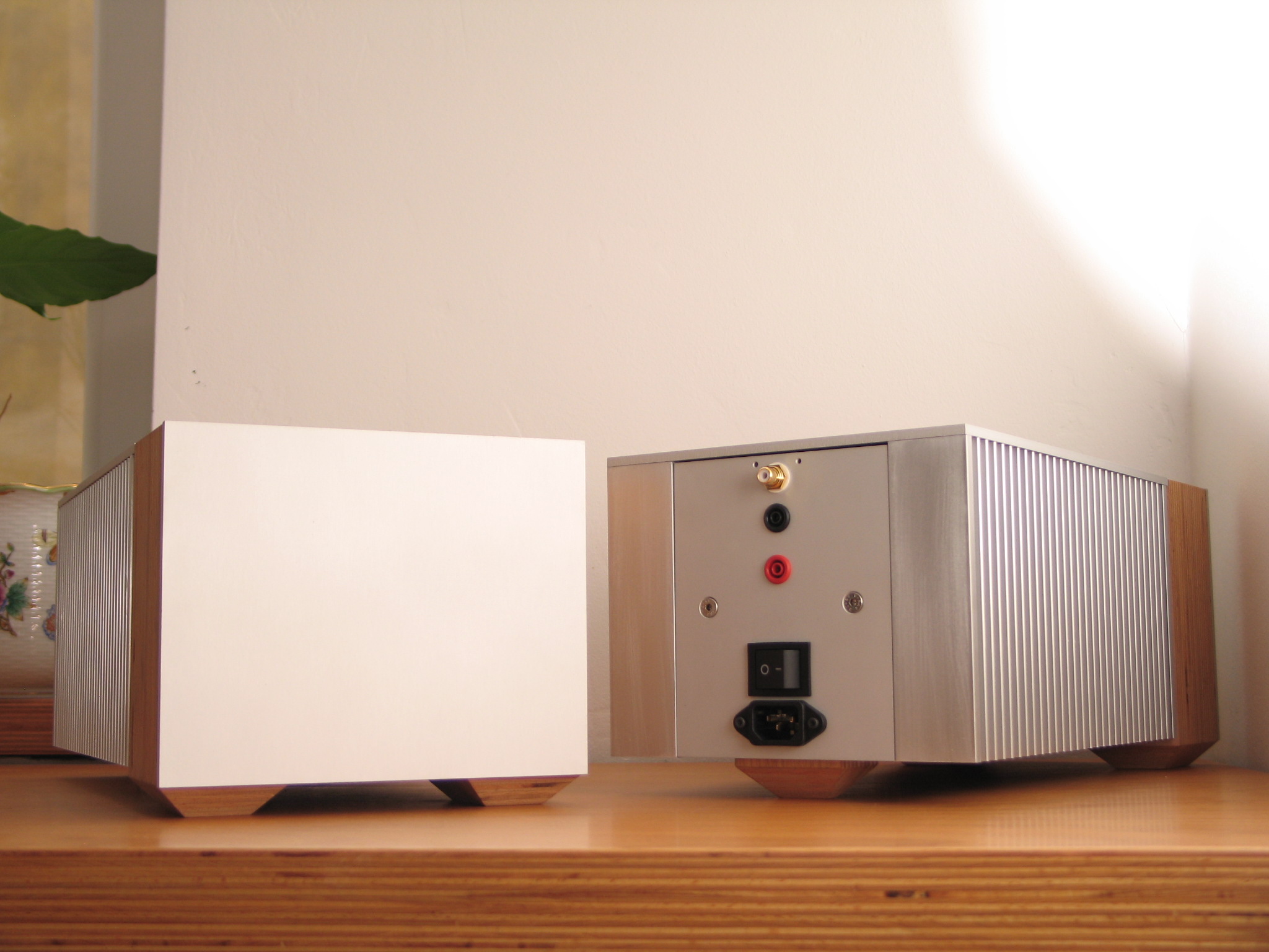

Here are some photos of my finished F5 turbo monos.
Each Mosfet is biased to 0.8A.
The bases are 59°C, the heatsinks are 57°C.
The room temperature is 25°C.

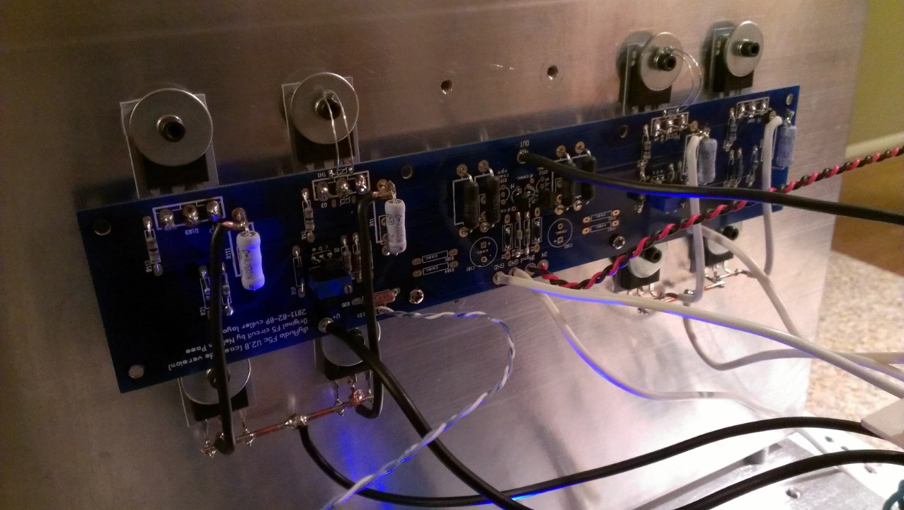

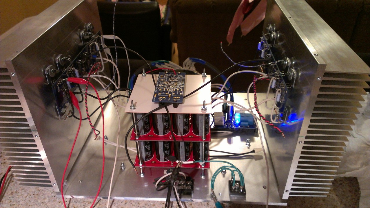

Here is a pic of my F5c with parallel source diodes. Im doing a preliminary bias now, its at .85 amps per device. Im trying to dial in on where the diodes begin conducting. It has .47 ohm source Rs, and 100 ohm parallel feedback Rs.
I dont think I can bias this much higher on my horizontal heatsinks.
The psu is all C right now, im waiting for choke coils.

Nice cable management! And I am glad you included the side shot otherwise I would not have understood what was happening there. I like how you nested the transformer in the back like that and flipped the cap bank under the rest of the components.
It unfortunately gives me ideas now...
Turn your sinks the other way. It has a great effect on dissipation. I wouldn't go much higher than .450 across Rs and that's assuming easy load.
The horizontal sinks were a design consideration based on some other materials I had. I had a se burning amp in the chassis, but couldn't get the bias I wanted. The f5c is working out well though, at .4 volts across .47R. Any higher, and it's a little hot.
Rookakoma - yes, those are among the best Pass amps that have ever been made. Truly inspirational work. Bravo!
(And the above comment by Tiroler is high praise indeed - his work is jaw-droppingly amazing...) 🙂 🙂 🙂
