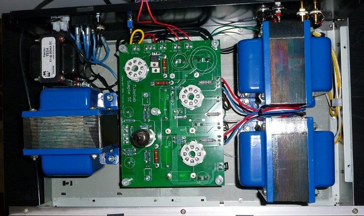

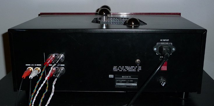

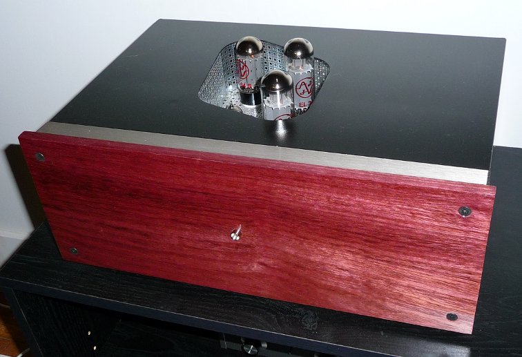

Here's my Simple SE build. The chassis started life as a Sony TC-K6 tape deck from the late 1970's that I picked up at Goodwill for $5. A piece of purple heart hides the old front panel. Some perforated aluminium from the local hardware store forms the recessed area for the tubes. The existing holes in the back of the chassis were re-used. The only problem I have is that the motor run cap I had was too big too fit inside. So I'm on the look out for an oval one that will fit. The whole chassis went together in a day and was cheaper than any of the commercially available ones.

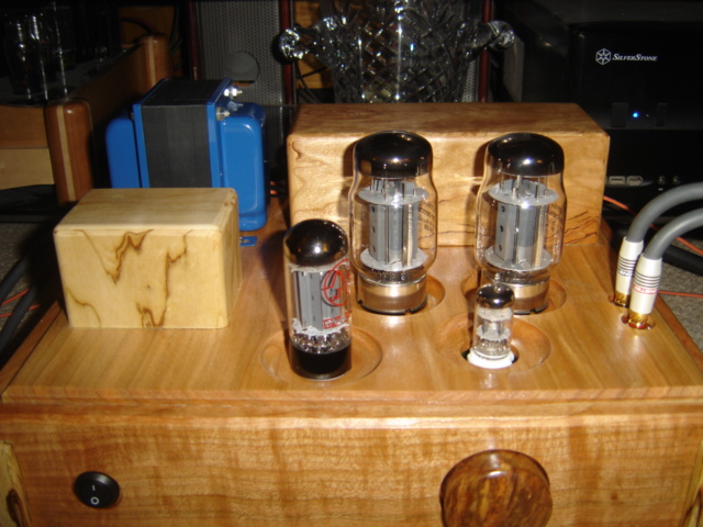

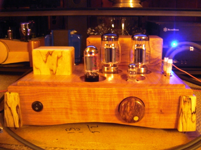

My original idea was a more traditional design with the transformers mounted on top of the chassis and a cut out in the center for the tubes. I wanted to cast this out of concrete similar to concrete counter tops but use white cement and cobalt blue glass. Once it was polished I think it would look pretty cool. I still may try this when I get some time and a place to work on it (maybe for a Simple P-P).

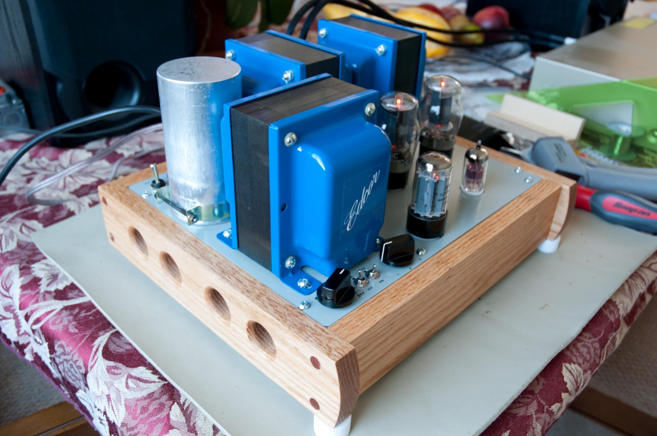

Pictures of my Simple SE

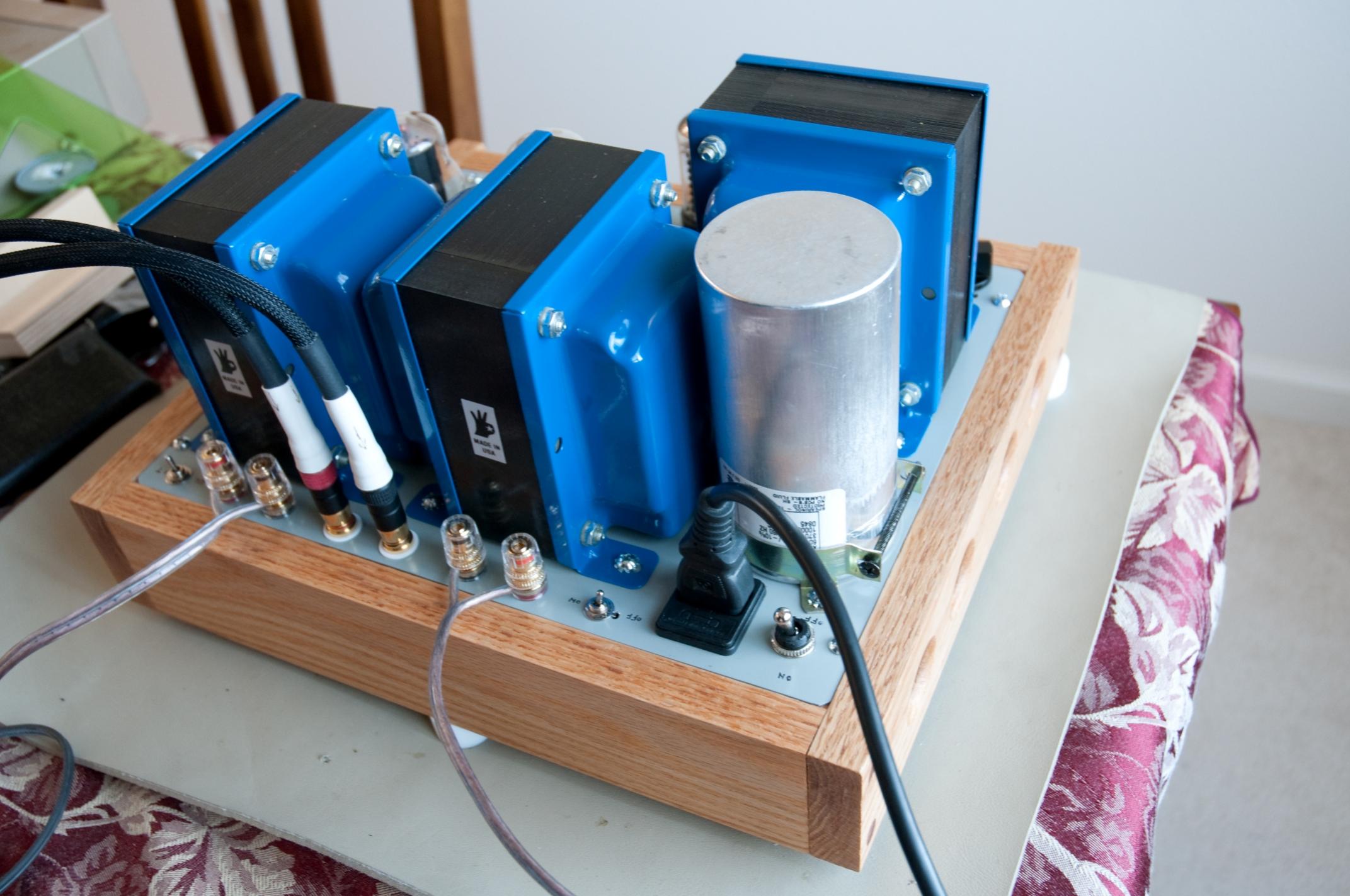

My Simple SE build was base on a 12"x10" Hammond steel plate and wrap around with scraps red oak. The idea of the original layout was inspired by fellow member Russ that he posted the pictures during his Simple SE build. There are so many Simple SE build and good ideas in the forums. Good luck and enjoy your Simple SE build.

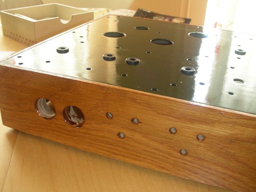

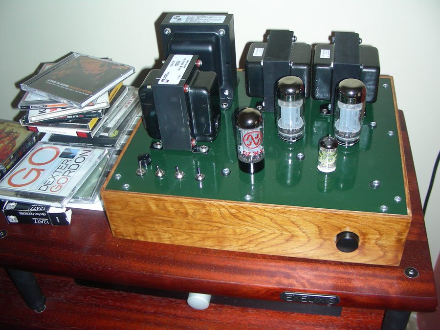

2mm alu top plate (first two hands of wash primer and then 3 hands motip dark green spray) on beech wood, Transcendars opt (5k/40% ultralinear/ 4 & 8 ohms) , hammond 374bx, hammond 193j , alps blue velvet ...
right now with Ei KT90 (pre bombs ones) .... and they are just perfect !!!!!!
good luck and have fun ...

jimazz, just curious, it doesn't look like you have any bracing underneath; does 2 mm aluminum support all that iron without sagging/bending?
I must say, I'm really impressed with the creativity in the DIY world; I mean, come on... who ever heard of making an amp out of concrete!
yeap, it does ....
tho I had many ideas to support the top plate finally I didnt have to ...
those opt helped out as they are much lighter than the hammonds 1628 or the big edcors that I had in mind ... (and sure will use them the next time)

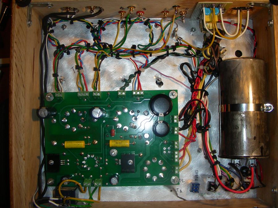

Here is my version. KT88 power tubes EDCOR 15w5k8 driving 4 ohm speakers. Will probably upgrade OPT but sounds good enough that I am not in a hurry.

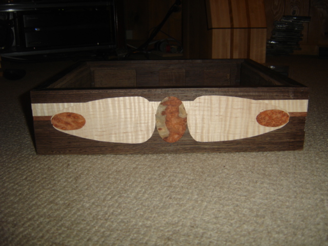

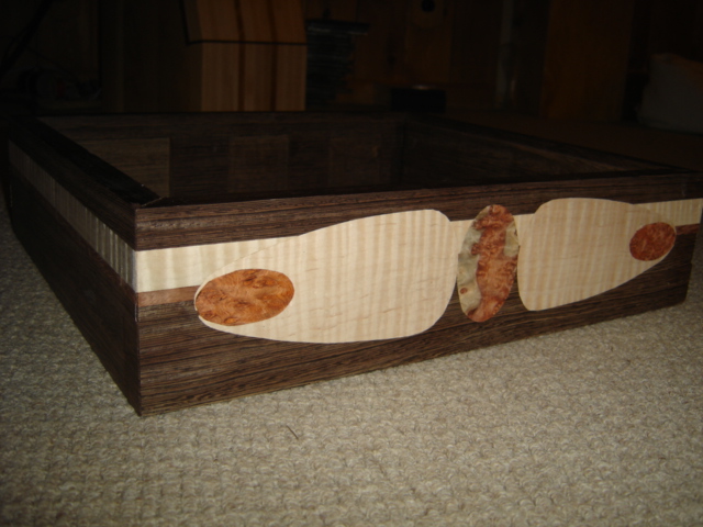

I also attached the chasis for my Tubelab SE. Was experimenting with inlays. Will make top plate tommorrow. That will have 25W3.75k6ohm edcor custom OPT and 300b power tubes.
