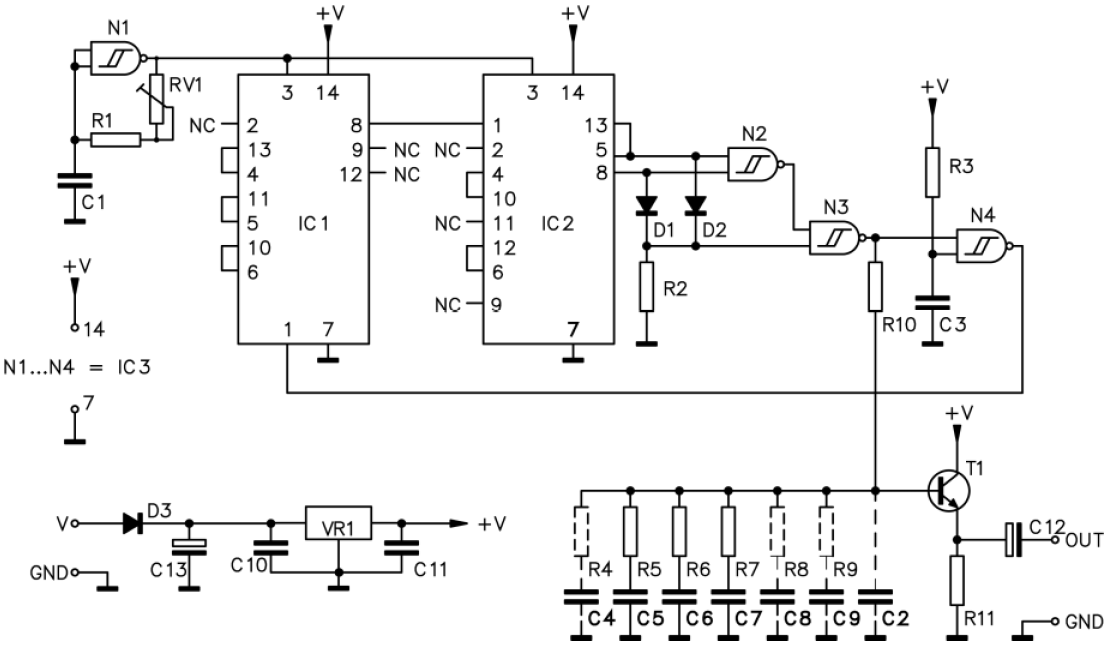

The attached schematic for a pink noise generator of which various versions can be found on the net, seemed easy to build. I have build a kit version with pcb. However, it appears to have an issue. Upon start all works fine, but within no time something makes it oscillate far more than intended. What a pun. The issue takes the regulator (78L08) and IC1 resp. IC2 (CD4066BE) down. The N1-4 IC (CD4093BE) has survived several times. A lab supply of 12Vdc was used to power the unit.
Before re-placing the regulator and IC1, IC2 for a second try, a decoupling cap of 100nF was added at the supply pin of each IC. Alas, the second time went the same dead end. A search revealed this is not the first time with this schematic, but no remedy could be found, apart from the decoupling.
Any suggestion on what is going on and how to cope with it?
Edit: the IC1, IC2 are CD4006BE (not 4066), but as per post 4 this should not matter.

The circuit might not be the best or the smartest, but it should work alright. CMOS circuits can take a lot of abuse and survive, and the 78L08 can only die if its input polarity is inverted, or if the input voltage exceeds ~40V.
Strange.
Probably supply-related
With a 8V supply, just a few mA/input and anyway the total current will not exceed ~100mA. That would be 0.8W for the whole circuit and 0.4W for the regulator with a 12V supply, but that's the upper theoretical limit, the actual current will be lower
Floating inputs are likely oscillating and exceeding the supply rails leading to latch-up. But it doesn't matter. The problem was the wrong chip. Yes, the odds of another mistake are high, but we cannot help with that.
