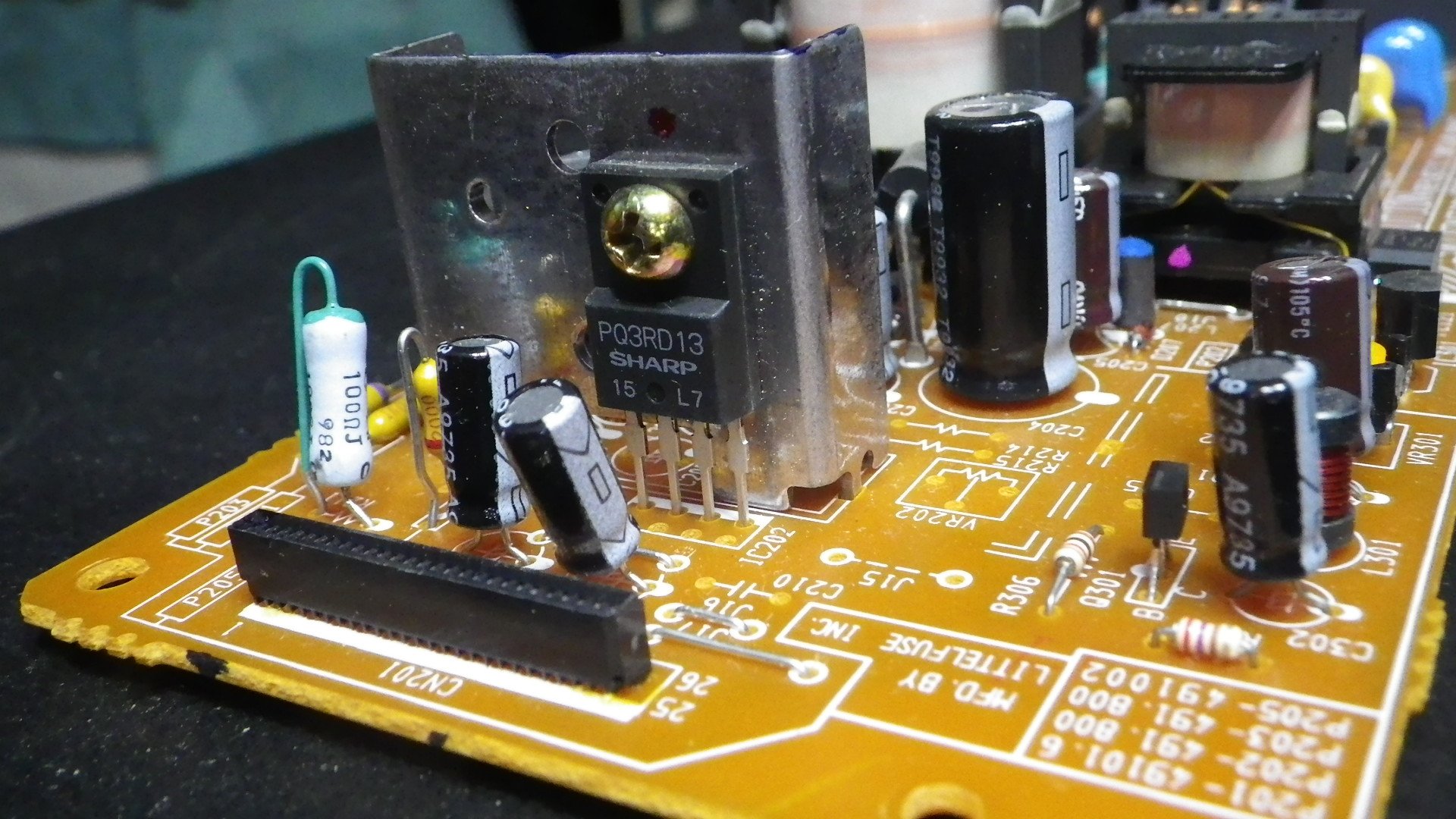

The IC I was talking about is the PQ3RD13 at IC202, which I believe is a VR for the low voltage feed.
It calls out 3.3v (I have 6.8v there) and 12v at pins 5 and 7 on the ribbon cable, I have 18.3 vdc there.

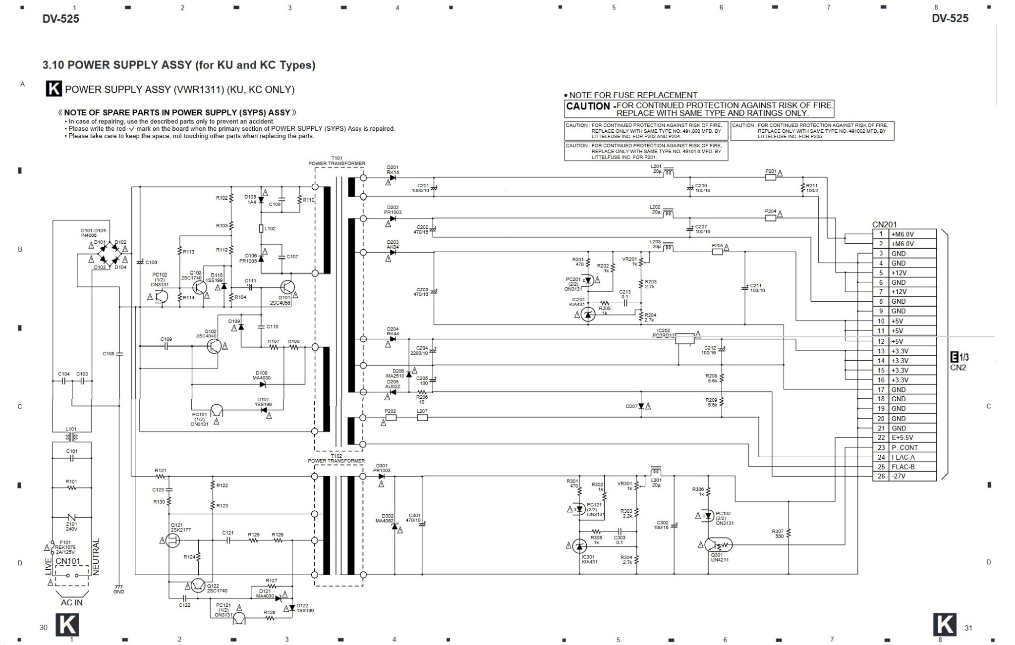

Here's a few more pics, plus the full ps diagram from the manual Showing from the AC in to the ribbon cable out.

Yes, the input circuitry to all intents and purposes puts AC line voltage across the bridge. Everything up to that point on the bridge is just for interference suppression.It looks to me like the power comes in through the fuse, to Z101, R101, C101, then through L101, C103/104, and to the rectifier diodes, from that point on its DC current. 120V AC is what goes right to the diodes.
You should end up with rectified mains across C106 which is 170 volts DC for 120 volt mains.
SMPS is very different in how it operates. Conventional transformers use the nice sine wave of the mains at 50/60 Hz to operate. SMPS use a transistor to 'pulse' the much smaller transformer. The transistor controlling the primary (Q101 in yours) is either fully on or fully off. The components across the primary, the diodes, caps and L102 work in conjunction with the resonant frequency of the transformer and help keep the primary current and voltages within limits. A form of resonant tuning, All this runs at perhaps 50 to 100kHz or so.Most of the receivers and such I've worked on the power goes to the transformer first, then through the rectifier(s), and then to the various boards.
The output from the transformer secondaries is a peaky and noisy type of waveform, not a nice sine wave.
That has to be a 3.3 volt reg looking at the marked voltages. If you have 6.8 volts on the output then the reg would seem to be zapped. Measure directly across C212 to confirm.
The 12 volts line up at 18 volts is also bad news. This is regulated directly by the PSU itself using opto isolator PC201 for feedback into the SMPS primary side. This is critical.

Its a very unusual PSU in that there are two separate transformers and switching elements. The two presets (one for each supply) set the output voltage of that monitored rail only. Those are the only ones monitored. All other unregulated (raw) supplies may well be a bit different depending on loading etc.For test purposes, I checked the voltages on a working player and got high voltages on that one too, and it's not damaged, but they're not quite as high as the one that got hit with high voltage.

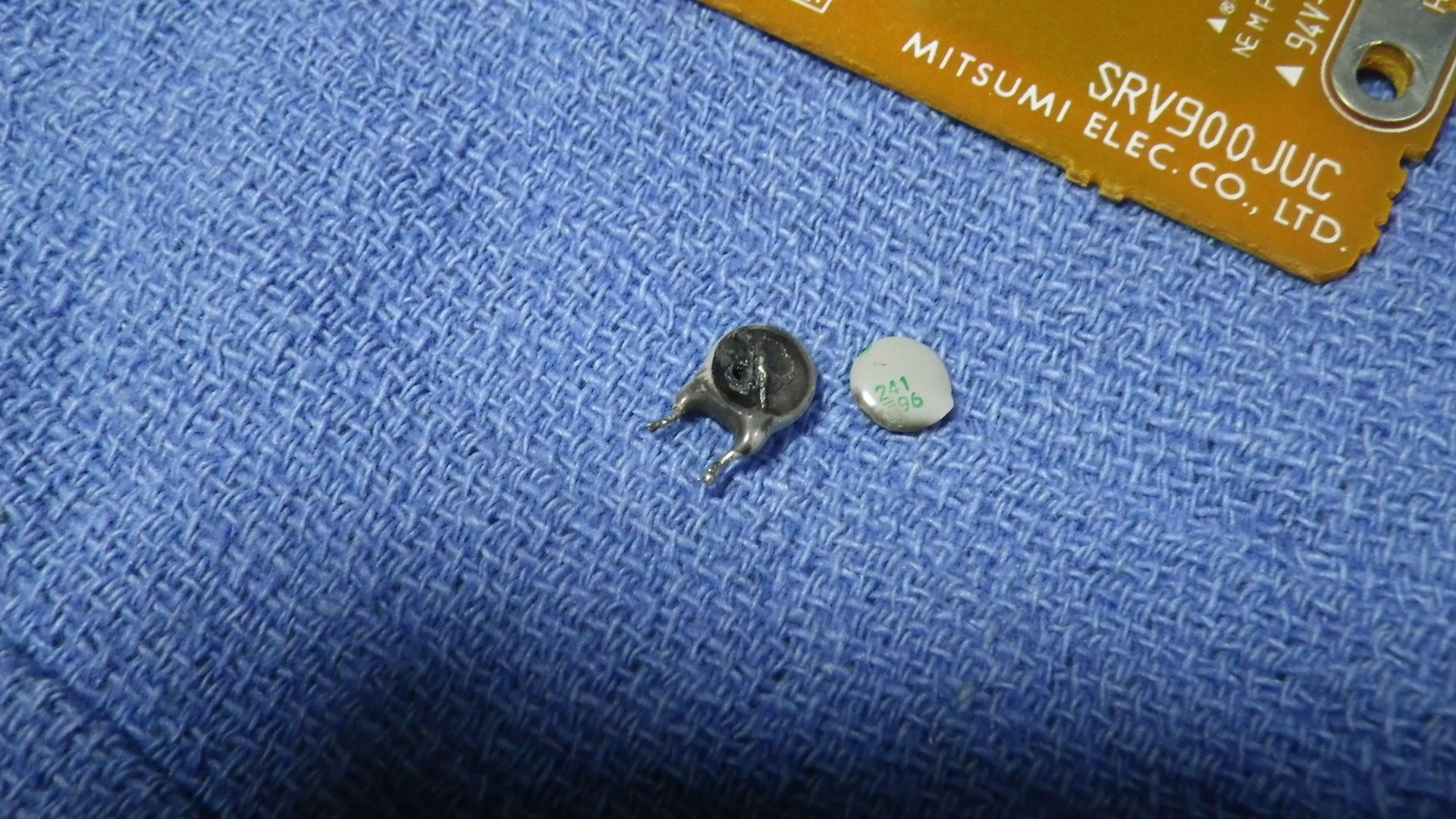

It will all work withut the varistor assuming no others issues exist.

So it is all working correctly and you just want to fit a suitable varistor.
https://m.littelfuse.com/~/media/el...ng_a_littelfuse_varistor_application_note.pdf
You can get a fair idea of the energy rating (in Joules) by comparing physical size of what is fitted.
