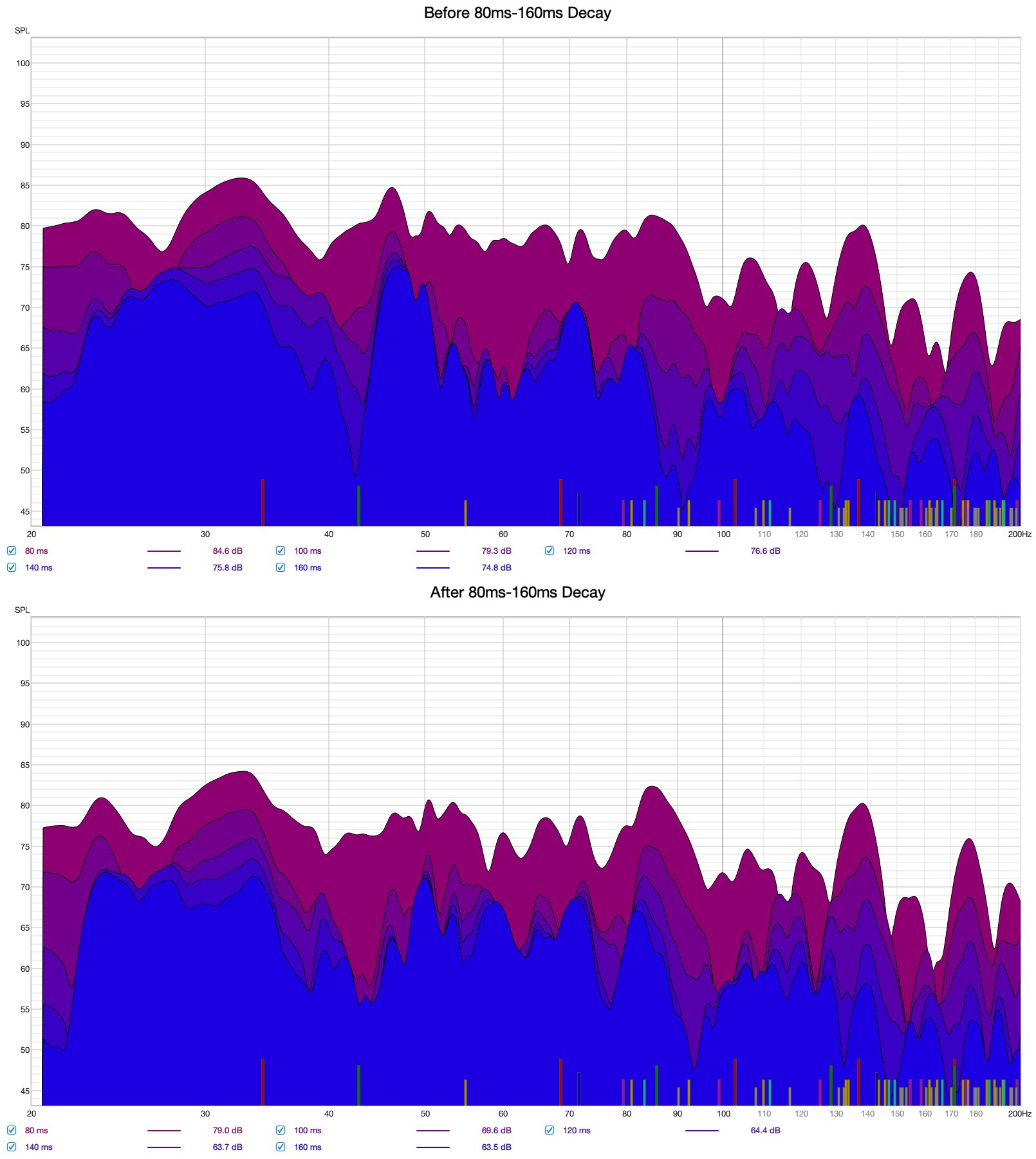

I have since made 6 more of these for a total of 12 in my room and they definitely brought some of the decay time down at the frequency they were tuned at.

Just moving a few of them changes decay times at different frequencies. I'm trying to figure out if they work better all co-located or spread out along the wall. That 50hz sound pressure wave is strongest in the corners I think but also has some spots along the walls that are pretty high. I have them spread all around right now. I wonder if they get in each others way and are less efficient and affective if placed too close to each other.Another thing to consider is that resonators, including Helmholtz resonators, must be place precisely where the anomaly is in the room, the anomaly can be any point or area where peak sound pressure is 6 dB or higher than the average sound pressure in the room. The general idea is to smooth out or neutralize these high peak SPLs. But if a resonator is placed somewhere else, arbitrarily, then the sound may suffer. That’s why I suggest mapping out the room with sound pressure meter and test tone or tones, to establish the number of room abalomalies before building any resonators. Hekmholtz resonators are not the only game in town, not by a long shot.
Deffinitely not the only game in town but, holy crap so quick and dirty. Grab pipe from Home depot, cut in half (almost resonates at 50hz right there) add a little neck, add a fistfull of polyfill and done.
I don't notice much change in the SPL peaks but more in the decay times.

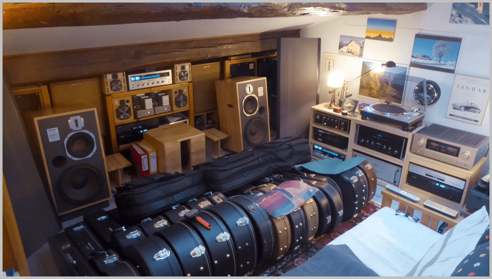

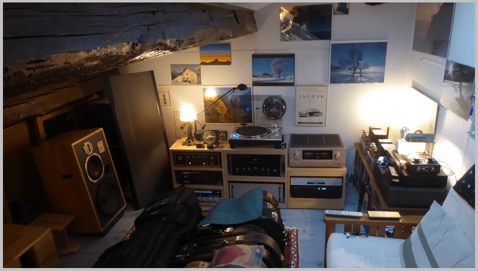

Of course yes ! Moreover my room has a slanted ceiling and is (unpractically) crammed with stuff (in storage) that - for the occasion - provides enough sound neutrality...
Incidentally yes, many of my Audio pals are often fronting some resonances problems with their much larger listening rooms - usually their living room, shared with the rest of the family - and this complicates the possibilities of acoustical treatment and speaker placement, de facto...

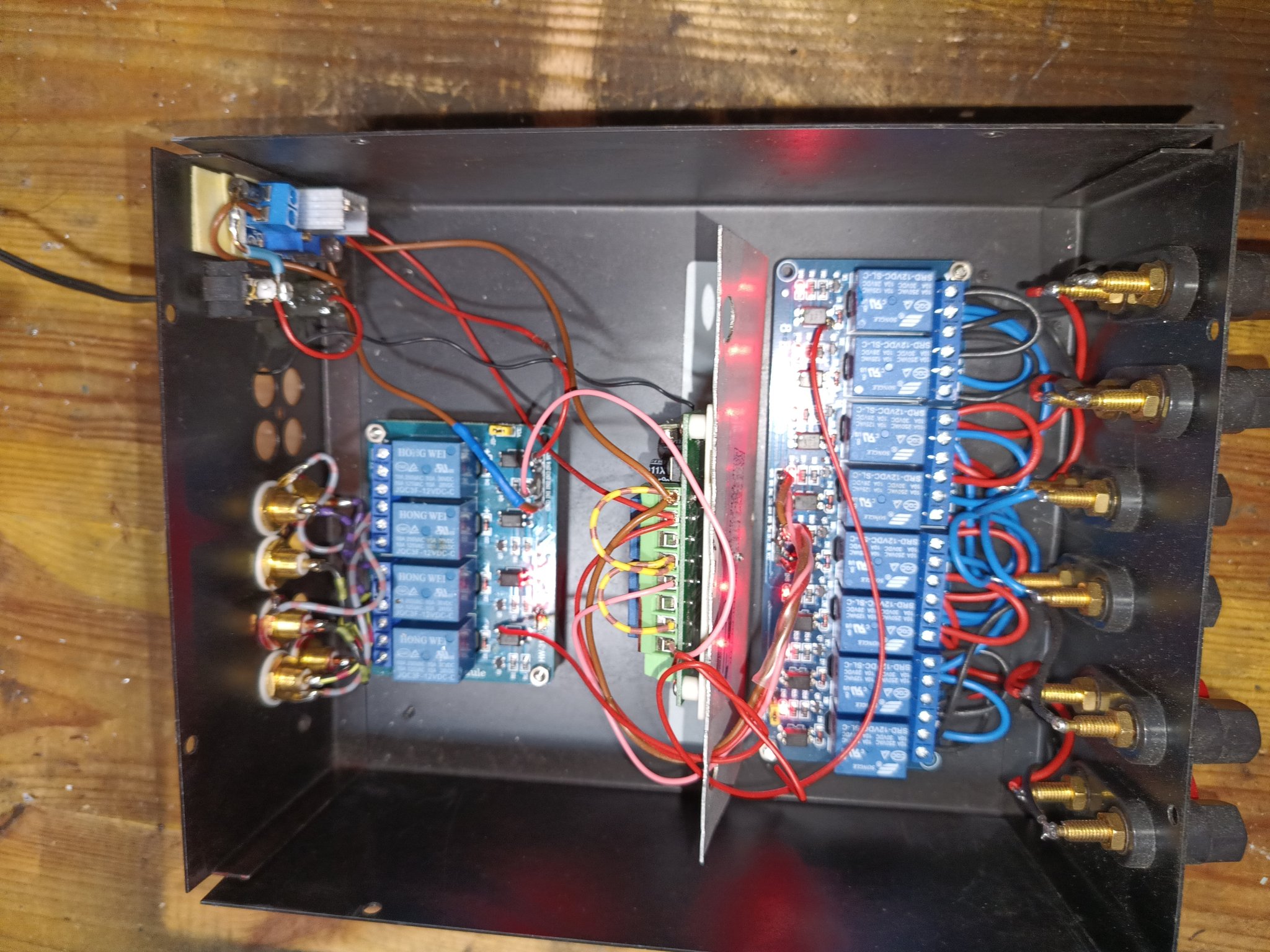

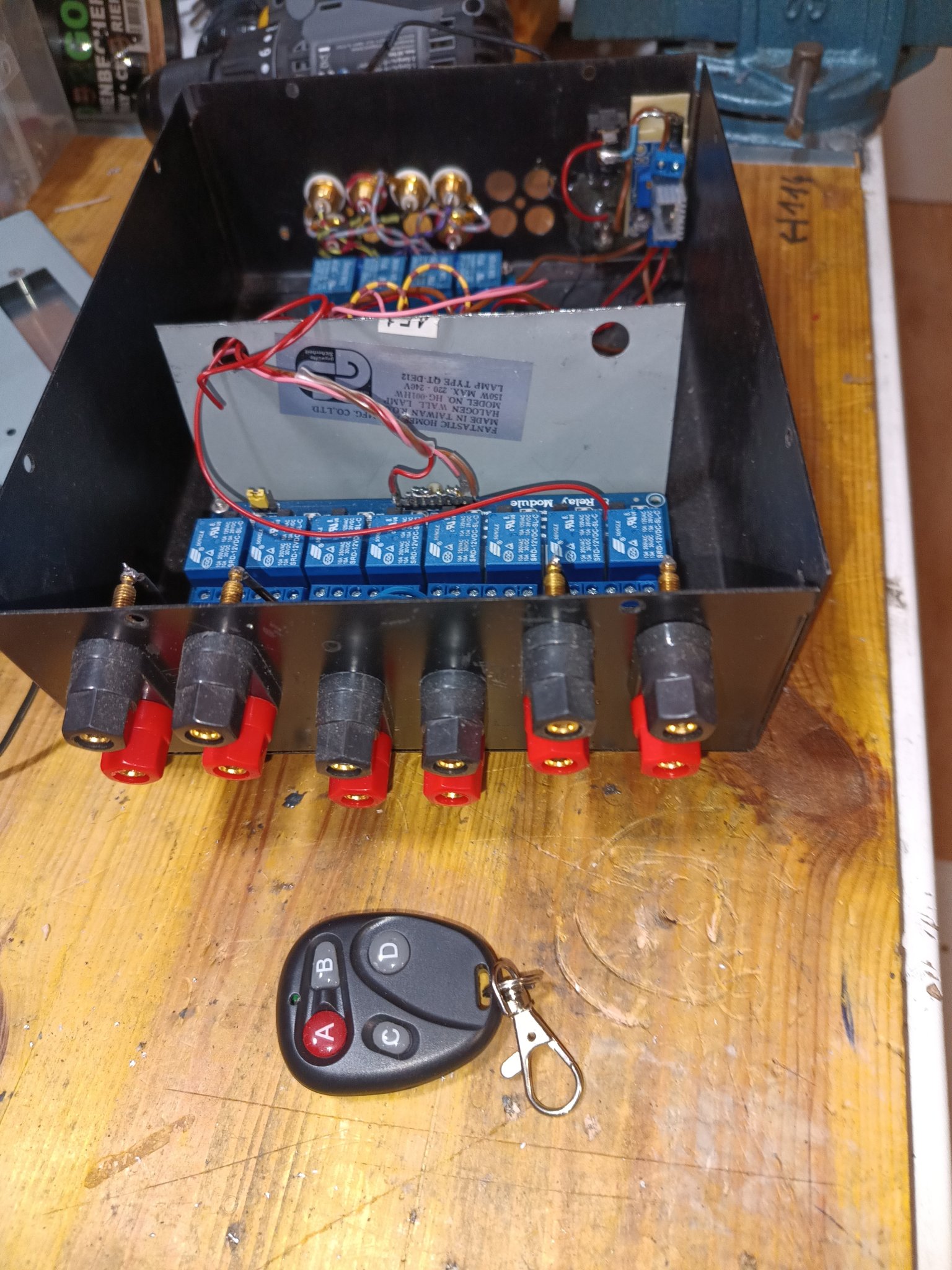

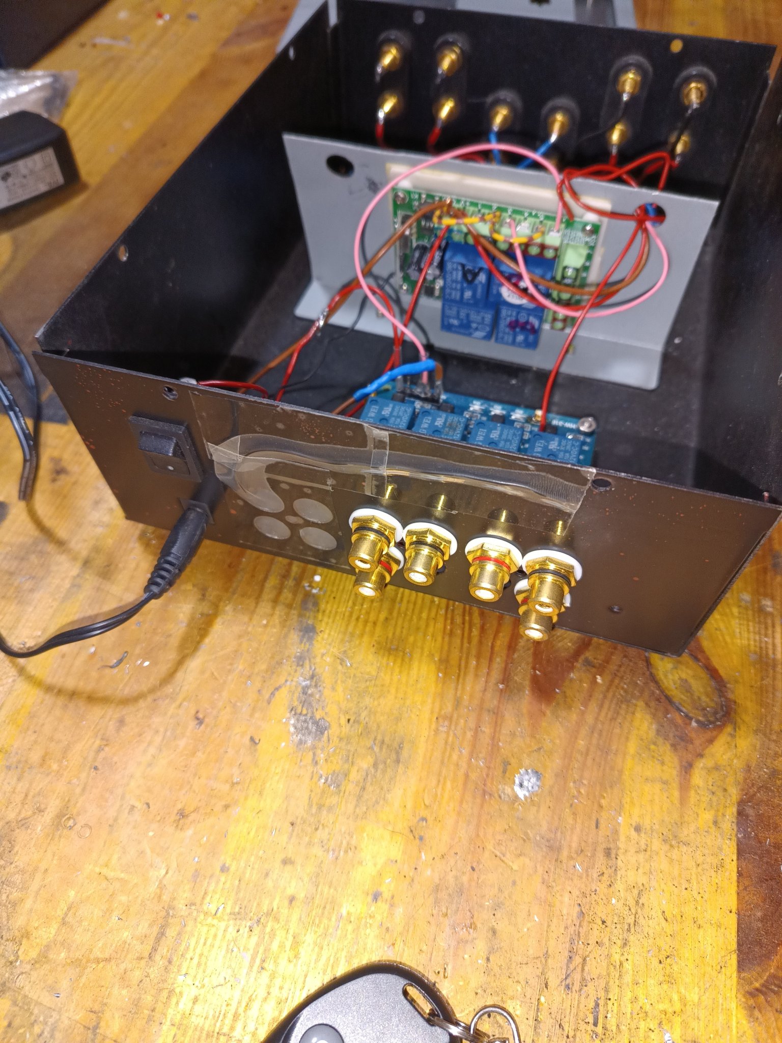

I for example, have very simple, cheap A-B switching devices. Remote controlled, the last build even wireless, so you don't have to move your body for an objective A-B comparison. I use to it to compare amplifiers, CD player and DAC's, and while improving speakers
Such a device should be the minimum hardware for anyone who has an opinnion about any gear. Not many posting here have something like that. I add a picture of mine.
