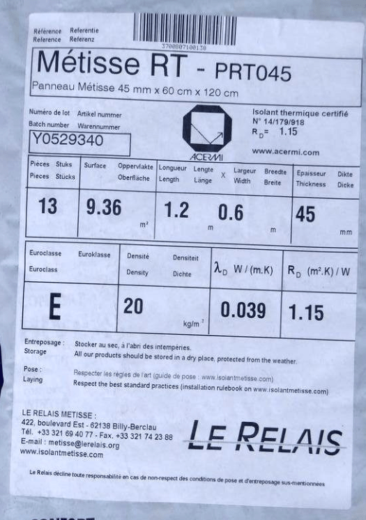

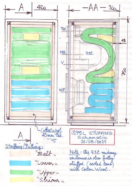

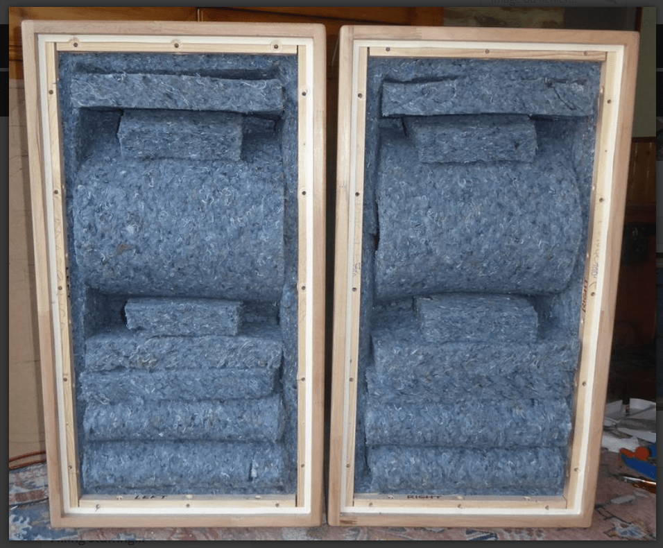

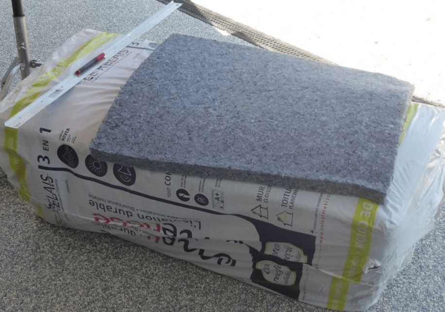

As you are speaking about acoustic absorbent material, I use this - currently available in DIY supermarkets :
Here are the specs :
This is recycled Cotton Wool - I use it for years in all my speakers with success, and moreover it's harmless - unlike Rock or Glass Fiber Wools...
T

Cotton wool? Do they grow sheep on trees now? 😬
Like Steel Wool grows on the Eiffel Tower. Very costy too...

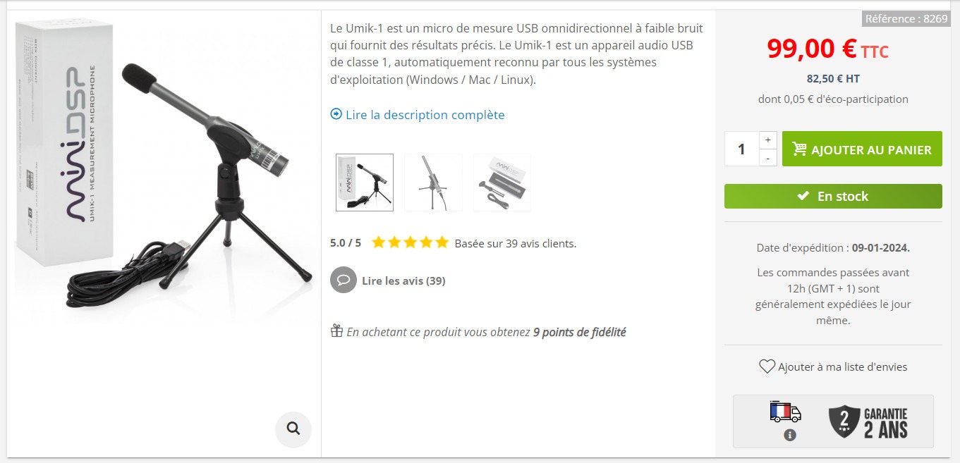

Umik 1 or 2 from miniDSP
$100 bucks and you’re off to the races.
What laptop do you have?
Umik 1 is usb A and 2 is usb-c
Something to consider depending on what type of ports you have.

Aw ! Well, no problem @nwickliff ...
I see :
My laptop is an ASUS VivoBook 17 (W11 pro), and it has the USB-A and USB-C connectors.
I'll also check what USB ports have my external soundcard (ESI Maya22USB).
Thanks for your input !
