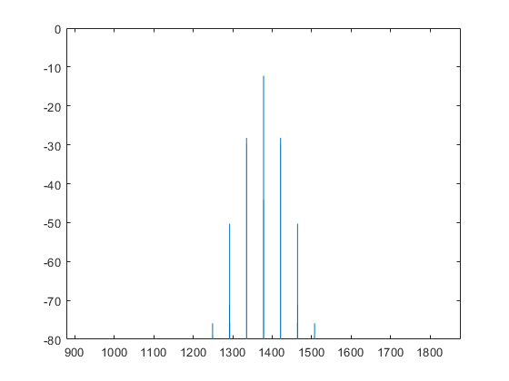

I just read the wav files into Matlab and calculated the spectra. The signals are periodic so we can do an FFT without window. Then converted to dB and subtrated. The biggest difference is 0.005dB at around 1507Hz (one of the side bands), most likely due to 16 bit quantization errors. Note that windows before FFT is spreading the energy in the frequency domain (multiplication in time domain equals convolution in the freq domain).Thanks, got them.

- this may explain why you saw a larger difference. Without FFT window for such periodic signal, the spectral bleeding is absent.
The script is here:
[ya,Fs] = audioread('PureAM.wav');
[yf,Fs] = audioread('PureFM.wav');
N=size(ya,1);
Ha=fft(ya
Ha(Ha==0)=1e-8; % avoid minus inf dB
[~,id]=max(dBa);
f=(0
f0=f(id)
dBa=20*log10(abs(Ha(1:N/2)));
Hf=fft(yf
Hf(Hf==0)=1e-8; % avoid minus inf dB
dBf=20*log10(abs(Hf(1:N/2)));
%compare magnitude spectra
idn=find((dBa>-100) & (dBf>-100) & (f>0));
[maxdifdB,idm]=max(abs(dBa(idn)-dBf(idn)))
f(idn(idm)),
plot(f,dBa);
axis([f0-500 f0+500 -80 0])
which echoes:
maxdifdB =
0.0050
idm =
7
ans =
1.5073e+03

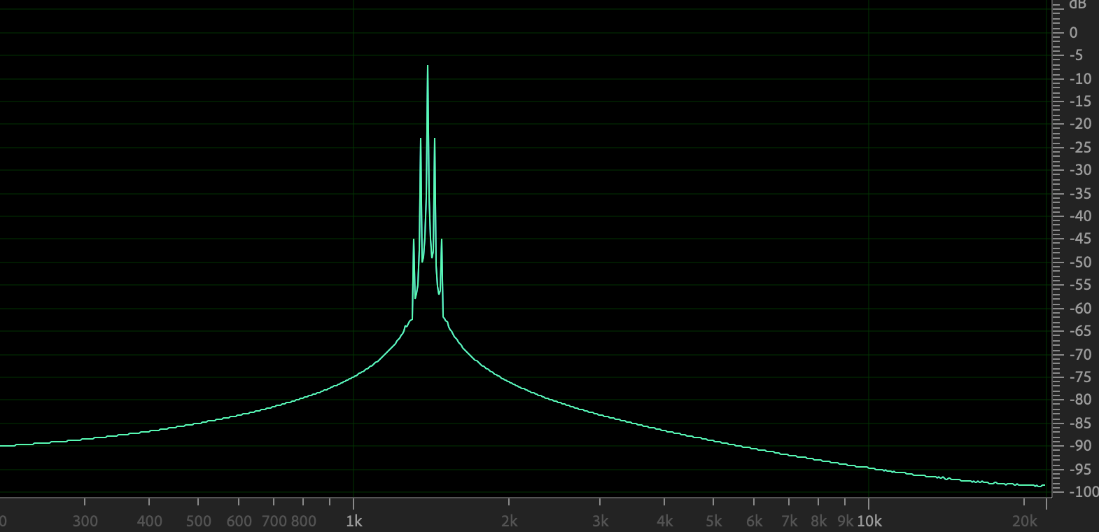

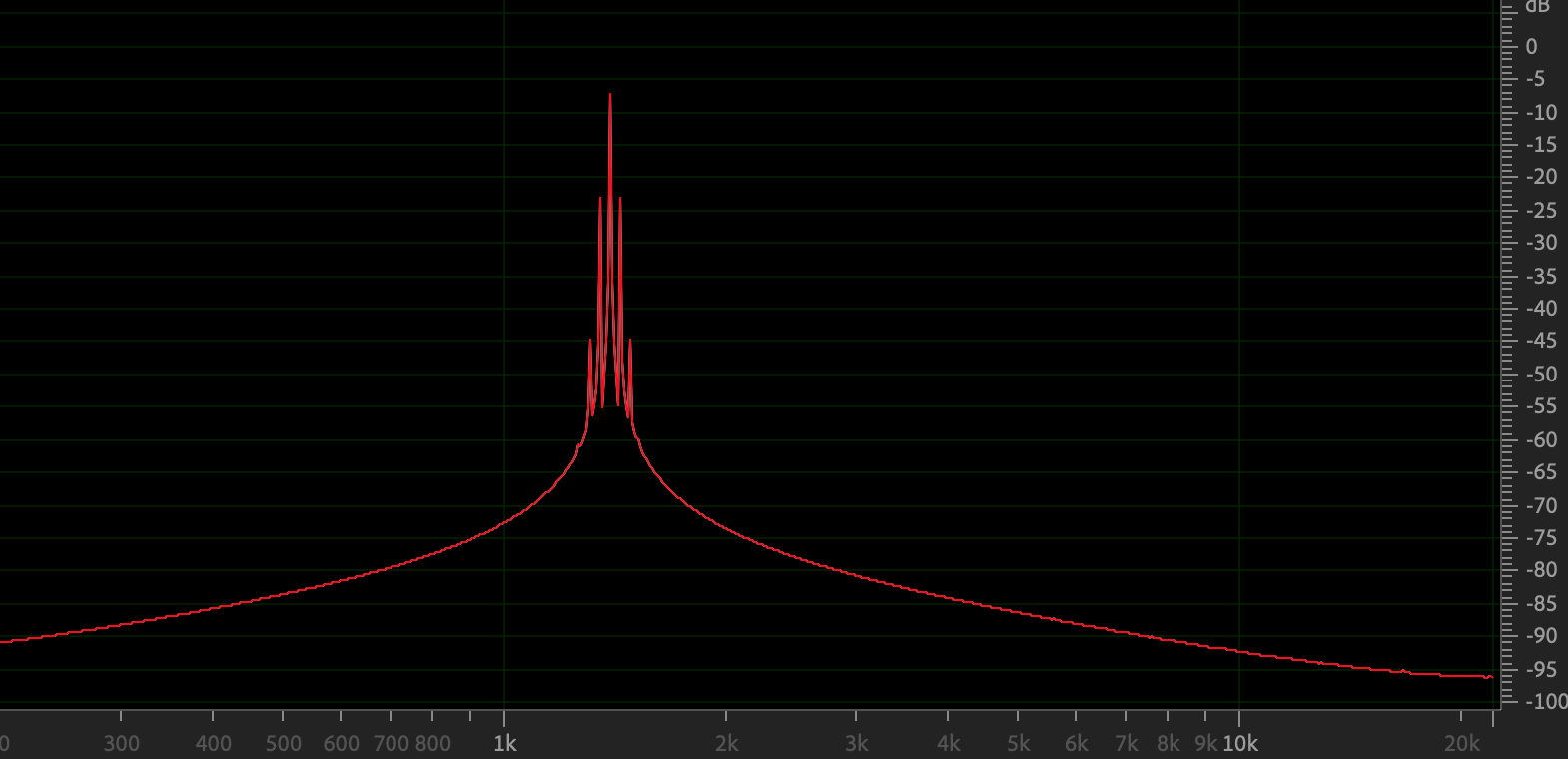

All I did was drop the files into Audition and run the Amplitude Statistics, and FFT on them. They are different peak levels, different envelops, entirely different waveforms. Why would anyone think the should sound the same?sorry, Matlab code seems to give smileys

There must be an error here. No other FFT has the spectrums identical.I just read the wav files into Matlab and calculated the spectra. The signals are periodic so we can do an FFT without window. Then converted to dB and subtrated. The biggest difference is 0.005dB at around 1507Hz (one of the side bands), most likely due to 16 bit quantization errors. Note that windows before FFT is spreading the energy in the frequency domain (multiplication in time domain equals convolution in the freq domain).
The script is here:
N=size(ya,1);
Ha=fft(ya,1))/N;
[~,id]=max(dBa);
f=(0N/2-1))'/N*Fs;
f0=f(id)
Hf=fft(yf,1))/N;
f(idn(idm)),
plot(f,dBa);
which echoes:
maxdifdB =
0.0050
idm =
7
ans =
1.5073e+03 View attachment 1039529
complain to Mathworks?There must be an error here. No other FFT has the spectrums identical.
No need to. A FM signal of a carrier fo doesn't in general have the same period as an AM signal of a carrier fo, like your calculations are assuming. Only for small deviations the FM spectrum can be assimilated with an AM signal, otherwise, for large deviations, the spectrum trends to a continuum governed by a Bessel function.
