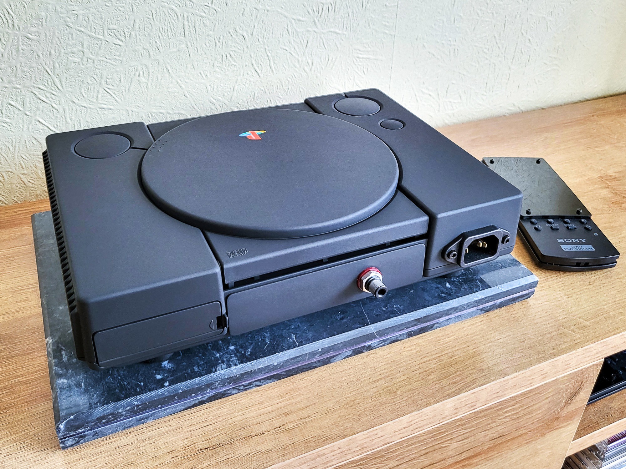

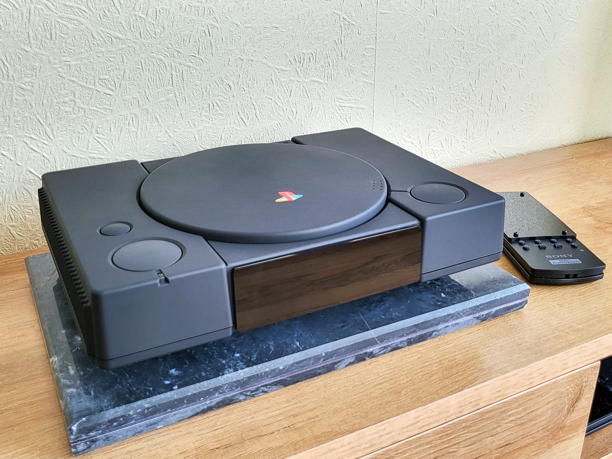

My Playstation 1 SCPH-1002 CD Player and CD Transport

Alright then. It's time to do a little review. So many years have passed, yet the first PlayStation still stirs the hearts of audiophiles. Much has been said and written over these years. Many battles have been fought between the camps of numbers lovers and live music enthusiasts. I will try not to introduce any contradictions and be objective, because everything that has been said and tested over many years is true. The only question is how you perceive and accept it, or not.
Around 2013, I first heard how the PlayStation sounds at one of the audiophile gatherings, where several good devices of that time, which had undergone serious modifications, were compared using A/B testing. Someone brought a PlayStation, connecting a Fadel Art Coherence One power cable (RRP €1.399,00 for 3ft) and a stock multi-out cable to it, and the music started to flow. That guy definitely knew what he wanted to surprise us with. Later, I listened to my own version of the PlayStation in his system, and it sounded simply wonderful, but, alas, at that time it was outperformed by another source in his system.
The beginning isn't too optimistic, but you need to know why that happened. It was a system based on the Meridian 598 DVD transport and 561 processor, Quad 99 power amplifier, and Rogers LS3/5A speakers. But that was just the tip of the iceberg. The devil was in the details. And the details included the entire range of connections based on Chord Indigo Digital for digital and analog interconnects (yes, the digital cable played better than its analogue brother), Chord Signature speaker cables, the top range of Fadel Art power cables, and a dedicated power line for audio in the house. I'm afraid to estimate the cost of the connections, but it was no less than $10K, so even at that time, the connections exceeded the cost of the system itself.
Many years have passed, and I've had various systems based on Class A single-ended tube amps, Electrocompaniet transistor amps, floor-standing and bookshelf speakers, but the PlayStation has always been a constant participant. It was then, listening to his system, that I clearly realised that although a combination of transport-DAC-preamp-power amp might surpass a full CD player and amplifier, but the cost of such a carefully selected system would be much higher. Much higher.
So, I came to a simple formula – full CD player + full amplifier. Minimum components, maximum quality. That was my recipe.
As I accumulated cables and held a soldering iron in one hand, I remembered that testing, and I had a strong desire to repeat it. So, I acquired a couple of wonderful Meridian devices: the 561 and 565 processors and the 596 DVD as a transport. Don't ask why. My rack just suited them well.

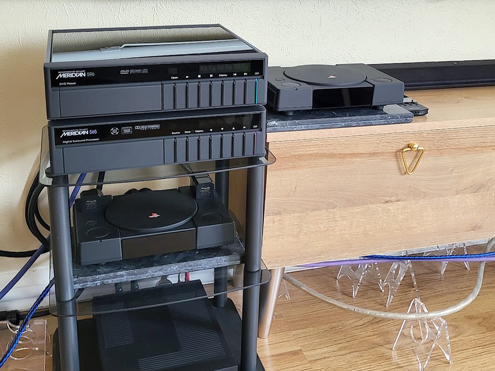

I think it's worth describing some details of my system, as it is built in the spirit of DIY, and there are practically no stock components left. All components have undergone serious modifications in one way or another.
So, the power supply system:
Mains Extension Block 1 - Chang Lightspeed (modified: digital filtering and fuse removed, Furutech IEC(R))
*Shunyata Copperhead
*Shunyata Sidewinder
Mains Extension Block 2 - Solid Ash (audiograde sockets, Duelund wiring, Furutech IEC(G))
*Oyaide 2.0
*R.A. Kimber Kable PK14
*Duelund power cable
Interconnect cables:
*Chord Signature Digital
*Straightwire Rhapsody analogue
*Duelund pure silver analogue
*Kimber Kable 8TC speaker cables
*Cyrus Two (modified: Nichicon Muse, Clarity cap recapped, unpowered phono stage)
*Castle Avon (modified: new crossover with Mundorf Oil, MOX/Clarity cap, neotech 3004 wiring)
Sources:
*Playstation 1 CD Player Studio
*Playstation 1 as CD Digital transport
*Meridian 596 DVD Player as CD Digital transport
I use a standard, slightly modified rack, which is set on spikes and sand pre-filled. I’ve had good racks before, but I just liked this one. I also use marble sandwich plates, granite plates and sand for speakers, and dedicated audio cable tower v2 for cables.
Well then, in a nutshell, did I manage to replicate the same test and its results that we did over 10 years ago? Both YES and NO.

Playstation CD Player vs Meridian 596 DVD Player
Playstation CD Player vs Meridian 596 as Transport + Meridian 561/565
Playstation CD as Transport vs Meridian 596 as Transport on Meridian 561/565
