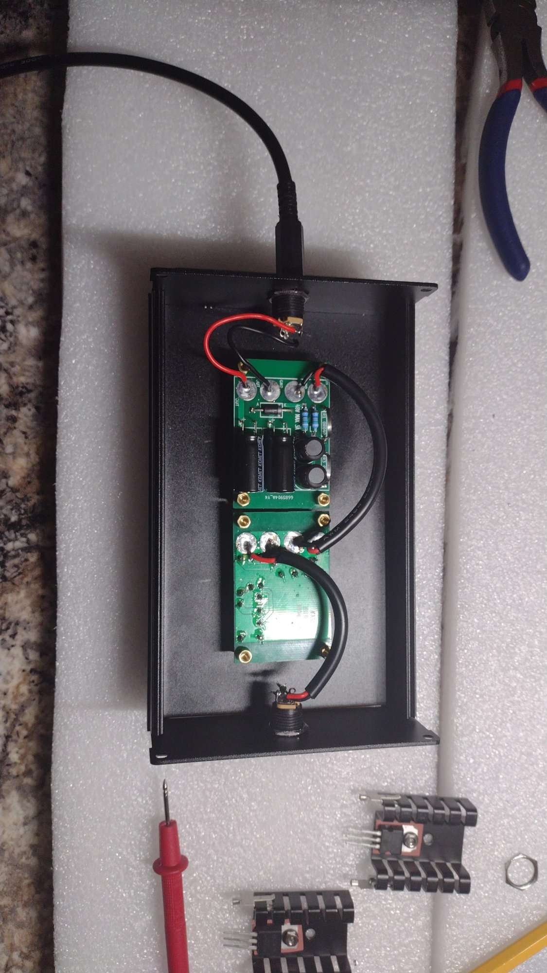

Thank you Mark Johnson. You inspired me to try having PCBs produced from your Gerber's. Had 5 boards made. All 5 stuffed, only missing current sensing resistors for 3 of the boards.
Bought some cheap aluminum project boxes off Amazon, trying the 2 units in series like posted previously in this thread. Not sure I can hear the difference but they where fun making them.

Nicely done!
--Tom
RE: "not sure I can hear the difference" - have you tried measuring the output with and without the filter? There is a lot of information in this thread about how to arrive at some very precise measurements. If you are queezy about those details, feel free to DM me and I can show you. Even the "non-super precise" approach will demonstrate that the filter is working and really only needs a DVM and some input source if you don't have a signal generator. A warning though: once you hear what the filter is eliminating, you'll never be able to un-hear it. You've been warned. :giggle::geek:
