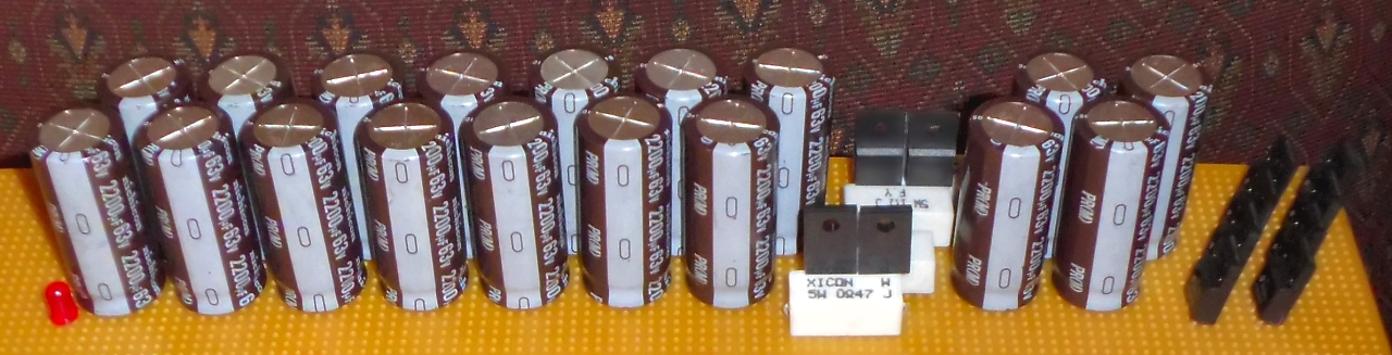

They are all 1/4w.
Output RC can be used with a 1/4w 10R and 10n capacitor--That's pretty minimal but usefully retards RF and can't shunt any audio.
That's seems backwards, for (bad) example: An 1/8w feedback resistor will degrade audio because there's a Power Amp pushing at it--Higher current into smaller wattage resistor is bad for quality.In another post you mentioned that you were using a 1/2 watt for your feedback resistor, but you thought the sound quality degraded with higher wattage value.
In a different way, 1/2w, 1w, 3w, might be bad for feedback resistor due to their larger size = higher inductance, and higher inductance puts MOAR gain on HF, which we don't want to do.
Ordinary 1/4w feedback resistor is unlikely to degrade the audio when there is low current. But, there may be room for improvement.
Parallel 1/4w resistor for feedback, as shown in the photos is great because it withstands higher current without degrading audio and because it cuts inductance in half. It also allows convenient values, such as 60k and 75k. . . of really really non-inductive resistors. I fluxed the leads before soldering, so that connections will be solidly operating as 1 piece for good quality.
Xicon and Koa 1/4w Carbon Film are suitable. Radio Shack apparently carries Xicon. Mouser has both. The leads on these products are nice and thick, and that's desirable. Approximately, 12 cents for a paralleled pair of good quality carbon film will have less inductance than a single expensive carbon comp.

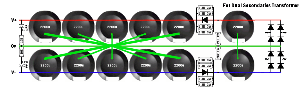

Daniel,,I don't have 1.3 R,3W but I have 1.5R,1W only,I don't hav 6A05 ,,but I have 6A04 diodes.Any alternatives ?Here are the 2200u caps:
how about carlos psu.
6 parallel 1.5R = 0.25R, 6W and ok. 6A04 is fine.Daniel, I don't have 1.3R 3W but I have 1.5R 1W only; I don't have 6A05 but I have 6A04 diodes.
You may want to find higher current resistors; however, the good news is that 6A04 assists in managing the surge current.

Yes, for 1w drainer resistors.Can I use 2.2K instead of 2.7k,
However, for 1/4w drainer resistors, you can use 4 of 10k in parallel to make a 1w 2.5k resistor.
Drainer resistor value adjusts time to drain. Adapt to suit.

Thank you so much Daniel.Actually I have started constructing the psu like you have,I have only 12x2200uf,50V.The shop has got 4700uf,50v,3300uf,50v good quality caps.Can I use 3300 or 4700 ,50 v with 12x2200uf caps ?Anyway the design,the stuff is so awesone,,heavy in a sense,,I just kept starring at it.
It would be wrong to throw a 3300u or 4700u in amongst that group of 2200u; however, you can put the 3300u OR 4700u before the resistor--The odd value caps can go directly at the bridge rectifier.Thank you so much, Daniel. Actually I have started constructing the psu like you have. I have only 12x2200uf, 50V. The shop has got 4700uf, 50v; 3300uf, 50v good quality caps. Can I use 3300 or 4700, 50v with 12x2200uf caps? Anyway the design,the stuff is so awesome, heavy in a sense; I just kept starring at it.
Example (one rail described below--other rail is copy of same):
Rectifier, 3300u, Resistor||Diode, 2200u, 2200u, 2200u, 2200u, 2200u, 2200u, cable, amplifier
Notice that it is the Series Element (Resistor or Cable or Transistor or Inductor or Regulator or Diode or PCB Trace are series elements) that allows us to connect a different size capacitor. The series element (such as a Resistor) creates a "Ballast" that helps Prevent problems in the power circuit.
Rules of thumb:
Don't put more than 7 caps directly in parallel
Don't directly parallel different size capacitors

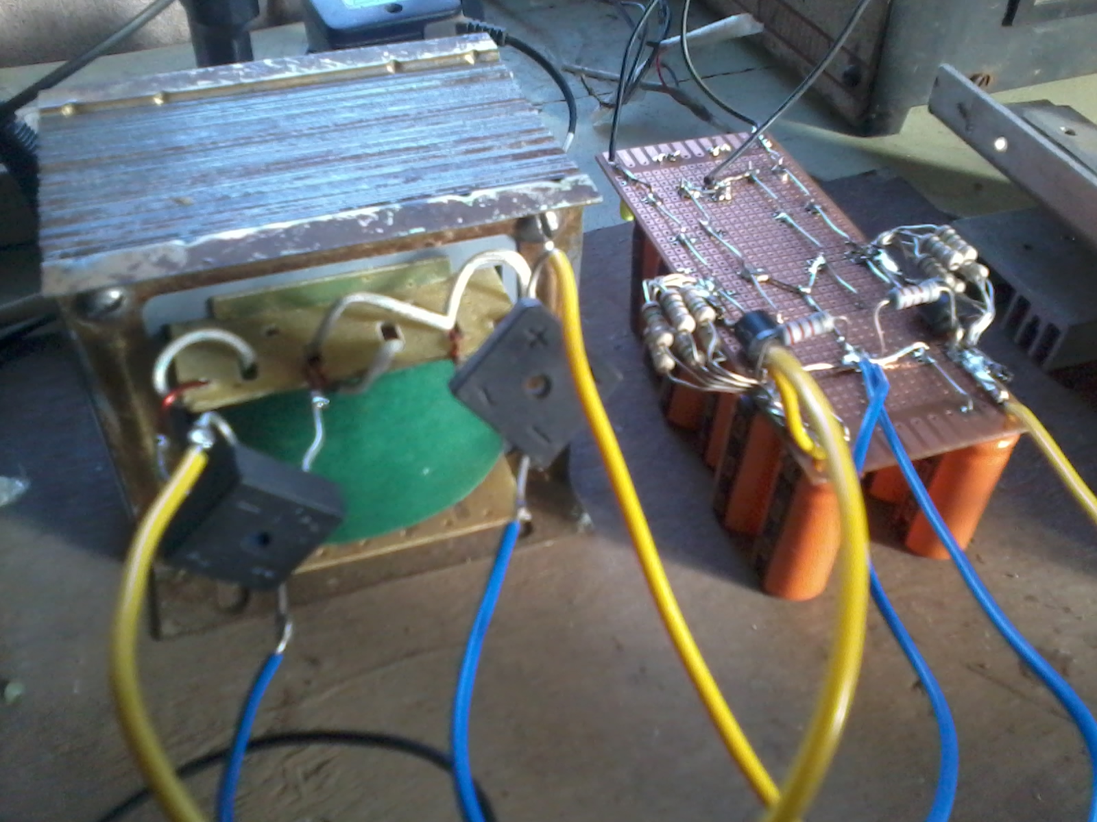

Does this occur when loaded or only when unloaded?simply14prem said:I called it a BEAST, I have never design a psu like that. There is a slight problem--There is a very small voltage imbalance in two of the secondary (dual secondary), Any method to level them, or should I rewind the transformer?
Are the bridge rectifiers exactly the same model for both secondaries?
You can try snubbing the transformer secondaries (2u polyester + 50R variable resistor makes adjustable RC's) to remove noise. Try it first on your "too high" side.
Can you post a photograph?
Fairchild Stealth are suitable, well behaved in linear supplies and extremely fast, but 8 of them are more difficult to install than a pair of KBPC1004's.simply14prem said:Do you know any fast acting bridge diodes?
Xformer have been rewinded as it is EI, so I love winding it in bifiller.It's cool now except the spark when power goes off.

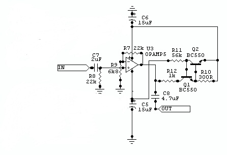

1.I will try 680+120=800,for the FB shunt R.
2.Put a buffer from NE5534, with or without the Class A biased transistor.
I think my amp is still muddy.I need to tweak it.
Also Daniel, I can't find any 2u to use from rail to rail, so sad.
Plz check these buffers ,,actually i like the one posted.Plz recommend me a good buffer.

Sparks? That's construction error. The connections are a bit flimsy and voids are causing sparks, so you need MUCH THICKER traces (probably needs reinforced with wire and solid soldering).
Also, the pi filter resistors need to be paralleled with minimum pin length and not look like a fishing net.
I think I see a ground loop that might cause dulling, so that needs fixed. Hey, I've made a drawing for you.
The green traces have the conductor Thickest to Farthest caps.
