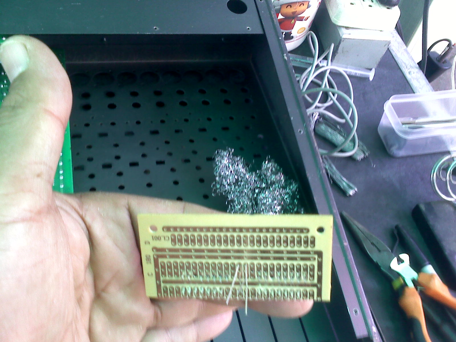

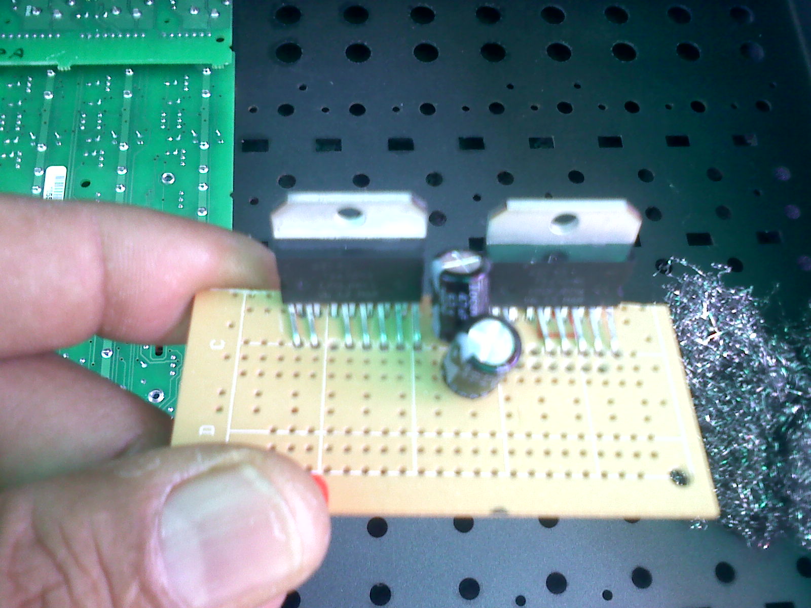

i´m trying now with a perfboard that i get locally
its got traces like to use dip ics, but i have your pictures,
and will try to follow your guidelines and the circuit you
made.I have to let aside the bridged amp and going to
start with the parallel 7293.
i´ll post images and comment how it sounds.

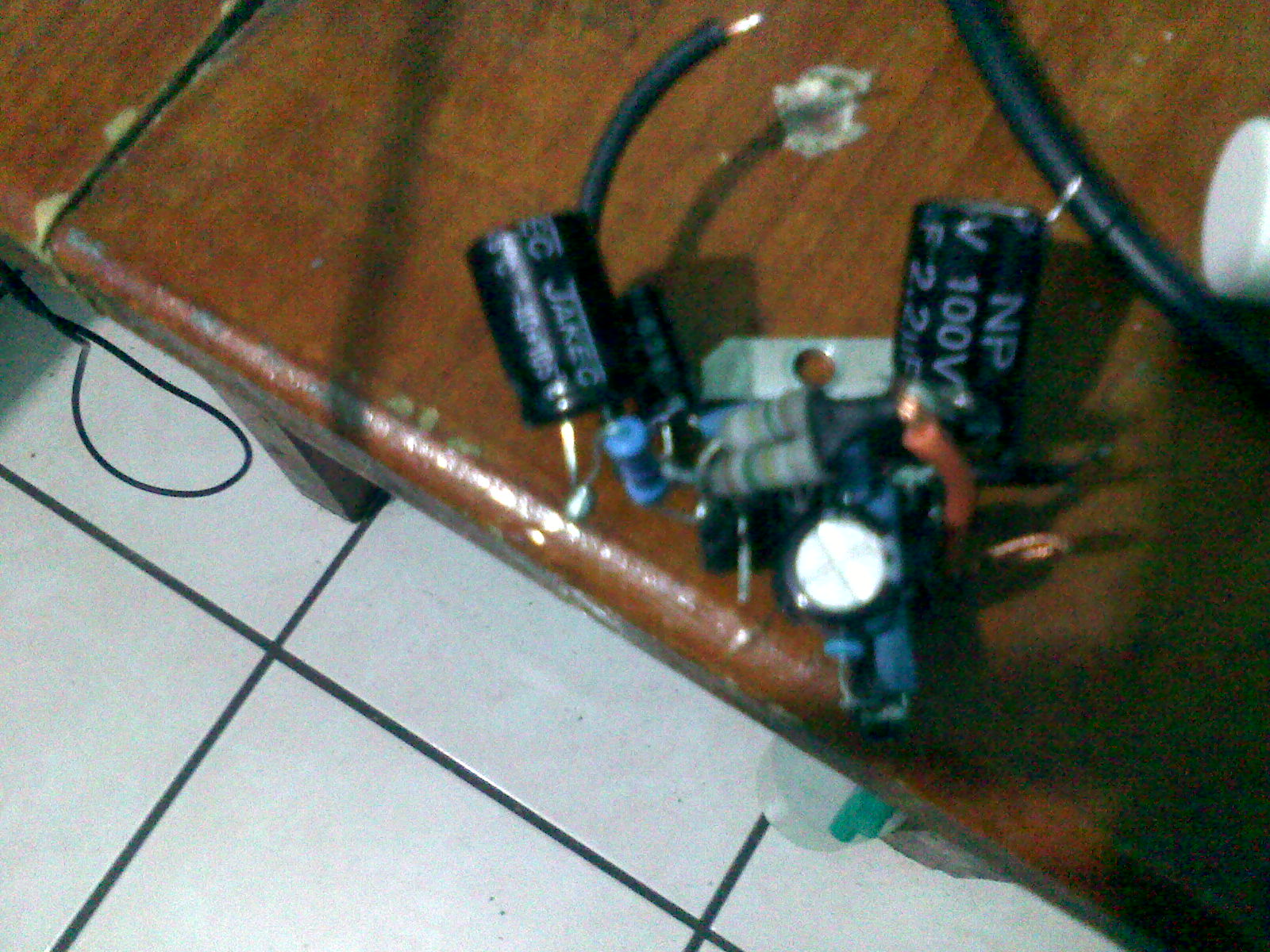

this is what ihave
:cool:
dead suspect of a fAKE!
Little table radios using that "fake" (re-mark) chip usually cost in the range from $50 to $380, depending on the skill of the marketeers. When it is re-marked to TDA7294, identification is practically impossible because the IC chip package is the same. An adequate defense seems to be to start up the amp with the Light Bulb Test and also a 12+12vac transformer. If it works at the low voltage, but not at the high voltage, then you've identified it.
For this reason, I prefer the TDA7293 chips, and see if the clip indicator pin works, which it tends to do on authentic chips.
