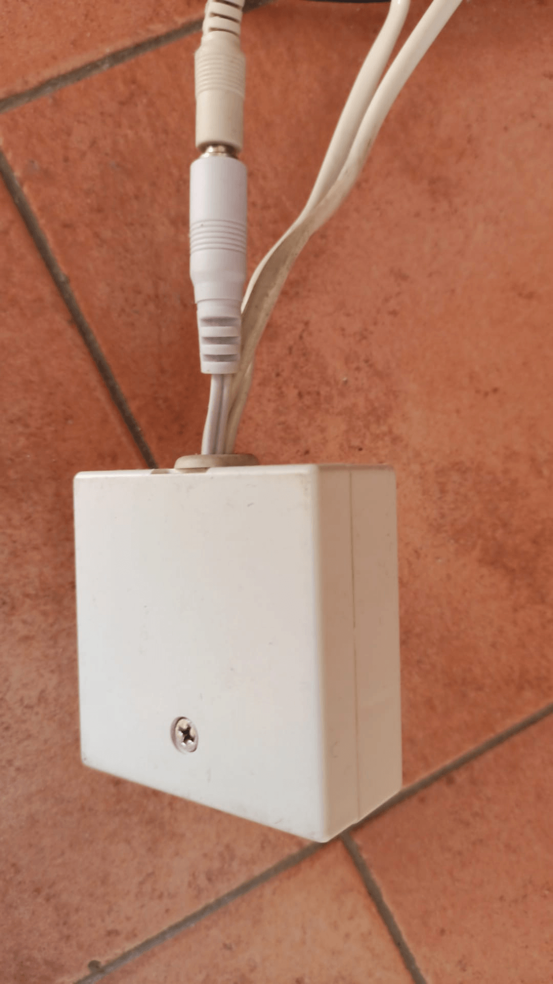

Finally, I replaced the Mosfet IRFZ14 and all the power supply capacitors, circled in red the notorious bad boys, then the others, I spent less than 10 euros using FR or FC series from Panasonic (but the important is they will be other brand no made in china, with low impedance 105C) and added a heat sink using one made from an old Slot1 processor. As you may have also noticed, the PSW110, and similar PSW111 and so on, always stay on, so I bought a 5V relay and mounted it inside a PVC box, I connected a wire to the relay coil with a connector, one of those circular standards for DC power. To give voltage to the coil I can use either a small 5V power supply to be connected to the amplifier service sockets, sockets that I have on the Sansui integrated amplifier, or, if it has no service sockets, as on the Onkyo AV tuner, I have also purchased an adapter cable that draws 5V from the USB socket and terminates in a circular DC power connector. The alternative simply solution is using a multi-socket extension cord with master switch for the AC power, for both the amplifier and the sub, and switch both off when not in use. I think now the SUB will last longer than me.Buon lavoro compagno. Ho lavorato su alcuni di questi amplificatori a piastre Polk e il 90% delle volte trovo mosfet e condensatori difettosi Sostituiscili e di solito sei a posto. Ma sembra che tu abbia anche un altro problema. Per favore aggiornaci quando lo trovi.

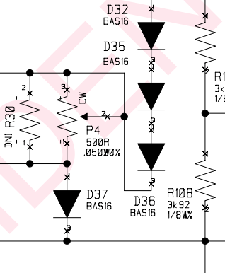

Hello, would someone be so kind as to tell me the value of the preset "P4" and what it adjusts? I don't think the schematic is available, I've been looking but I haven't found anything. Thank you all very much.
Sorry for the insistence, but please, someone in this post or another who has a plate of this model at hand and can confirm the value of the preset "P4", in my case it is melted by the heat of a capacitor that overheated and I am unable to see it, nor can I measure it, it is open. Thank you very much.
