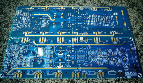

Everything is well labeled. You'll be likely be getting a set of jkuetemann's boards which are pieces of art. There is lots of support in the Slewmaster thread or jkuetemann's build thread.
it's official
proud owner of slewmaster os + cfa input boards
2 mono block 500watt monster build begins

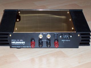

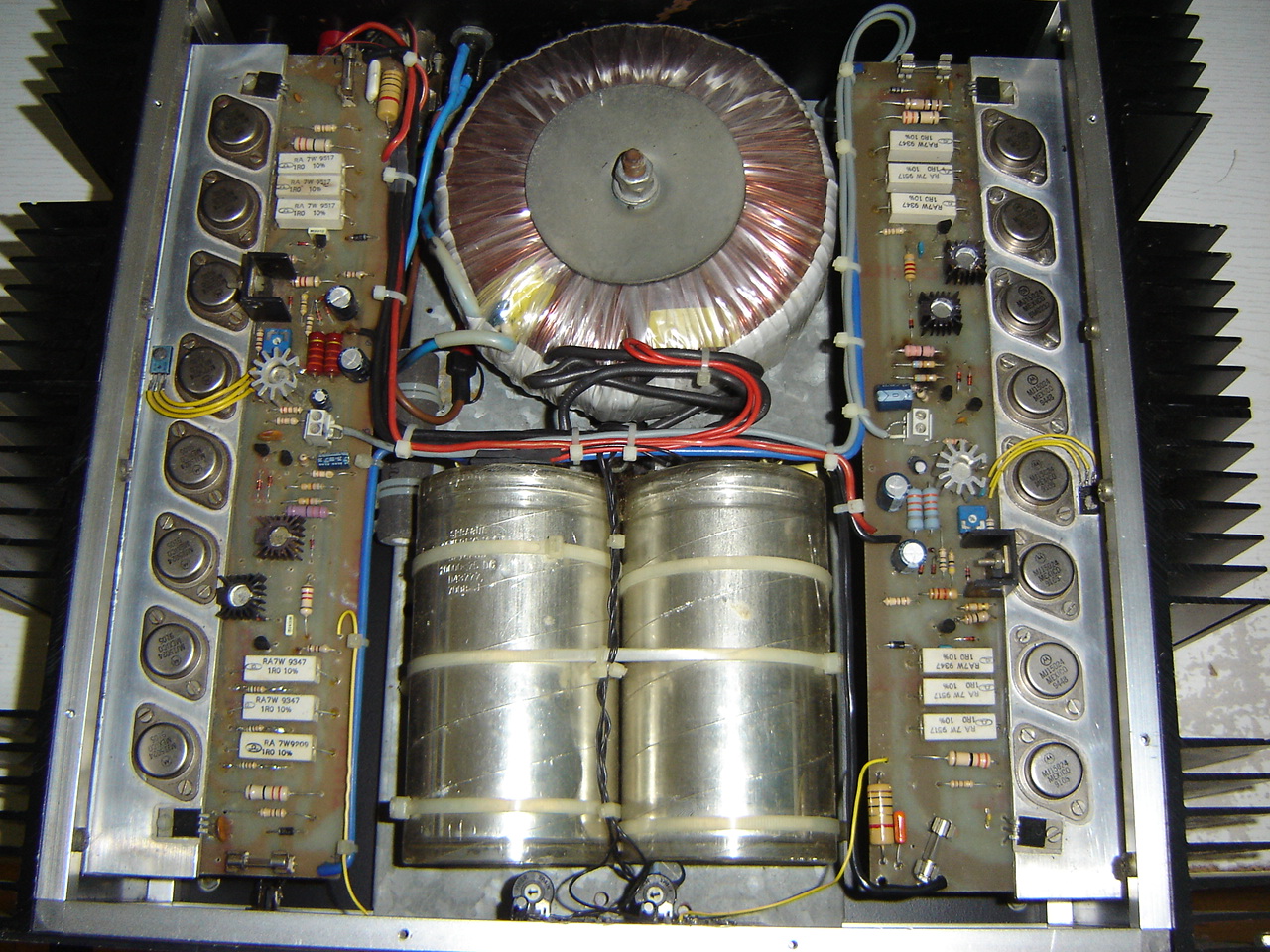

Home made power amplifier from year 1993

without software for pcb, all with pencil and hands,...
Yummy , 4 pair TO-3 BJT.
True DIY (by hand).
PS - but only 3 pair emitter resistors , one pair to-3's are drivers ?? 😱
OS
TRUE DIY!IT LOOK LIKES THE OLD PRODUCT!

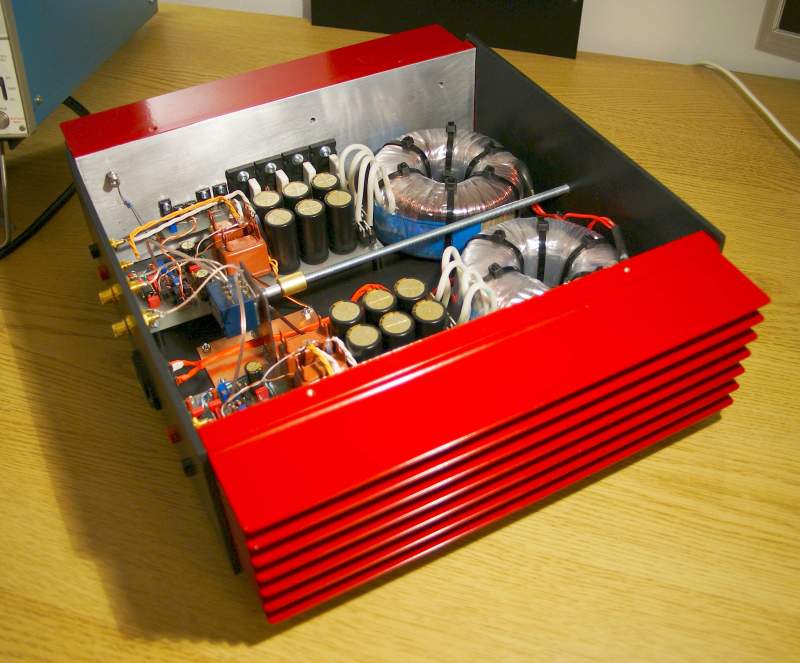

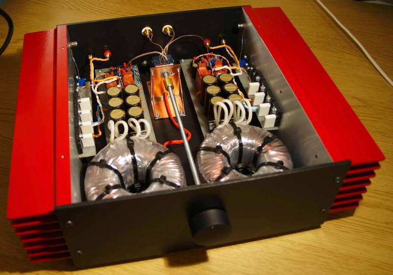

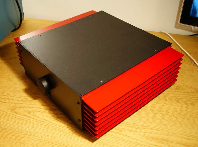

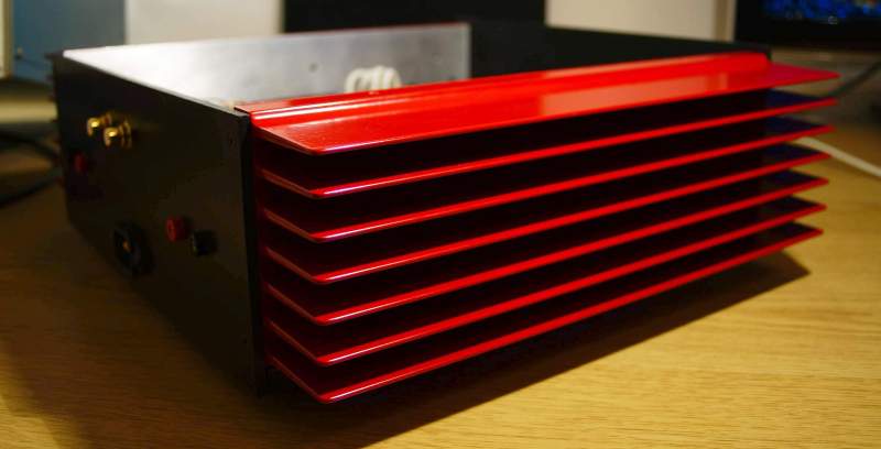

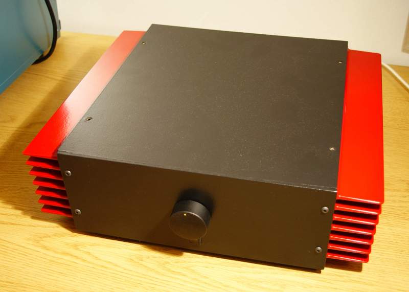

Now comes AndrewT and will scold location of heatsinks 😀My amp... 🙂
Heat sink are enough for this type of amplifier and yes the look pretty neat
In general though having the output stage wired like this while the input stage lays next to the power supply is bad practice and will effect the amplifier some how
Heatsink: yes I know but they are left-over so I had to use them somehow and I didnt wanted to slice them.
With average load they go up to 75C°... With a little fan -20C... So the airflow is pretty bad. 🙂
But I hope the high temp will produce high quality as a side effect... :-D
Layout: I had many other issues with the stability but nothing bad experience with this wiring!
And now it is rock solid finally.

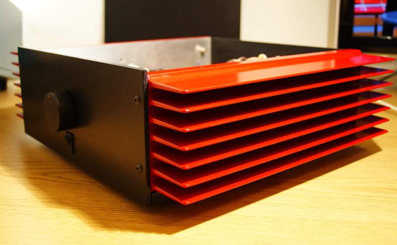

Jaco wat wys jy vir die mense , Is dit die heatsinks wat horisontaal le ? Ek wonder as jy in die boonste vinne gate boor dat daar konveksie verkoeling kan wees. Dit sal mos werk.
Is it because the sinks are mounted horizontally. Drilling a few holes at the top will increase convection flow of the heat. Looks great. !
