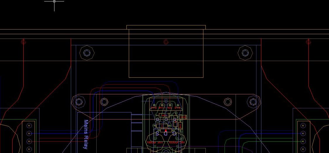

Thanks Uwe.
Attached is a screen dump of the rear end of the case.
Light blue is the Cradle on which the main transformers (in light purple) sit.
Red are the output speaker terminals and cabling route.
Pink is the outrigger for the regulator heatsinks in grey, but they are way above.
So are the wiring to and from the regulators.
The IEC is the rectangular blockin the middle of the picture in beige.
There is a 10mm gap between the back of the IEC and the transfirmer.
So a bit tight, but not impossible.
There is another 5mm or so more space when using the PowerCon.
Patrick
