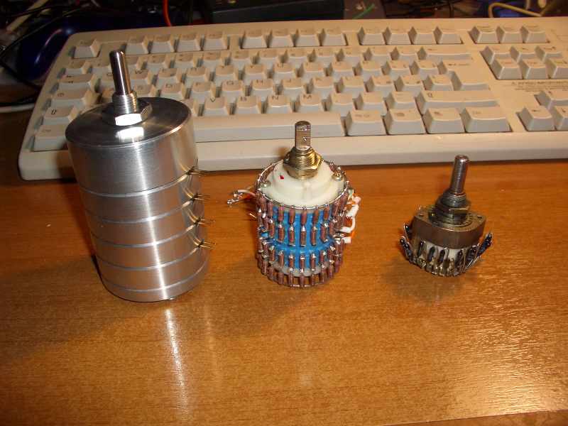

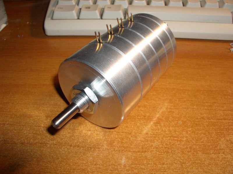

I owned Alps, Noble, Penny & Giles, Elma & Shallco. The best one is Shallco so far (tracking, less contact resistance, more life rotational switches, etc).
new for me - thank you very much for this advice. Until this day my favorite brands are Penny & Giles by the attenuators (potentiometers) and Elma by the rotary switches.
1) Audio Attenuators and Networks:
Shallco - Attenuators
2) Precision Rotary Switch Products
Shallco- Precision Rotary Switch Products

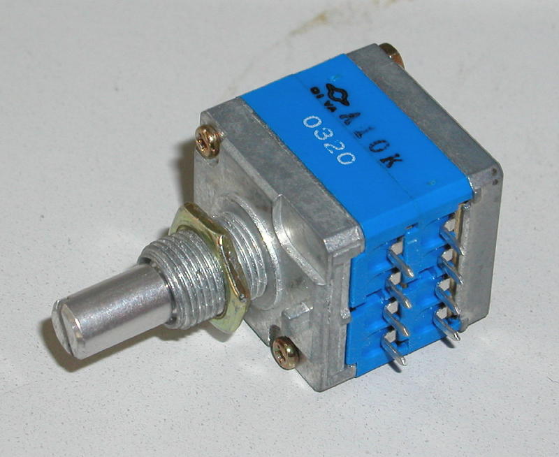

bourns sound great but bad tracking. blue alps has good tracking (0.3dB over a 40dB range) and decent sound. a bargain champion. TKD 2500 are the best i measured ( better then 0.2dB) and the sound is a bit better then the alps. more open and less artificial.
