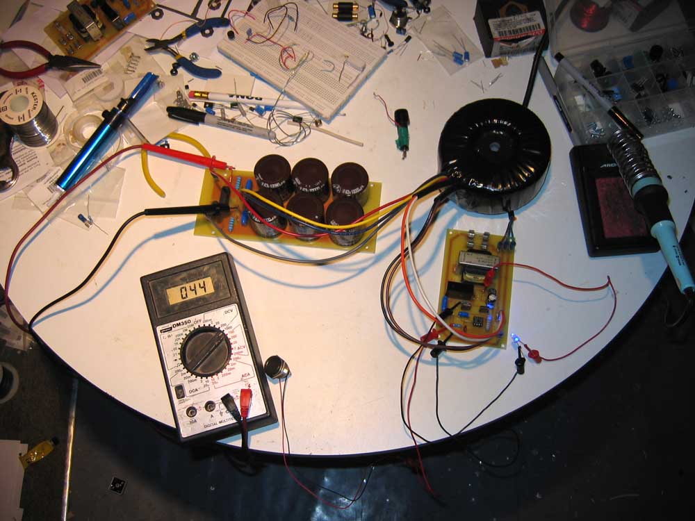

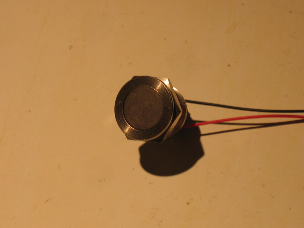

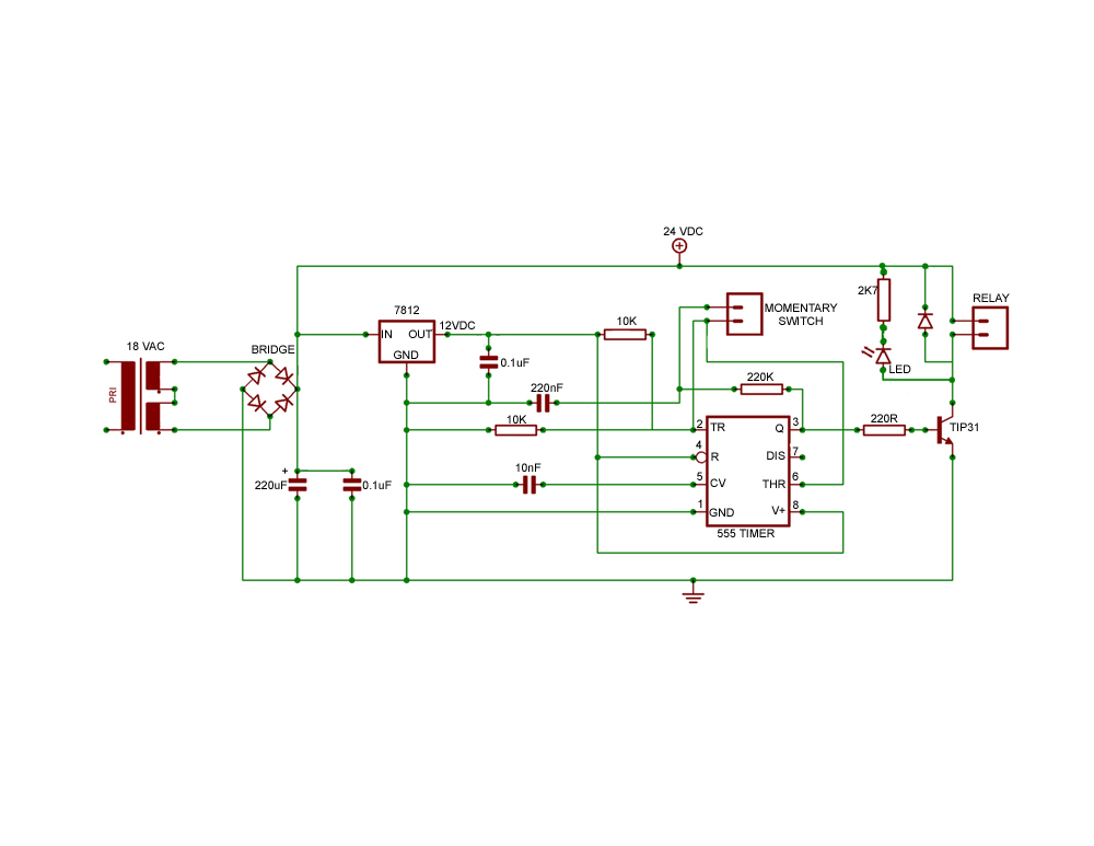

Cool Power Switch
I found these awesome looking switches but they are momentary, no good for amps. Then I thought if Quasi needs 24V for protection circuit, why not use the 24V to set up a momentary on/off cicuit? I just love the look and feel of these switches. So...

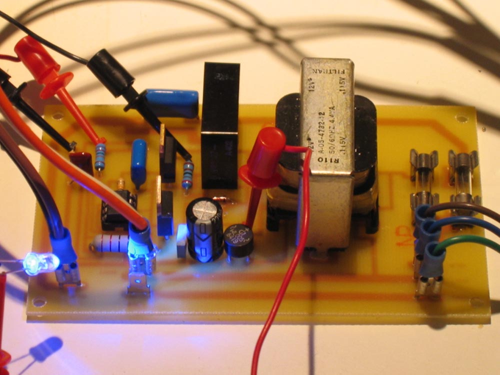

Re: Re: 24 Volt Supply with momentary circuit
Everybody seems to be getting along well together. The momentary control circuit on the board should be flipped so the relay's contacts are in line with the other AC Lines I went and routed the AC power around the PCB to the relay. Also it may be better to build a larger board and include a soft start cicuit. It is not really required as the XFMR for each channel is 400VA and they will be turned on seperate from each other.
Now where are those Toshiba Devices...
I am learning as I go along here and I hope you folks find it useful to see these things?
Shawn.
Shawn.

You can run the the circuits as they are with a 12 volt relay by using 12-14 volt rails. The switching times will increase but they can be reduced again by reducing the value of the timing capacitors.
Or you can run everything on 24 volts and just put a resistor in series with the relay. The value of the resistor should be the same as the resistance of the relay coil (or slightly less). This can be done for all the relays you use..
Cheers
Q
