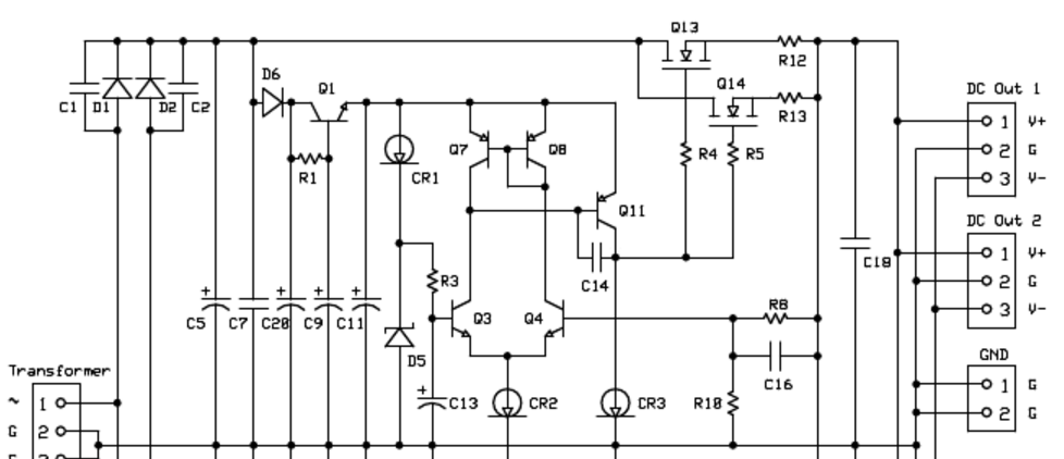

I was thinking the OP might decide to build voltage regulators a la the Levinson ML-2, in which case 10 milliohms at 10 Hz is eminently doable.
Regulated supply options
A pair of σ22 supplies would probably work well The σ22 regulated power supply
I'm not a big fan of un-degenerated current mirrors, as used in the sigma22 regulated power supply. (example: Q7-Q8). Mismatched VBEs can twist an un-degenerated mirror quite badly.

I don't understand what you mean by "twist?" Poor regulation? Noise? High sink / source impedance?

Resistors connected in series with the emitter leg are called "degeneration resistors", see Bob Cordell's power amplifier design book Fig 2.5b and/or section 3.2. In a current mirror, degeneration resistors ameliorate the errors ("twist") caused by mismatched transistors. Try it in circuit simulation such as LTSPICE.
But what's important here is that a multi-ampere voltage regulator with reasonable amounts of gain and reasonable amounts of negative feedback, is likely to provide an extremely low output impedance when powering a class-A amplifier. Much lower than the impedance guideline suggested in post #82 above. Just avoid obvious circuit design errors like un-degenerated current mirrors.
