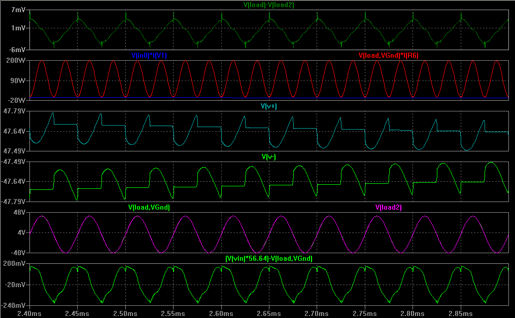

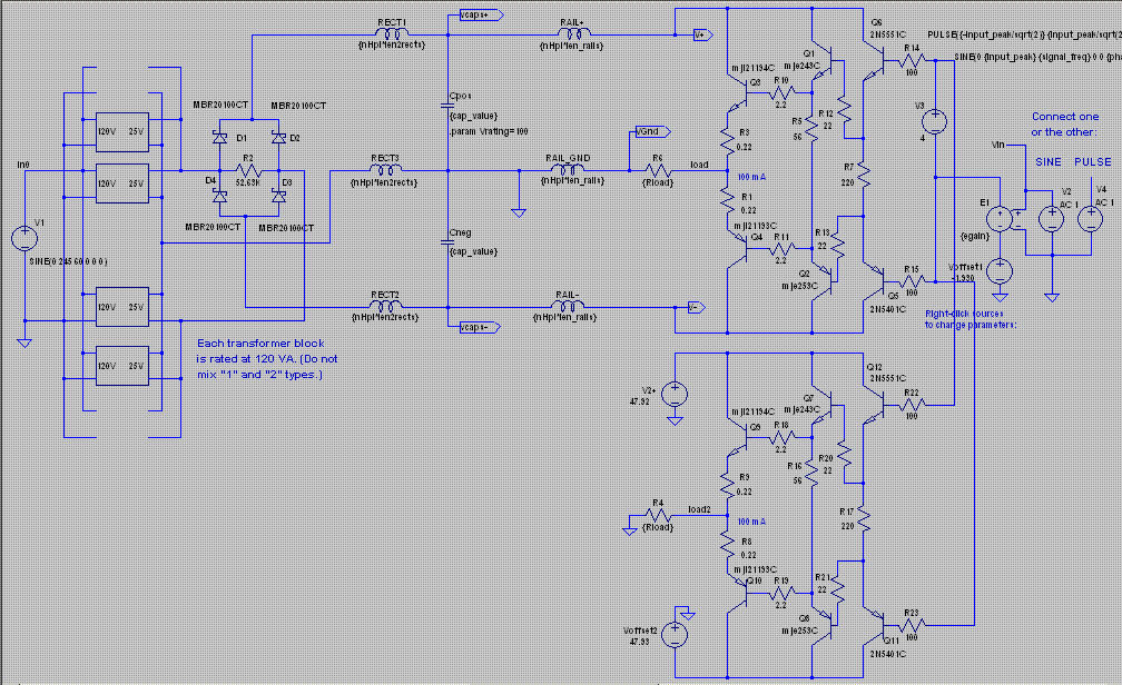

Just to add a tangent to where the conversation is at the moment, because my belief is that the perceived quality of an amp is due to how well it handles the high frequency stuff, and also that I wanted to show a simple technique for comparing different approaches, here's a variation on Tom's latest test jig:
Note that the original circuit still stands, but I've duplicated the circuit loading the power supply, hooked that one up to perfect voltage sources, and am now driving both versions with the same signal. This makes it easy to compare one scenario with another, without having to worry about comparing the output to the input. And here are the results, driven by a full bore 20KHz signal:
The top waveform, which shows the difference between the signals across the two versions' loads indicates where the problem is using class AB with real rather than theoretical supplies: nasty glitches, at very high frequencies, at the time when the current draws through the active devices switch off, ie. crossover artifacts. This of course will be supposedly corrected by feedback, but if it can't quite do the job properly because the supply is glitching at the time, then things might start looking, and sounding, worse ...
