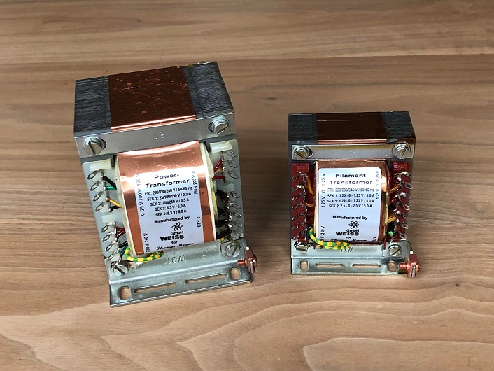

@Tom: separate filament transformers are a must, as with DHT's the filament (= cathode) is audio.
Do you mean separate filament transformers or separate filament taps? As far as I know the vast majority of amplifiers have a single power transformer with a separate tap for each DHT. IDHT's can generally be heated from a single common tap.
I thought that if you wanted to heat the tubes before applying the HT this can be achieved by in a single power transformer have two switches. One on the primary side and another on de center tap op the HT winding.But, also for the sake of start up, a separate filament transformer is best.
Tom
Hello Johan, I hope I read your message right. I agree that the power transformer is not in the signal path and should not have a impact on the sound quality as such. However there are in my experience (solid state amps) 'qualities' such as quiet operation, minimal stray fields, isolation form mains noise that do have an impact on sound quality. Although not backed up by empirical evidence (never had the opportunity to try) I have a suspicion that running a core a high flux density to improve efficiency also has an impact on sound quality.Not to expand this to a design discussion, but I must respectfully disagree with Schmitt 77 regarding the 'sound' influence of a power transformer. A transformer provides the neccessary voltages; the dc after rectification and filters is determined by everything, and any single source has its own heavy enough bypass capacitor. Unless transformer windings are so thin as to influence regulation, I fail to see how the power supply proper is anything but plainly a dc short at audio frequencies.
Tom
Hallo Tom, groeten vanuit New Zealand.
Here in New Zealand not even winders are easily to be found. Why not buy a Hammond transformer from Mouser? Above 100 USD they'll ship for free and that is cheaper than anything you can wind locally. Make sure to check out the way they calculate the load capability.
Hallo AmadeusMozart, bedankt! Hartelijk groeten uit Haarlem
I checked the Hammond catalogue and they do have a model (302AX) that would suit my needs (correct voltages). Price is 147,- euro and shipping is indeed free for orders over 100,- euro.
With regards to the load capability. The examples they provide are all for solid state diodes, and I plan to use a tube rectifier. Now, I know that a tube rectifier has a significantly larger voltage drop then a SS diode, but does a tube rectifier also impact the current capability?
Tom

Hi Tom,
you're comparing a two-way silicon diode rectifier vs. a two-way tube rectifier, don't you? Just because a bridge rectifier is another story with respect to transformer efficiency.
The type of rectification per se won't affect current capability. A given DC current yields from the same AC current in both cases. But: With respect to the higher voltage (i.e. power) losses in HV rectification, you'll either need a bigger transformer (the best, hence preferable solution) or you'll have to wind more turns (for higher AC voltage) onto the same core and bobbin. Thus you'll use thinner magnet wire to cope with the given space. And this, of course, will affect the transformer's current capability.
Best regards!
Calculating the proper type of power transformer is difficult even for experienced builders.
You need to purchase a transformer which is designed for your circuit and labeled to provide the voltage range you want for the type of rectification.
My advice: dual power transformers is very difficult to build and lot of noise and problems can occur. I could never complete an amplifier with 3 power transformers which integrated a dedicated pre-amp and 2 mono for power sections. The ground path always carried hum no matter how I would route it.
Valve rectification is harder to build, it is noisier and you need a bigger transfo. For a start use solid state if you are not comfortable with grounding and tube rolling, some tube rectifiers can make more noise.
Make sure you decouple the vibration noise from the main transformer, it will reach parts of the amplifiers and create noise, even if you cannot feel the vibration it will reach tubes and parts.

IMO the keyword here is "commercial".
Virtually all commercial available "off the shelve" transformers are wound with core excitations around 1.6 T.
Completely understandable as this way cost is cut (less material; less weight).
However, with core excitations approaching core saturation, risks are lurking.
Many commercial transformers are mechanically not silent (to put it mildly...).
Apparently the quality of impregnating is insufficient; I am pretty sure that not many commercial transformer companies apply the way of vacuum impregnating the way Goatguy describes as it would make a more expensive transformer.
Besides, high T transformers get rather hot as secondary power is about what the core can deliver.
Last, but maybe not least, strayfields are strongest with high core excitations.
To overcome, or maybe better put, prevent these problems from happening, in my (and others, like Tony) experience it is good practice to choose for lower core excitation; 1T is a nice upper limit.
This lower core excitation however is not so economic: for a power supply transformer with 150VA of secondary power a core of some 300VA is needed 😱. Winding for lower core excitation requires more primary windings, so the larger winding space of the 300VA core is needed to have enough space for primary and secondary windings (apart from single or multiple screening).
At the end of this low T power supply transformer we have the advantages of:
- a cool running transformer (think of nearby electrolytic capacitors not liking heat);
- a transformer with minimal strayfield;
- a mechanically silent transformer (vacuum impregnating still necessary but less critical as the whole thing is less vibrant to begin with).
The story above applies to EI, c-core and toroidal transformers, with some peculiarities typical for the type:
- EI laminations are "loose" after assembling so good quality impregnating is very important;
- c-cores are impregnated during manufacturing, but impregnating still applies to the coil(s);
- toroidal transformers can be a nightmare: prone to core saturation; very difficult to get silent with impregnation as windings tend to be random with much room for vibration.
I don't understand toroidal power supply transformers in (mostly) SS gear as being the norm.

as one who designs and builds power transformers, this is how it is done...
you will be surprised to know, electrical varnish have a way of penetrating in between laminations and every nook and crannies in a traffo...
proof? try dismantling a power traffo after it has cured of varnish,
the difference between unvarnished traffo then becomes obvious...
