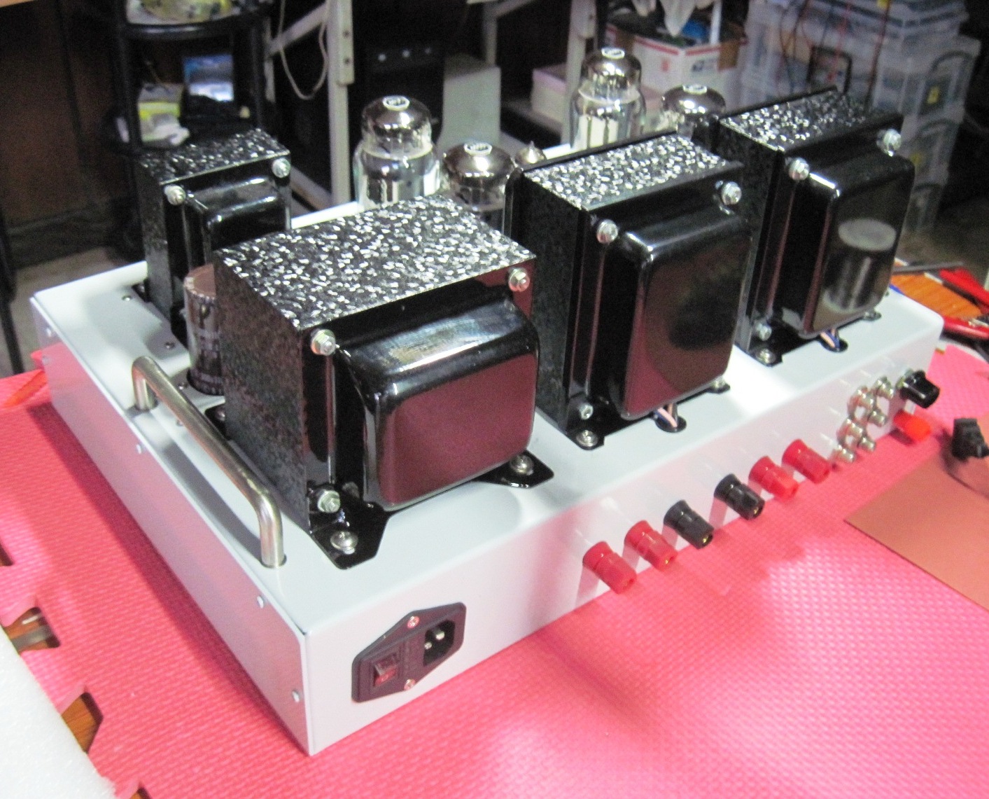

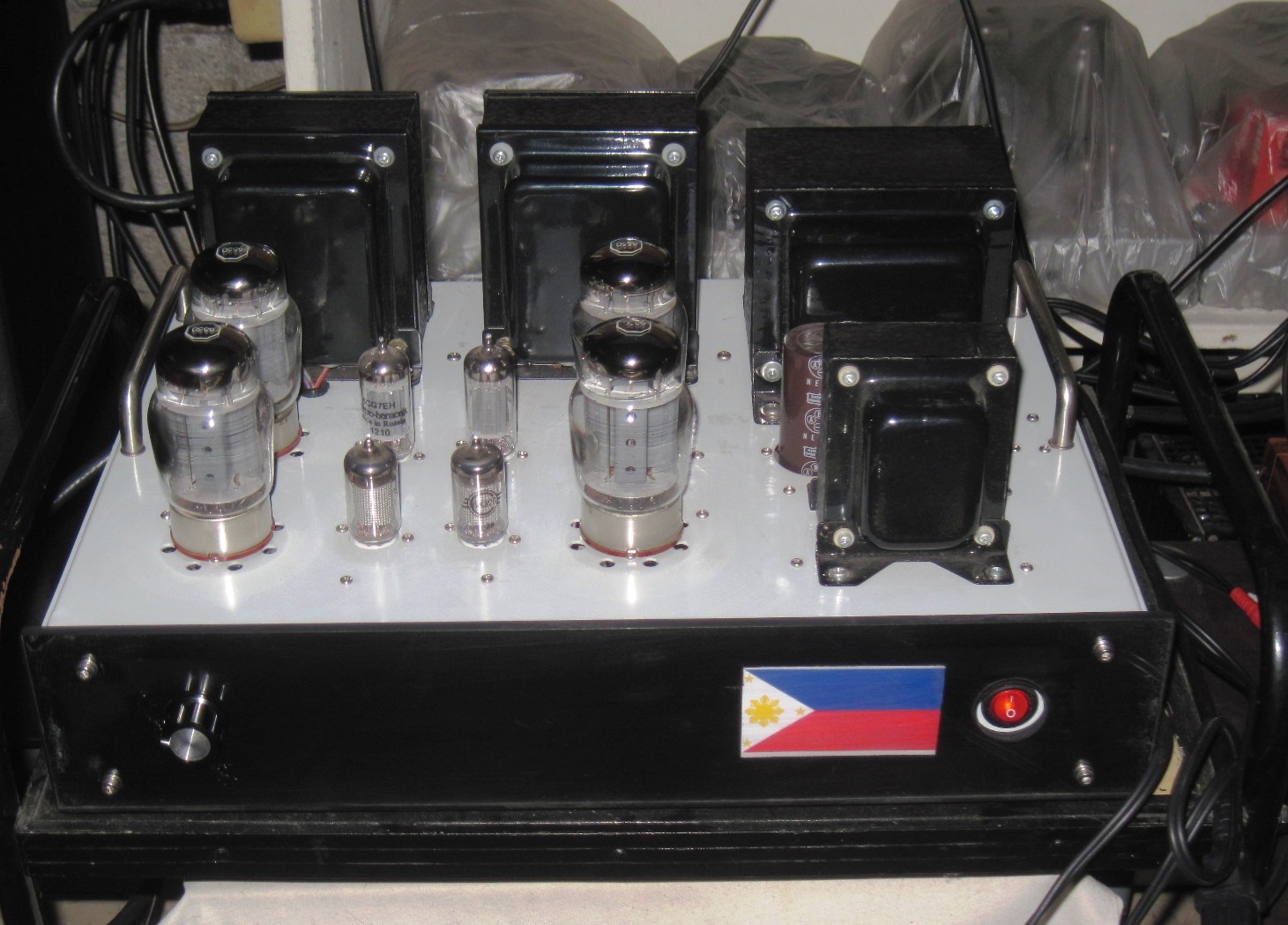

btw, this 6550 pp amp i did using RM18 grade laminations, 0.35mm laminations, barely gets warm even after an hour playing music....
