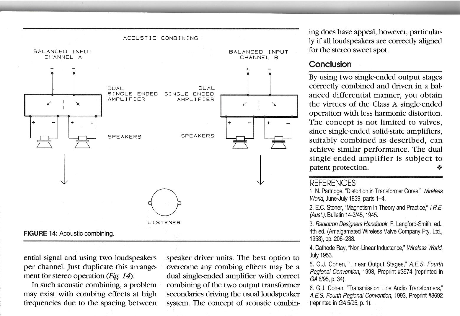

All I know about the special case push pull that uses 2 SE air gapped transformers, it "sounded" good, and not just to me.
And there did not seem to be any reduced power, reduced gain, unwanted cancellation, etc.
Of course, the primary inductance was a low frequency limiting factor, use real good SE output transformers.
It is really easy to try that topology if you have a triode push pull amplifer that does not use negative feedback.
I never heard of the French objecting to the performance.
Co$t is probably the only reason that topology is not built more often.

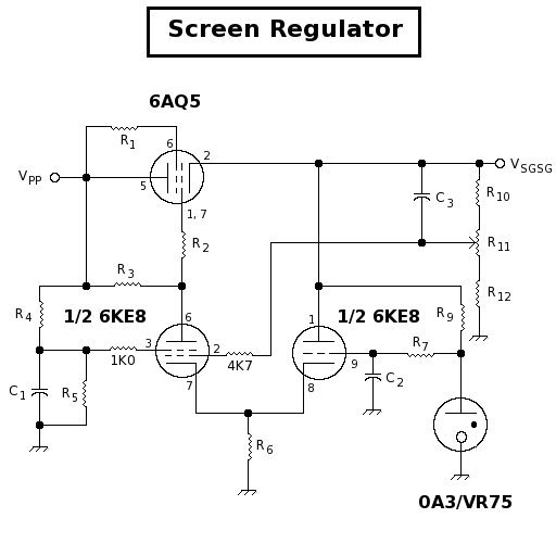

In my designs, I've always included active regulation for PA screens. In these cases, the active regulators were hollow state, but there's no reason why it couldn't be done with solid state. A "capacitance multiplier" woud be better than nothing (and considerably more than what commercial designs back in "the day" included). The main problem with the 6V6 is that it was designed to operate with the same voltages on the plate and screen. That wasn't a consideration with the 807 or 6BQ6 as these types call for screen voltages considerably lower than the plate voltages..Is use of a capacitance multiplier adequate for the screen supply, or does it really need to be fully voltage regulated? I'm thinking about where to put heatsinks...

Hi,In my designs, I've always included active regulation for PA screens. In these cases, the active regulators were hollow state, but there's no reason why it couldn't be done with solid state. A "capacitance multiplier" woud be better than nothing (and considerably more than what commercial designs back in "the day" included). The main problem with the 6V6 is that it was designed to operate with the same voltages on the plate and screen. That wasn't a consideration with the 807 or 6BQ6 as these types call for screen voltages considerably lower than the plate voltages.
Do you have a schematic of the regulation for PA screens?

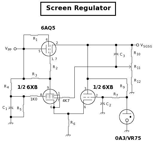

Yep (attached). This is the design I favour, and included two versions. The one that uses the 6KE8 is the design from Le Renard. The alternative makes use of a rather hard to use type that was originally an oscillator/mixer for TV front ends. Not much audio usage for a triode/pentode with a shared cathode, but just what you need for the asymmetrical LTP error amp. Have a bunch of 6X8s since people just give them away.Hi,
