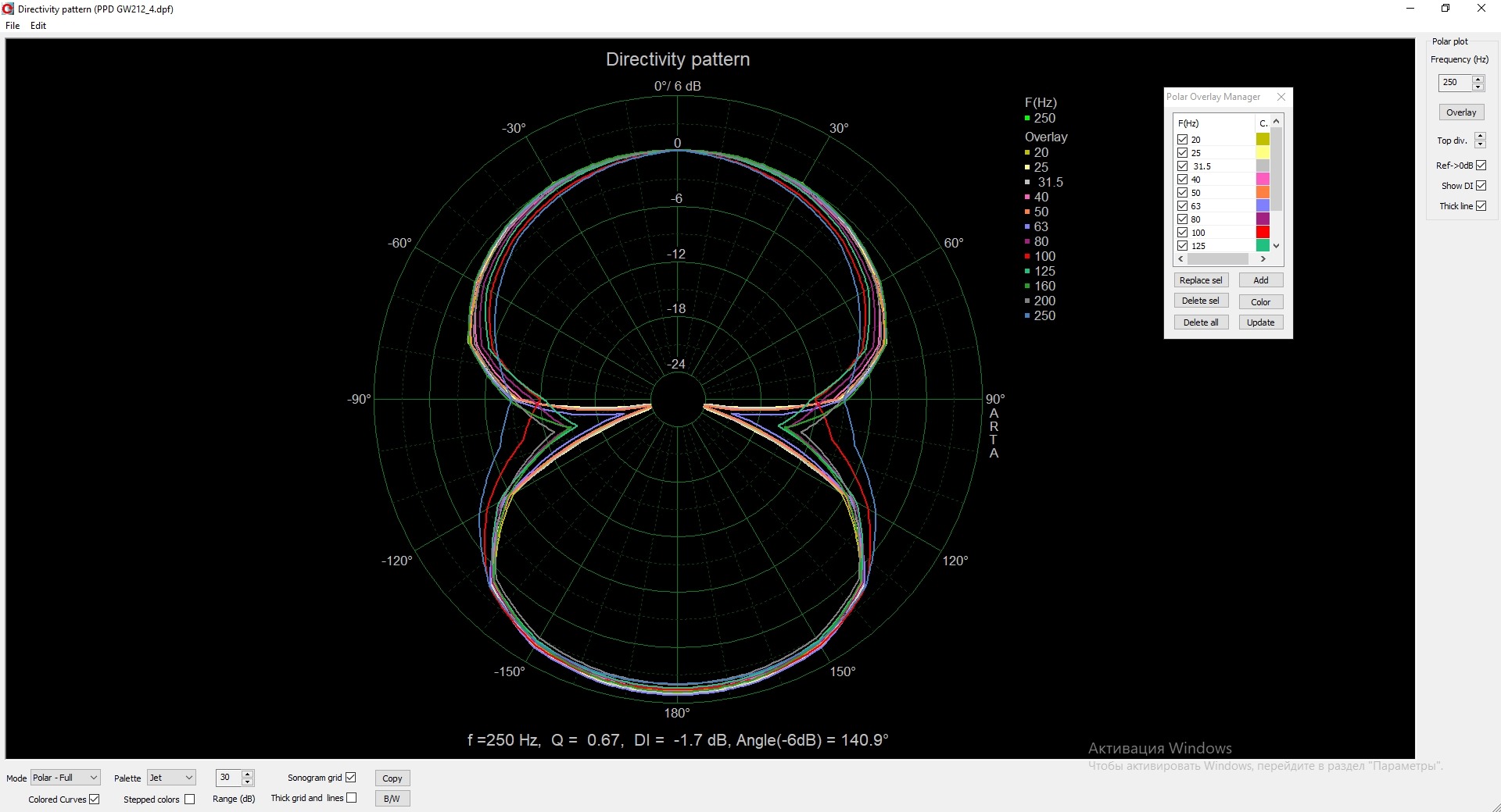

I only have U baffles to test, but acoustics will be the same. The PPD is "just" a U baffle with loading on front, and very little rear extension.

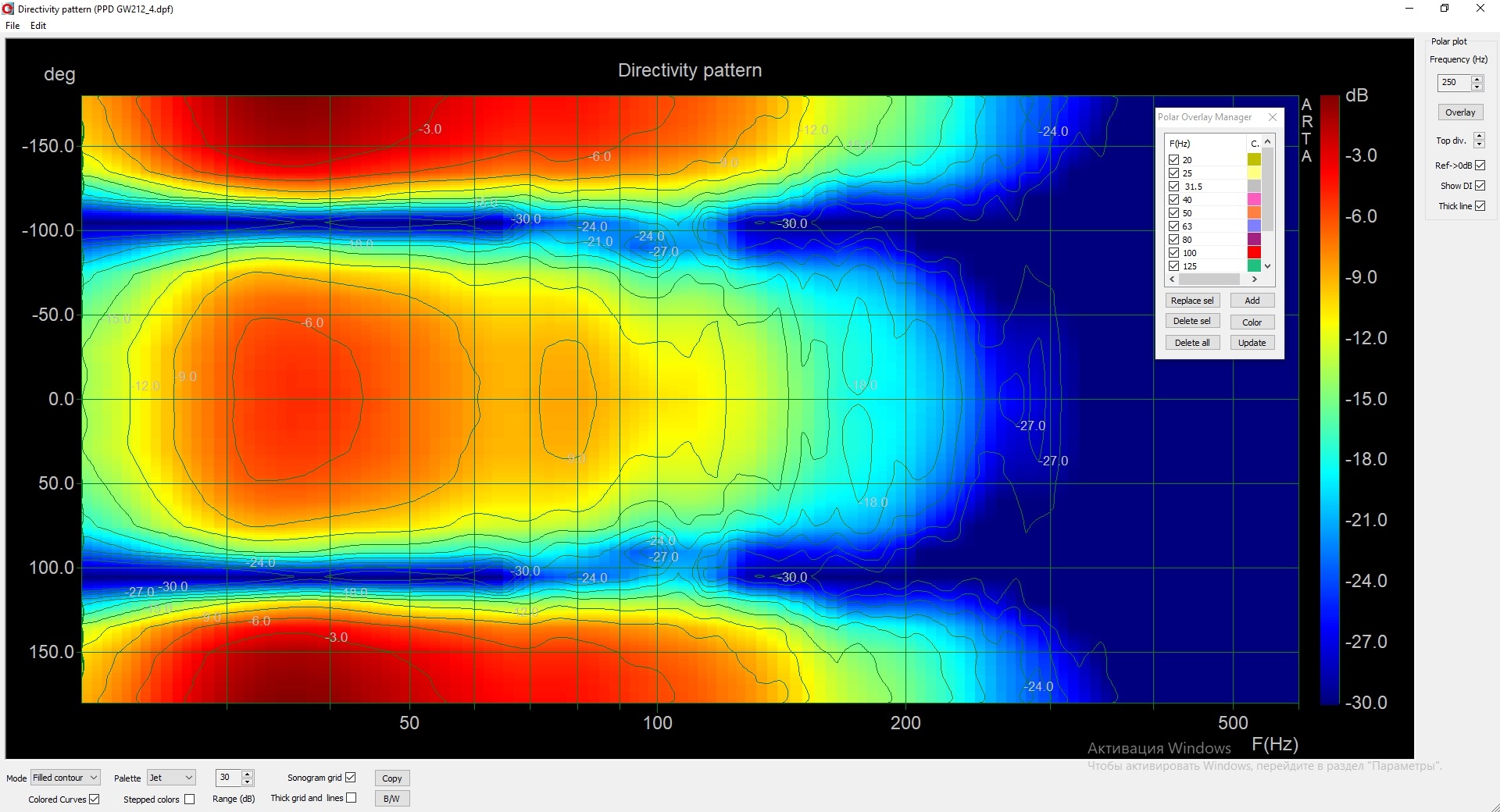

I have attached the set-up I will use. Two PPD facing each other, and woofers in antiphase. Listening position in front of the "gap" between woofers.
I'm not sure how cancellation will behave, but my logic tells me I have only have bass to the left and right and not in front of the set-up.
As far as I remember my experiment, everything was like this.my logic tells me I have only have bass to the left and right and not in front of the set-up.
Emerald Physics also makes something similar. But always stacked or side by side with multiple woofers. I'm really wondering how PPD will work with the woofers facing each other. Ripol/W/N baffle I understand, but for PPD there is nothing stopping the bass frequencies to wrap around the baffle

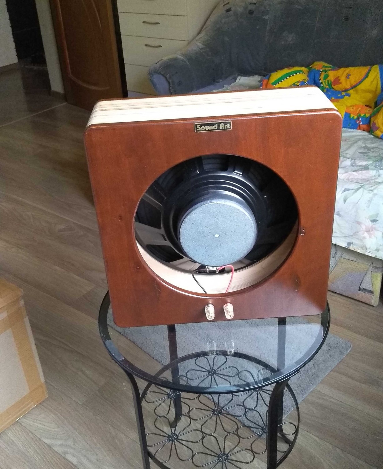

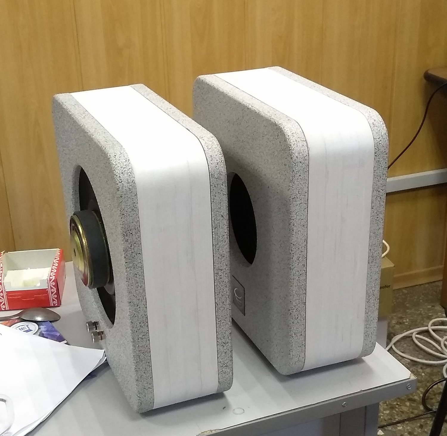

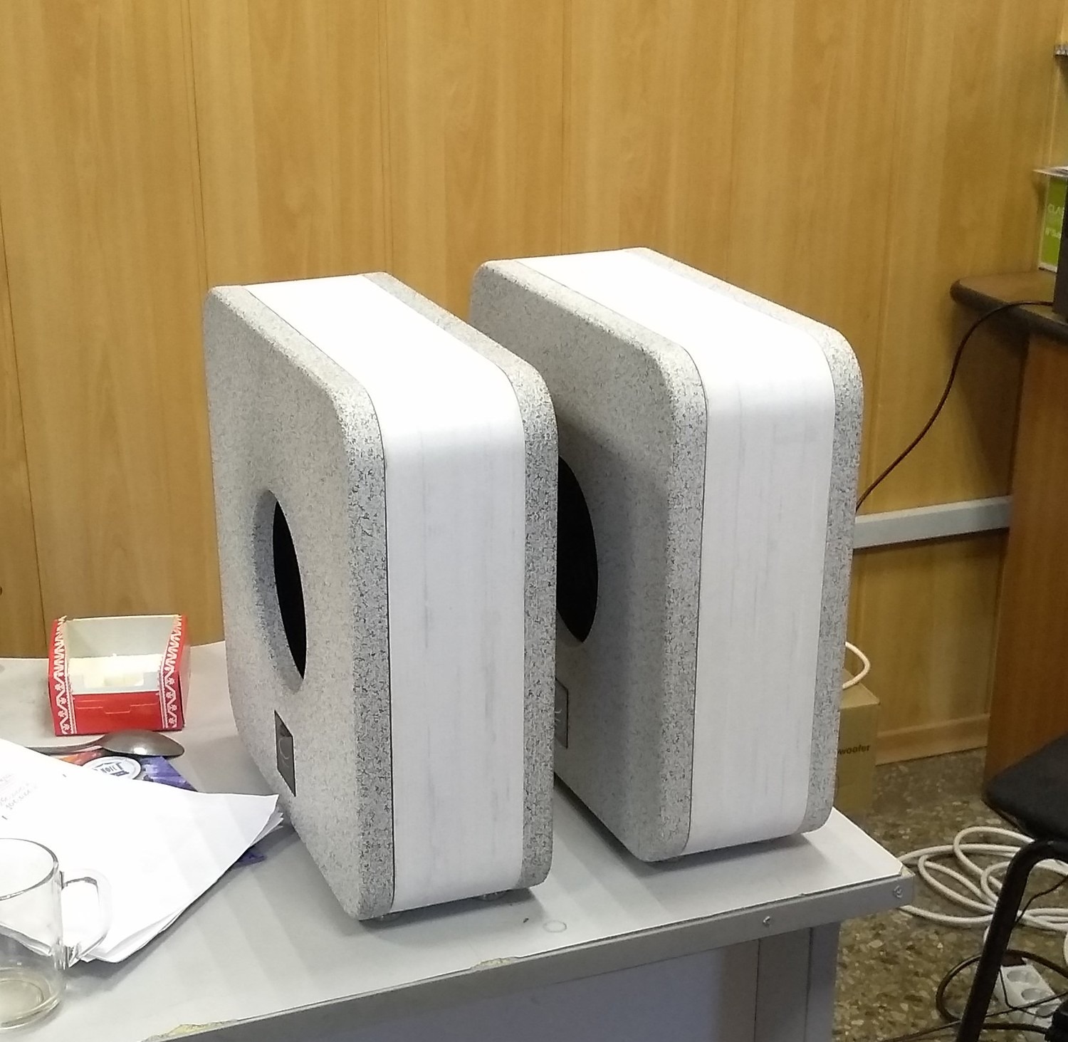

Yes, very much Ripol-like. There's a very similar design in Germany with 8" Dynavox drivers, called Dynapol. I will build that too.

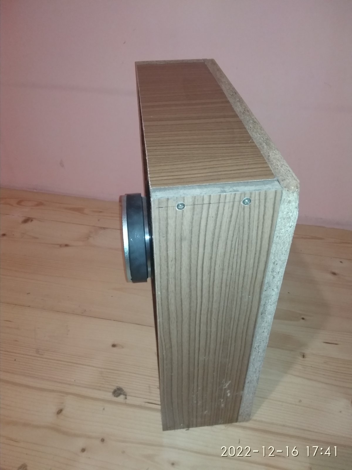

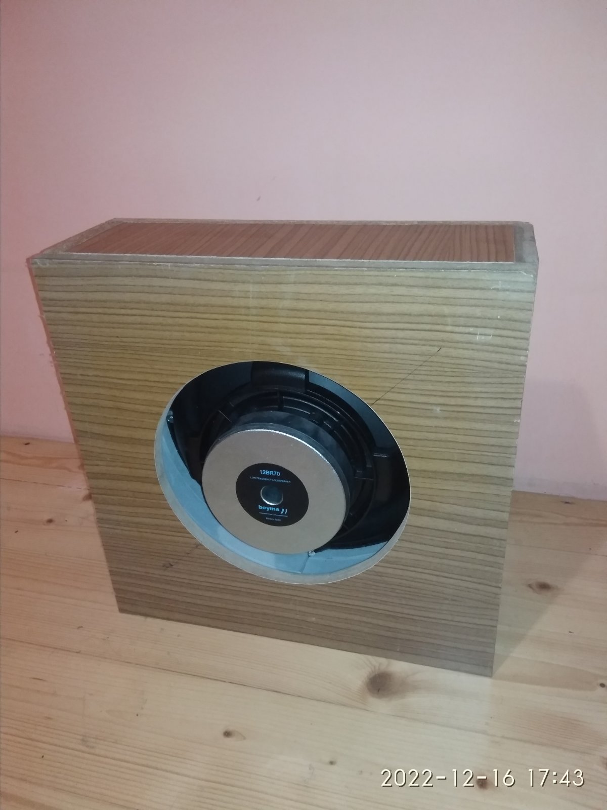

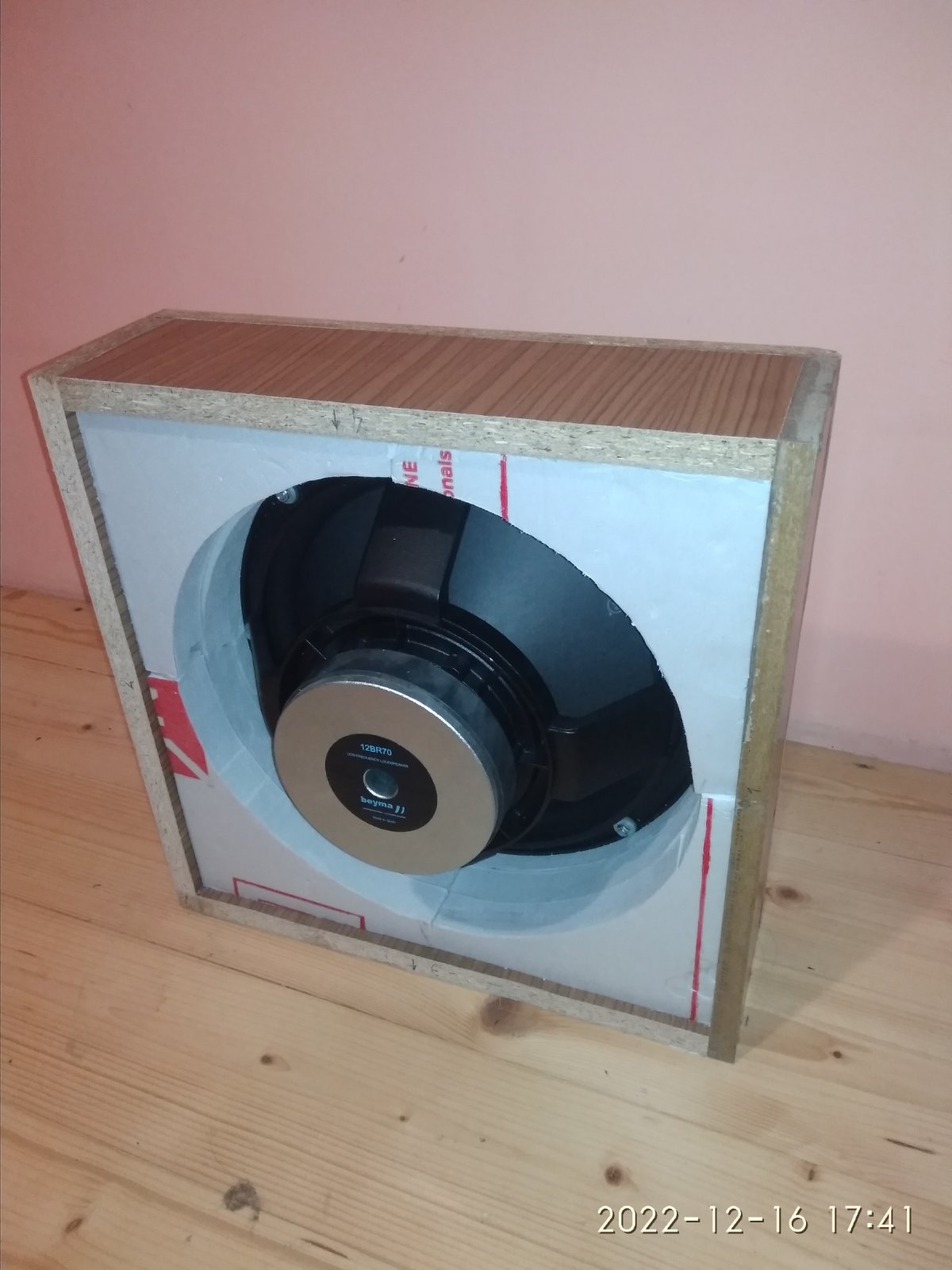

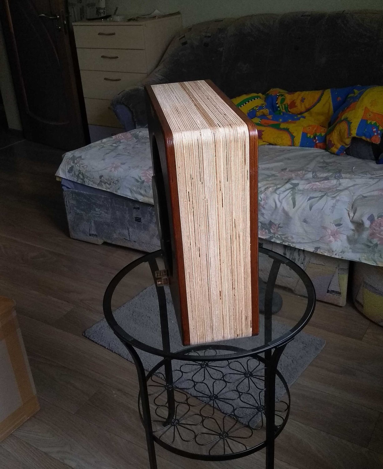

How is the performance pros cons pleaseI was already planing to build Ripoles until I found a link to here. So I made those for a 3-way studio monitor system.
What driver are you using

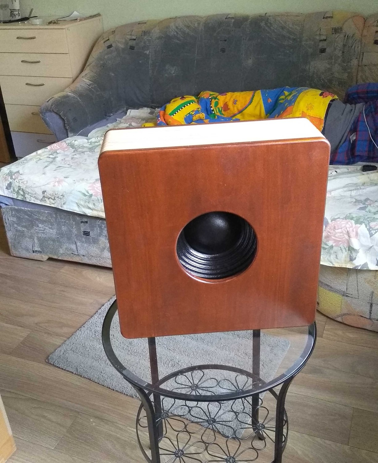

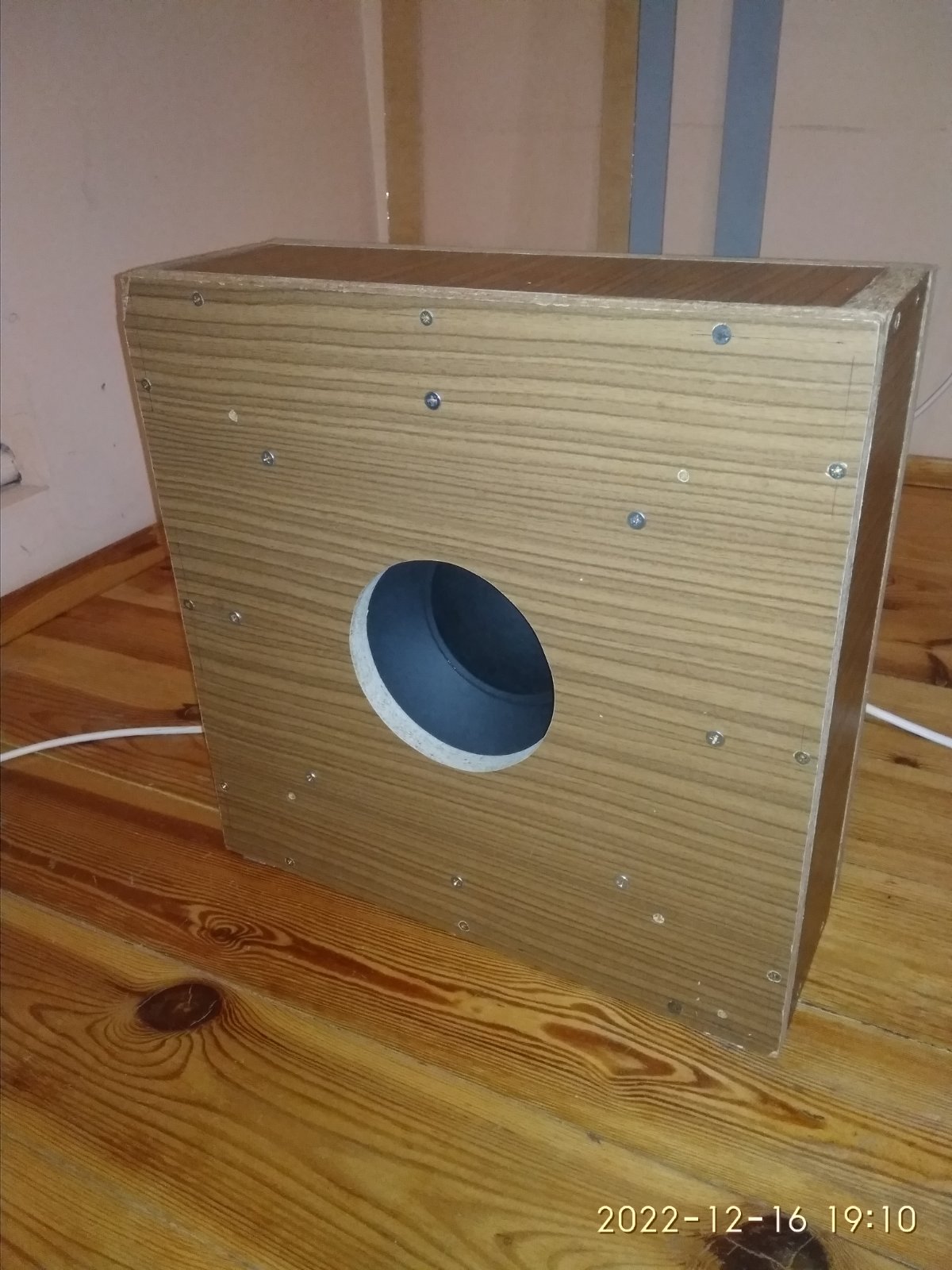

Apparently, your front is removable. Try replacing it with a version with a calculated hole in the center and compare the sound. It should be noticeably better.So I made those for a 3-way studio monitor system.
I checked the whole threat and didn't find any information about your experiments with different front openings. On the other hand I found informations of a YouTuber who did some experiments on his OB-speakers. He recommended this kind of circular slot for being better than a hole in the center.I did a similar experiment and it gave a negative result. Now, after all the material presented, it should be clear why.
What was your experience when you compared both options?
low frequencies are missingWhat was your experience when you compared both options?

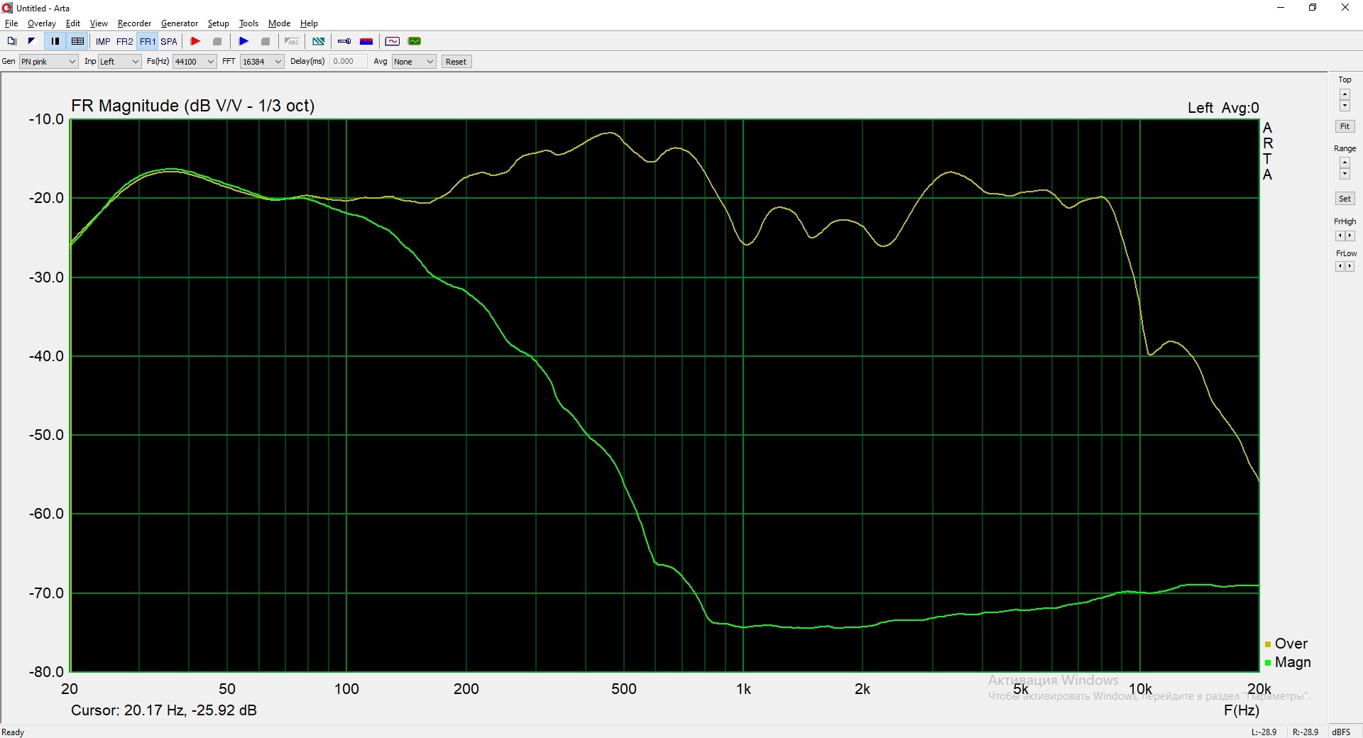

If you take a microphone and measure output at exactly the same input power you will see that the woofer with no restriction plays louder. =higher efficiency. And has less distortion.
EQ is your friend to make response flat. You need EQ anyway for dipole compensation 6dB/oct
