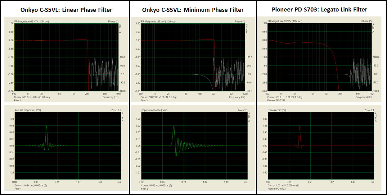

I think you have read more into my ARTA suggestion than you should have. All I was saying was that if there was really a large change to the audio signal, not necessarily related to just the HF roll off, then you should be able to measure it. The test results that I sent you, shown in post #304, were merely an example of what I was able to easily measure, not a recommendation of what you needed to measure to decipher the effect of your mod.
The 1-bit impulse *.wav file isn’t some sort of silver bullet that is guaranteed to lay bare the effect of your proposed mod on the signal. It was just a convenient way to capture the CD/DAC player’s impulse, frequency, and phase response (see attachment). From the discussion that followed post#304, the consensus seemed to be that something like the two tone test would be more likely to show what is going on. ARTA, or some of your other test equipment, can be used to generate that type of *.wav file. In any case, I will send you a set of six 1-bit impulse *.wav files (0dB, -3dB, -6dB, -12dB, -24dB, -48dB) for you to experiment with. If anybody else happens to be interested in them, send me a PM.
As I mentioned before, I am not well versed in DACs or testing there-of. This topic piqued my interest mainly because it surfaced soon after I had measured several different CD player reconstruction filters. Having seen how easily ARTA measured large differences for filters that sounded to me, subtly different at best, I recommended you try measuring. I remain puzzled as to why you wouldn’t have done that immediately after noticing what you felt was an unexpected improvement. How else could you hope to understand and fully exploit the possibilities?

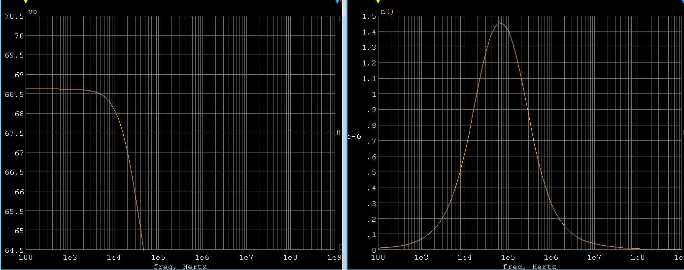

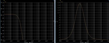

OK here's a picture using an ordinary 100MHz op-amp on a similar process. This is a full top level circuit file of one of our older amplifiers. The output is using a 2700 Ohm resistor so it is scaled by 20*log10(2700). The response is ~-1.5dB at 20k and there is no misbehavior in the frequency response.
The noise is in nVolts/rt-Hz which is my problem the integrated noise blows away the spec on any of the DAC's mentioned and it can't be filtered out (at least the part below 20k).

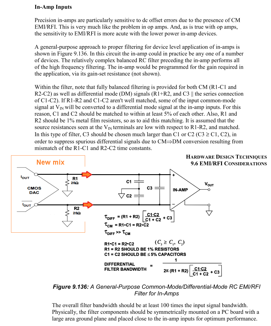

Back on track, it seems we now have at least 3 references over the last 20 years (without even trying hard) that show a capacitor across the inputs of the I/V converter. So safe to say this is a well known technique in this application amongst those well versed in the art? And certainly nothing new or revolutionary in DAC design.
