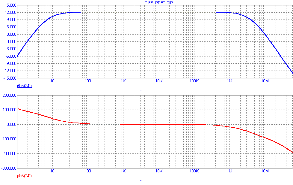

Hi, PMA,
In your English page, you wrote this preamp concept has -3db bandwith of 7hz-3Mhz. This is good, very good.
Is it flat linear from 7hz-3Mhz without flaws in that bandwith?

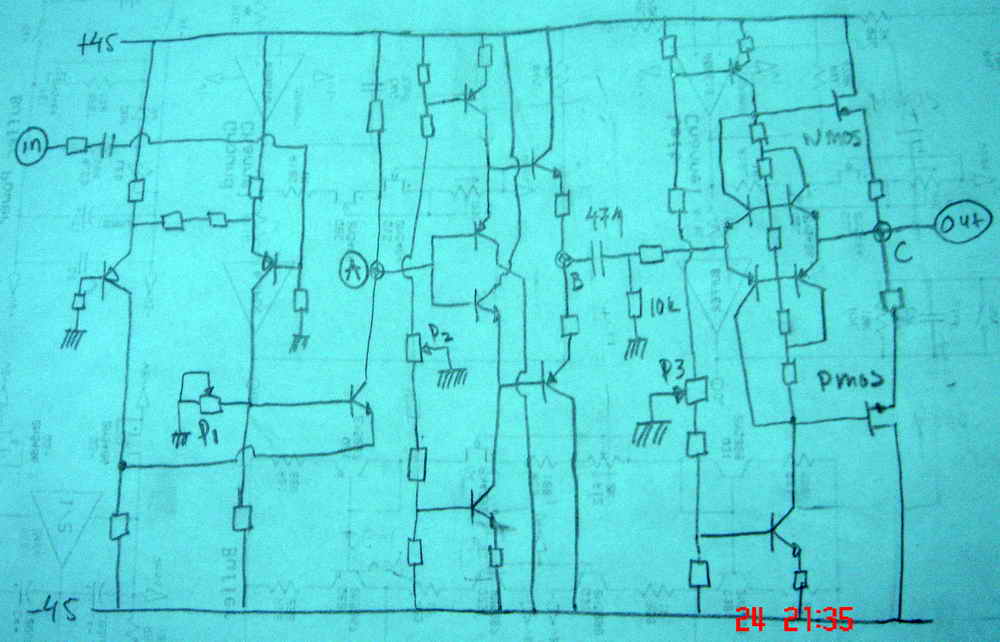

Hi, PMA,
I've given the idea (of making "preamp concept" to openloop power amp, still have the original spirit of non feedback) many tought.
First, R7 (4k7) is not changeable to bootstrapped. It has to stay a pure resistor.
Second. About the DC offset you raised. You are right. So in this sch, I introduce 3 pots to set DC offset at 3 important points.
P1 is for adjusting DC at point A. P2 is for adjusting DC at point B. P3 is for adjusting DC at point C (output). P2 and P3 is setting the bias balance for lower/upper current sources.
I've included 47uF cap coupling + 10k before the NP-PMA. This looks like a more implementable amp.
I still have not clear, wheter it is wise to set the front end gain up to 100X. It is wise to do so? I don't want to use any additional preamp, just a potentio volume control in the enter point. So the gain should be 50X at least.
I think NP-PMA can give the low output impedance like ordinary feedback to inputstage, (even it is openloop without feedback, )because it is a full differential feedback itself (in follower mode).

David,
I believe that your last one should work. Regarding P1 pot for DC setup, I would recommend to split it in a fix resistor + trim pot, the trim pot value should be considerably lower than that of fix resistor, otherwise DC at collector of 3rd transistor will dramatically depend on every touch of pot's turning screw.
You do not need the P2, as DC at point B is completely set by P1.
