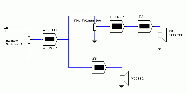

Juma,
This seems a bit back to front but I wondered if there is a simple way to make this idea work well ...
I want to drive both F3 and F5 in parallel out of the Aikido preamp ( O/P Z of about 500R) and if use the BF862 gain stage to raise the gain of the F5 to exceed the gain of the F3, where would it be possible to fit a volume trimmer - the F3 feeds a 97dB/W FR driver and the F5 into a 96dB/W bass driver (speaker uses a biamp or split passive Xover)

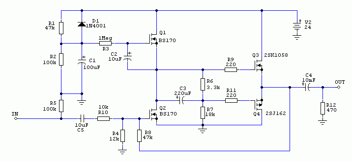

Not the best idea. Output devices in F5 work in common Source mode i.e. as voltage amplifier. Laterals don't have enough gm for that job. I tried it and wasn't satisfied. IMHO 2sk2013/2sj313 are the best option....What do you think about possibility of lateral output? ...
If you want Laterals in smal PC desk amp, use them as Source Followers - I like the one in attachment. R4 sets the BS170's Id at about 15mA and R6 will set the Laterals' Id - 0.5A was OK for me. The gain equals R8/R10. This little amp gives 9V_peak of clean swing at 4 Ohm load.

you can leave the R5 out if you plan to drive it with B1 in the same case. B1's output cap is not needed too.
SRPP FE. I like it. Can swing big voltage into high impedance load, correct. Missing gate resistors for input fets? I need to stop talking to you. Can't keep up. Thanks.
Never.... Missing gate resistors for input fets? ...
Behold the R3 and R10 - they are gate resistors too, although you are used to smaller values...

Got boards made and parts for both the gain version in post#5? using BTJ output as well as the cascoded buffer pre. Looking to do something similar to one above as well and have a question. What is the second 100K resistor, the one that is tied to input, for? Why not jsut tie the first 100K to ground. I am not acutally going to do this circuit( 1014D SRPP instead), but just looking and trying to understand.

The 100K resistors sets the input impedance and if driving from B1, it is not needed because of high output impedance of said device. You say the 12K resistor sets the Id of the BS170(thought BS portion was joke at first) at about 15mA. I see that the source of the bottom BS is grounded, so how does the 12K resistors affect bias? Does it sink some of the feedback voltage, creating a Vref of sorts?

Generally, the JFET needs DC path (through resistor) to the GND in order to define Gate's potential.
If you have a coupling cap it will be charged during the operation and it needs to be discharged (through resistor) if you want to avoid unpleasant transients.

Wasn't unsure if placement at feedback point intersection changed general bias considerations. So, is it correct to assume that if both the Gate and Source are grounded, does this mean that it being operated at Idss, which happens to be 15mA.
