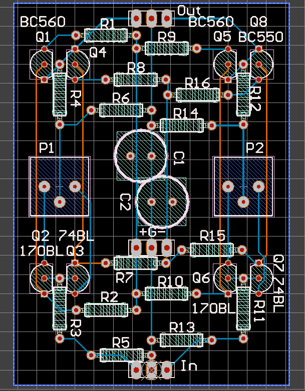

After few months of experimenting here is the circuit that sounds best to me - it's the same topology as the first one in this thread but with BJTs in output and higher Id through JFETs (6ma).
It takes the +/- 24V from F5 (they are both in the same case - F5 as integrated amp) and preamp's OUT is connected directly to F5's input.
I used the PCB from the post #3 of this thread but with some diferent components and values.

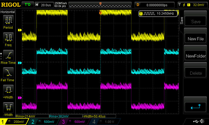

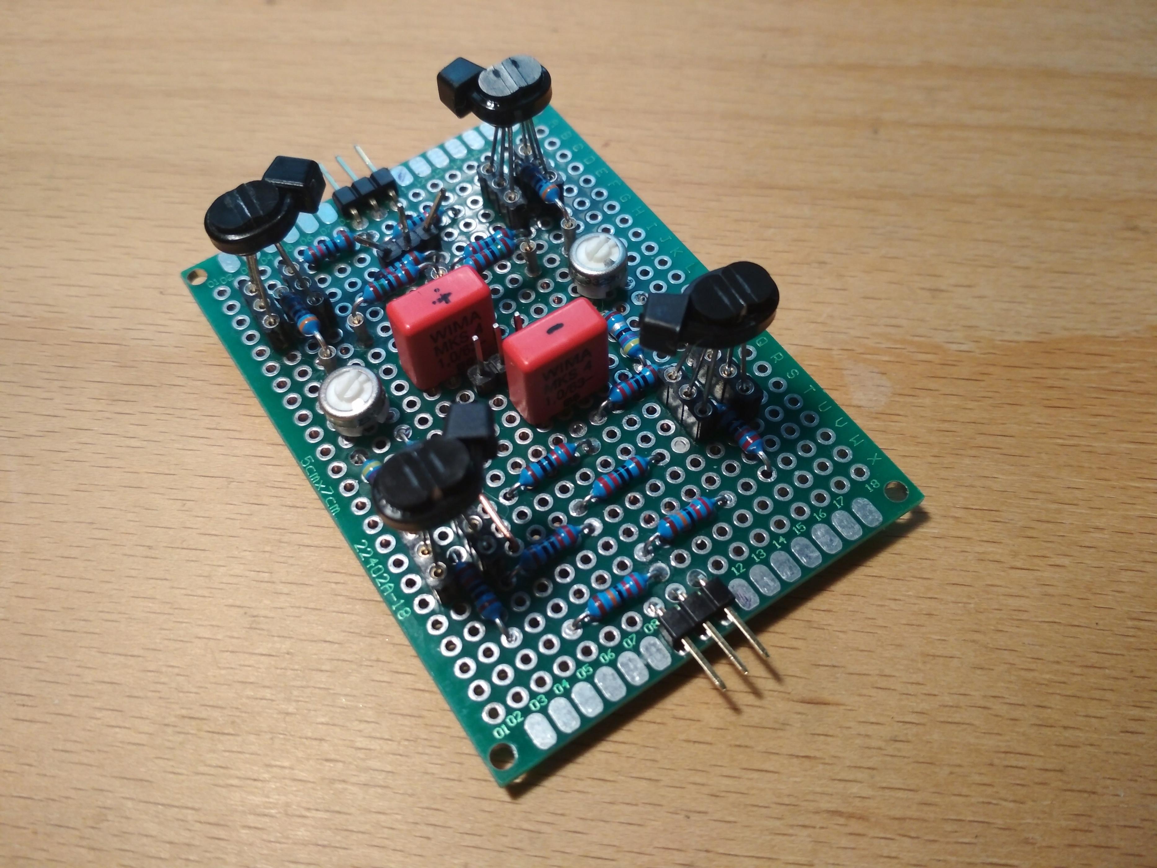

I was looking around today because I need some gain, mostly use computers for source and many amps just don't put out much with a .5vac signal, its not enough. found this and made it.
Looked at many others but settled on this one to try out. Its going infront of a Pre with Jfet inputs.
My 2SK170 are 9.2 IDSS, so changed 33R CCS resistors to 51R to lower current, its now 6.4ma each with +-18V supply's so 70% ..... thinking of going to 43R to get that a bit higher
Sig gen has a bit of noise, need new cable for it. But the wave is nice and sharp. used a 39K load resistor.

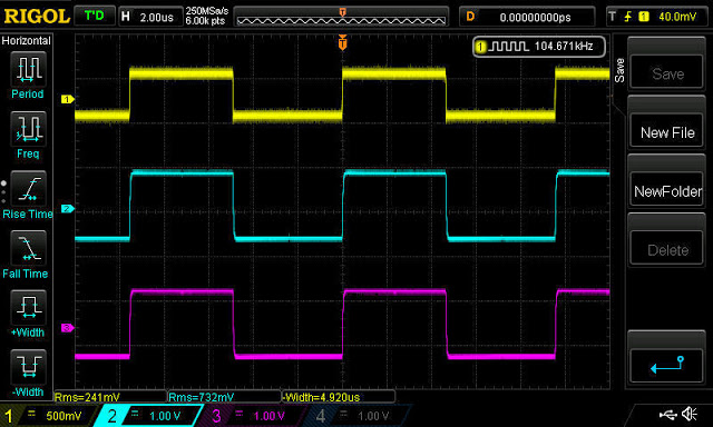

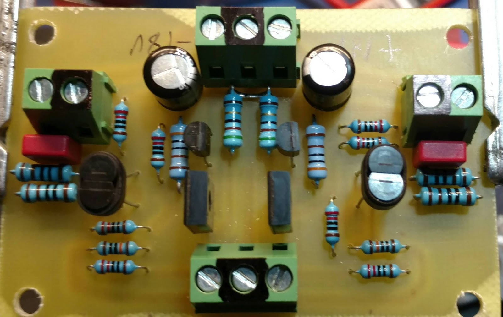

J310 version
Today I tried J310's, with IDSS of 38ma, it looks much better, at least to me.
there is no way to run these at 80% of IDSS without heatsinks on the CCS and jfets.
tried 24ma but was hot, finger three second Hot....
so put it back at 14ma with R5 of 33R,
did change tale resistors to 50R - 50R
load is 39k and gain is3x
this might work very well

Q1 & Q1 should operate @ roughly 30% to 90% of their Idss.
If you have 10mA jFETs then R5 should pass between 6mA and 18mA.
Once you have decided what Id you want to operate at you then select R3 and R8 to drop ~8volts across each.
Pq of jFETs = Id * Vds and for 90% @ 10mA Idss you end up with Pq=9mA*10V=90mW << 200mW
You definitely do not want 24mA passing through your jFETs.
Thank You that makes sense... was able to adjust ratios and its better now.

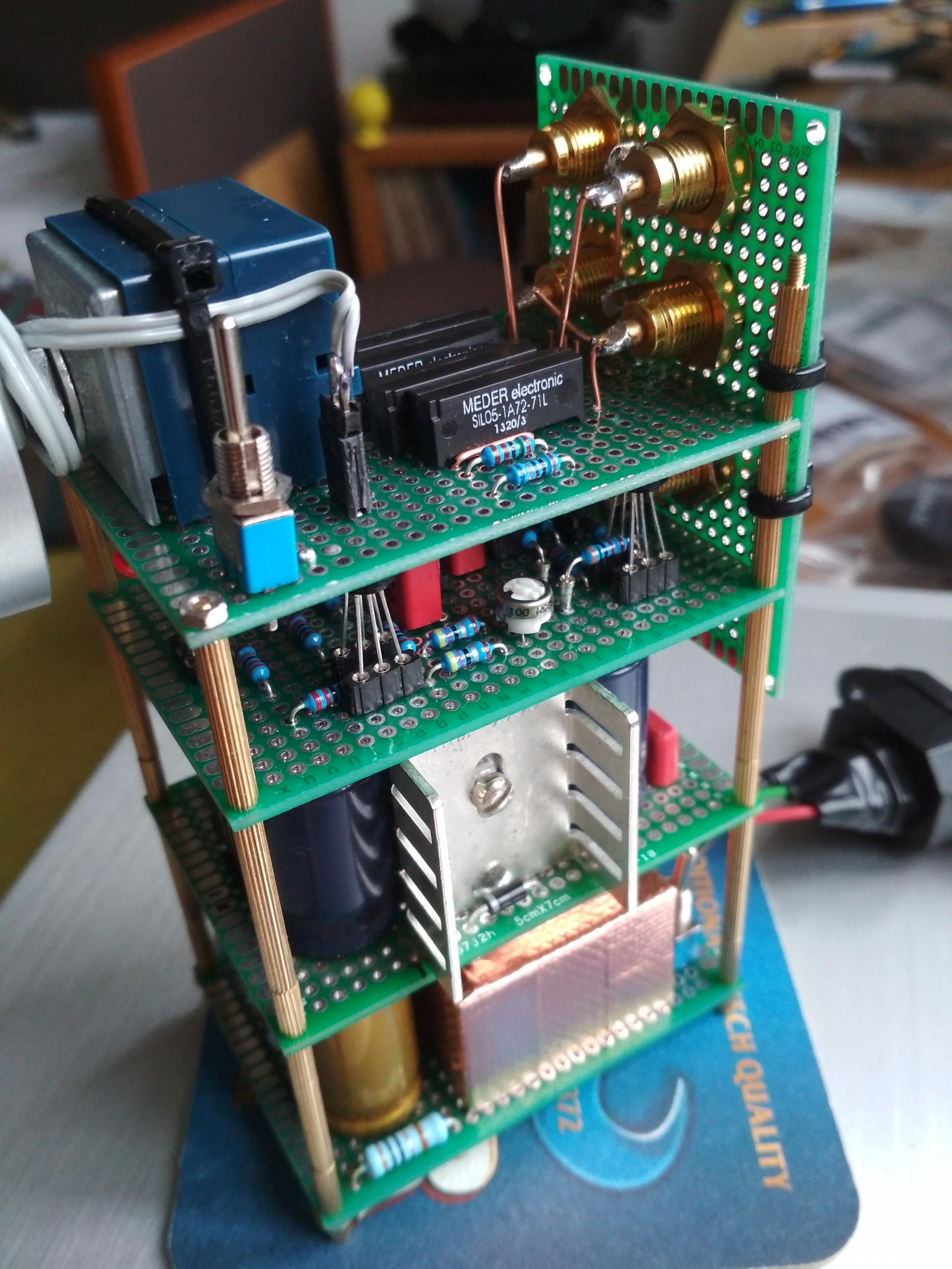

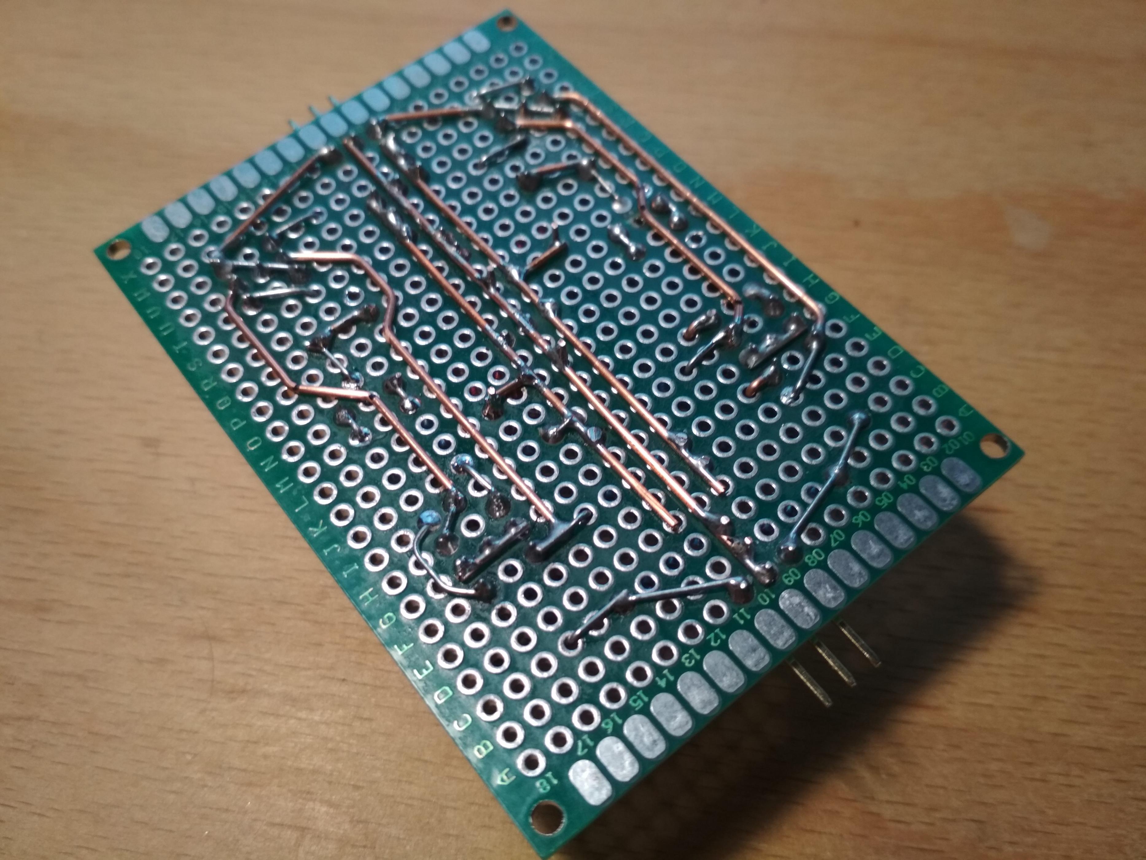

I built a Juma preamplifier(-tower
Schematic: post #53
The parts came from my drawers, the size of the Chinese proto boards are 5×7cm.
On the lower stage is the mains transformer, rectifier brideges, and RC filters. The next one is a power reg with LM317/337.
Above is the Juma's pre. I used the CircuitMaker to optimizing the traces. You can see the project here, if you are registered in.
On the top is the input selector, two inputs with reed relays, 20k Alps pot. The backboard is the same size, I drilled the holes for the rca's and for cable zip for fixing it on the tower. The standoffs are M2 sizes from Banggood, but you can buy those cheaper on Aliexpress.
Thanks Juma!
