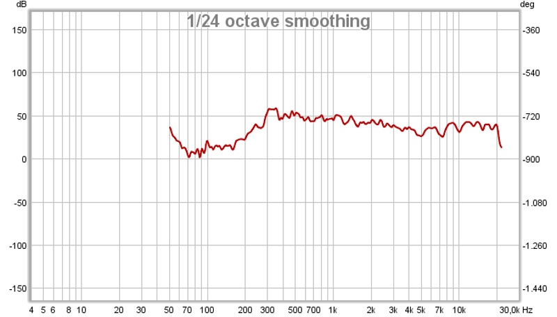

Hi
I think I can correct also the low part who needs less power, or the high then it needs more power, in my eyes it is better to down the low part because it has also to be set lower sensitivity because of bas units, I do not use a dsp, I go analog and shelf the stuff.
I have some pictures I have also included my open baffle system so you can see what it is without much corrections, except a baffle correction, picture two.
I can afcourse do something wrong with measurements, I do measure with pc mic input with some boost, that is not the right way so I have build me a mic amp from the dipole guy and use line in from the pc.
regards

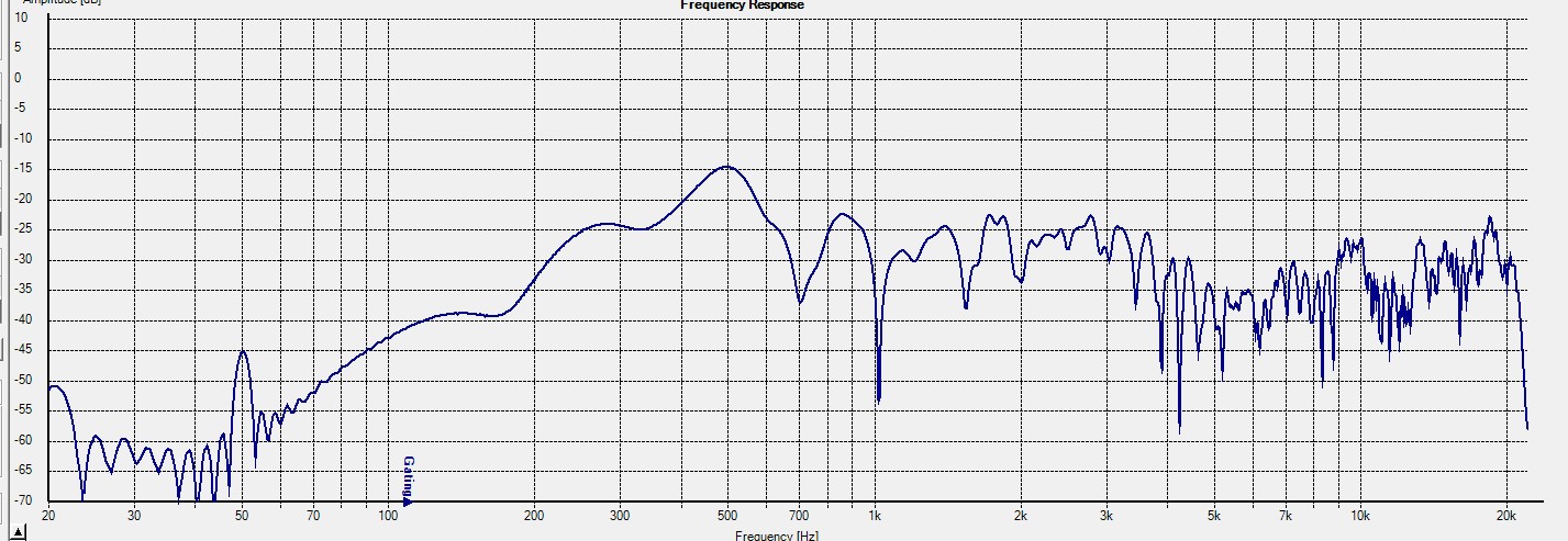

I think -25dB relative SPL is the system sensitivity, the first peak is the simply the bandpass port injection peak (you can flatten that with a smaller front chamber volume using filler phase plug, and making injection port larger). There is about a -10 to -12dB fall off that is normal after that. What you can do is make a peak or notch for the 500Hz peak, and make a -10dB shelf below 4.5kHz. That should equalize it for the most part. You really should try miniDSP - so easy to do vs analog filters.
If you look at what I did:
Grey line is raw non-EQ, you can see the EQ levels I used.

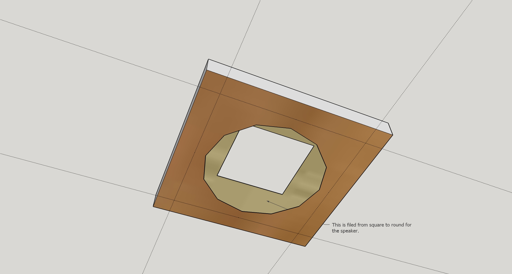

I did put speaker on without a plate, but I did thought about go from square to round then surround don,t hit and port is larger.
Akabak however do not let see this. so sim is just a get in naburehood to start.

I do put picture here about the port idea.
What about the bass, you did not use the basreflex ports? it is off I thought to see, I use two 8 inch woofers so one port on one side, not two, I do put them left and right in the horn corner.
I do not now if this will work, I tow ports for one woofer is not possible.

Good idea on adapter plate. I did not try bass reflex but I know that works where you redirect bass reflex back into periphery of horn mouth. Look at Weltersys' thread on the SynTriP speaker where he does just that. You can get extension down to 80Hz that way. On mine I use sealed back and can get 100Hz easily. 80hz with EQ but limited SPL.
I see your shelving filter - passive at line level then. Hard to get steep slopes that way - will need active op amps soon. When using op amps might as well go DSP.
I have a hybrid amp, I can use a extra tube that way, I think a steep slope is not needed, this is 6 dB octave and much speakers can corrected with that, special open baffle, but horns are other stuf, and yes maybe I need active, but then tube, or discrete jfets...

Have make the shelf filter, but it needs a lot correction, like some of 18 dB to get it right. Visatons are just 87 dB 1 watt.
so much horn correction for the whole bandwith so much more distortion, so maybe i go make a small tweeter sersion, then I have a lot more succes or a other driver.
The open baffles still sound a lot better, but need afcourse more done with it, I do not now it is swuitable horn for high end audio, then I think need make two way tractrix or even three.
regards

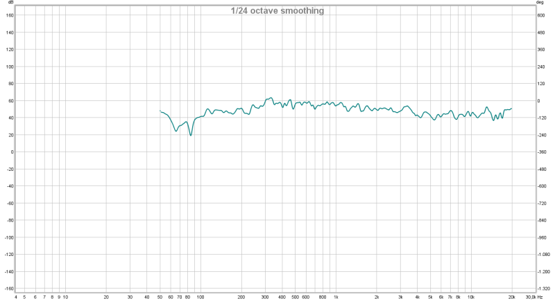

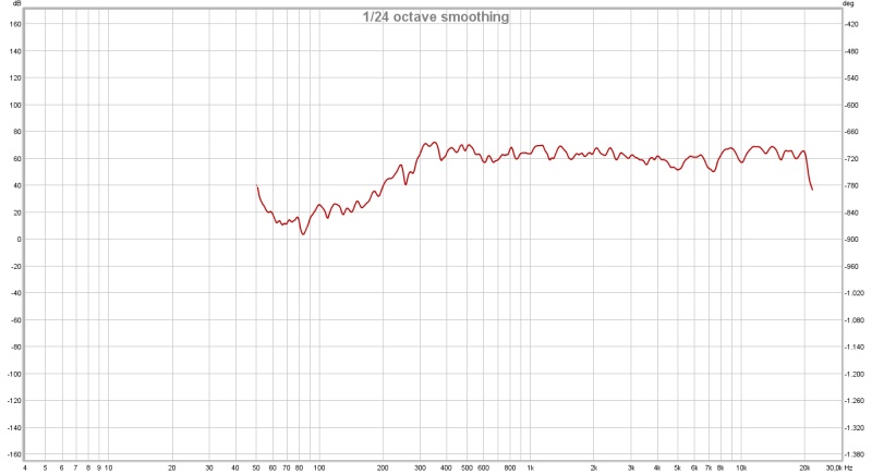

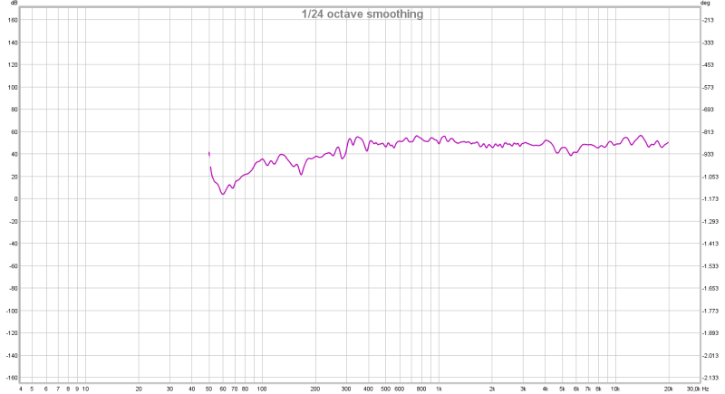

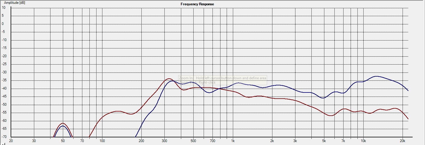

The trouble of hollow sound is over, this was because I did give full signal inclusive low end, not it is fiterered from 300 hz, and no hpollow sound, I did read that colouring occur in horn when below its frequency cuttoff.
I do however see I get much signal differences because of room, 10 dB (plus min 5) is occur. efficienty is now same as big 8 inch, but then it comes from a 3 inch, that is impressive. Down from 108 dB watt to plus minus 93 dB watts.
If I do go make a tweeter tractrix extra it is a very high sensitive speaker system, only it is quite directed, I do miss the space the open baffles give to me.
PS the third photo is without shelf, pure audio out with 300 hz high pass thirth order.
regards

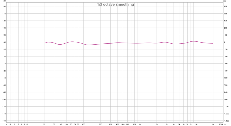

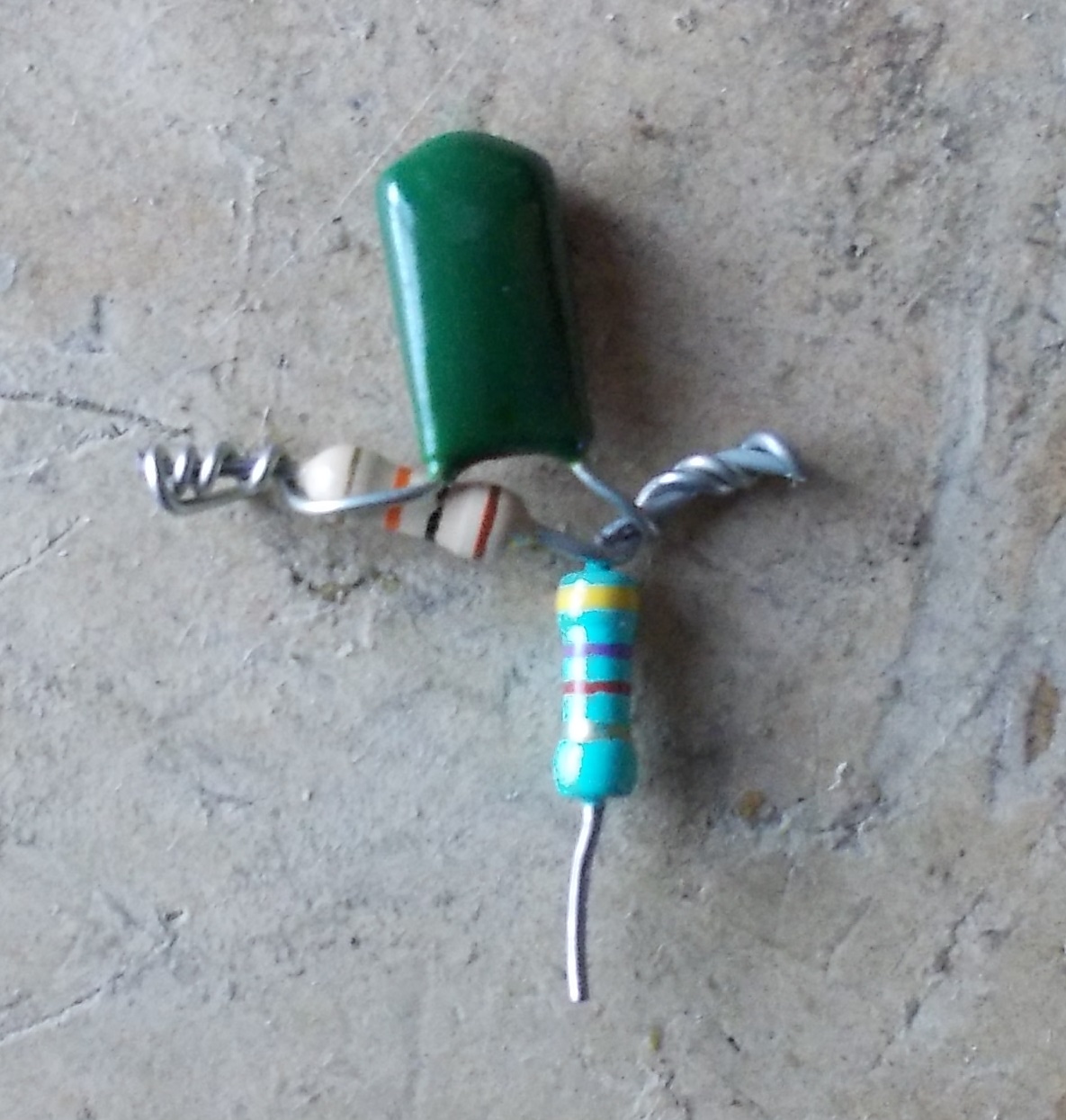

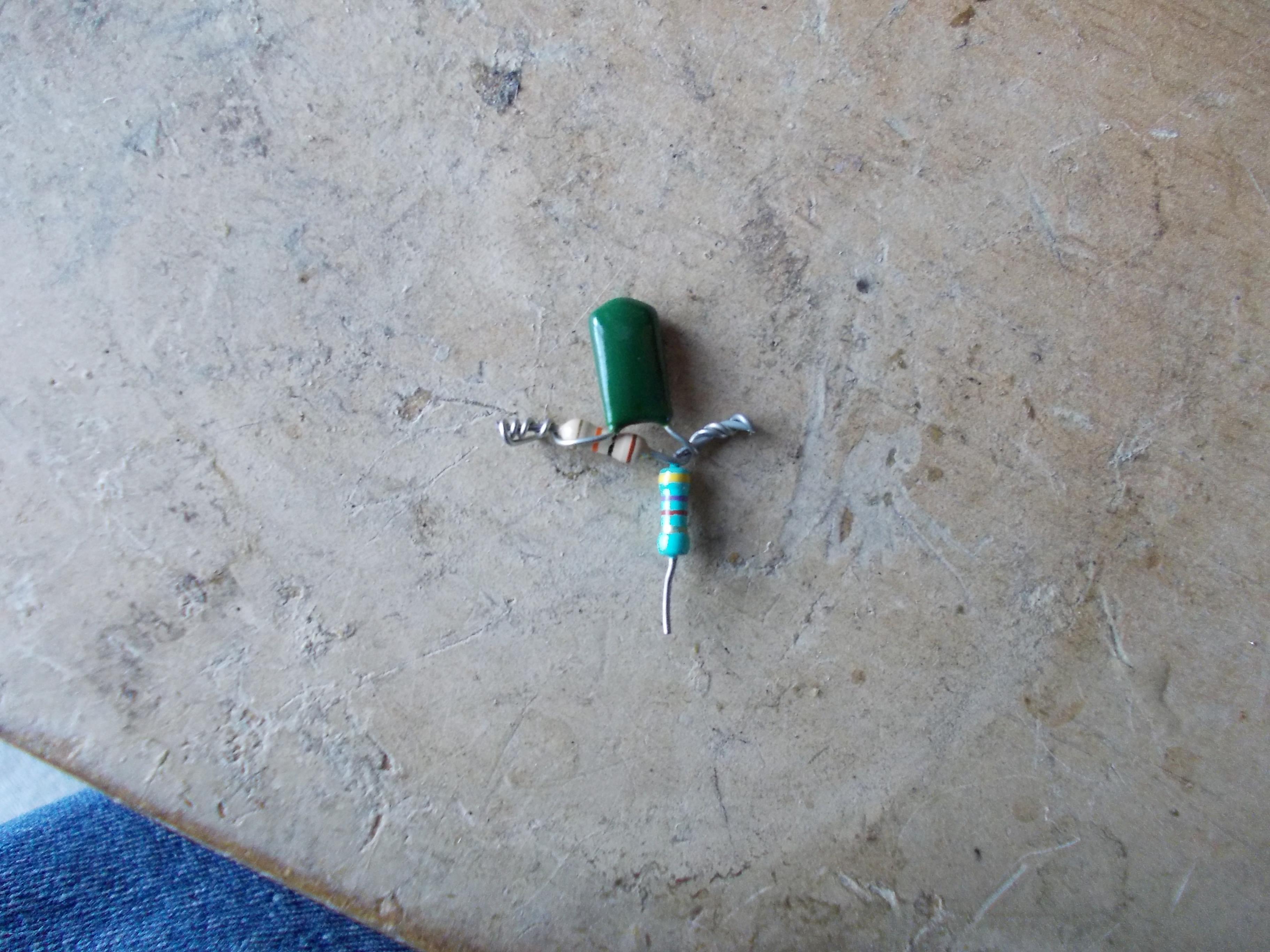

Great news. It looks very flat in response. Is that due to the shelf filter you put in?
Yes just one cap and two resistors high pass on input of the hybrid amp, who by the way is blown, the DN2540 mosfets are very very sensitive, I do go to normal fets the next time.
Maybe it is better to include a high pass in the crossover itselfs, on output of amp. horn need big time correction in my case plus minus -13 a 14 dB below 1.5 Khz.
repaired again.
