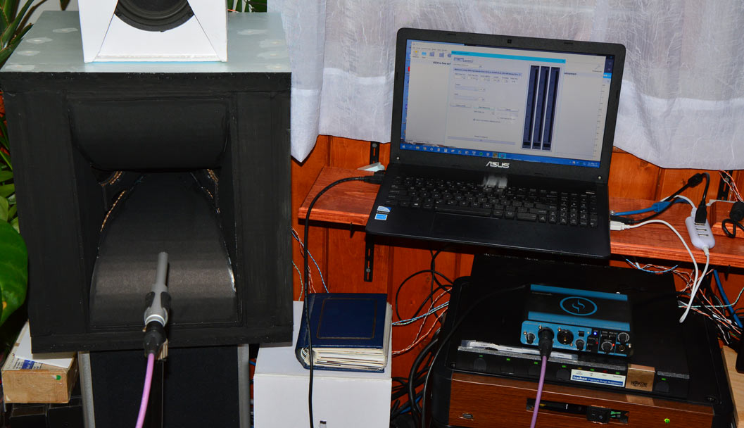

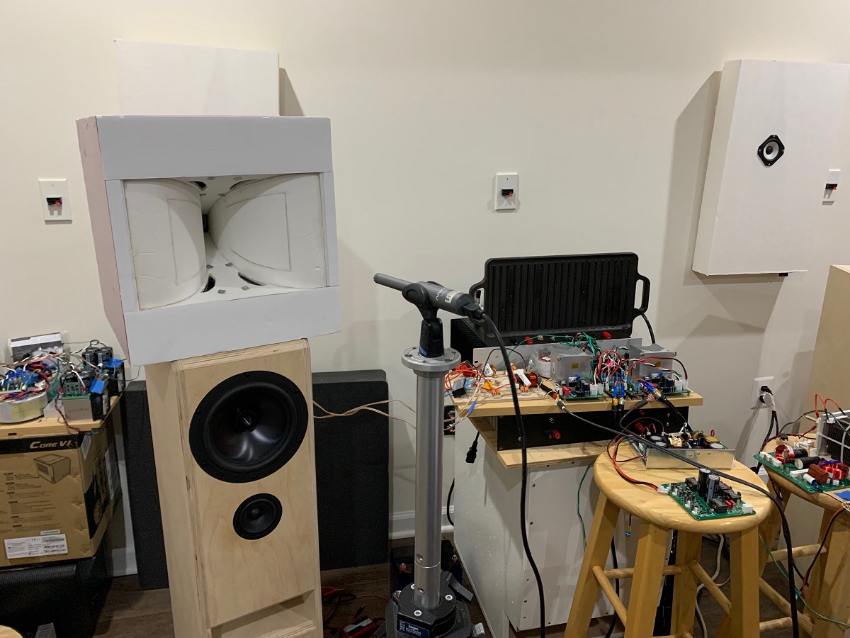

I'm putting in alot of time, yes! I was unhappy with the readings I was getting and believe it was the way the calibrated mic was being patched in to the system. So today I hooked up my Sonar Sound Studio 25 adapter which is an older version of the Steinberg which minidsp shows on their page as acceptable. This way I'm plugging the mic right into the "sound card". The drawback is that it's not as good a playing vehicle as my regular DAC and it generates alot of usb noise in addition to the minidsp. Right away my readings looked much more believable. My delay has dropped two notches to 0.35411ms. And the eq is different. It's less bass heavy, but I need to listen for a while. I've now packed up my friend's mic to return and unpacked it about 20 times. Meanwhile I'm hearing alot of great music.

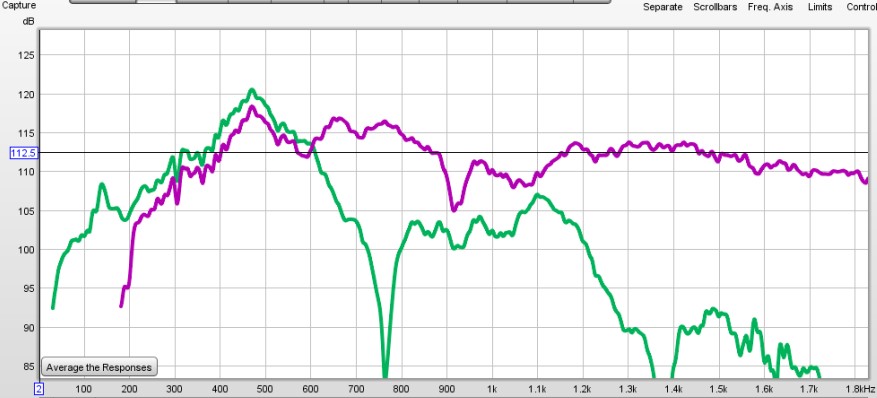

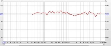

I've revamped my setup. Acquired a usb hub. Now I can playback thru my favorite dac, record thru the Sonar Sound Studio w calibrated mic, and run minidsp nearly noise free. Took my first set of readings with no EQ whatsoever and no crossovers. Ran the woofer sweep from 30-2,000Hz and the tweeter sweep from 180-20,000Hz. Here are my averages of each (6X each). What is my next move? Do I try to set EQ filters or crossovers and where would be a good frequency to start with the crossover? Thank you.
Thanks X. Before I saw ur reply I went ahead with minor negative EQ to smooth things a bit and set up a crossover of 600 Hz(!) It sounded pretty acceptable early on which is totally unlike how I started weeks ago. My new testing setup seems to be working correctly. The biggest surprise is I added a 4X usb hub on a 1/2 meter cable because my laptop has only two jacks. I have both the DAC and minidsp (both self powered) plugged into it and the mic interface, which needs to draw its power from the usb connection and doesn't always turn on, plugged into the jack next to the power connector. It all works. And it's absent most all the noise I was getting before. Plus, and this I cannot figure, the signal coming out of my dac is louder.
At any rate, the sound is cleaner, especially the bass and with only a bit of EQ tweaking is sounding very good. Not quite there, but on the right track. The actual crossover point (set at 600Hz) is ~520Hz.

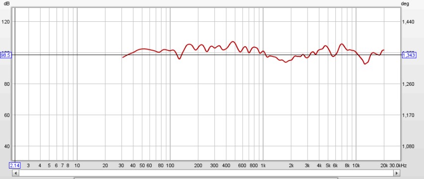

that's a good question. I've been listening with my subs going as well and cannot remember the exact setup when I took that overall reading. So I just measured again with the subs absolutely off. And yes, it does look like I'm getting down to 40Hz on the uTrynergy's. This is with no smoothing.
Sorry I forgot to check in on this thread lately. The response without the sub hitting 40Hz is very nice! That is amazing considering it is a semi open back design.

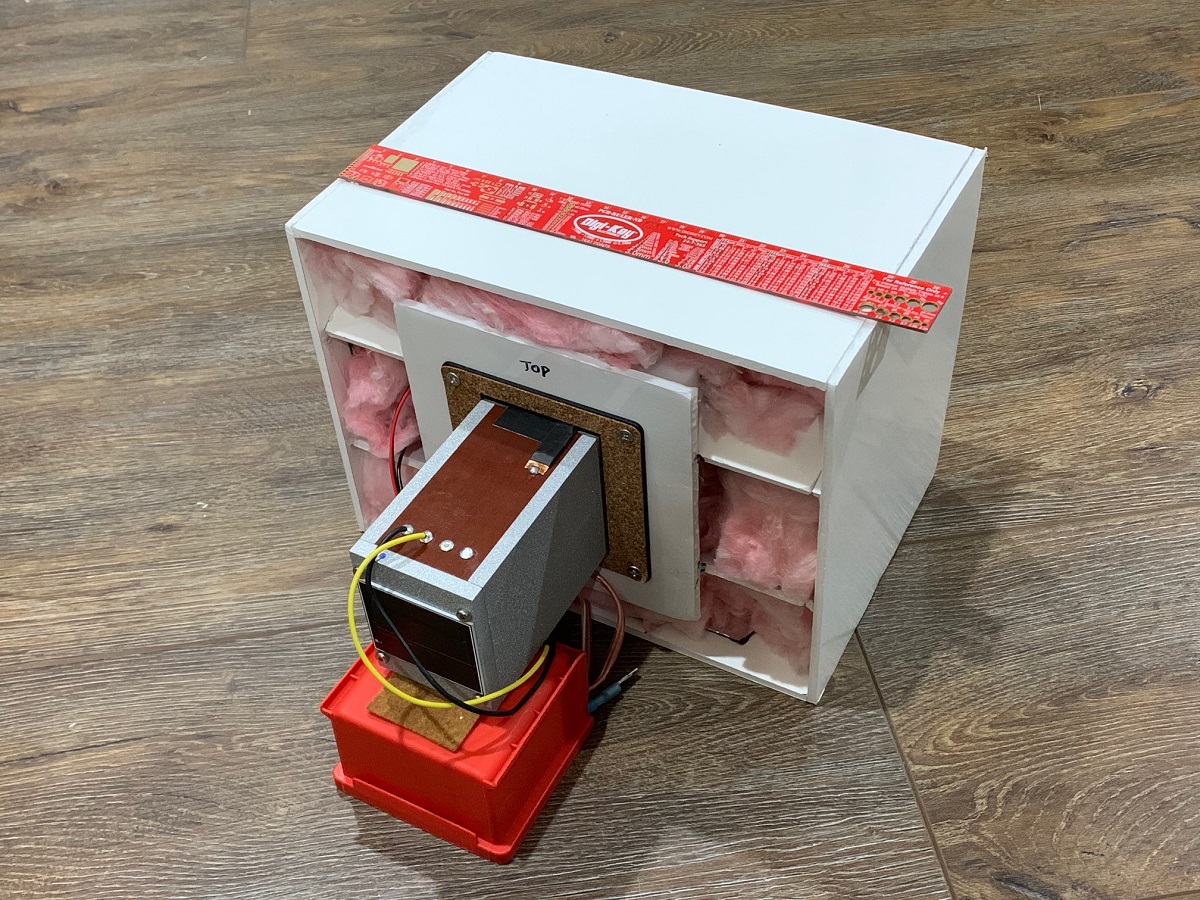

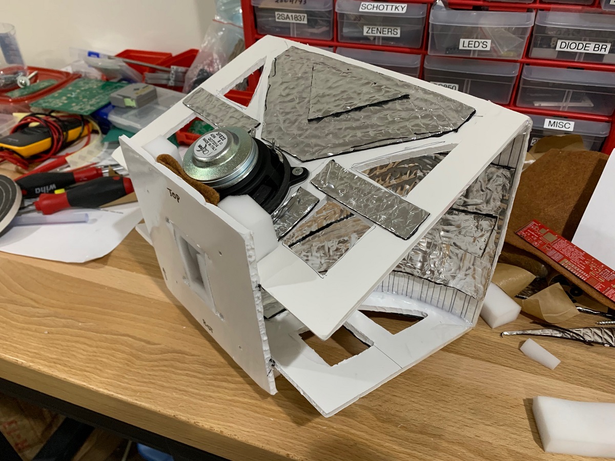

I was intending to make a sealed box, with the option to go bass reflex vented. In building it, I left the rear panel off for final install of a removable panel. So I turned it on and listened to it and the dipole bass really surprised me. In a way, it resembles a band pass slot loaded sub woofer with open U frame back. The full range mid/tweet is also free to radiate to the back too. Anyhow, the bass digs pretty deep and I can get about 90dB at 50Hz with only 2% HD. The cool thing is that as it is an "OB" woofer system, the group delay is very low - under 5ms at 50Hz.
Material is all 1in thick XPS "Foamular" from in 2ft x 2ft sheets at HD. Low VOC Liquid Nails adhesive and hot melt tack with some screws to clamp for curing. As it is still drying, I have it rotated 90deg to not put any shear stress on the (still wet) glue joints...

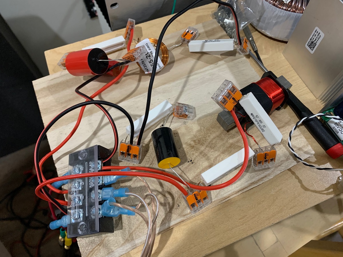

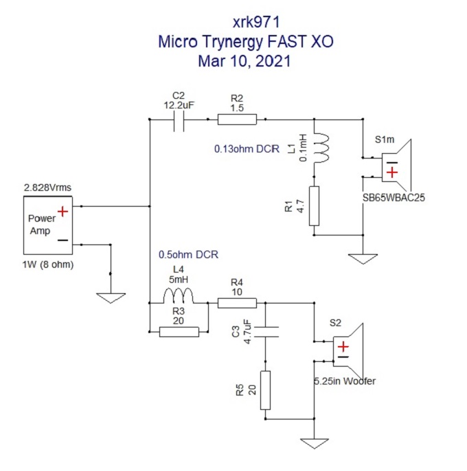

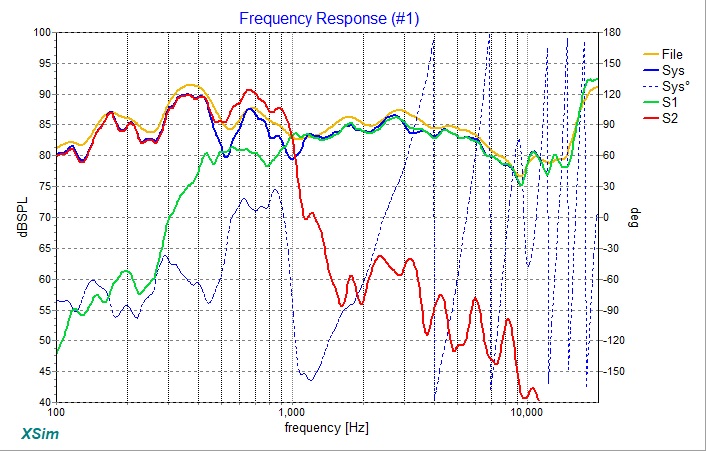

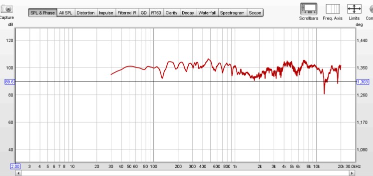

I haven't touched this speaker for about 5 years but decided to whip up a quick and dirty passive crossover for it last night because a friend wanted to hear them at his house and I did not want to mess with a DSP setup. Just plug it into an amp and go is preferable.
Here is what I came up with as a rough first cut. Crossover is somewhere around 800Hz so still qaulifies as a FAST with the single SB65 full range doing most of the work in the vocals and upp range.
Schematic:
Prototype XO implmented with Wago connectors:
XO Curves - predicted (blue), measured (orange), woofer (red), green (tweeter):
It's rough but passable and listening to it, sounds quite decent. A wider frequency range shows that the bass extends down to 40Hz even though it is an open back type speaker with four 5.25in polycone woofers in series-parallel.
