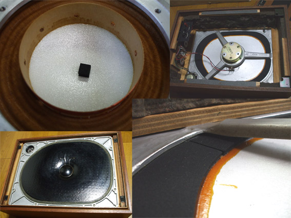

I realize that this thread is at least six months old, however I do have something to ad to it.
My experiment:
The Point Source Principle - Ripple One Experiment
Tim de Paravicini can speak for himself, and maybe I'm on a different path.
Cheers, George/kach22i
My experiment:
