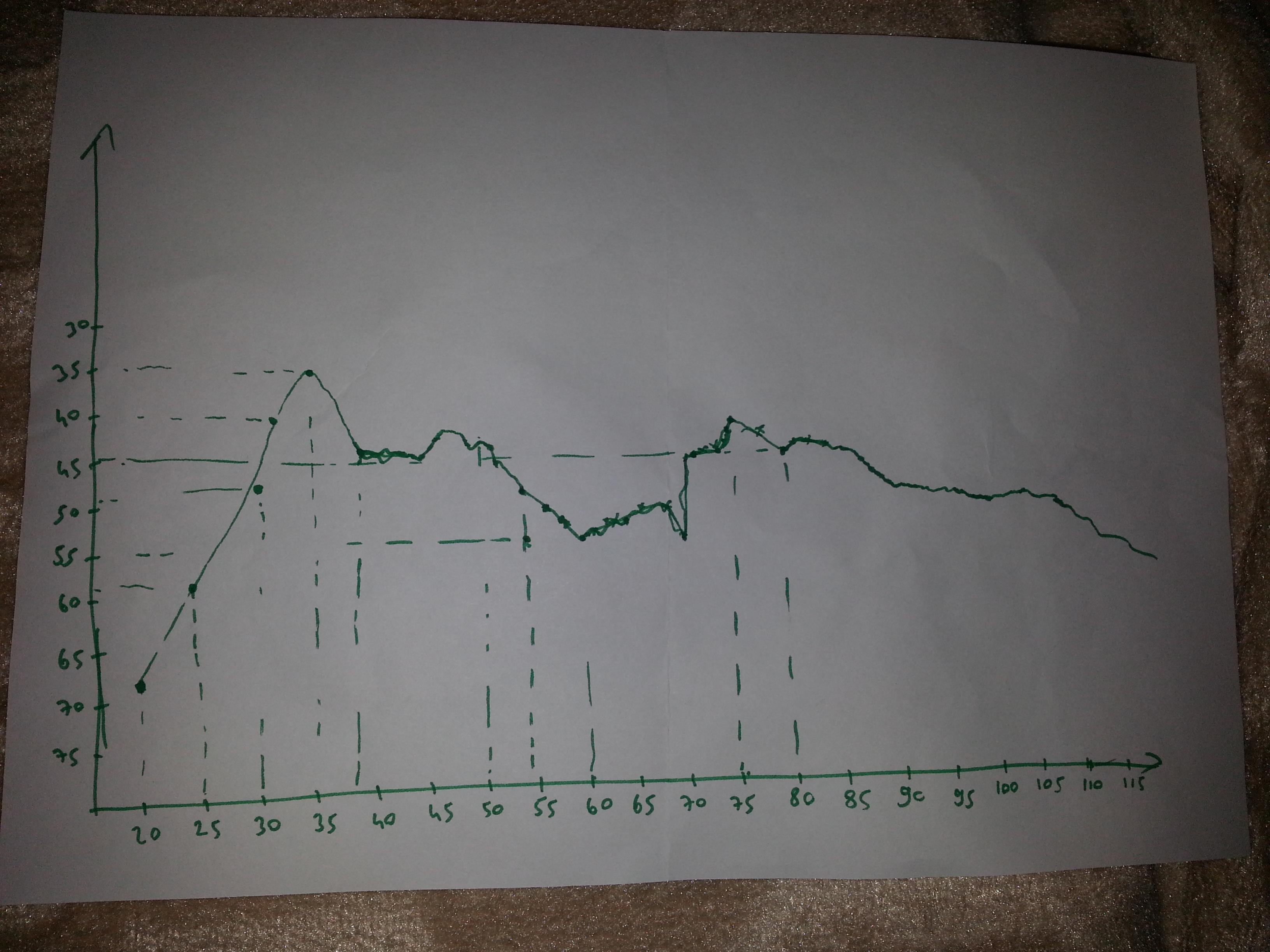

Hı. I want to make a 3 way system but i could not decide which drivers to use.As you can see it in The picture of my subwoofer i think I should make active crossover @ 110 Hz .
I searched 20cm fullrange drivers and 20cm pro drivers as midbass driver.They both have almost same sensitivity. I will use F5 amplifiers to drive them
Hifi fullrange drivers have lighter cones have smaller magnets and smaller voice coil and smaller inductance, pro drivers have bigger.If they have same sensitivity,which one is more suitable to drive with F5 amp ? I can use 20cm B&C midbass and de250 Hf driver.(I can reach easily in my country)
Or Fostex Fe206en and a hifi tweeter from Usa
Which one can give lower distortion ?Has anybody measured and compared them at 1w and 5w ?
(Poor Picture is a measurement in my room at my listening position. 4 meter far from subwoofer and measured by ipad air microphone.Subwoofer is in Thé corner of the room and in front of me .My sitting room is about 25 sq meter)
