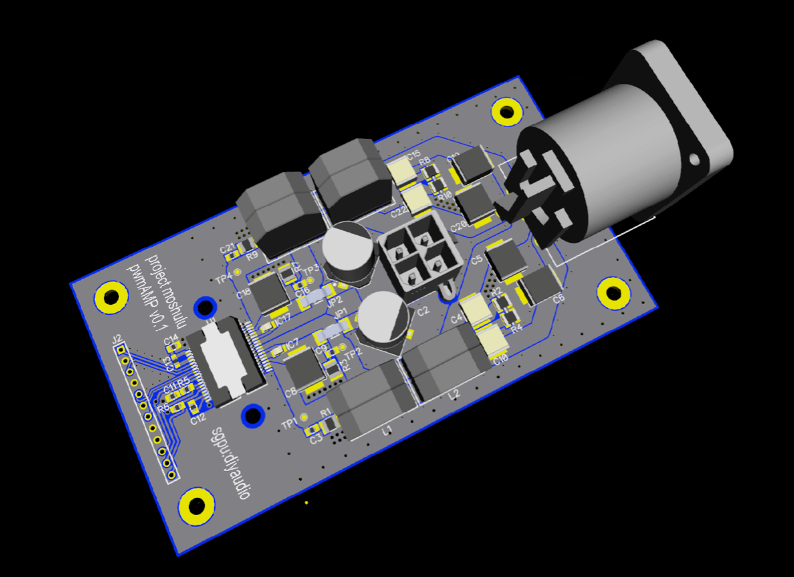

Thanks DrMord. I spotted a few designs installing 3.3n to 10n 0605 caps right before the speaker terminals for EMI reduction. Are these preferable?
The 100n would be better as small case X7R caps, far better for local bypass in the smallest package you can handle. The Panasonic are rather large and have to much parasitic inductance, look at the inductance curves on the data sheet. A lossy X7R in a small (low inductance case) is what is required for low value and local to power pins decoupling, being lossy limits anti resonance peaks, being low inductance means they work at a higher frequency, this is what is required for high dI/dT switching and instantaneous current supply.

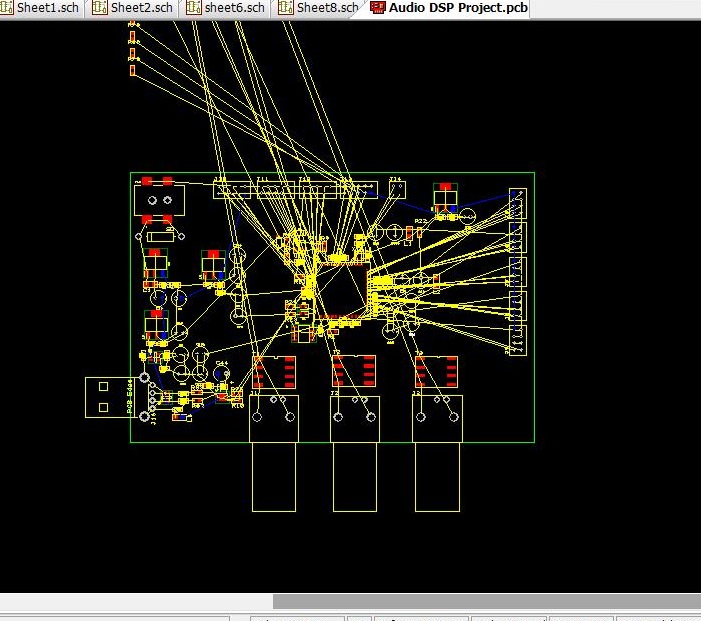

I've been messing around with the MSI motherboard mentioned earlier with the UPL and learning how to use that for testing. The 7 channel PRE out card is interesting. The DAE-3 is working as a PWM DAC --> 3 state bugger --> JRC 4580 dual op amps.
I made a start on the DSP board last night.
So far we have
LM340MP -> 5v
LP5097-3.3 for analogue section
LP5097-3.3 for digital section
LP5097-1.8 for clock and PLL
LM117-1.8 for core
GXO-3306G/B 24.576MHz 1.8v clock source
2 x SPDIF in -> Newawa transformer -> dsp
1 x dsp -> Newawa transfomer -> SPDIF
ADC input header
1 stereo pair but worth having around ~ THD-81/SNR95. Looking at OPAMP options so this can be used if required.
Outputs
Headers exposing 12 channels of PWM output mapped to 18 pins. Can be driven as PWM DACs - 8 or 16mA drive.
Install simple passive filters to deliver 1Vrms line level or opamps for more intersting outputs.
~ 104 db single ended
~ 114 db differential
I/O
i2s/DSD/HDA/TDM and USB for programming.

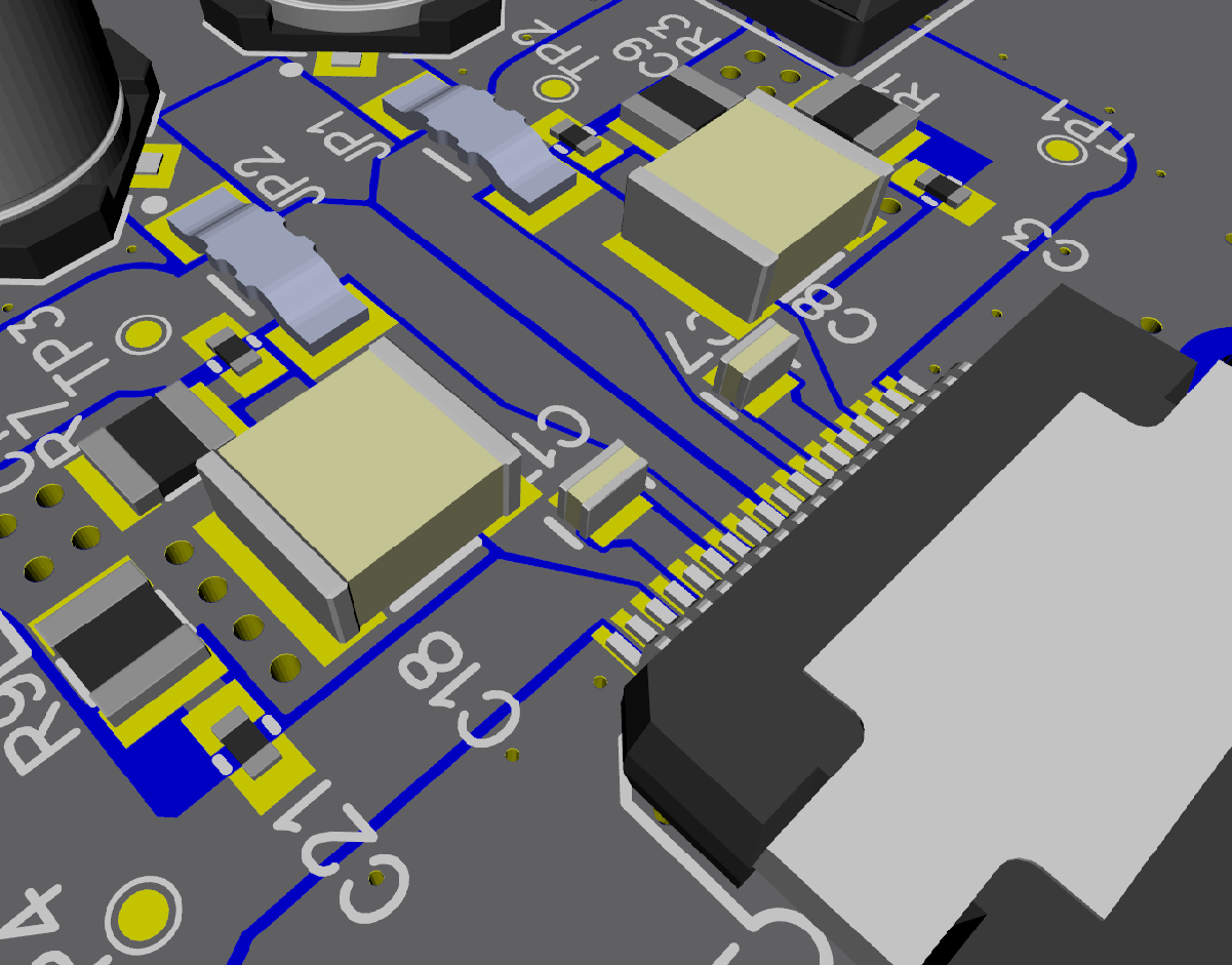

What does the jumper and the increase in PSU traces add, the huge Wima size adds too. I would take a look at TI evm's for openloop amps and see how they filter/provide power to those ampchips, ripple gets directly into output TI showed.
The jumper saves having to route power through vias to the gnd plane. I thought it would be a neater solution. I am rethinking choices of components now.
Several EVMs and designs I've found from TI/NXP/IRS tend to use a single 2.2uF X7R for bypass with the bulk cap.
This particular part seems popular.
http://www.mouser.co.uk/ProductDetail/Murata-Electronics/GRM31CR71H225KA88L/
MLCC is not only temperature dependent, but voltage dependent too. 100 nF will be only about 50 nF at rated voltage (but this depends on the exact type very much). Bigger ones can be better. I found good ones in 1206 only. (X7R can be strongly voltage dependent too, not only Y5V!)
And 100 nF is not neccessarily enough. With the parasitic inductance of the electrolytic cap it can resonate and causes an impedance peak. 10 nH 100 nF gives 5 MHz. X=0.3 ohm. If ESR is lower than this, then the resulting impedance at resonance will be even higher. But if ESR is higher, then it is a problem alone.
So to avoid this problem I use as high capacitance close to pins as possible. In the latest design 100 nF directly next to pins, but on the other side 4*2u2 connected through 5 parallel vias. This gives much smaller impedance at resonance. And ESR of polimer electrolitic is selected to damp this resonance to Q=1.
