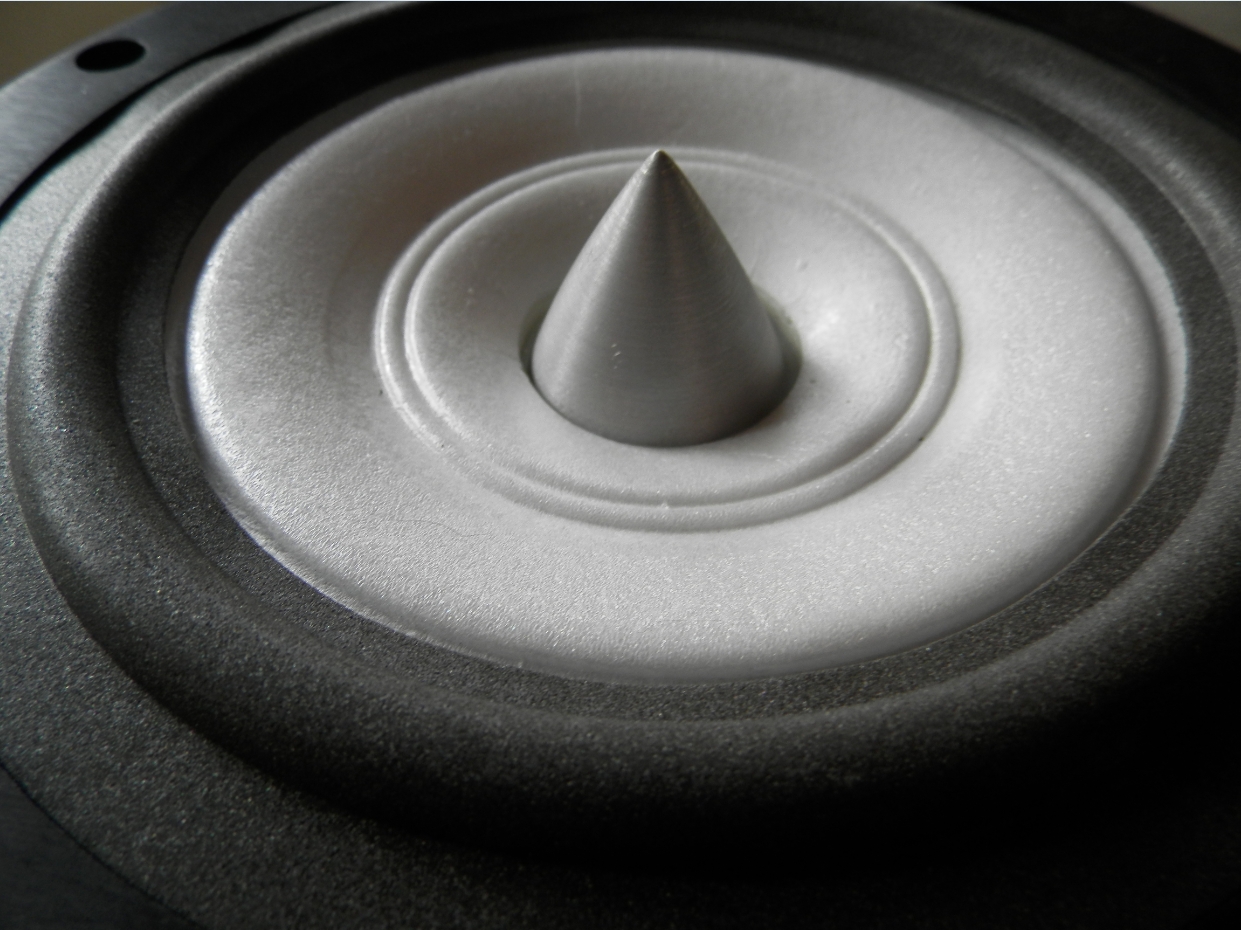

Just a small update. I did decided to go back and try making a cone from Depron after experimented with a variety of material. The reason for this is that Depron is very light weighted and stiff material and it has some good damping qualities.
I made the cone by pressing two hot forms with the Depron in between, it took some tryes to get the temperature right. The temperature should bee 150-160°C, maybe a little bit higher. The cone is made in one pcs.
The cone you see is 6” and the cone is made in one pcs. the weighs is only 1,6 gram, that's hard to beat. I did mount a voice coil on it and it work fine. But I need more time to figure out if it's a keeper.

Thanks Hentai, Yes your are right I did try Depron (polystyrene foam) before, But thanks to you, this forum and a lot of experimenting I think I can pull it of now. In this one I used a larger areal to connect the cone and the voice coil, it is like a small some what flat wizzer where the centre cone is glued on. Also I am using my own voice coil, I used a standard replacement coil in the first try.
I am using slow curing epoxy glue with micro balloons (200 micron glass balloons), this makes the glue very hard. The Depron is slightly sanded to make a good grip for the glue.
One thing I have notes with the Depron cone is the high frequency respond at a angle, it doesn’t seems to be very directional as the other cones I made. Maybe it's because of the way the cone is spilt and the con is relative flat.

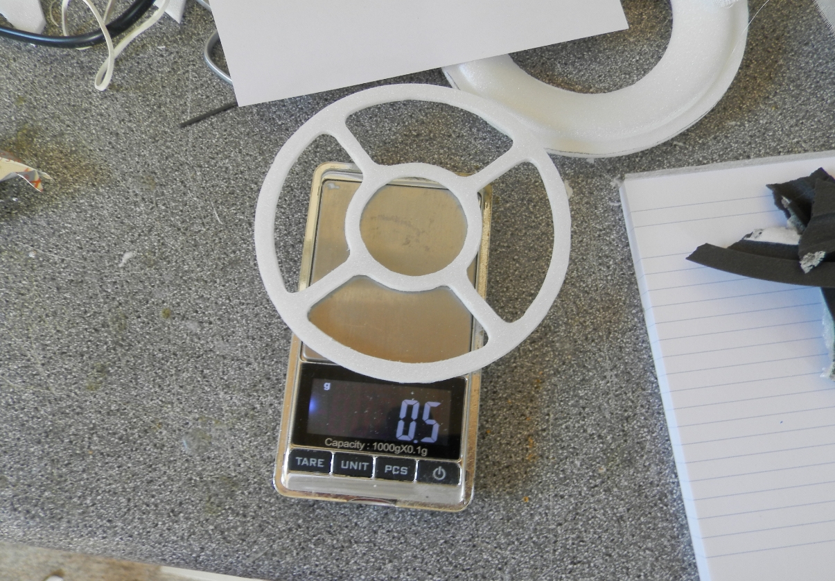

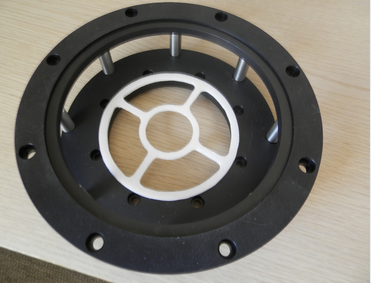

I just finished my first take on a Depron spider, and it's looking good. Weight is between 0.4-0.5 gram and the suspension seems very soft. I know there should be more than four joints, but it is the first try

Your spider looks good, but I could not use it as my 8" have 30 millimeter peak to peak movement...

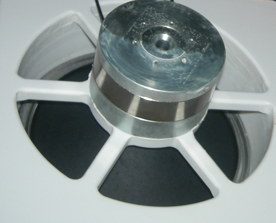

Made also some basket less versions - CNCed Corian baffles.
Have now prepared some baskets and will in a couple of months time build some new 8" with the minimalistic spider and some new AMTs and can post some pictures then.
