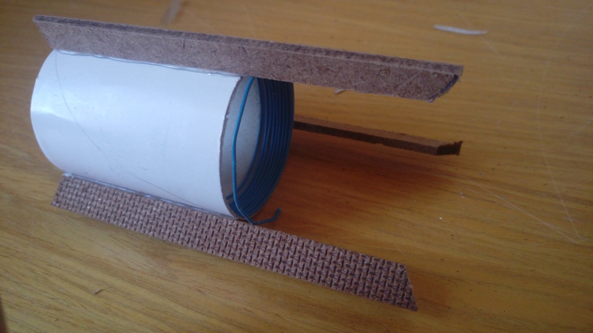

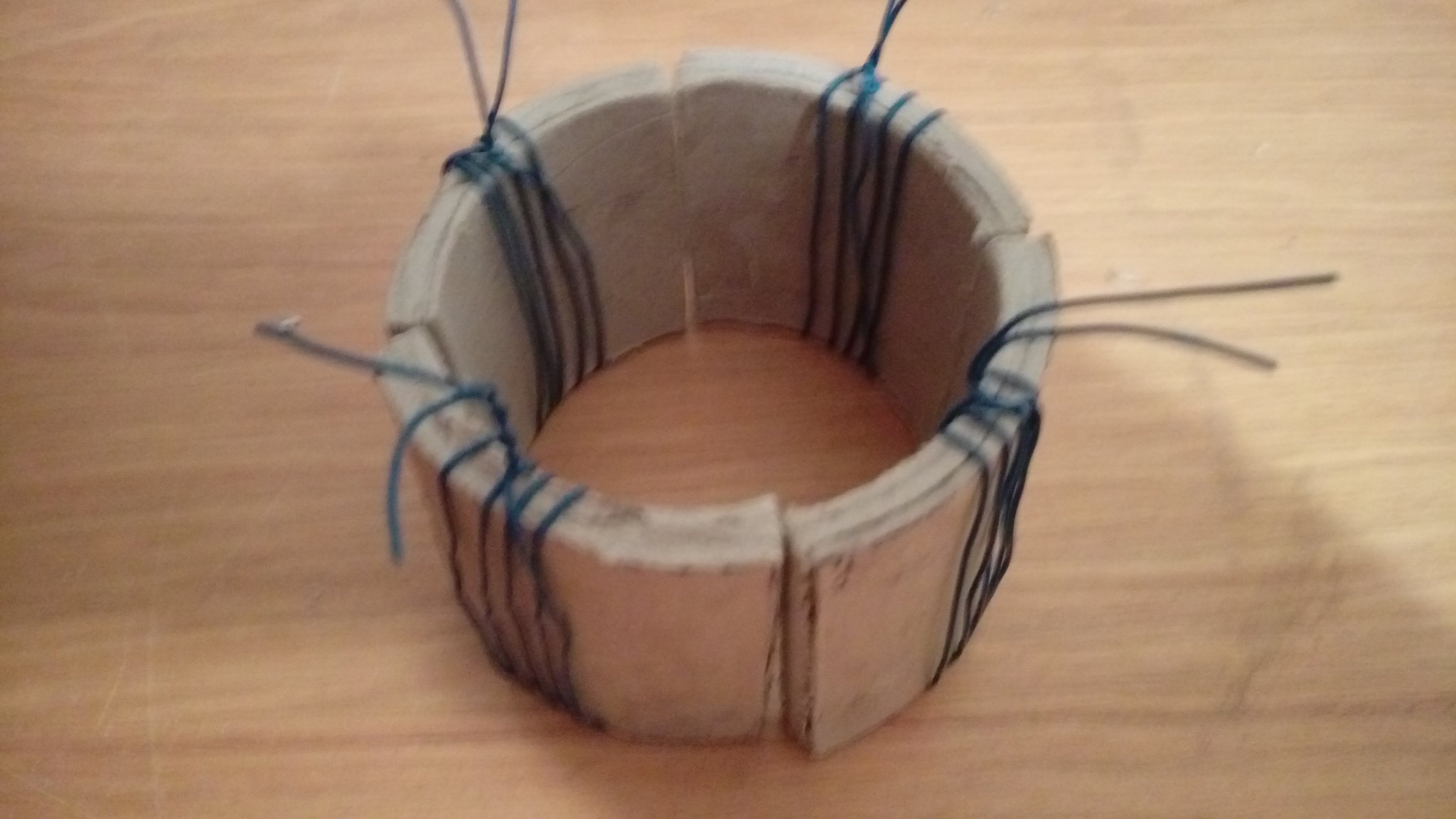

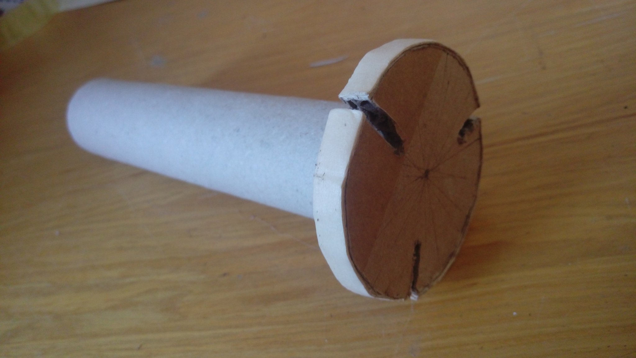

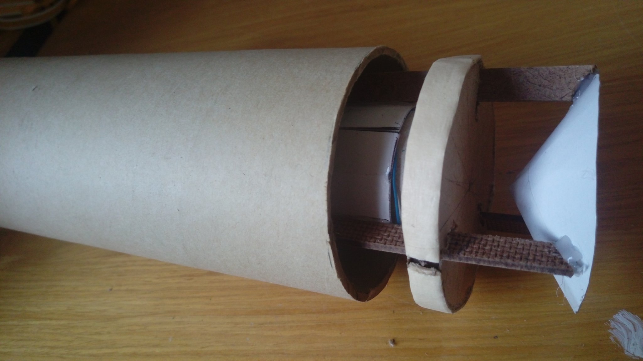

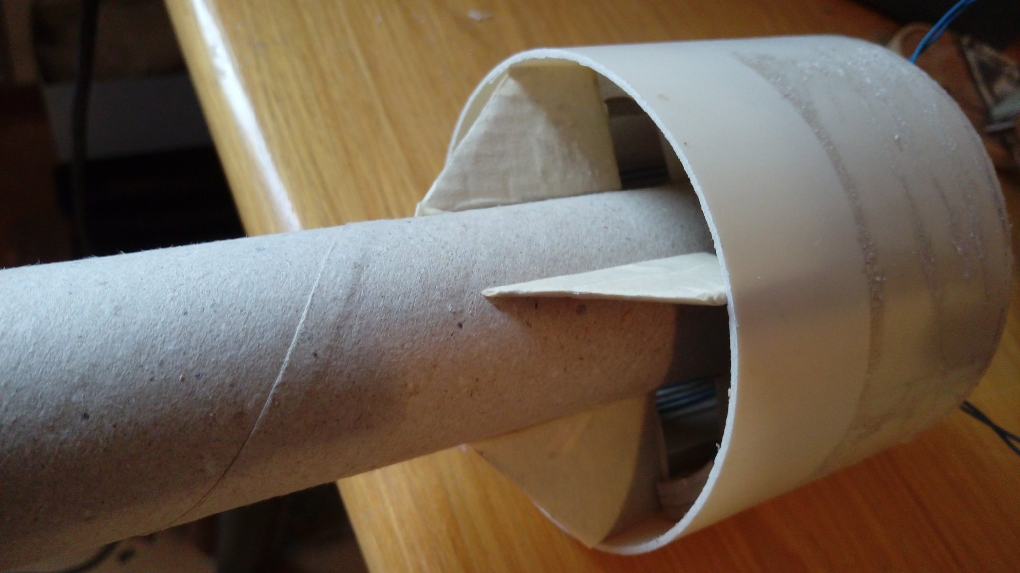

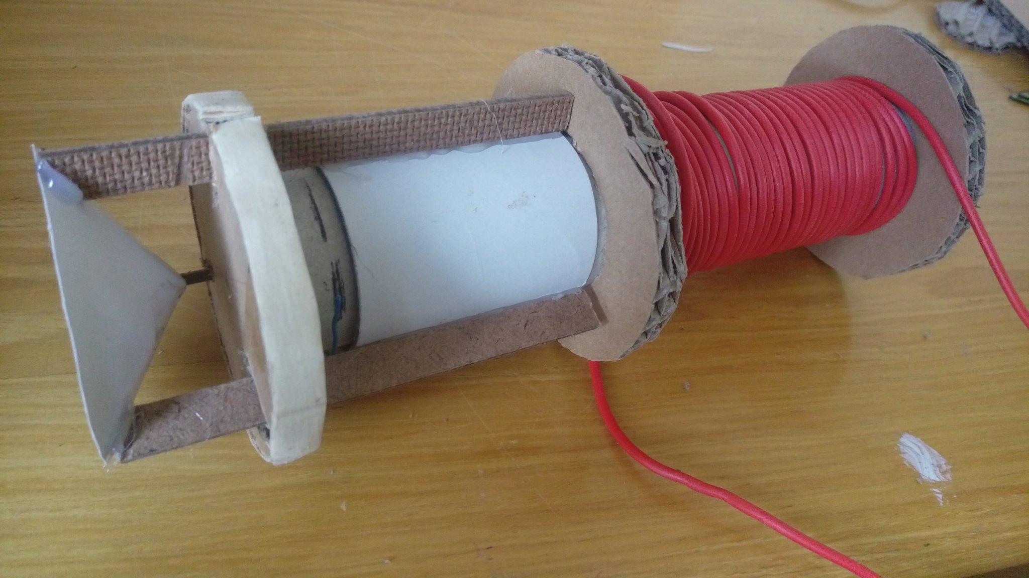

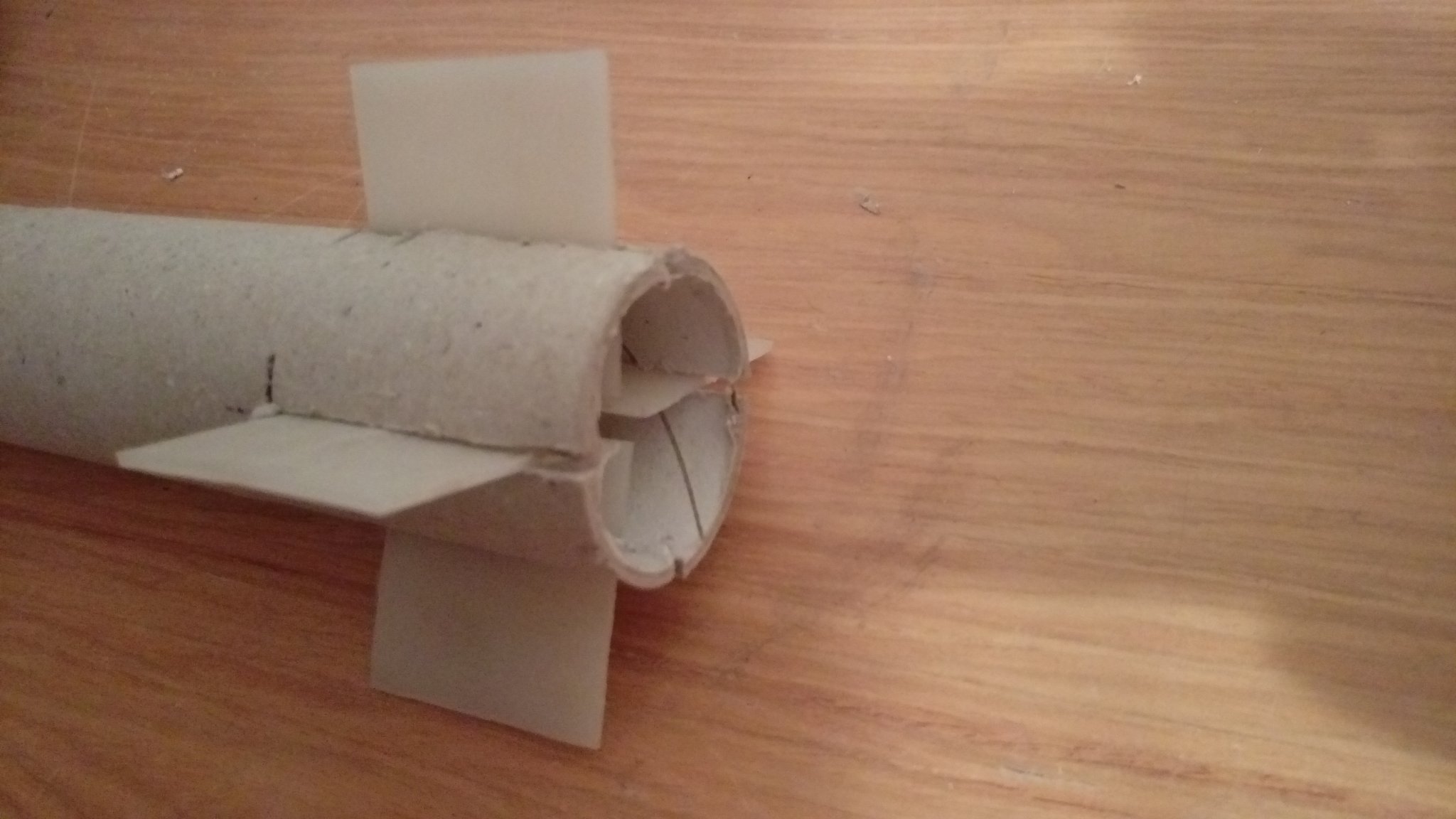

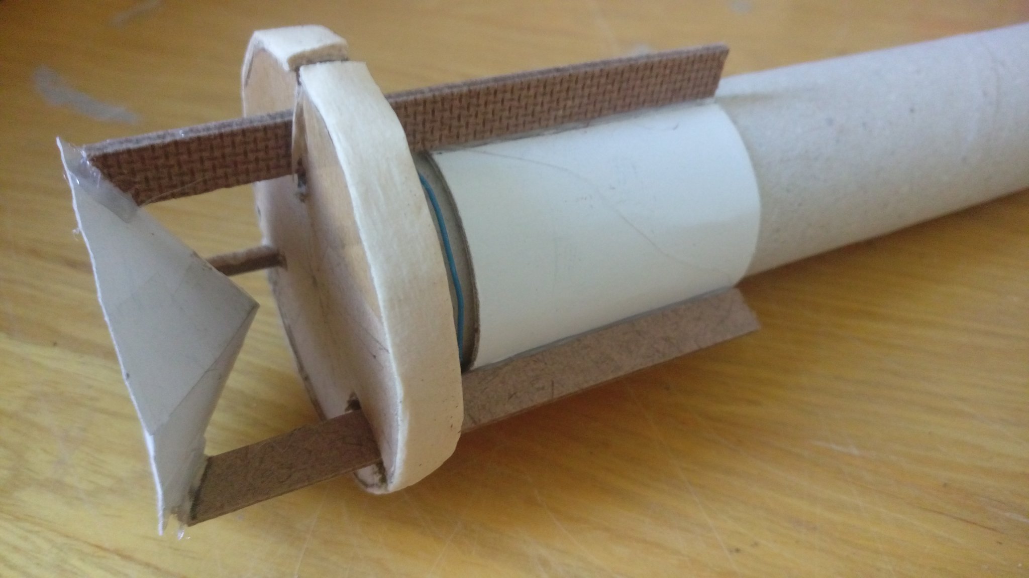

Hi everyone .

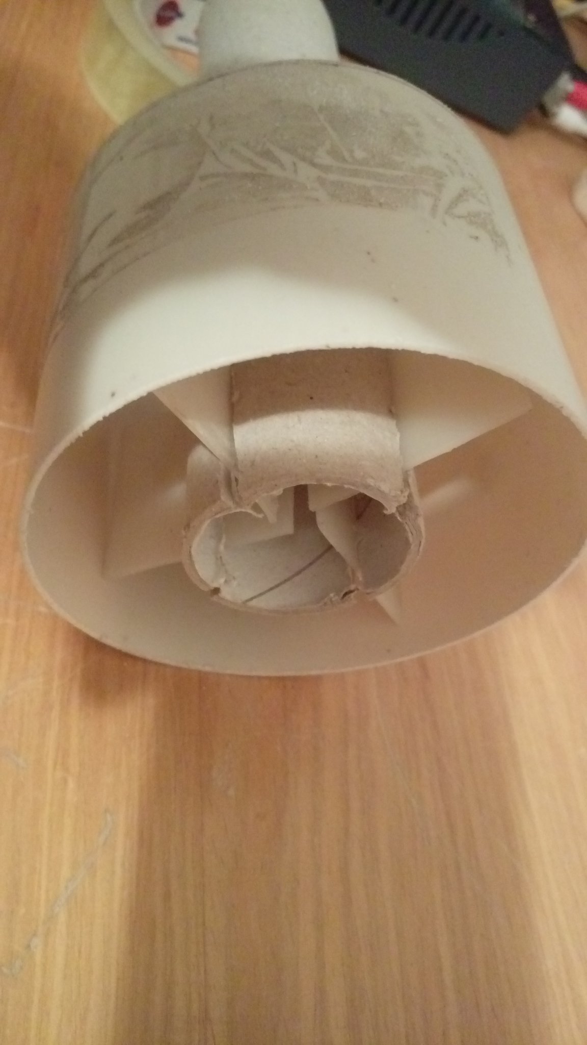

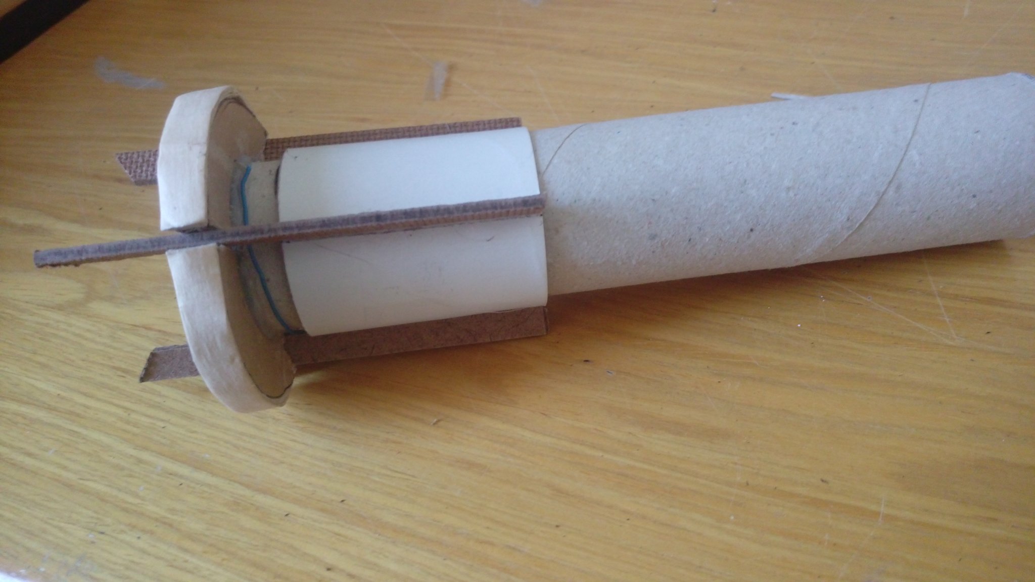

I made a cardboard model to show you what I thought. the images in this case are indispensable .
it is a field coil loudspeaker which does not have the circular cut (air gap) which completely interrupts the magnetic flux.
in this case, however, the magnetic flux manages to close through three paths that join at the center (2). This is the great advantage.
but there are also disadvantages. the voice coil is located further away, it is more difficult to design the path for the voice coil terminals.
the winding of the voice coil is not located outside the support but inside, the three rods serve to join the voice coil to the loudspeaker cone (actually the cone you see in the image is small and must be glued to the cone than the loudspeaker which is much bigger ). I believe it is possible to do everything in carbon fiber with a 3D printer (1).
the red wire you see (5) is the winding that creates the magnetic field.
finally everything is placed inside a hollow cylinder to create the ring in which the flow closes (6) .
do you think it works?

in this case they would be two concentric magnetic fields
The magnetic field would be going the wrong way. You need flux lines going through your voice coil in the same plane of the windings and perpendicular to the windings to generate axial force to move a cone. This is a bad description, but if you have a magnetic field oriented along the same axis as the voice coil, you will generate force inwards and outwards on the coil. Look up the right hand rule for Lorentz force for a better explanation.
Reactions: Arez
I've always heard about Lorenz's right hand rule and strength but my head has always refused to believe it. Obviously you're right, otherwise it wouldn't explain why everyone does this. it would be wanting to deny the laws of physics. but explain one thing to me though, because two linear permanent magnets placed on the same axis attract and repel each other according to the orientation of the poles? . obviously everything changes between the permanent magnet and the winding.

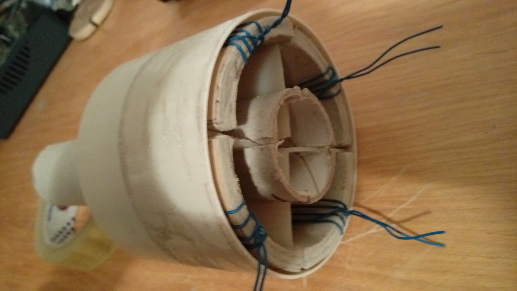

could this work?
the magnetic field is formed inside the circular toroid made up of 4 elements each fed individually, image16.
electric current flows within strips of thin metal perpendicular to the magnetic field, image18.

If I understand your idea correctly, yes, that could work. If you create a circular magnetic field in your toroid and have current flow from outside to inside through the gaps in the toroid that would generate force aligned with the centerline of the toroid. It seems pretty complicated though. What do you see the advantage being? You'd probably want to keep your conductive strips to be short in the direction of current flow so you don't have a bunch of extra resistance that isn't generating force. You'd have a bunch of structures that would be tough to make stiff enough to not resonate in undesirable ways, I would imagine.
yes you understood correctly. the main advantages that come to mind are two. absence of inductance or superfluous. the air gap can be greatly reduced compared to the traditional system, perhaps less than half a millimeter because in this case there is no thickness of the support and the copper wire. perhaps with this system instead of a copper strip metal as a conductor, new materials such as graphene could be experimented with. If I understand correctly the Lorenz force one of the factors it depends on is the speed of the electrons and in graphene it seems to be 100 times greater but more in-depth studies need to be done. regarding the structure, it can be done in carbon fiber with 3D printer. but all this is to be verified.

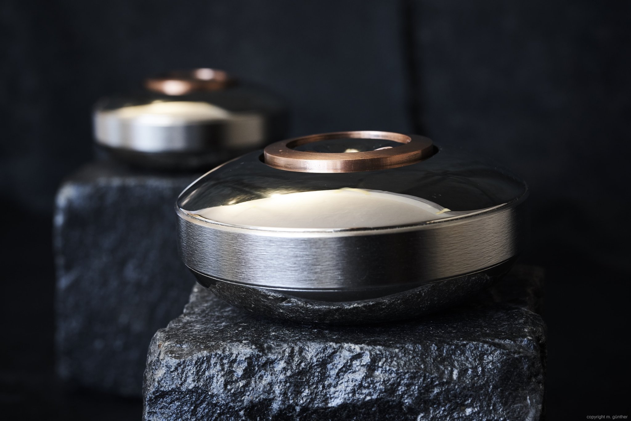

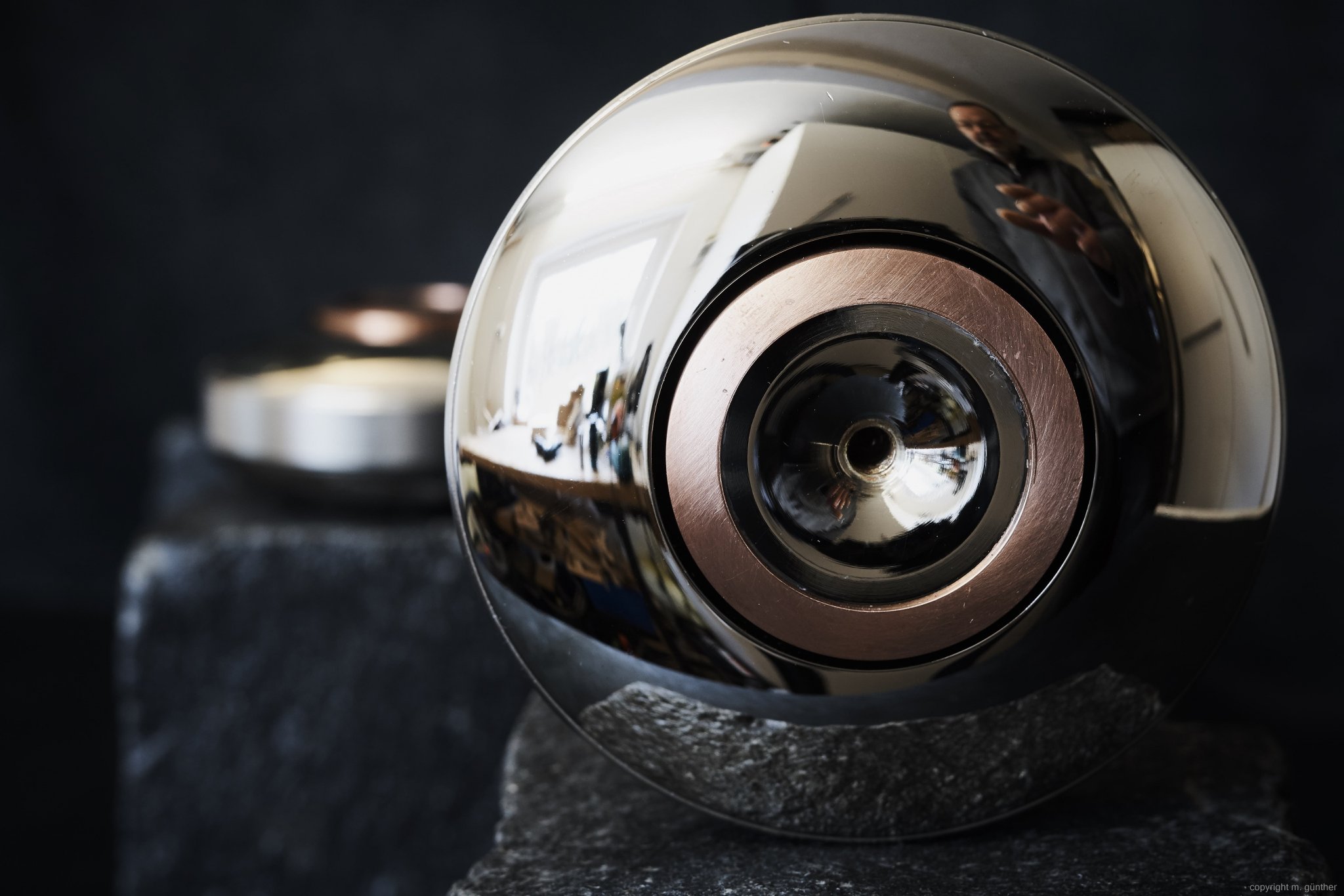

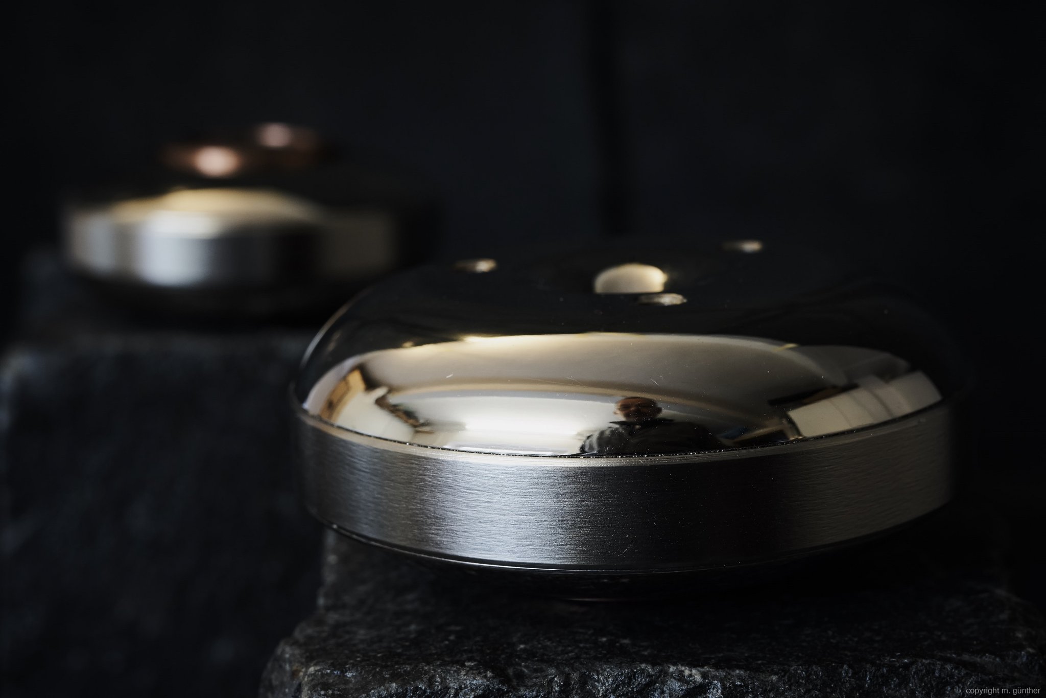

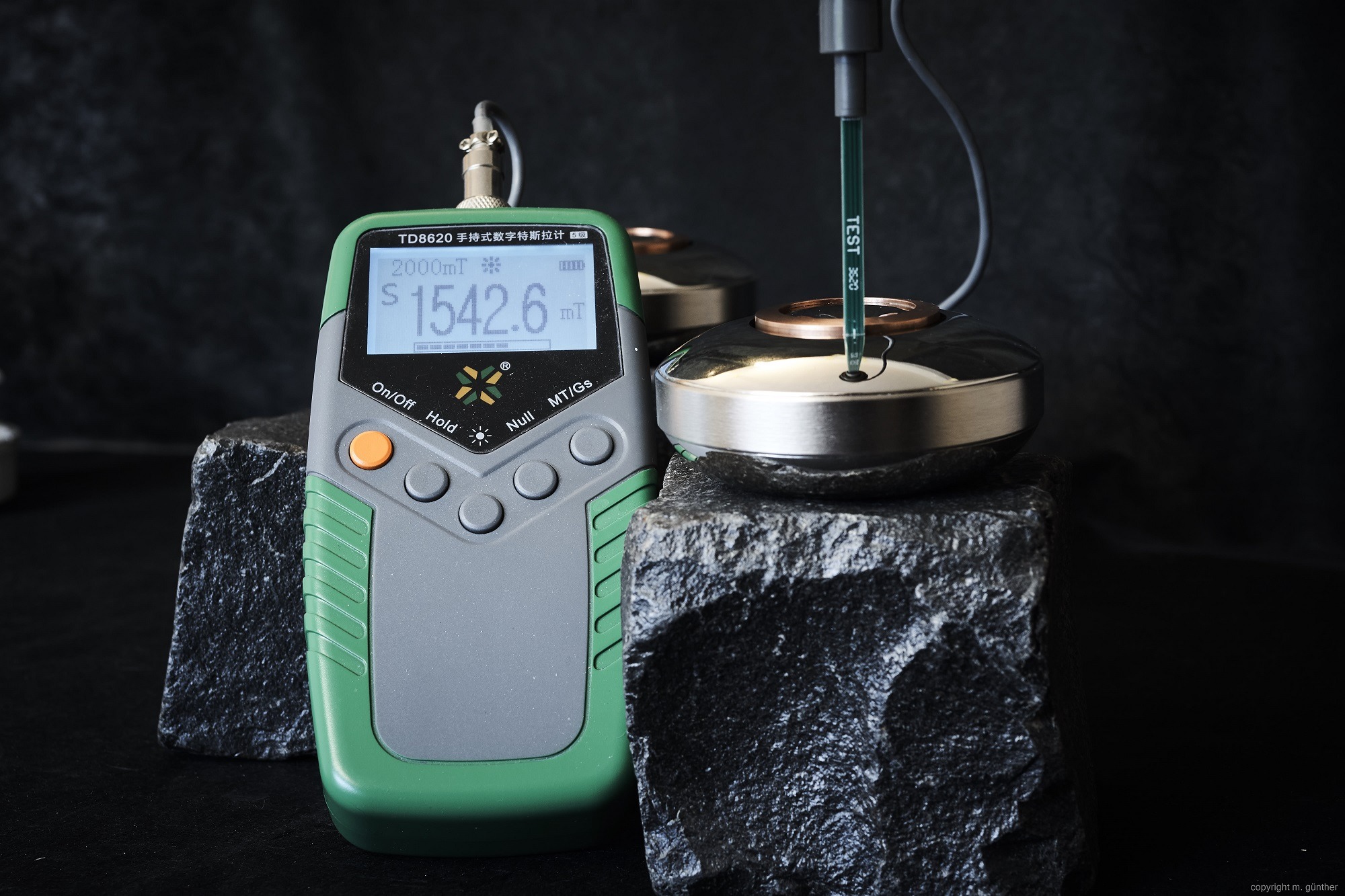

Pure iron saturates at 2,18T, and depending on motor geometry and magnet force it can be saturated (my motors are fully saturated). But of course this is not what you will have in the airgap. My airgap has 1,3mm with a length of 10mm and a diameter of 40mm, and I have (measured, not guessed) 1,54T in the airgap. Pure iron was the best compromise, it is expensive, but not extremely so as Permendur, which would have costed much more and could have resulted in app. 0,1T to 0,15T more in the airgap. That´s it. Whenever you read of claims or advertisments of 2,3T in the airgap - don´t believe it, it´s not possible. Physics.
1018 steel is standard. A bit better results are possible with 1010 steel, but Pure Iron is still better and allows to have around 10% more power in the airgap. FEMM is a great tool and will show you what´s possible and what´s not possible. The simulations are pretty precise and match reality quite good.
