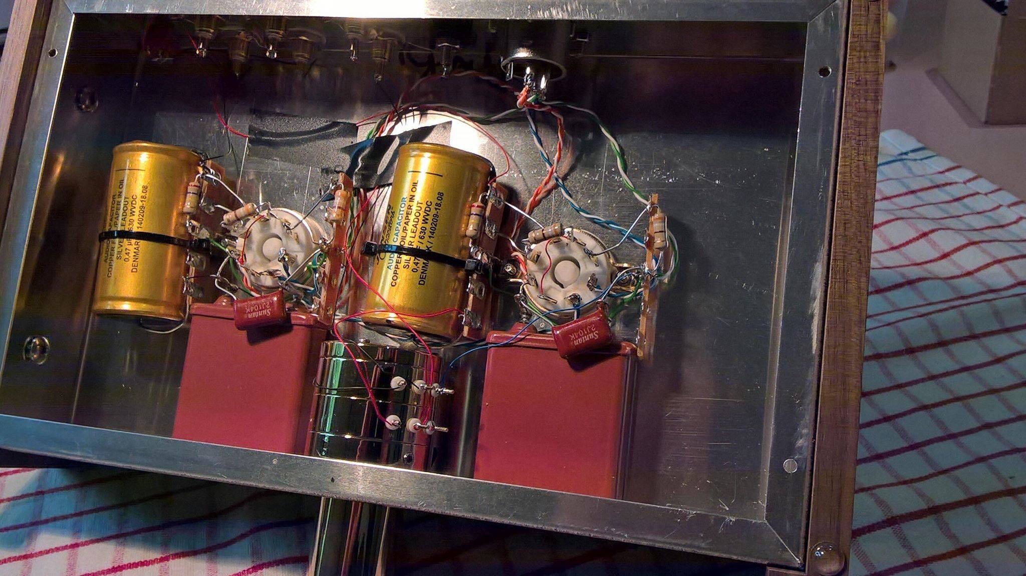

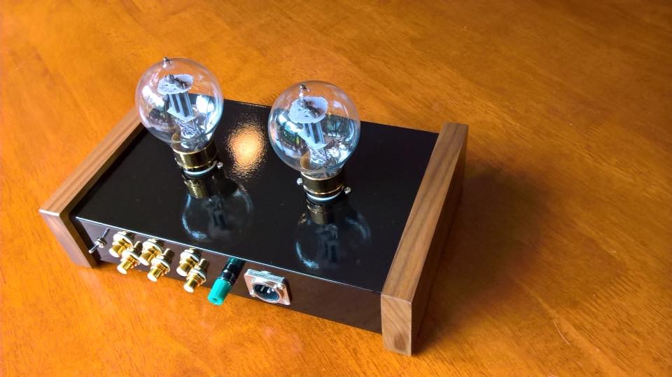

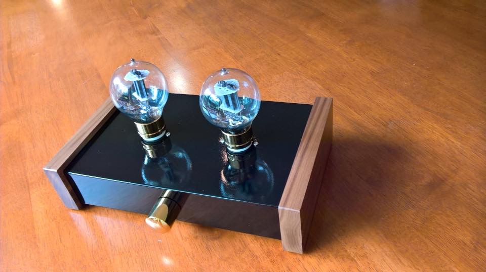

I had always wanted to build something with globes. When (recently) these were released I decided it was time. I built three of these and two got sold off one on commission.
I called the first preamp “Grace” then the next two “Elite”. The difference between Grace and Elite is a premium stepper attenuator at twice the price of Grace’s. Better parts are; Jensen copper paper and oil output caps, premium stepper and twin PIO final storage caps. The tubes are very expensive compared to even good quality 6SN7s but sound excellent.
But I think the ShuGuang CV-181Zs may sound better. I built yet another of these preamps with the ShuGuang tubes and some slightly less expensive parts and think it sound better. See other of my posts here.

I use to use XLR like that.
Then I discovered that most are rated at 125V, and it seems the 250V rated plugs are becoming scarcer.
After that I wouldn't risk them with HTdc.
I've used Amphenol connectors but 500V rated, but prices are variable and more costly than an XLR. Clones exist which are cheaper though.
