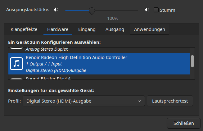

what does right-clicking the sound icon in the task bar for you? for me it shows the settings, under the tab "hardware" i can set profiles for available devices. exuse the german text, if necessary i can try to get screenshots in english
bottom most - "Profil" here you can switch to multi channel if the device supports it.
