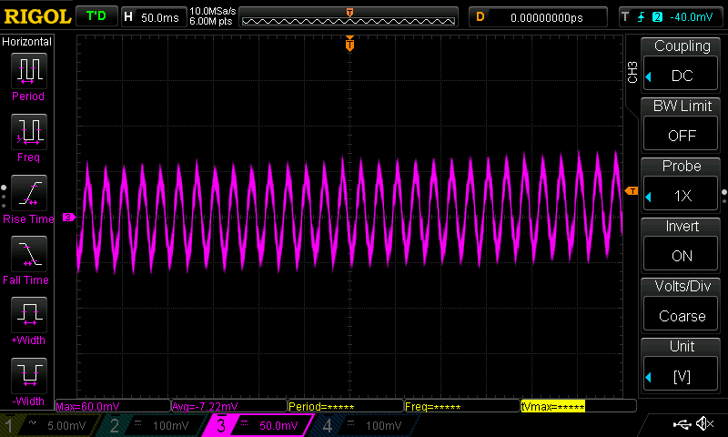

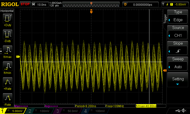

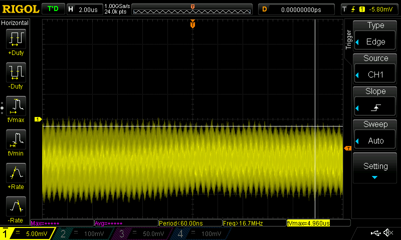

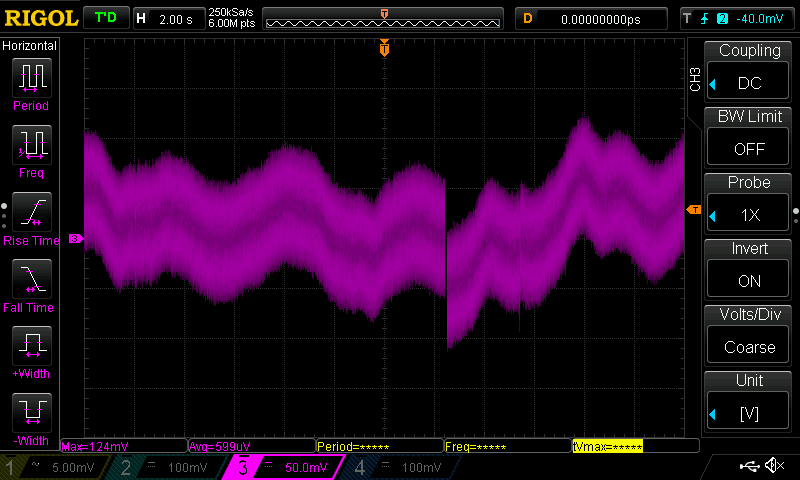

The voltage between TP0 and TP1 (or TP2) measured with inputs grounded still fluctuates (a few V up and down). I have attached some screenshots to show what I found.
Setup:
2 x Pumpkin pcb, each connected to its own Shunty
Inputs grounded
Pumpkins voltage supply steady +/-36V
Pumpkin A
Yellow traces (channel 1) = pos (or neg, can't remember) output ref. to output GND.
Pumpkin B
Pink traces (channel 3) = pos (or neg, can't remember) output ref. to output GND.

I believe you're good now to proceed with both Shunty and Pumpkin
residual HF weed you see on both you can ignore as environmental induced garbage
when you have Pumpkin boards in case, then it is what you get regarding offset stability - temperature equilibrium is what is needed
feel free to test Pumpkin with 30V rails, no problem there

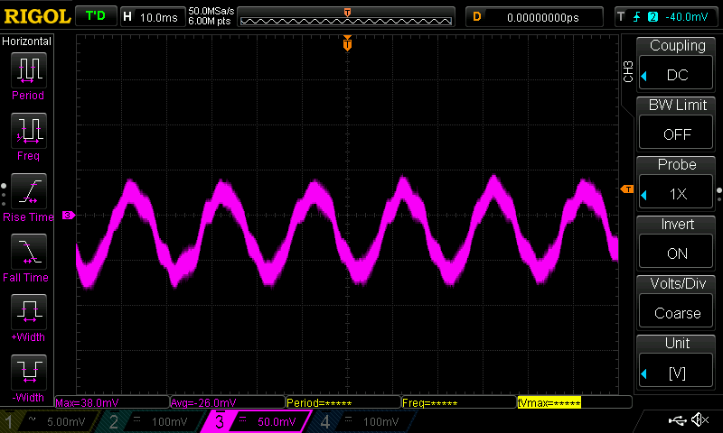

I finally had a helper here today (my regular helper in abroad for a few months) to get back to the shunties and pumpkins.
I am having a wobbly rail again on one of the shunties, so it seems the previous changes did not cure it after all.
I thought I would forget about the pumpkins for a bit and try the pumpkins using my +/-30V bench psu. Current drawn was about 150mA per rail (which seemed about right).
Single ended input, neg input grounded, no music playing.
Before trying music I measured dc output and had around 50mV which seemed high. Switching my fluke to ac I found about 2V(not mV!) at 50Hz frequency. Obviously the lab/bench psu should give reasonably clean power and should not be the cause (I did not bother measuring the psu ripple, but at 150mA the 3A rated psu should be fine).
So, I think my pumpkin wiring is picking up a lot of noise.
Next steps:
Pumpkins
The setup in my shed is obviously very noisy. I will have to change the input and output wiring to shielded to try to get rid of some of this noise. Also, probably best to test in a metal enclosure as well.
