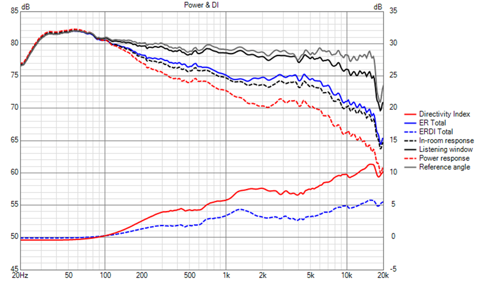

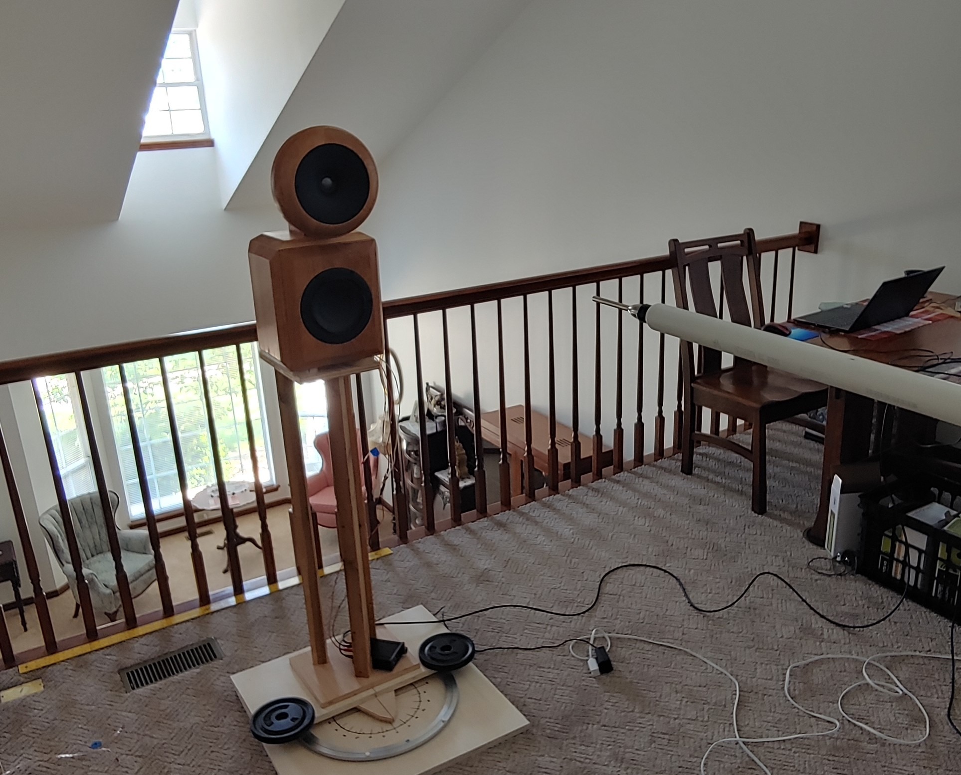

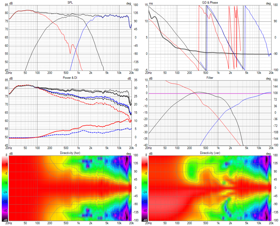

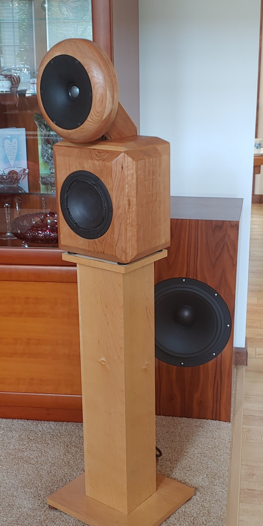

I installed the mid/tweeter cabinets into my main system. This requires I remove the existing cabinets (Satori textreme) from the stand and mount the new ones. They are secure with a 5/16 inch bolt through the bottom of the speaker. The electrical connection is to a screw-terminal bus in the upper part of the stand, and the driver wires are fitted with ring terminals. The bottom part of the stand contains the Hypex FA253 amp.
I made near field and polar response measurements of the completed system. The differences between these measurements and the polar responses of the waveguide and midrange box individually (post # ) are insignificant… i.e. there were no surprises. There were some small diffraction differences in the mid response now that the tweeter waveguide is mounted above it and it is on the amp stand rather than the test stand, but these were minor. My simulations from this point forward will use the latest measurements.

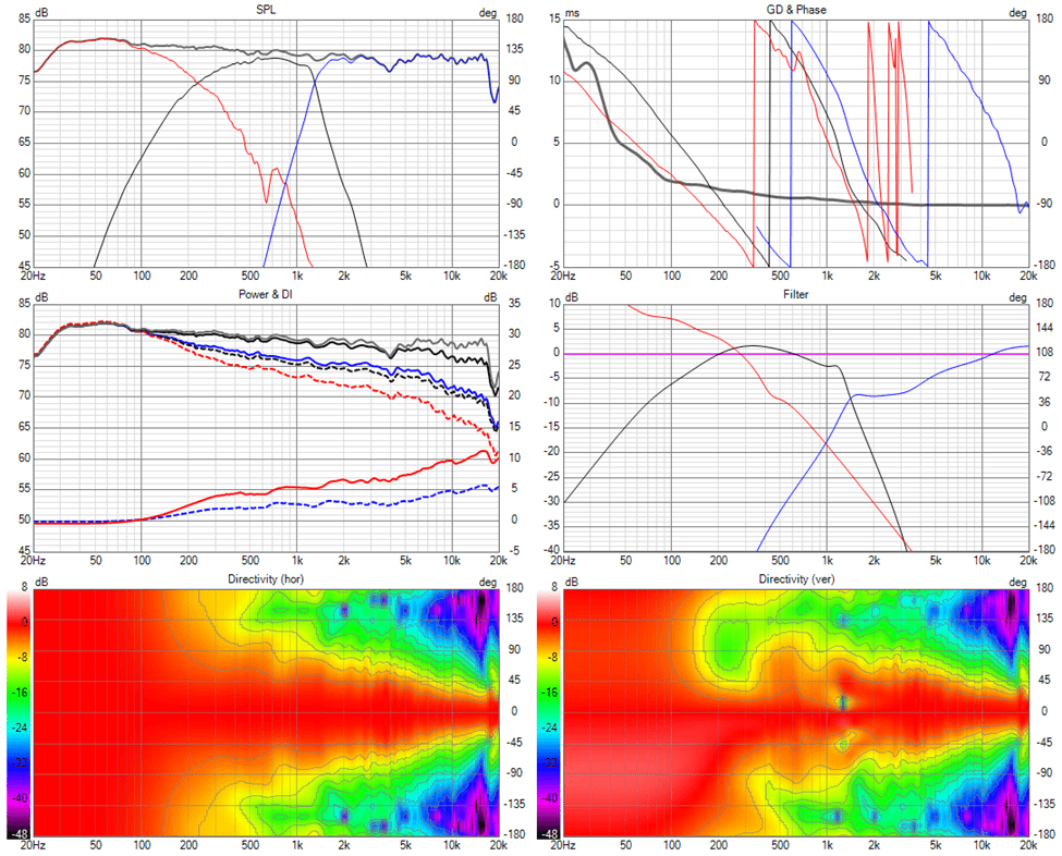

I am going through test and evaluation (T&E) of the finished speaker. The current DSP filter is one that makes T&E more simple and easy, it is a flat on-axis response with idealized LR4 crossover slopes at 1.6k, and LR2 at 200 Hz. It is not necessarily the best possible filter from a DI perspective or a PIR perspective. Nonetheless, this system sounds really good. Right from the start I noticed very precise image location, and a great perception of depth. I will have more to say later as the DSP filters become more refined.
j.
j.

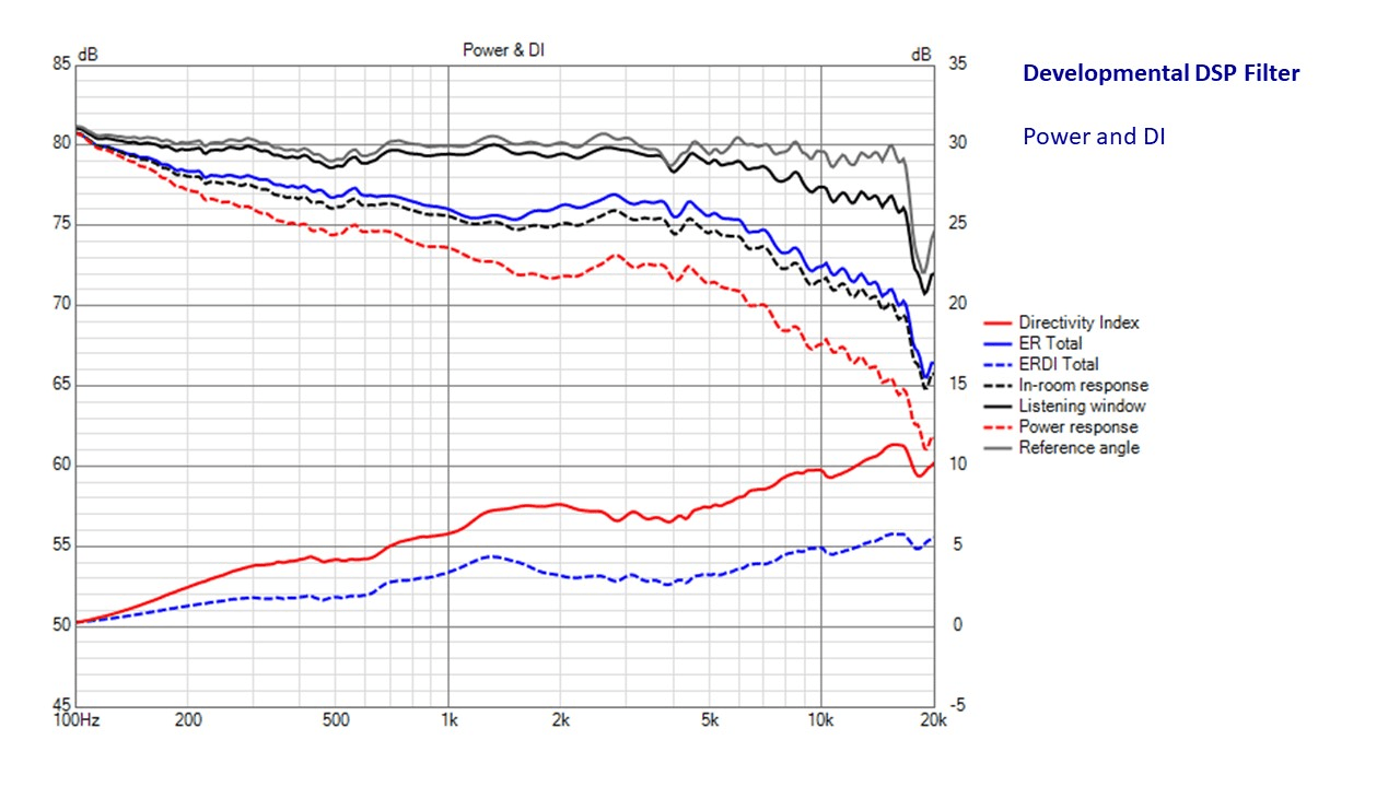

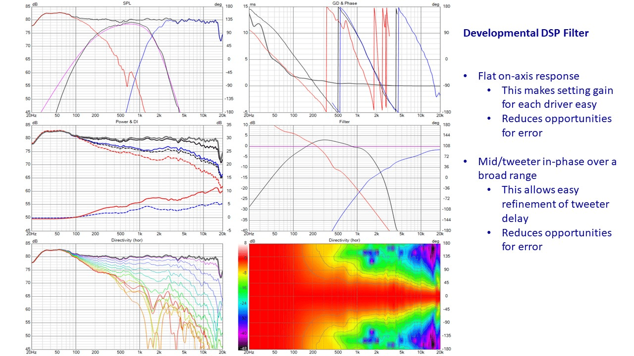

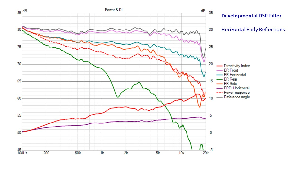

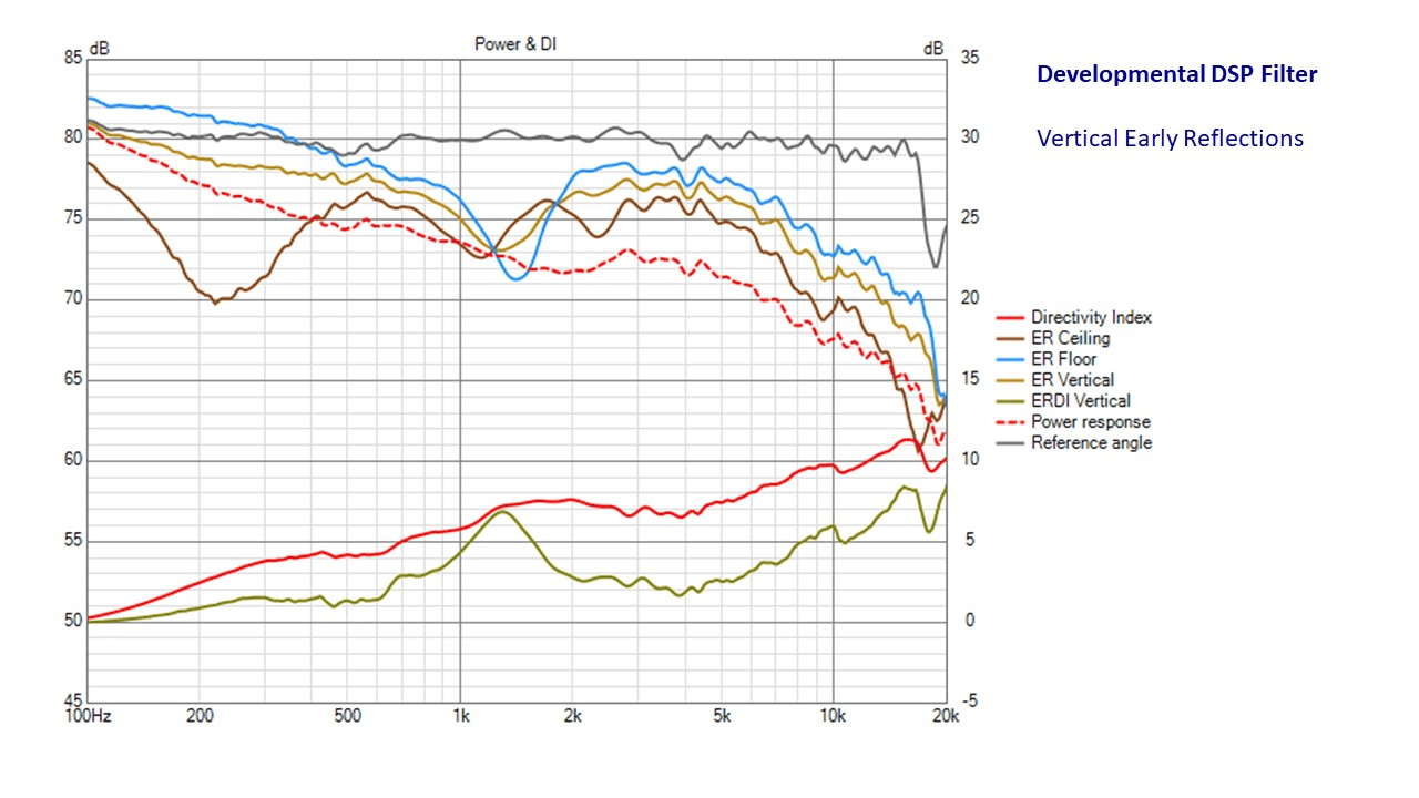

For development work I installed a DSP filter which is flat on-axis and has very close phase alignment between the mid and the tweeter. This allows me to set the gain levels and tweeter delay with no ambiguity and a low probability of error. However, this filter is not optimized for the best DI or PIR response. I view it as the starting point for fine tuning the performance, both objectively and subjectively.
I have not yet taken the whole system outside for low frequency ground plane measurements… therefore, my woofer gain settings are not finalized. I made 10 in-room measurements in the 100 – 300 Hz range for the mid, the woofer, and both together. I took measurements of the raw driver responses, and the fully eq’d responses. Based on all of this data, I estimated the relative output of the woofer relative to the mid, and then used this to set the gain.
I am very pleased with the performance. They have a smooth natural sound, great image specificity, excellent presentation of depth. Excellent detail.
The next step is to try some new DSP filters I have developed which are more optimized for DI and PIR performance.

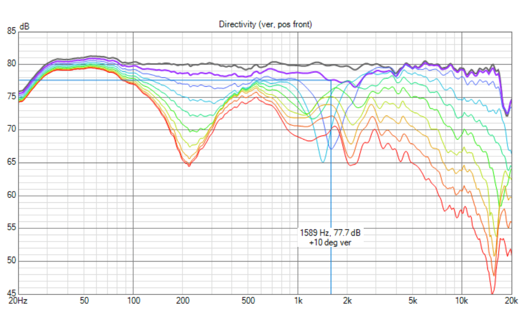

Hello @hifijim, Question?
I have the feel of the coverage angle of the Purifi mid-woofer and the coverage angle of the tweeter. The 24dB slope of the 1.6kHz crossover is also known
The distance between the centers of the mid and tweeter looks to be 12 inches plus +/- some.
Your measurements show some degree of interaction and lobing at the 1.6kHz crossover frequency.
What do your ears tell you? Between sitting and standing is there a large or noticeable difference because of the narrowing vertical coverage at the 1.6kHz crossover Frequency?

Yes, my CTC distance between mid and tweeter is 280 mm (11”). The design axis for simulation and measurement is exactly halfway between the two, so in simulation the tweeter is at y = + 140 mm and the mid is at y = -140 mm.
My actual seated listening height is below the design axis, it is more or less even with the center of the mid. This means I listen at a -3.5 degree angle, but this slight angle has no consequence in either simulation or measurement compared to on-axis.
When standing or walking around, I am a bit further away from the speakers. At this distance, my ears are at + 10 degree, and according to simulations I have a -2 dB suckout from 1.2k to 2.4k. I can hear a mild change in tonality at this position, but it is not annoying or distracting, it is just different. It is fine for casual listening. All of my serious listening is done while seated in the sweet spot.

I am just at the point where I am satisfied with the voicing of this system. So now I am ready to do a direct comparison between the TXT system and the Purifi-WG system. It has been about 3 weeks since I have listened to the TXT system, so I am hesitant to discuss my impressions at this point in detail, but I feel comfortable making some general statements....
There are differences in how the two systems present an image, the way they create the illusion of 3 D space. I will get more into that in a future post.
If a speaker sounds quite different while standing than while sitting, the primary cause is likely to be a peak or null in the + 15 to + 20 degree vertical direction... a peak would be more intrusive, but a very deep null would also be noticeable. This kind of problem at +15 to + 20 degrees vertical has little to do with CTC spacing, and a lot to do with crossover slopes and good simulations.

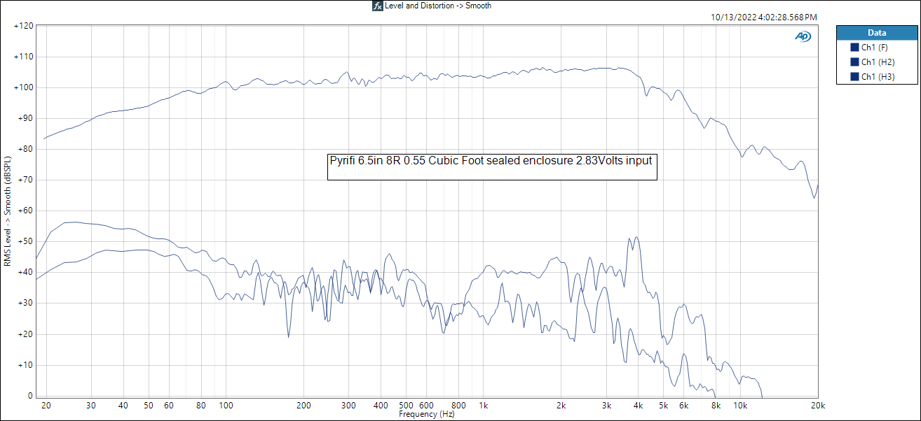

What makes a large difference is reduced distortion at higher output levels. The Purifi mid-woofer is a keeper.

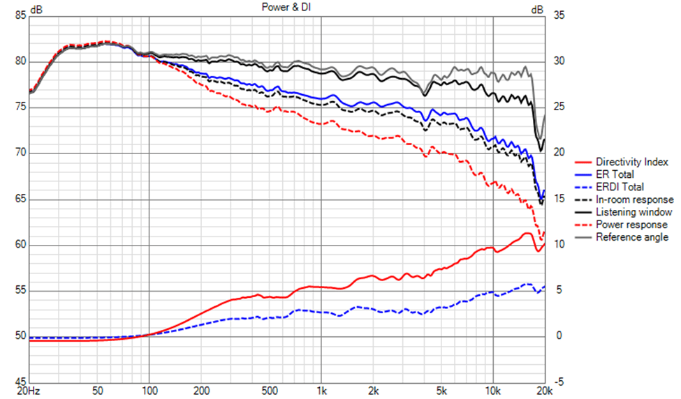

For the past several weeks I have been listening to two filters. The baseline is a straightforward 200 Hz LR2 + 1.6k LR4. The on-axis response slopes down by about -2dB from 100 Hz to 10k. In the 1.6k crossover region, I have very good phase alignment between the mid and tweeter.
The second one has been optimized for the smoothest possible DI and PIR response. To achieve this, I had to reduce directivity from 1k-2k by about 2 dB. This required a bit of a funky filter. The crossover frequency is now 1.3k. There is a 60 degree phase difference between the mid and tweeter, and some aggressive EQ to bring it all back to flat. The DI now rises smoothly from 300 Hz to 10k. The PIR curve is a straight line from 100 to 10k sloped down at -1.2 dB/octave.
In theory, this second filter should be superior to the baseline from the standpoint of tonality and balance because it has a smoother power response and PIR response. According to conventional wisdom, the baseline (first) filter should have an advantage in creating a 3D sense of space and imaging because it has better phase alignment through the crossover region.
In reality, I cannot really tell them apart. The performance of the system with either filter is very high. Clarity, detail, tonal balance; they are equal. Imaging, localization, 3D sense of space; they are equal. Dynamics, and a sense of naturalness; they are equal. My going in assumption was that I would hear a difference, and I am a bit surprised that I did not. A bit disappointed also… I was hoping to draw some conclusions regarding certain perceived sonic attributes and physical measurements.
So that is what I have so far.
