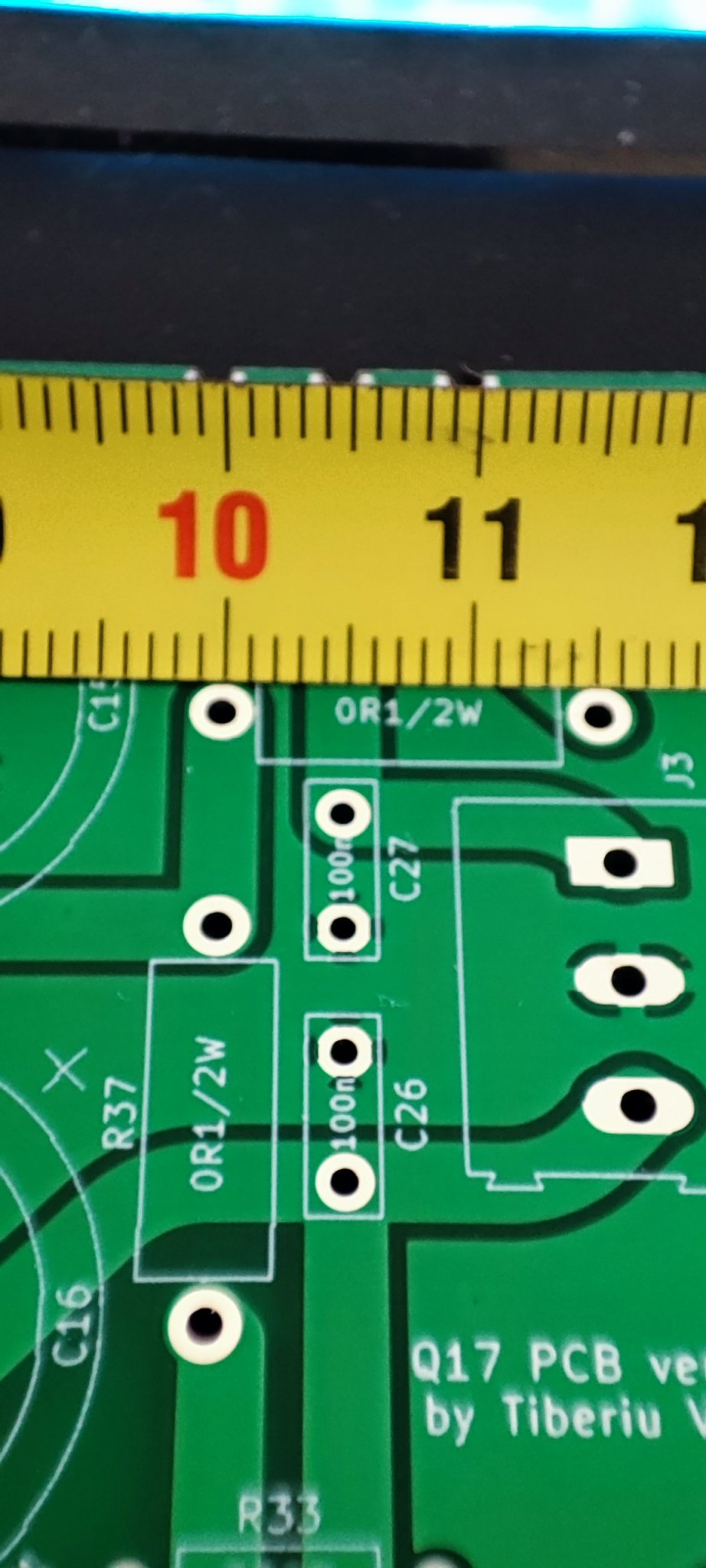

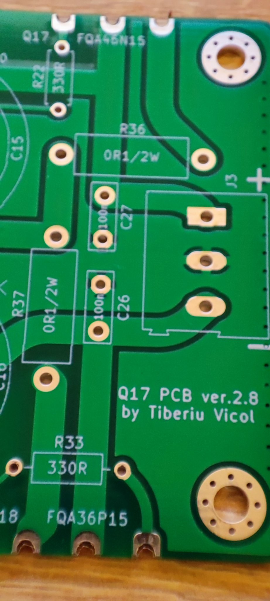

Friends,
first I'm going to compose Q17 on the original boards ver. 2.8 (2 pairs).
I noticed that on the printed circuit boards since version 2.5 there are resistors R34, R35, R36, R37 (0R1/2W) but in the BOM on the mouser 3W.
So the question is if 2W will be enough?
Dimensionally 3W metal oxide resistor won't fit much there..., Pitch ideal for 2W metaloxide.
Thank You!

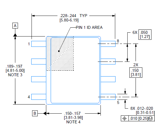

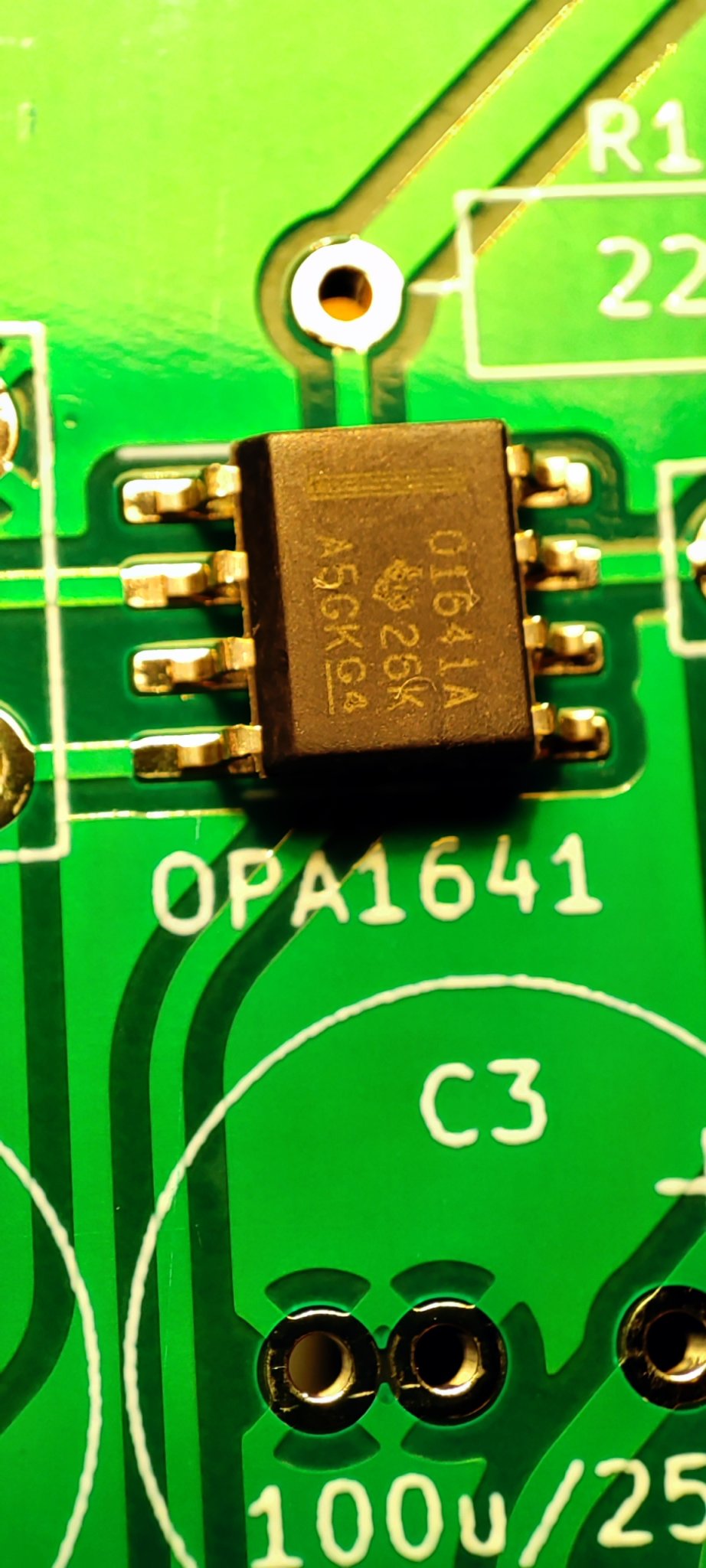

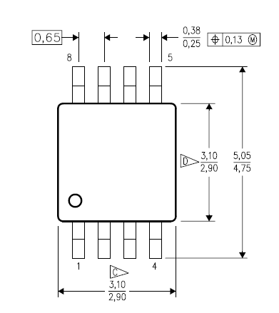

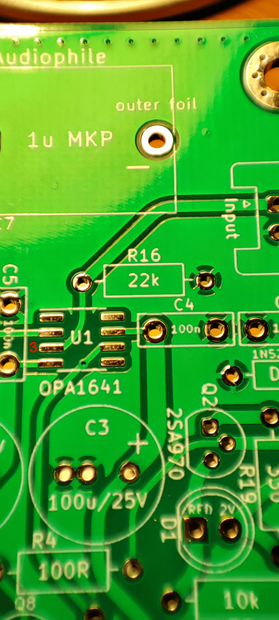

IIRC horizontal bar across end of opanp should be at same end as bar on PCB. Looks ok to me from here, but I'm sure someone else will confirm....I need advice if I have correctly oriented opa1641aid on pcb, since I don't see any cutout or dot at pin 1.
Short answer: Yes, the opamp is placed correctly.
Long Answer: In general, Pin1 can be marked by a circular depression, a laser or printed dot, a printed/lasered bar across the left end or a chamfer down the left side
If you look carefully at the package drawing in the datasheet, you will see the outline of the chamfer on the left side. Now look at your chip/photo and you will see the same chamfer on the left/pin1 side
Thank you all, I finally took another look at the fitted boards from Tibi and got it right.
