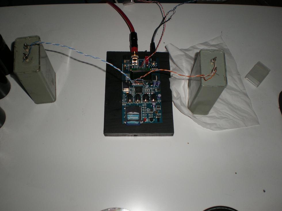

here is my mod to this SD card player. the mod includes audio-gd's ICAC SPDIF module and 2 shunt regulated power supply boards, supplying power rails +/-15V for the ICAC module and +5V for the player ( removed internal 7805 regulator) and independant +3.3V for the clock inside the QA550 player.
now it sounds 10 times better it was and also better than a lot of CDP’s i have heard.
