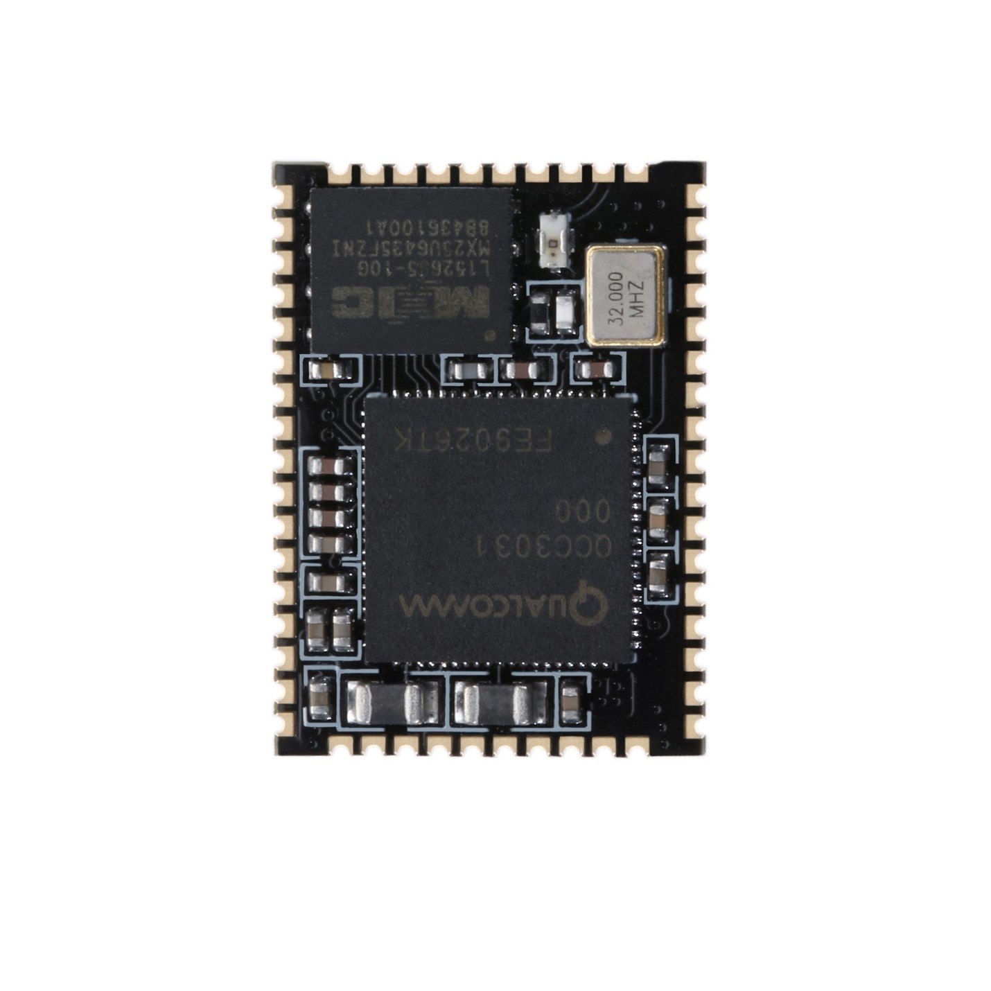

I have this module - BTM331.
965189d1625655918-qcc5125-qcc3034-qcc3031-programming-qcc3031_1-jpg
965190d1625655918-qcc5125-qcc3034-qcc3031-programming-qcc3031_2-jpg

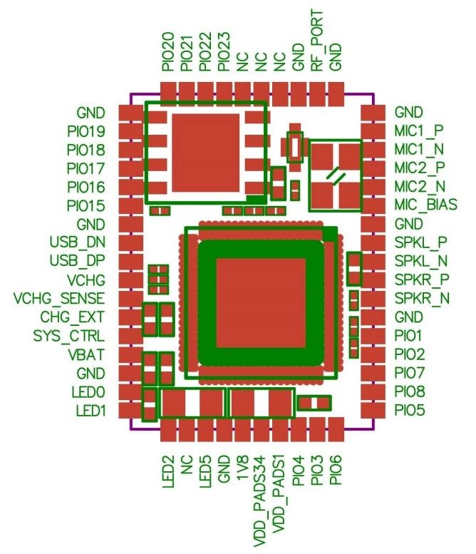

I would like to ask you to share your experience, how connect this chip to USB? How configure DSP Kalimba on this chip by USB?
On USB we have 4 pins
  • GND,
  • Data+
  • Data-
  • +5V
And we have pins on QCC3031(BTM331):
  • VBAT_SENSE
  • USB_DN
  • USB_DP
  • VCHG
  • VCHG_SENSE
  • CHG_EXT
Which pins from qcc3031 I need to connect to USB pins?
As I understood Data+ and Data- from USB need to connect to USB_DN, USB_DP from QCC3031.

If you Google the keywords qcc usb_dn usb_dp you'll find the datasheet for qcc5120 and in it there is an example diagram that shows where you need to connect USB_VBUS. That is probably needed to activate the USB subsystem. The datasheet also states that the ADK documentation has the necessary info for programming the chip, maybe it includes the connection info.
Hi, thanks for your comment.
I opened QCC3031 datasheet and found information about USB:
"The transaction bridge is an external bridge into the internal transaction bus between QCC3031 QFN subsystems. It
is the primary debug interface and can also be used for production programming."
"A direct USB2.0 connection from a host computer to the QCC3031 QFN can be used for most
debugging and programming activities. For more details, see ADK documentation."
"TRBI200 use is not mandatory for flash programming or other manufacturing operations. Those actions
are performable using direct USB connection to the QCC3031 QFN USB device interface."
And in datasheet, I found this "USB_VBUS (VCHG)" - is it mean that + from USB need to connect to VCHG?
GND -> GND
Data+ ->USB_DP
Data- ->USB_DN
+5V ->VCHG
Am I right? Or need something else?
The 5120 datasheet has an example diagram which shows USB_VBUS connected to multiple pins. I don't know if 3031 is different.
I tested connection:
GND -> GND
Data+ ->USB_DP
Data- ->USB_DN
+5V ->VCHG
And it works! I unlocked the device and now I'm trying to work with MDE.

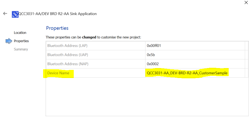

By the way, I still don't know how to rename this chip :)

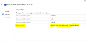

I take my words back, I know how to rename the chip, this is simple, when you create a project in MDE, the name of the project will be the name of the chip after the DFU process.
attachment.php
I understood how to change settings and upload these to the chip. I will check it first on my chip and will let you know.
Based on my experience with CSR chips I can say that QCC30XX chips are more intelligent. MDE gives you quate more opportunities than PSTool.

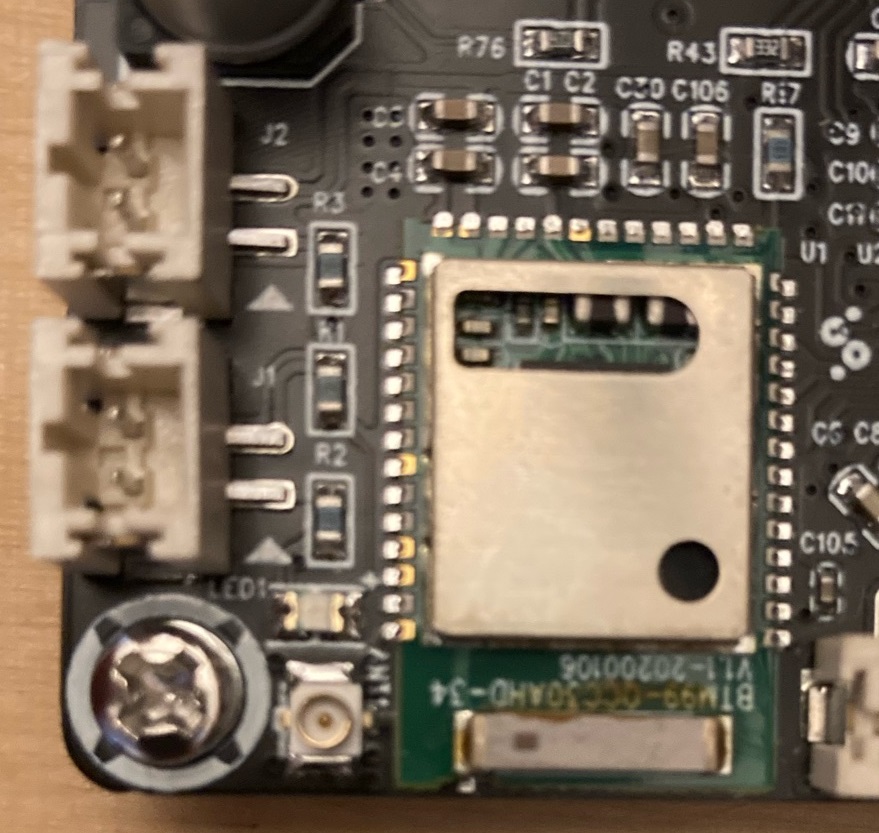

Hi all, hi German1212,
I‘m new to this forum and I registered because of this thread to be honest.
So my problem is the following:
I have a Wondom Jab4 bluetooth power amp, which is actually using a qualcomm qcc3034.
I know Wondom proposes a service for changing the pairing name, so the pairing name should be changable after production.
There is a 5-pin connector on the backside of the board just under the bt-module called J3, which is not labeled.
I got an answer from Wondom, telling me that I should use the qualcomm programmer, which is extremelly expensive. I also got the answer about the pinout of J3.
as follows:
1 -> MOSI
2 -> MISO
3 -> CLK
4 -> 3V3
5 -> GND
Do I have another possibility to change the „friendly name“ than using the qualcomm programmer?
If yes, would you mind sharing your experiences with me?
thanks in advance!
cheers, F.

Hi, you can change the name with a tool that @hvmcsa provided to me. It calls QCC tool: QCC_Tool_v1.0.3.zip — Яндекс.Диск.
You need to find the next pins on your Bluetooth chip:
  • GND
  • USB_DP
  • USB_DN
  • VCHG
After that you will be able to connect to it by USB:
GND -> GND
Data+ ->USB_DP
Data- ->USB_DN
+5V ->VCHG
By the way, I googled the board "Wondom Jab4" this is quite good stuff, this board has external DSP chip ADAU1701, this is a very powerful chip for good sound quality.
thanks a lot for your reply.
It will be a game of patience to find out which pin is which
I allready asked Wondom, let's see if they mind sharing it. GND will be pretty easy, maybe VCHG too, the other ones will be harder to find without reply from wondom.
F.

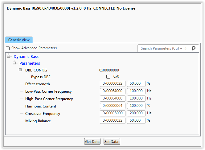

Hi all,
I continue working with QACT and I have questions about the Dynamic Bass feature. As I understood this is clever thing to bass boost better than just a simple equalizer. This is really digital sound science. I found documents but this is difficult to understand, that's why I ask. This is a useful link: https://citeseerx.ist.psu.edu/viewdoc/download?doi=10.1.1.524.4796&rep=rep1&type=pdf
attachment.php
Did anybody work with that feature?
How configure it correctly?
What does mean Harmonic content?
I will be happy your any ideas and experience about it.
My guess, by harmonic content, is digital sound processing, that looks at the fundamental bass content of the source material and then adds in additional 2nd and 3rd harmonics to provide the illusion of bass.
Like if your speakers only go down to 100Hz, 50Hz will sound like nothing, especially if you have a high pass to protect the drivers from over excursion in passive radiator/ported cabinets. So lets say the song plays 50Hz and through those speakers it sounds extremely bass light. The DSP adds in additional harmonics at 100Hz and 150Hz and provides the illusion of some bass being present.
Question German, the ADK that you linked to comes with an ADK configuration tool. Does this work via USB programming for you? It should allow you to change a variety of settings to suit your intended application without having to rewrite source code. I am trying to figure out if this only works via the SPI programmer or if it is also possible via USB. Thanks.
Answer to your question - Yes, ADK works perfectly with USB. I have configured at least 3 modules 3031\3034 via USB.
Thanks for your answer. I figure out how it works, but I'm not sure what parameters a need to set for the best sound.
For example, I have a speaker with passive radiators and speakers 2.0 with fs 103 Hz. What are the parameters I should set?
Effect strength - 50%
Low-Pass Corner Frequency - 150 Hz
High-Pass Corner Frequency - 50 Hz
Harmonic Content - 50% (How does this parameter affect the sound?)
Crossover Frequency - 150 Hz
Mixing Balance - 40%
Are those parameters good for this speaker?
Thanks.
I really do not know how the parameters affect the bass enhancement as it sort of implies that there could perhaps be a separate low frequency channel too somewhere. Maybe this is possible as I know an LFE/sub output is part of the configuration somewhere, but who knows.
I'm assuming that harmonic content would determine how many additional harmonics are generated. Some % might = 2nd harmonic only, a higher % might mean 2nd and 3rd are generated etc.
Effect strength vs mixing balance is confusing as I could see both of them doing exactly the same thing. In other words how much of these additional harmonics are added to the original sound.
The high-pass corner implies the -3dB point for a high pass that would ordinarily protect the speaker from frequencies it cannot produce. Obviously we've no idea what the slope type used is.
The low-pass corner could be asking how high up in frequency do you want the additional harmonics to be added, or it could be how high up do you want the enhancement to detect the presence of the bass fundamental.
The crossover frequency is kind of bizarre as a parameter for this.
Without an explanation as to what the settings do you're just going to have to give it a go and see.
If you wanted to quantify the results you could connect the output of the bluetooth module to the input of a soundcard. Play sine tones and white noise as stimuli on a phone with an appropriate app and then alter the parameters of the enhancement and see what happens.
