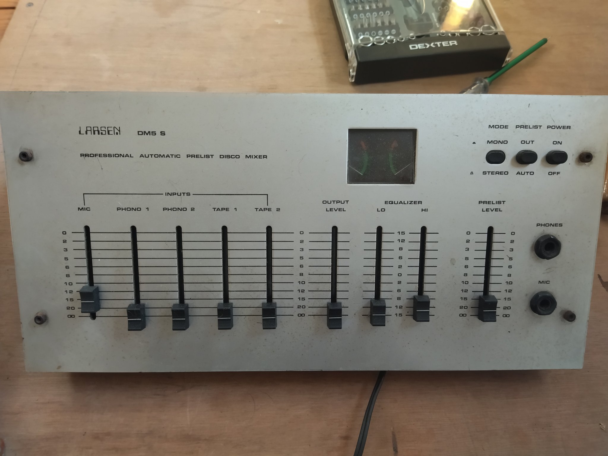

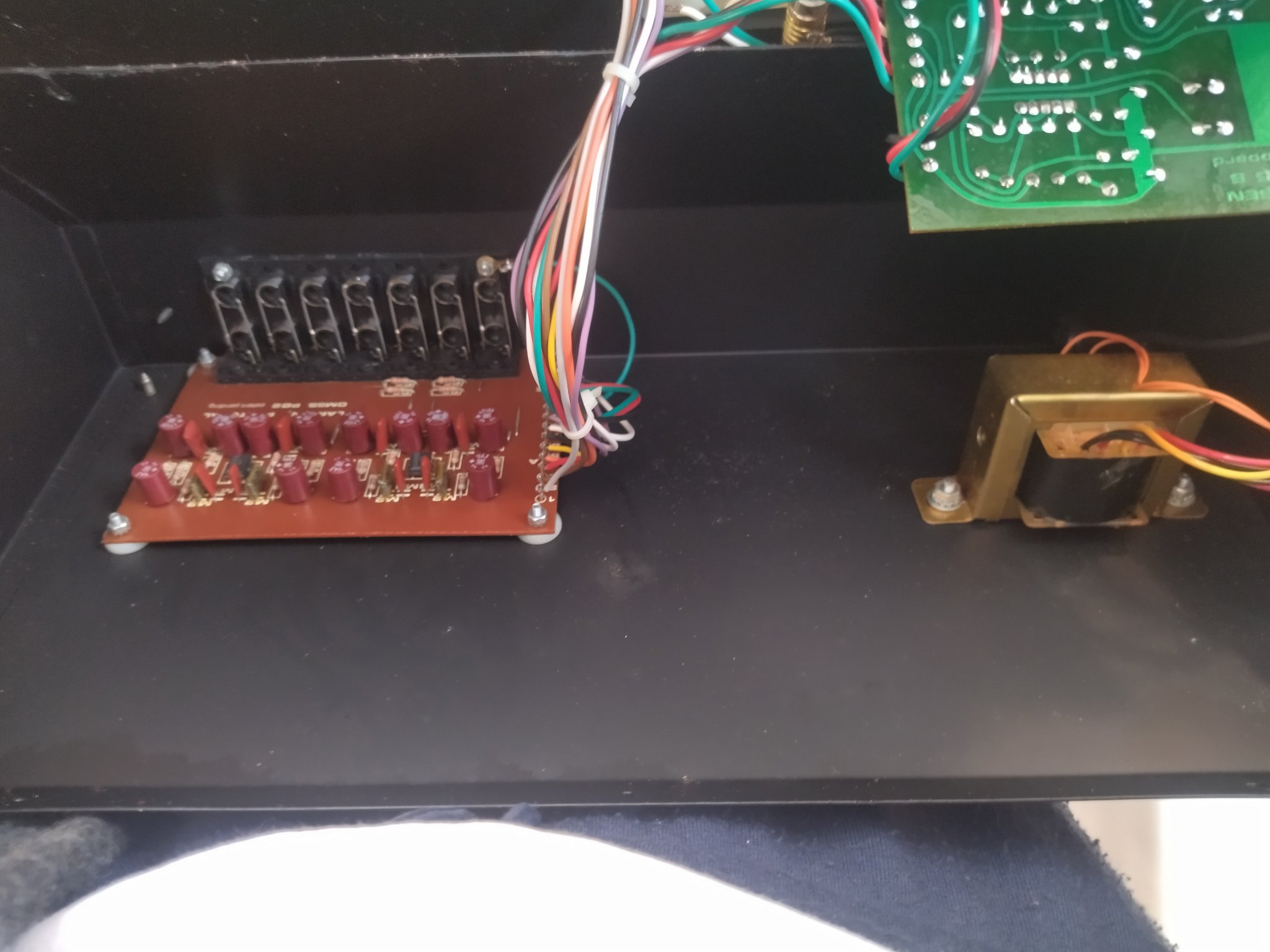

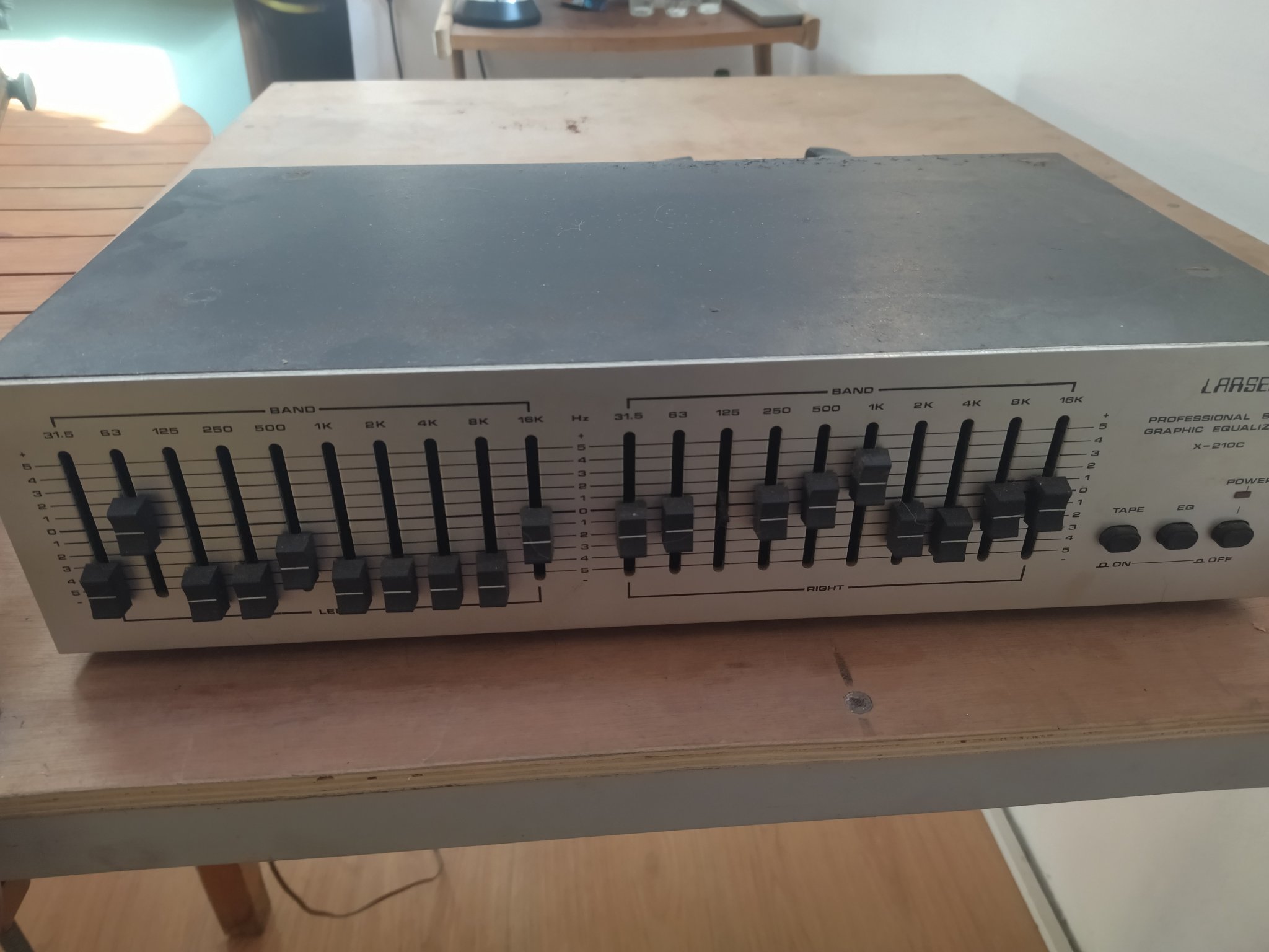

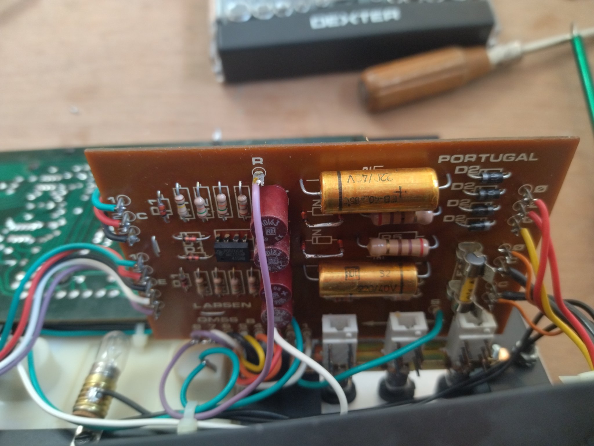

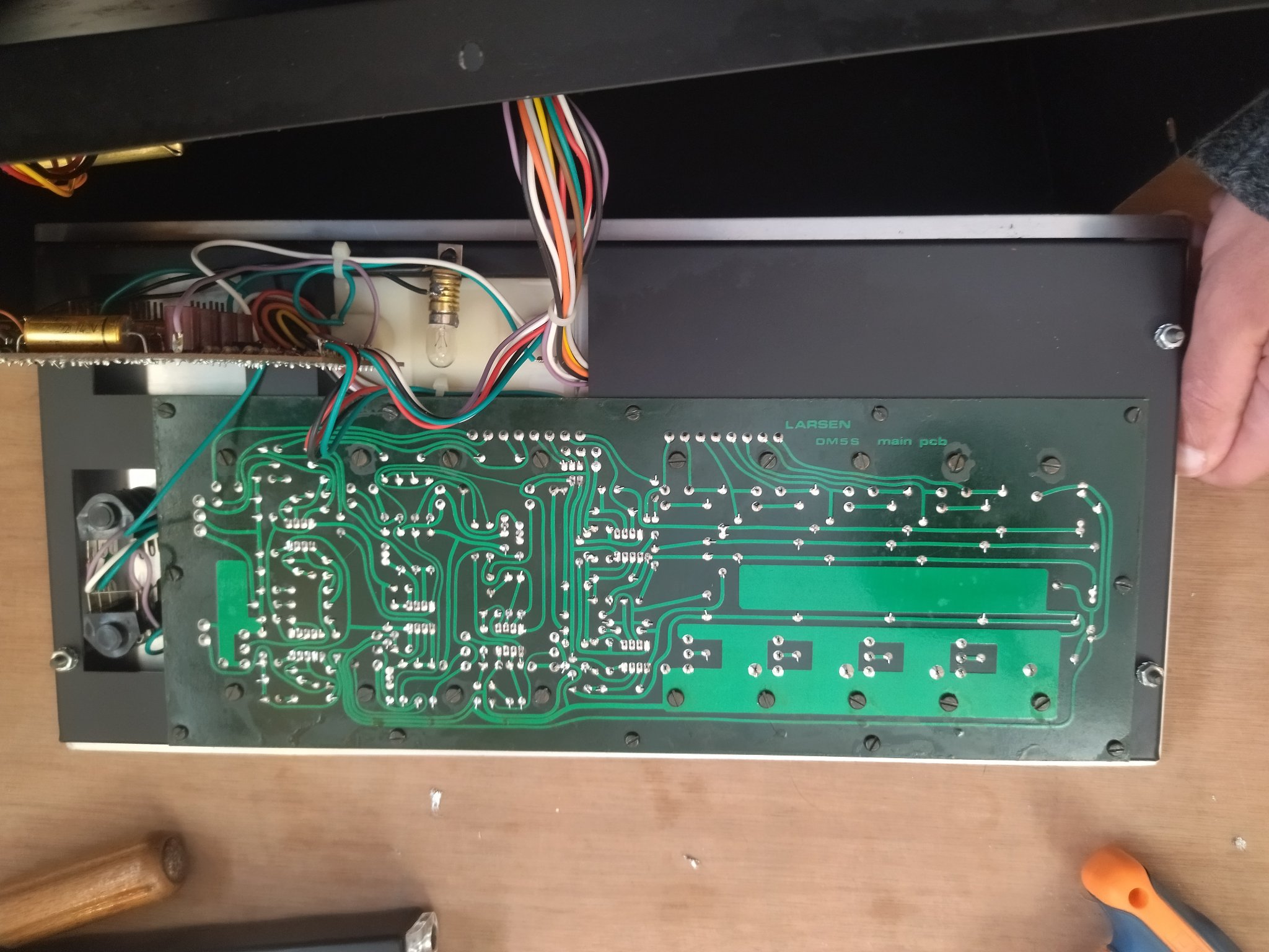

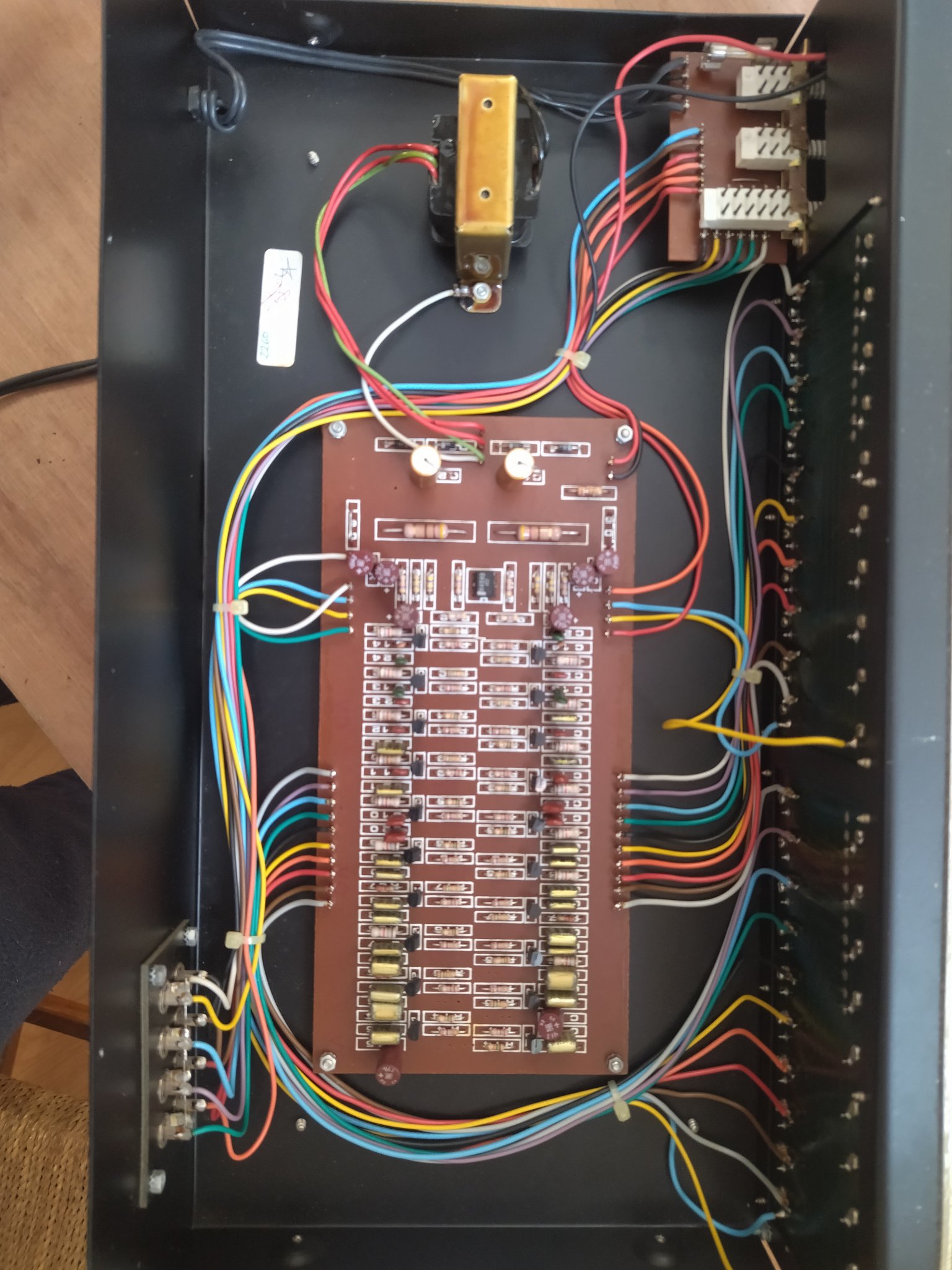

With the system came also this mixer and equalizer. I don't want to introduce a bad link in the chain so I took some pics of the insides for you guys to take a look. An eq seems like a good thing to have, the mixer I could use as a way to get more inputs to the tape input of the quad. Bonus points for the Vu meters 😆
Don't know if the Phono1 and 2 are pre amplified or not. If not I could use this as a 4 way selector. The mic has to have a pre right?
It looks kinda cheap but the insides look decent.
You have nothing to lose having a play with the equaliser but its not really something I would want in that form. There were equalisers available from many big name manufacturers years ago. The mixer as a way to get more inputs isn't a great idea either I'm afraid. Having said that have a play and see what you think 🙂
I never liked that thing, I was curious to see if it made any sense/was well built. It is from a portuguese manufacture, very rare and umwanted 😆
